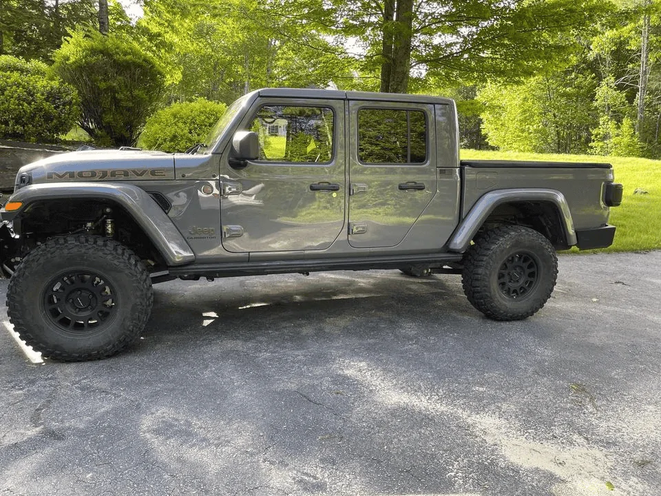

I had 35’s with my Clayton 2.5 RR and it looked fine, but the 37’s I have now make all the difference. Luckily I justified the upgrade by gifting my 35’s to my sons JK. We both win :)

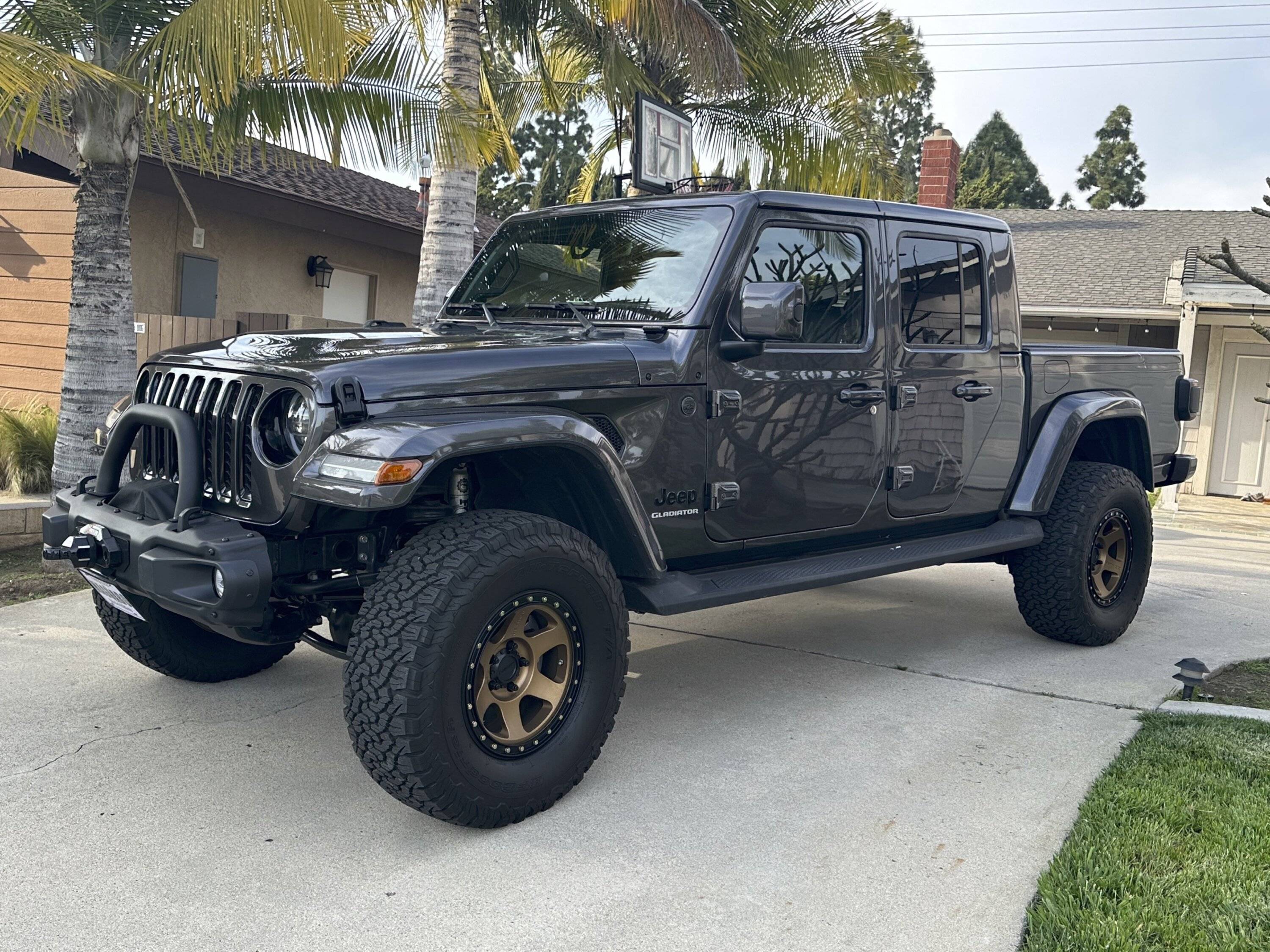

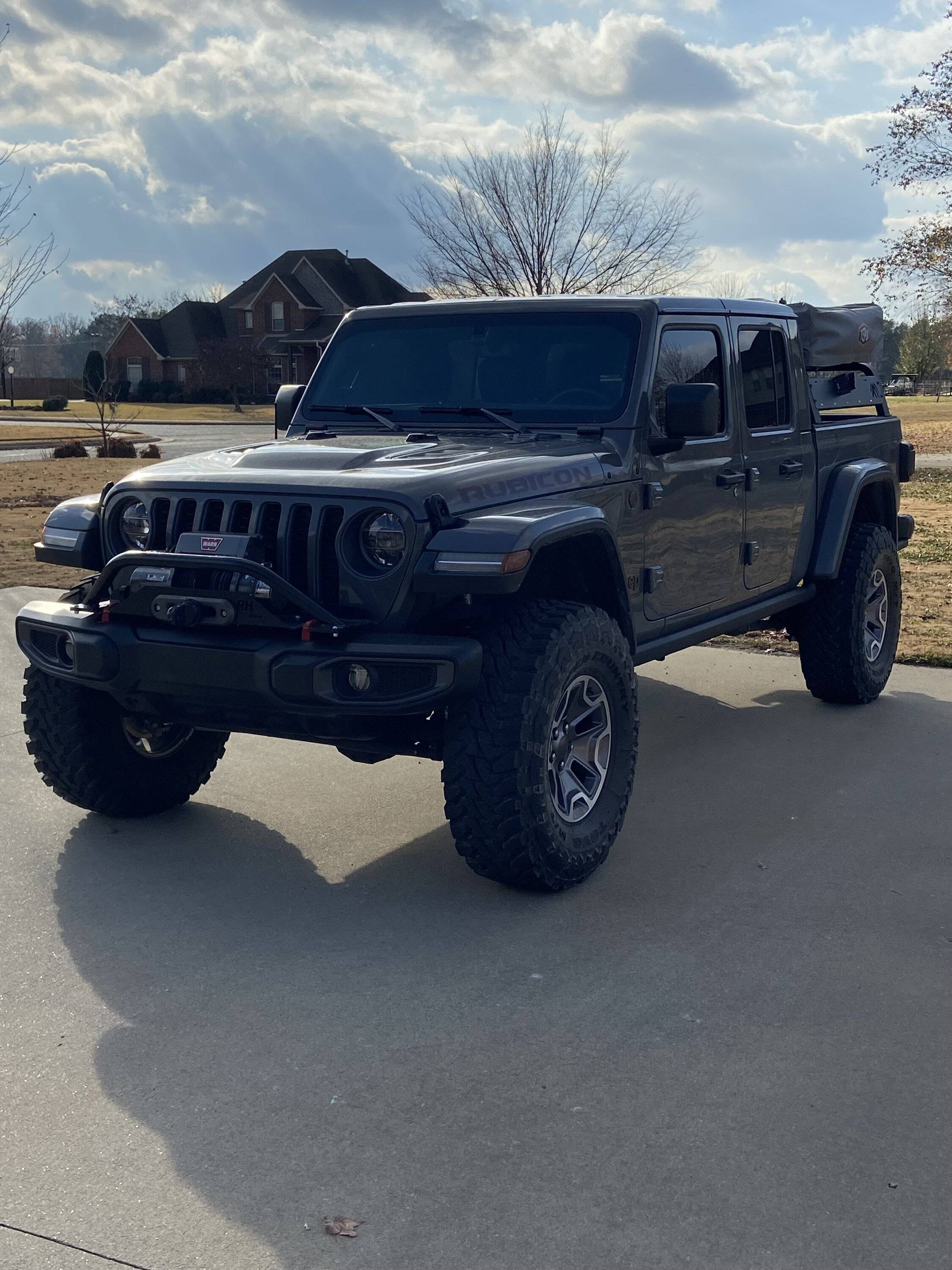

Not a Rubicon. Mopar lift with an inch puck up front to level the rig. I have 315/70/17 KO2s. It looks perfect to me. I hope this helps.
Tbh this looks perfect to me.

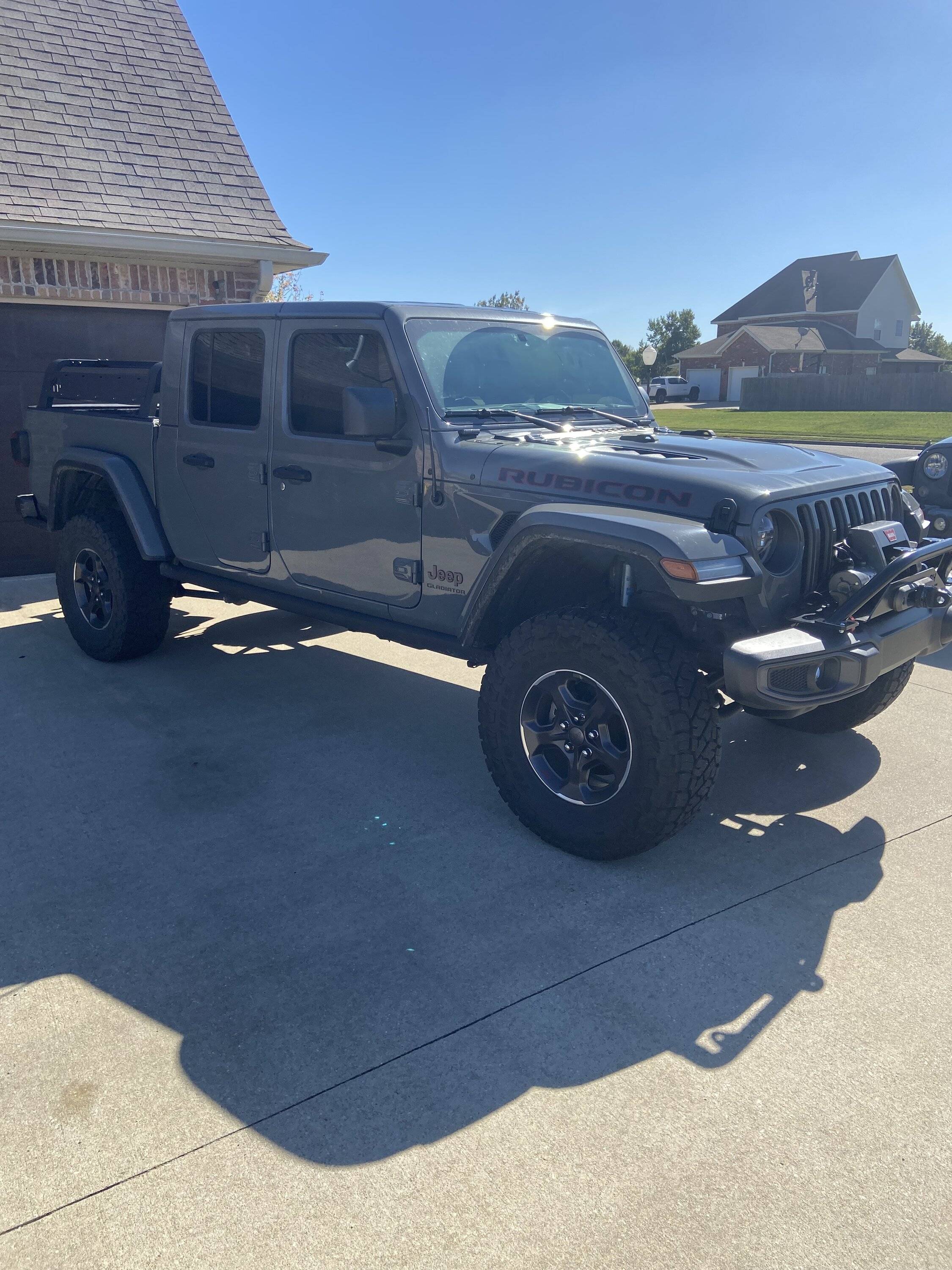

Clayton 2.5" on Cooper STT Pros 315's
Damn it actually looks good. Is your Mojave still 1 inch taller than my Rubi after the Clayton lift? Could you send me more pics of your rig? Thank you!

I came from the JKUR world and knew from experience buying a tire size and regretting not getting what I really wanted. It really depends on what you want to do with your Jeep I guess. I liked my 315 Toyo MT on my JKUR. Seemed perfect. The Gladiator is so long and the Rubi wheel wells are so open that I knew eventually, I would go 37 once I got the Clayton lift on. I believe I got 3+”from the lift IIRC. Love the ride, and haven’t done the full control arm kit yet to make it an Overland kit.
I went with the 37’s because of the buy 3 tires get one free deal from Mopar. DT matched it, and I got an extra 5% off using my no interest for 12 mo DT card.
I looked at the 1.5” lift and thought long and hard about it. But I knew I would eventually want the 37’s so I got the 2.5”. If I was in a spot where I had new 315’s, personally I would go with the 1.5” kit.
I have to say with 37’s, I feel like I’m driving a tank…in a good way :)

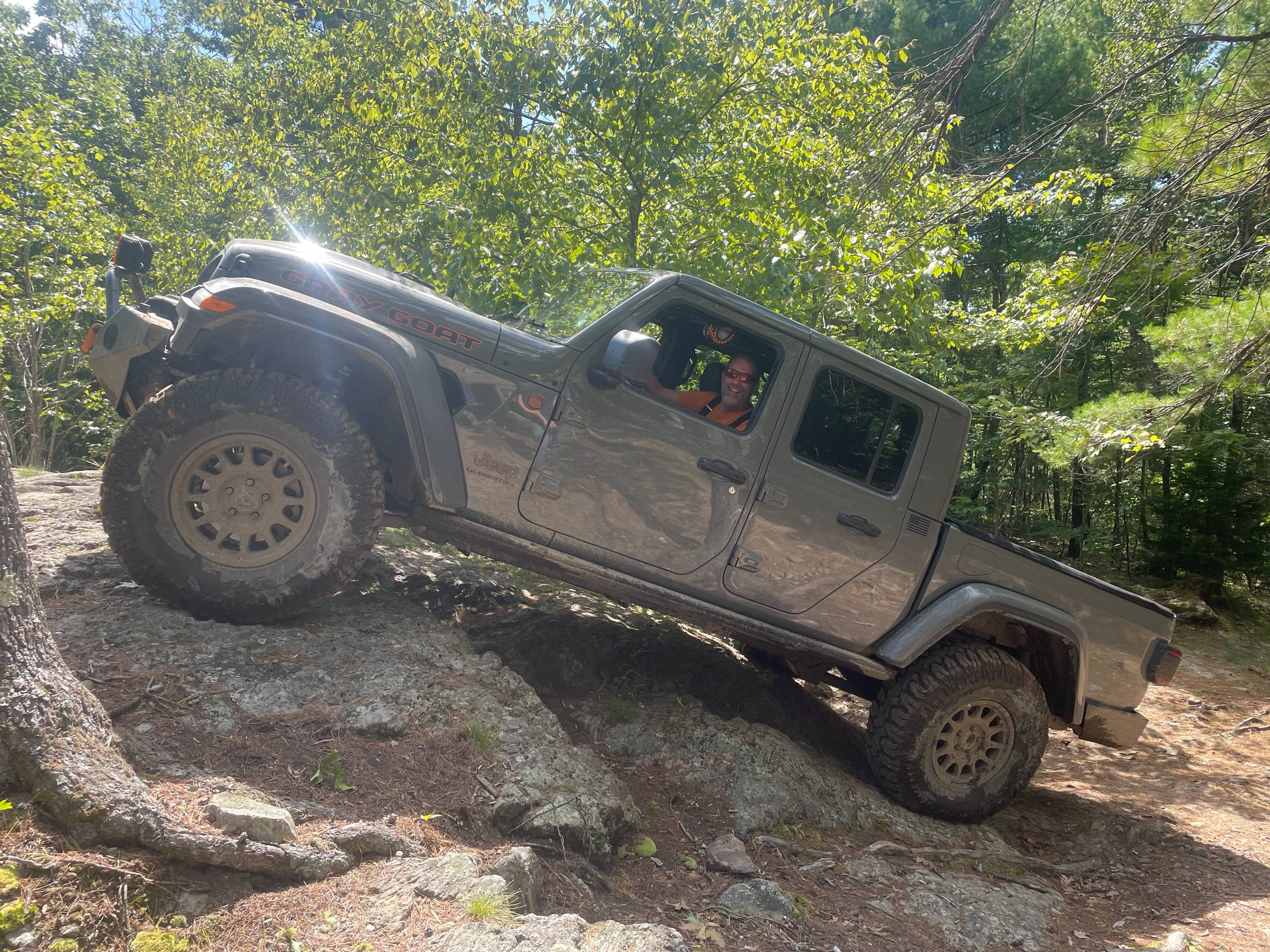

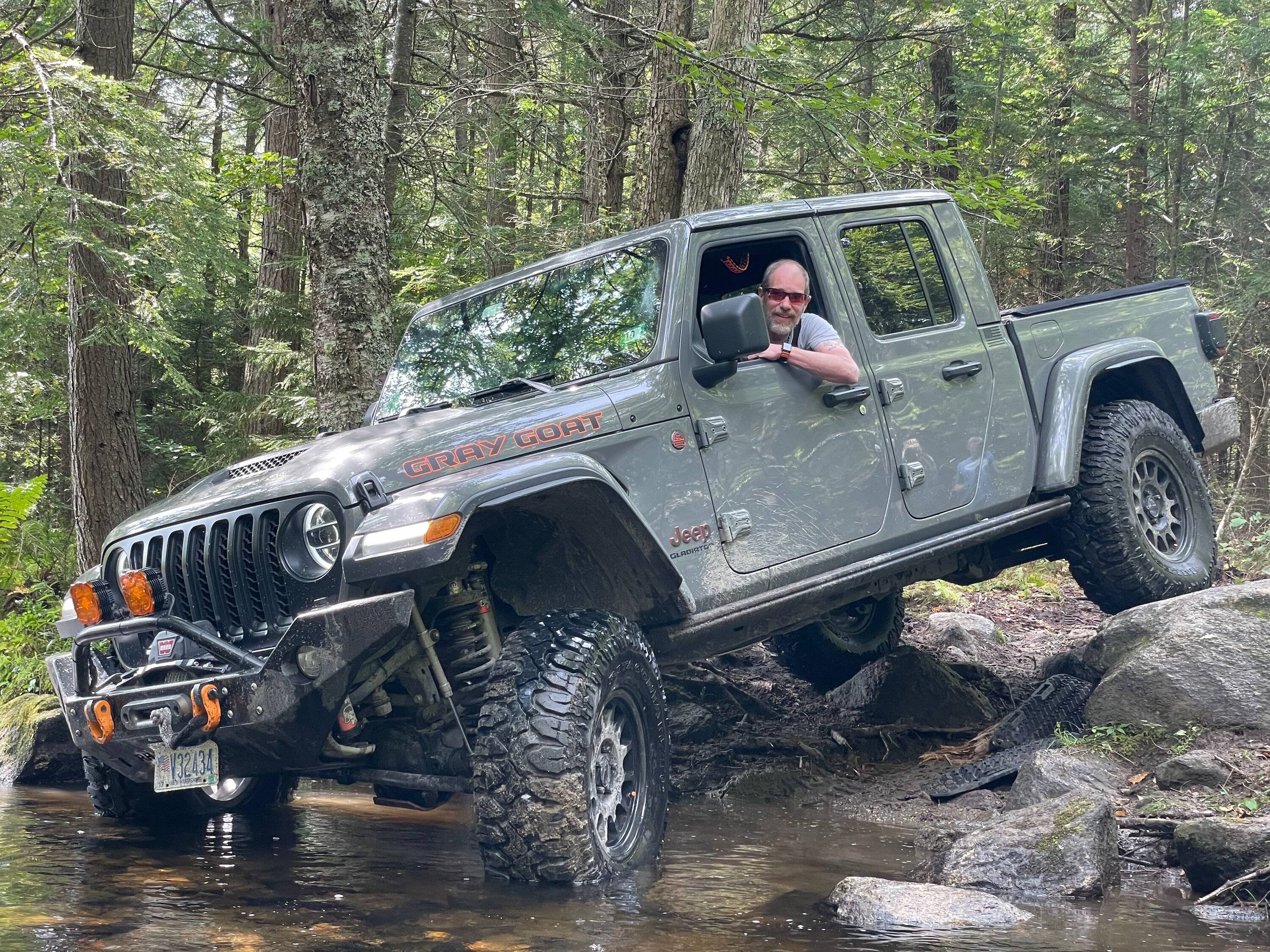

Here is a video of my first ride after installing the lift.

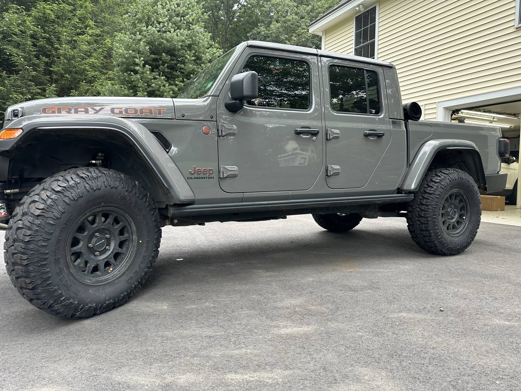

Looks great. Been thinking about lifting my Mojave also, but don’t want to do the AEV. What Clayton lift did you go with, also, did you use shock extension? I’ve been thinking about just replacing everything, shocks included. I know, why did you buy a Mojave then. ?

I did the clayton overland 2.5" plus lift. I did use shock extensions. I have since upgraded the shocks to eliminate the extensions and went to 37's
Toyfrog
James
Sep 4, 2020
603
697
Houston
2021 Mojave
Thinking about going the same way. Would you mind sharing some pics when you get a chance please?
Did adding the puck effect the ride quality at all?
Gelo
Gelo
Dec 27, 2020
Orange County, CA
2021 Jeep Gladiator High Altitude
Accountant
Hi, I don't think it did but I did add the puck at the same time the truck was lifted. The steel bumper and winch did settle down the front perhaps a half-inch. You can feel the weight of all that gear.
