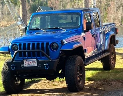

  • 35's and 4.10 gears, yes.
  • 35's and 3.73 gears, no.
  • 33's and 3.73 gears, 8th gear will phone in from time to time.
Bingo
Without gear change from 3.73s to at least 4.10s or you have the max tow package, then 35s will be a bit much. I think 35s look the best on Gladiator.
