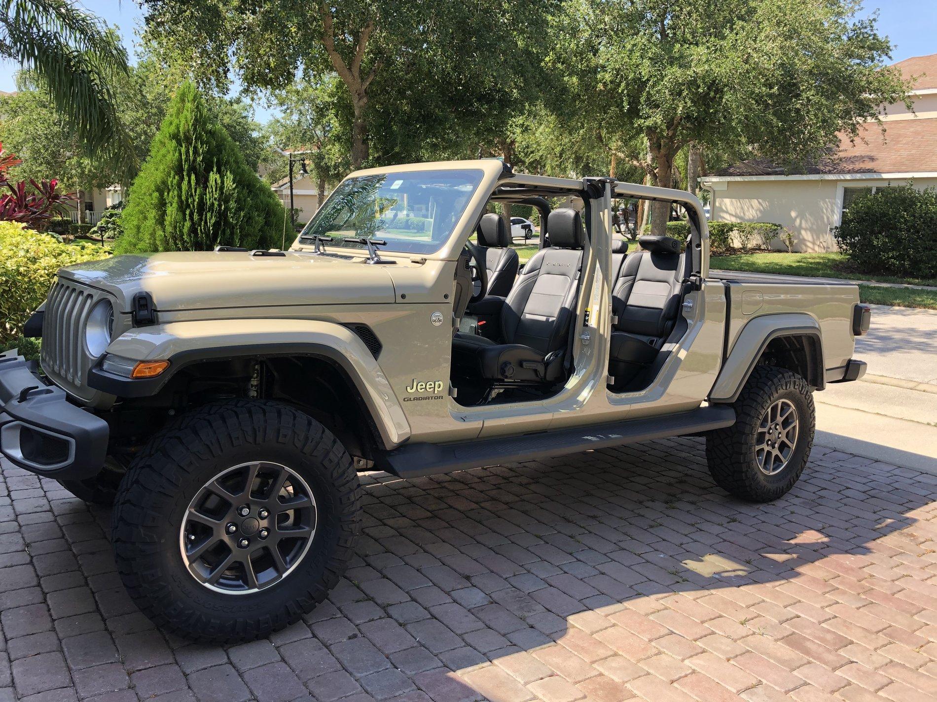

I put Ironman All Country 35" x12.50 M/T's on the stock rims they look pretty nice. However, I have a 2.5" Icon lift.

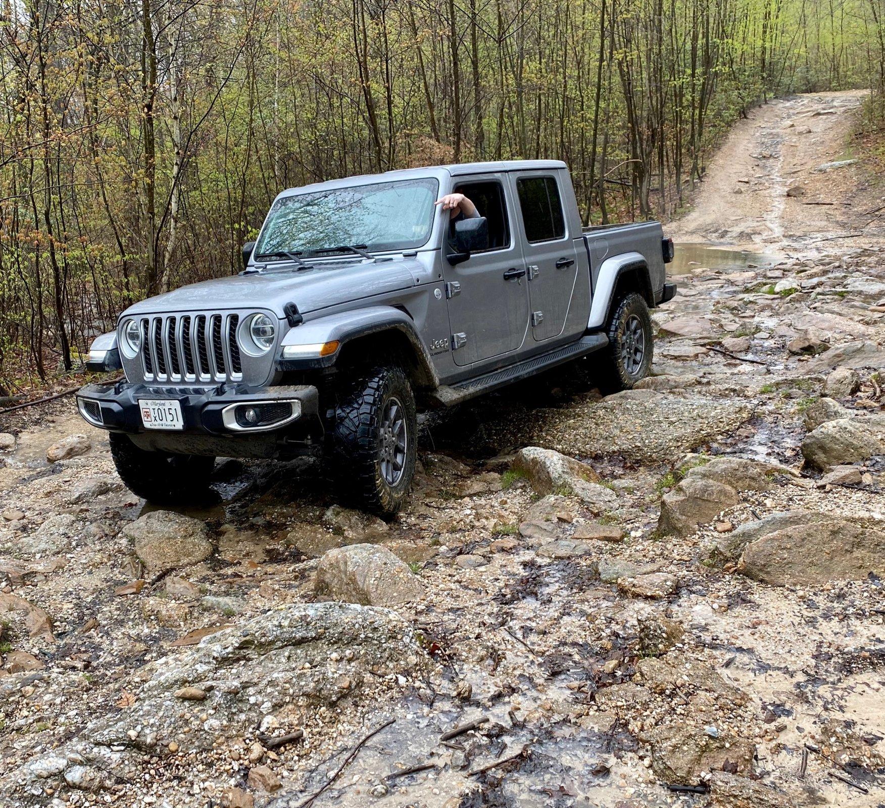

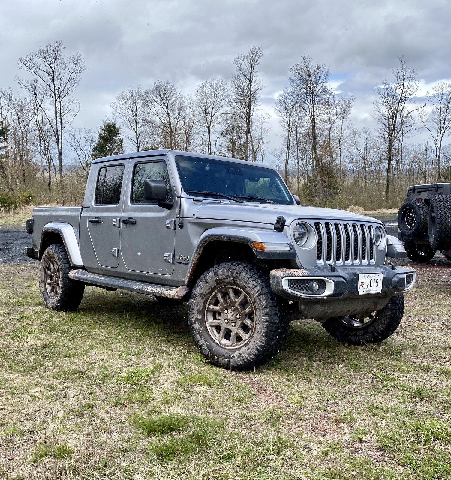

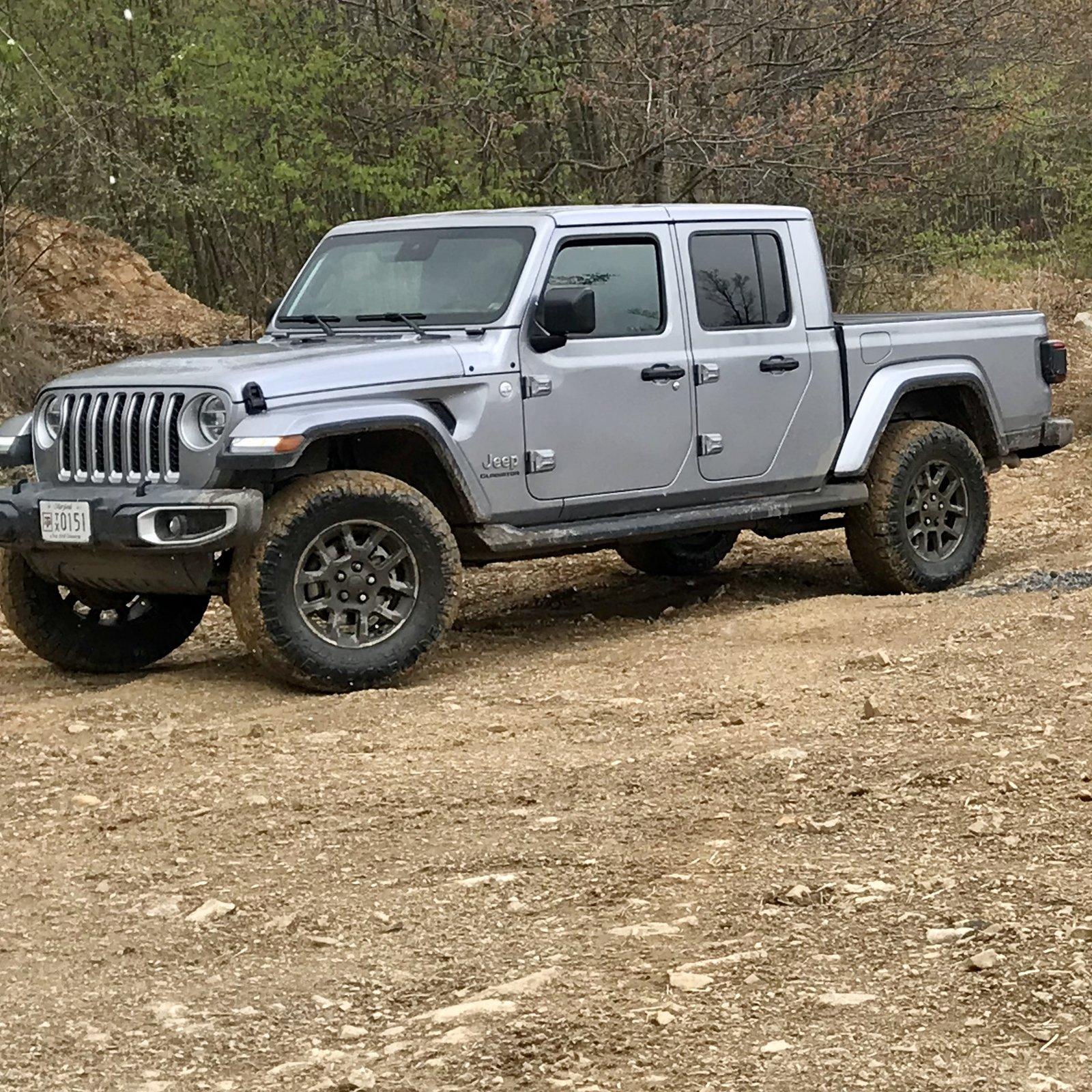

Nitto Ridge Grapplers 295/70R18s with a 2.5” lift. I drove 6 hours on them this weekend and love how quite they are on the highway while still performing off road.
The last picture helps explain why I wanted 11.5 width instead of 12.5. With 70’s I could keep the tires tucked flush with the fenders and had very little mud or rocks kicked up on the body. Running boards helped as well of course...

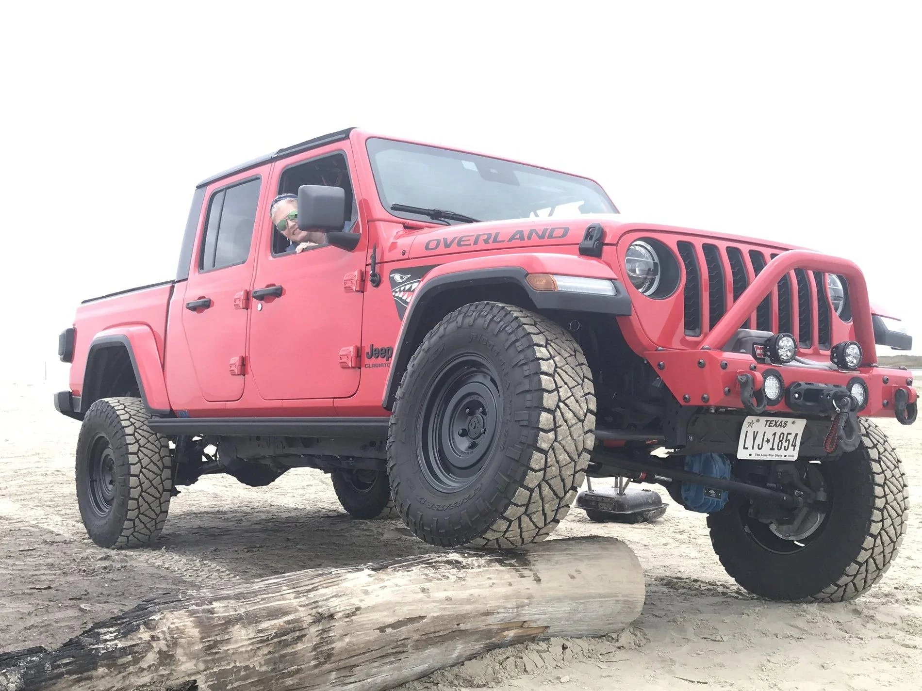

i run Nitto Ridge Grappler in 285/75/R17 C comes out to 33.8" mounted 33.5" with 3" RockKrawler suspension.
