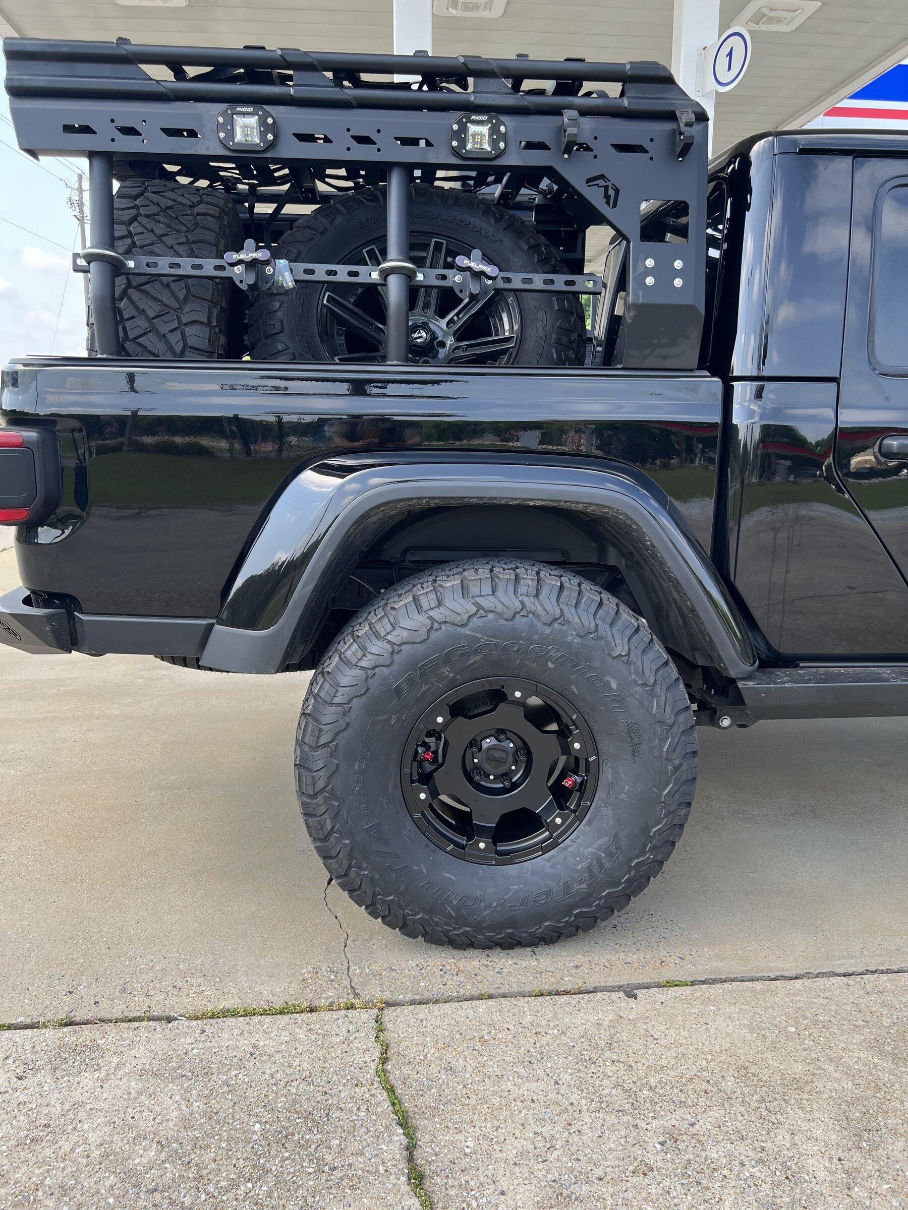

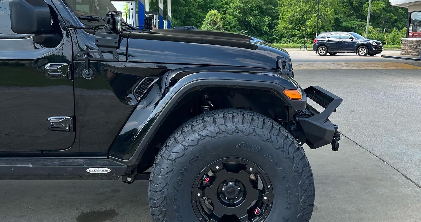

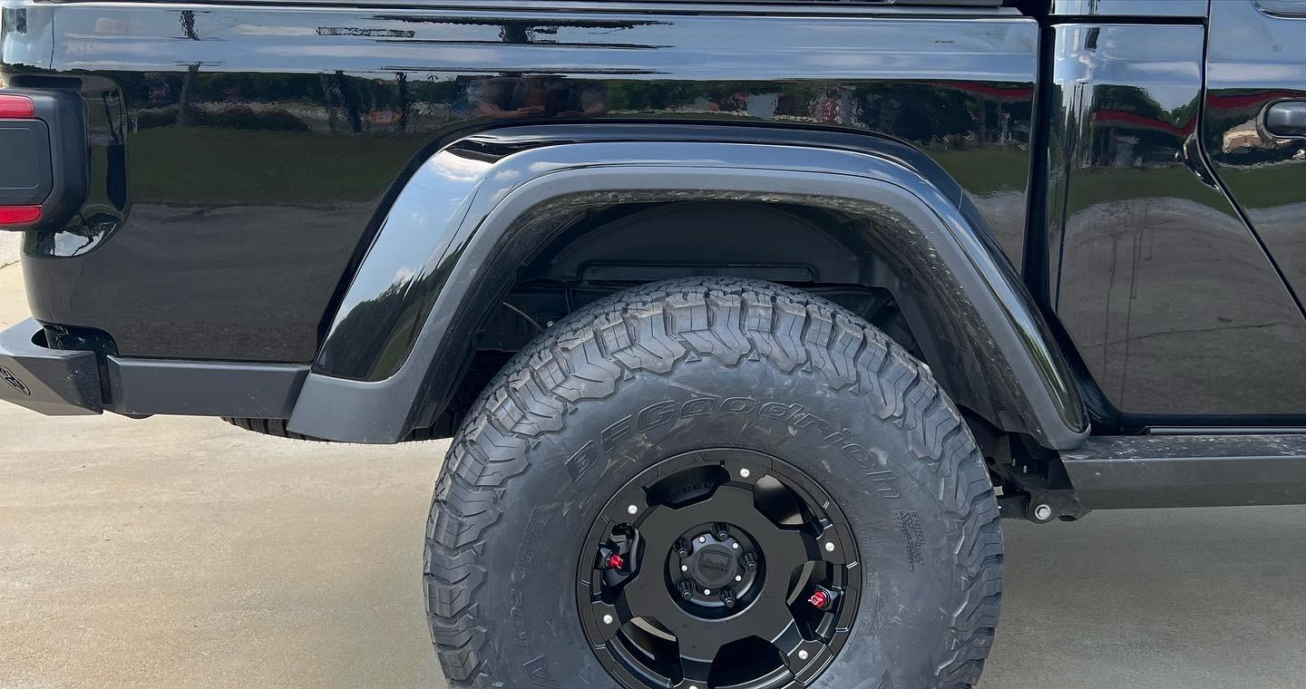

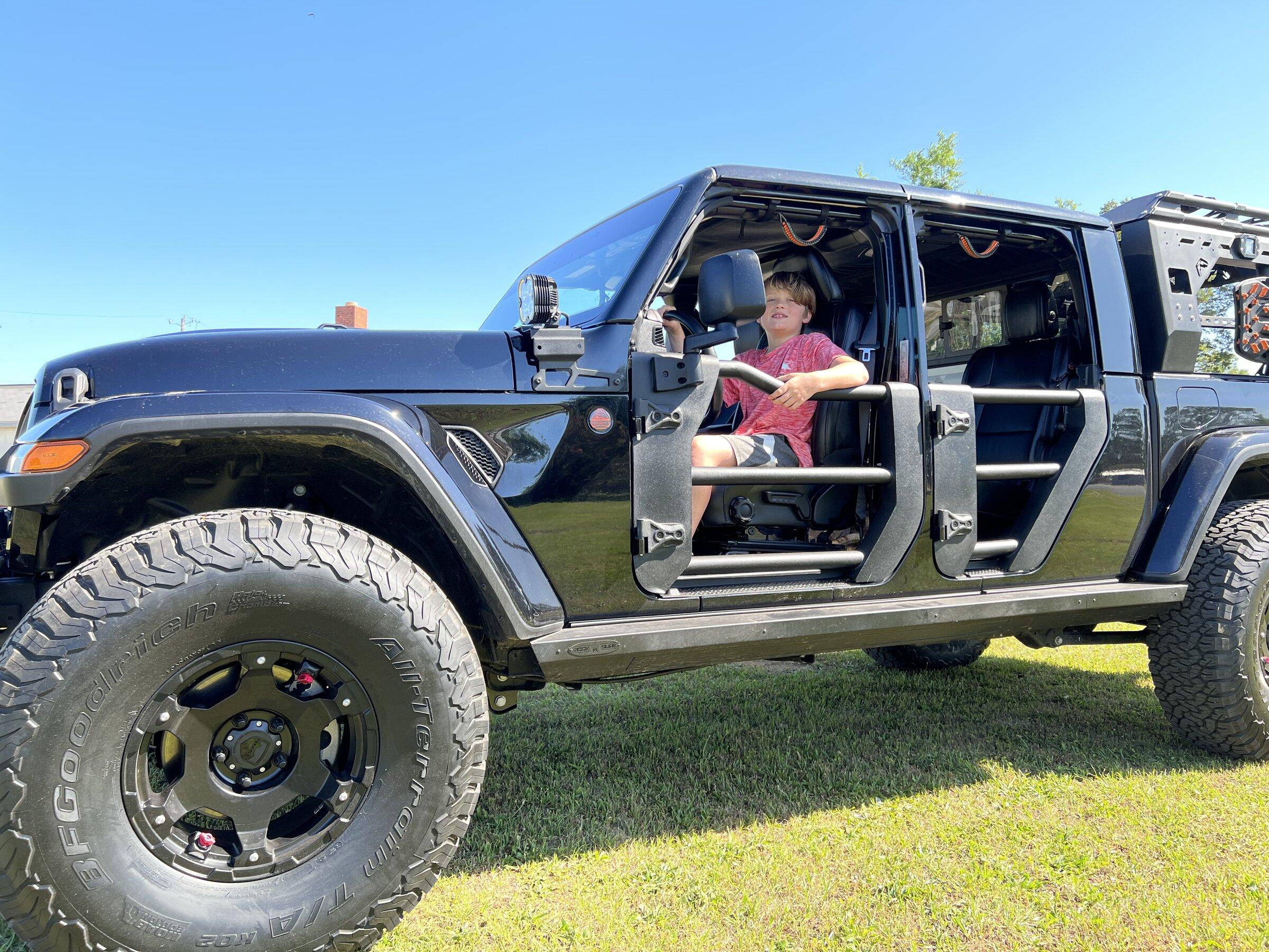

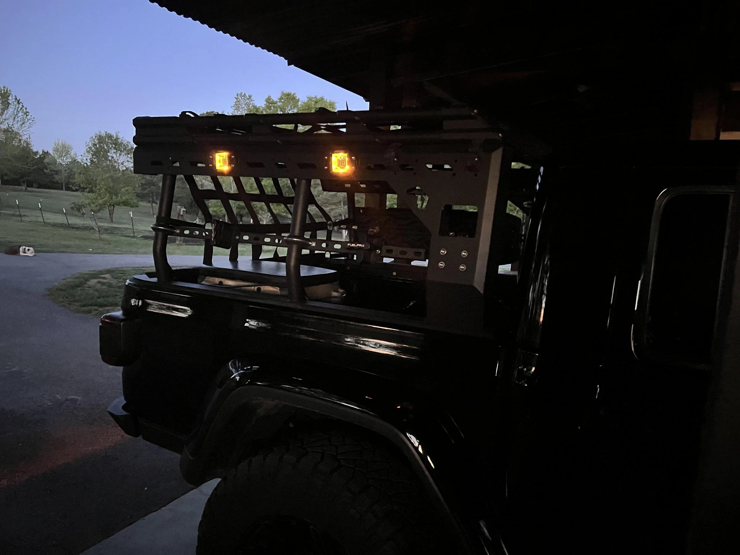

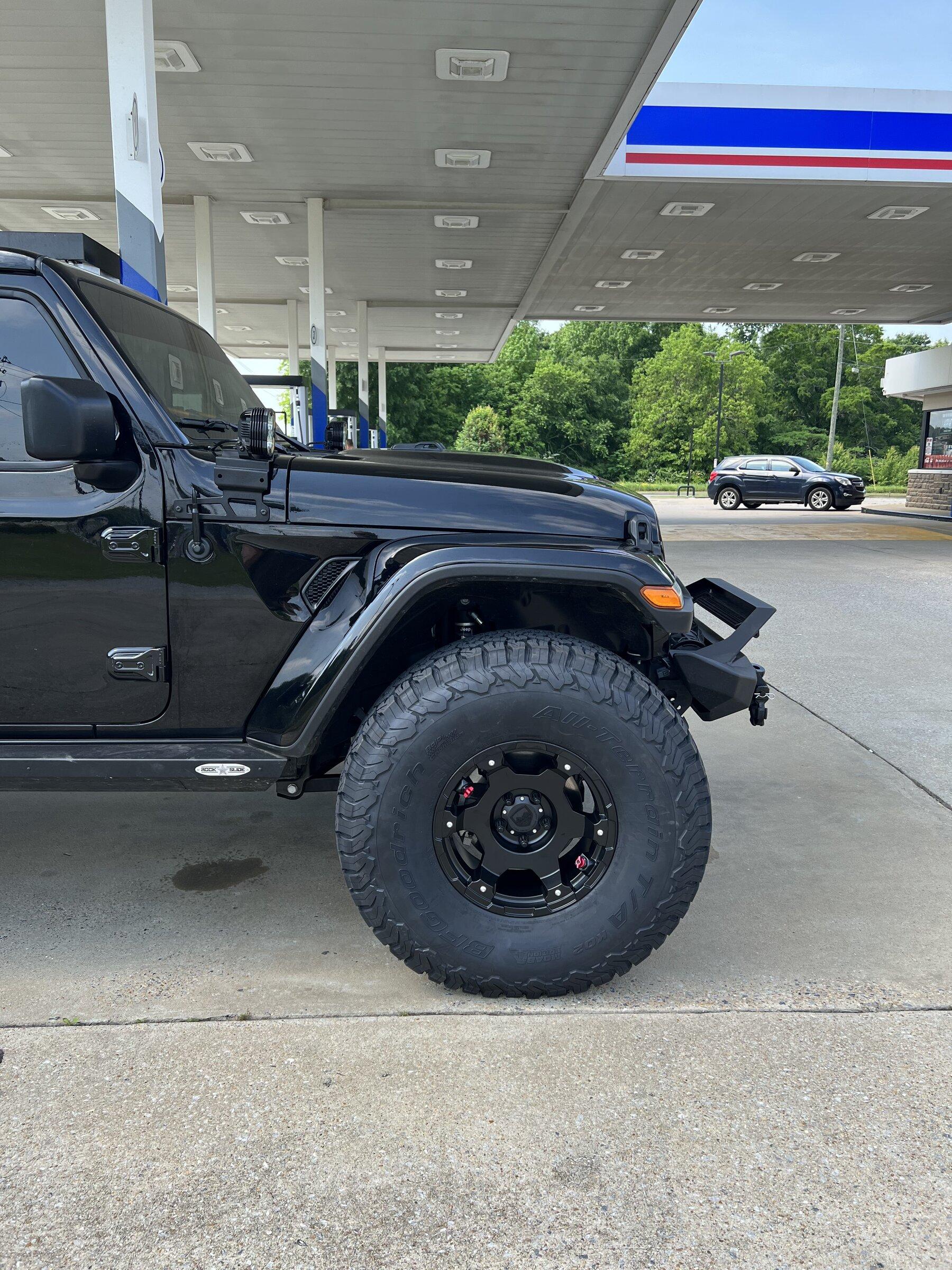

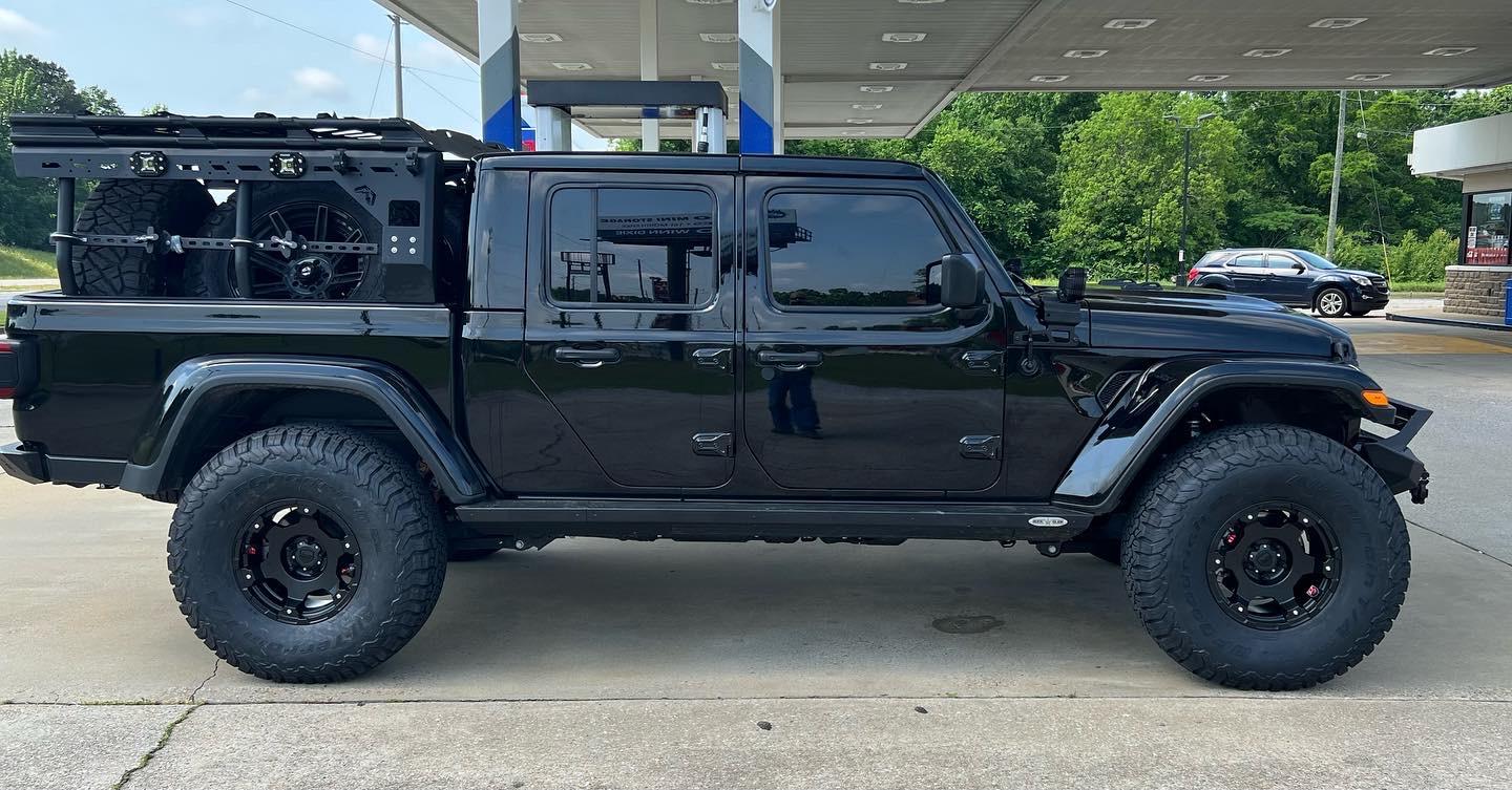

I’m not online much so will provide as much information as possible. If you have a question don’t be offended if I don’t get right back to you! 2021 Mojave 3.6. Added AEV 2 inch spacer lift with their geometry correction brackets. Highly recommend any AEV product! Cost around $800 and installed myself. Teraflex deluxe Nomad wheels. Very pleased with look! Have the optional trim rings ordered. 39 x 13.5 x 17 BFG K02s. Barely extend beyond fenders. Ride very quiet compared to the 37 inch Nitto Ridge Grapplers I replaced. Air bags in rear inflated to 10 lbs. Zero rubbing. Zero problems. Have ridden around my property quite a bit but no rock crawling. Plan to install motobilt front fender brackets this week and remove the factory inner liners. Just for the look and extra few inches of clearance but not necessary. New gears one day but drives great as is. Have not recalibrated speedo yet but superchips on the way. Here are a few pictures. This forum is extremely useful for DIYErs! (quadratec tube doors match my fabfours rear rack perfect, all rugged ridge lights & KC lights). Goose rear seat delete saved 90 lbs.
