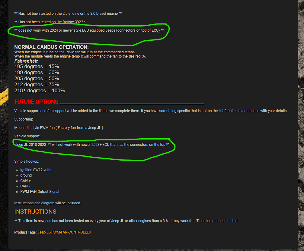

well there is some kind of difference. otherwise they wouldn't state any of that. And how would one know its working? and not just continuing to run on its stock profile? IS there a way to check that its actually running outside the stock set range? or do you have to get the switchable option and do it manually?
I did have to use a wiring diagram for my specific jeep as the one provided by them was incorrect. Maybe that’s the difference?
I can confirm it’s working because I can hear the fan at idle, which I never used to before, and I no longer get over 206°. Whereas before I’d see 230 sometimes. I can assure you it is working as it should in my top-connector GPEC5.
well that warrants giving them a call at least. Thanks for doing the unknown!
I didn’t even see that it wasn’t supposed to work with the top-connector ECU. haha OOPS!!

Mine has the GPEC5 with the connectors on top and I’m running the fan controller just fine…
What engine do you have.
This is the first time I have heard of a top mount ECU.
They made the change several years ago, but it wasn't consistent. The older unit still showed up in some trucks. There's a lot of information in the Forced Induction section. It had a big impact on those doing Tunes and adding Superchargers.

You guys want to really lower your engine and oil temps.
Install the RPM Extreme JL Fan controller.
I have his old version on my Willys witch Idles the fan at 15% fan speed keeping air moving through the engine compartment at all times. Running it for over a year now.
I have his new version on my Wife's Rubicon witch comes on at 195 at 15% fan speed and turns off at 190 degrees. In stalled last week.
I have seen a reduction of 25 degrees on both oil and coolant temps.
Jon can program the module any way you like.
Here is More info on how it works.
http://www.rpmextreme.com/Product/311/Jeep-JL-PWM-FAN-CONTROLLER.aspx
This has been a game changer and I will be happy to answer any question you may have.

The link will fit a 2023 rubicon? Not sure what options are needed
You don’t really need any options unless you want manual control over the fan. You can have them add a wire that gives you medium or high fan speed by either supplying + or - to the wire. I elected no overrides.
so that kit linked just plugs right in?
jav_eee
Mar 10, 2023
1,084
1,075
2021 Gladiator Rubicon
it has to be spliced in. It’s not hard at all IF you’ve done wire splicing before. I just peeled back some insulation and wrapped the new wire around the target wire and added a drop of solder to hold it on.
