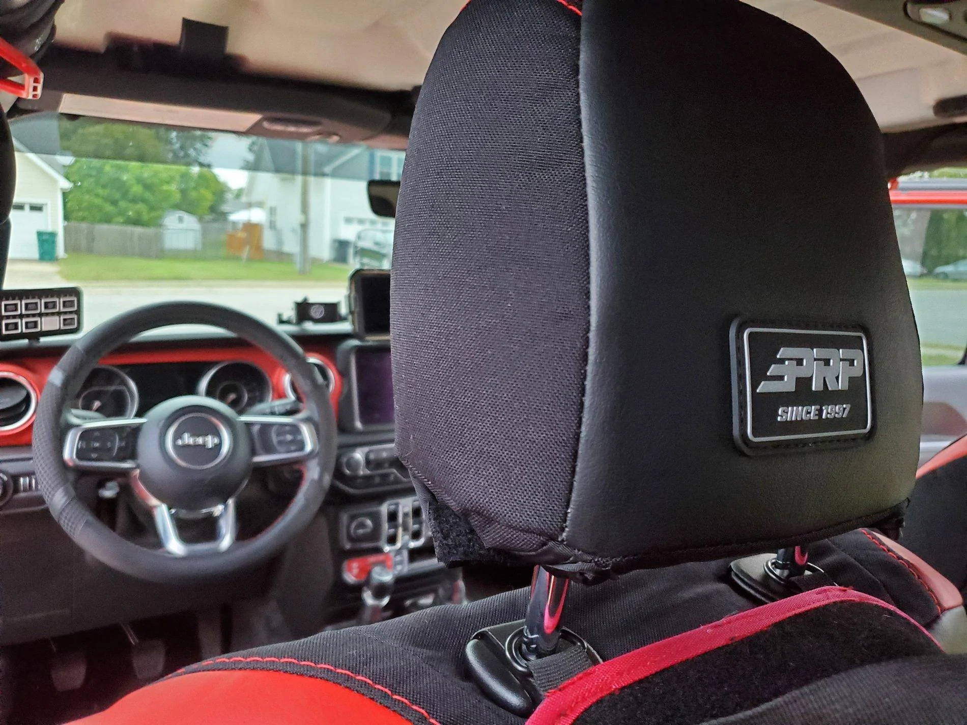

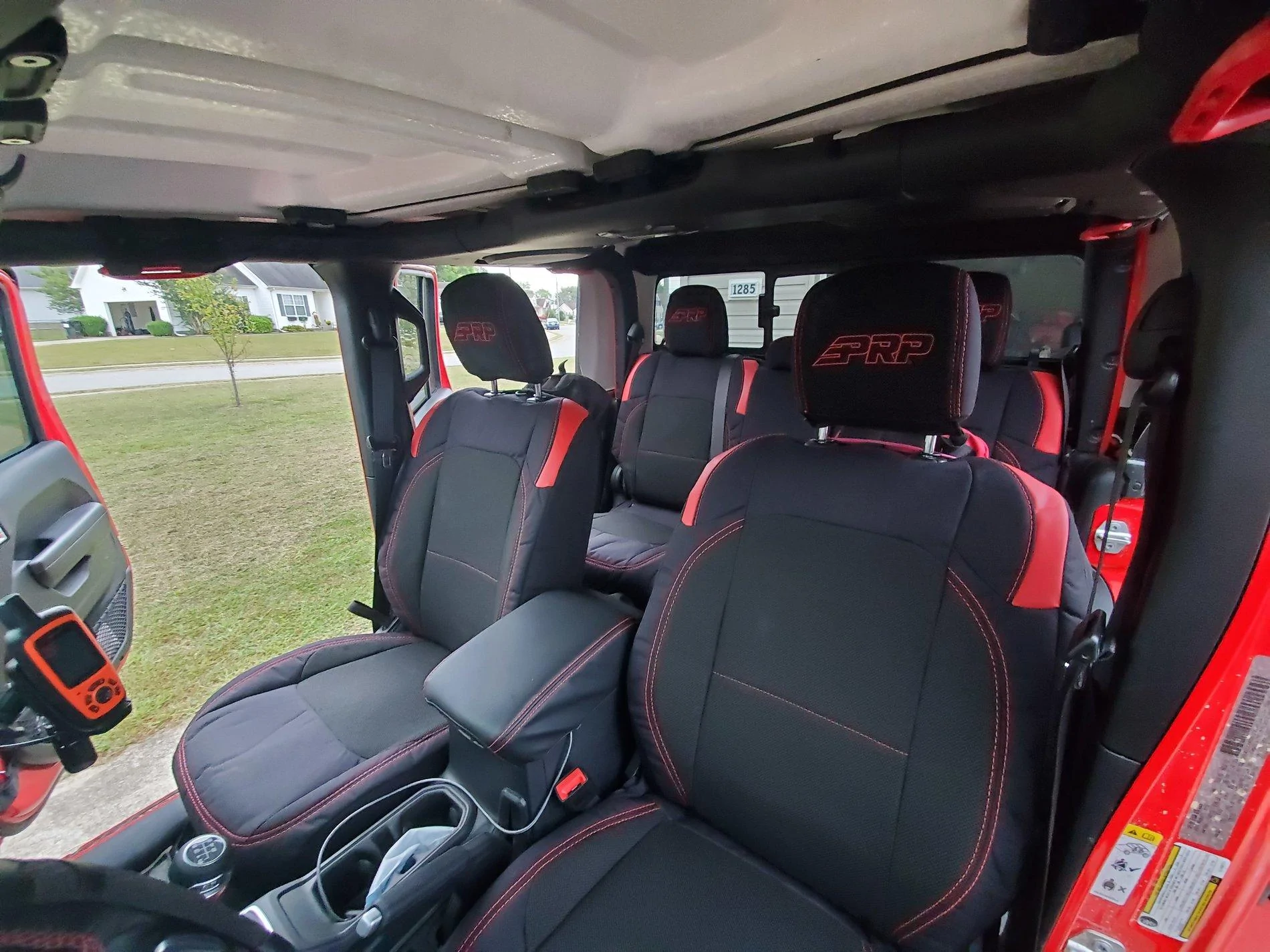

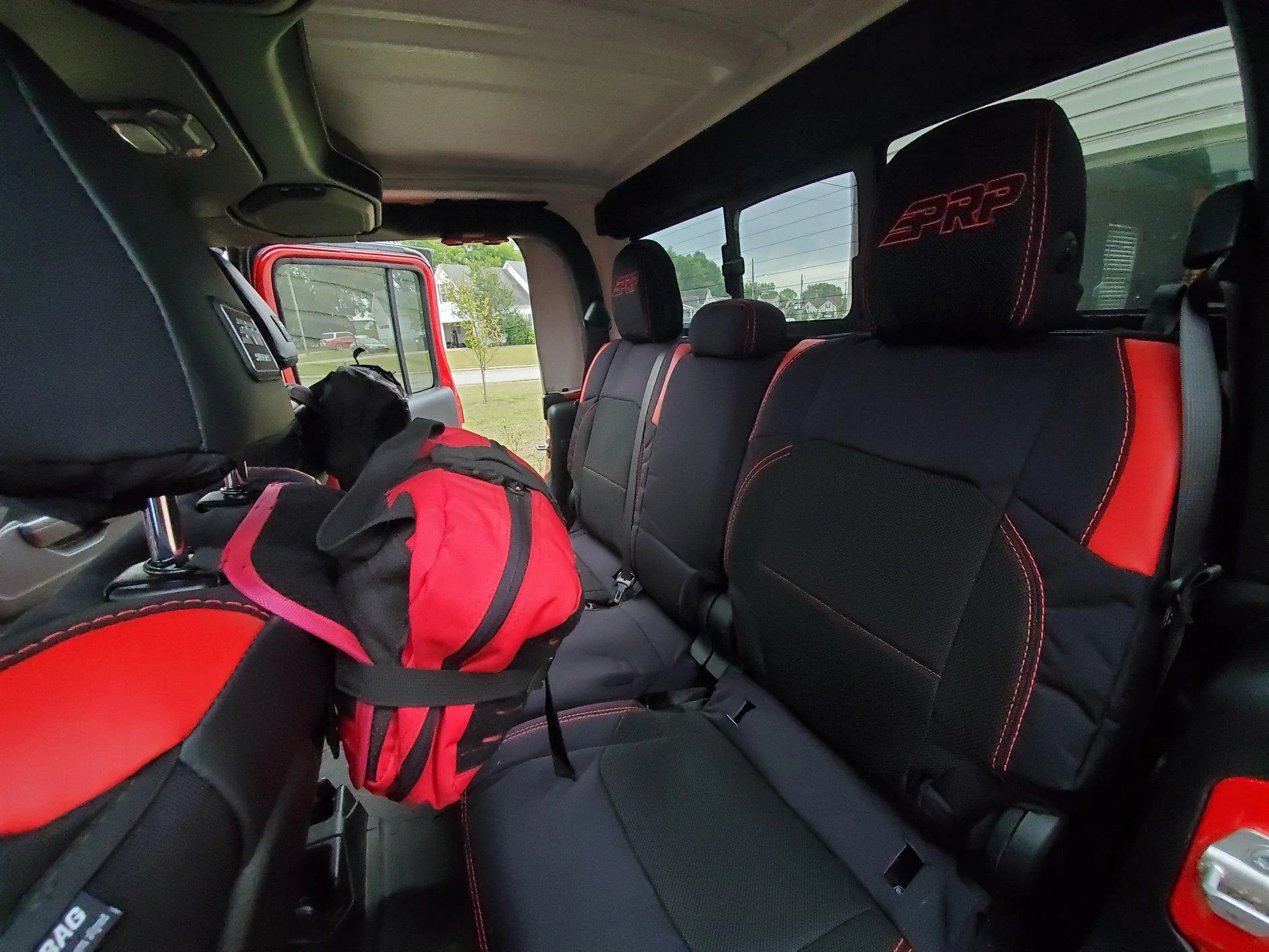

Another quick update today! My PRP seat covers finally arrived (they took 6 weeks from order to arrival), and I couldn't resist getting them installed. I'm very happy with how they turned out. Admittedly, install was...a bit of a pain. It was mostly time consuming, and involved contorting my 6'4" frame in to positions I probably shouldnt have attempted, but here we are.
Jeep Gladiator Ares - Build Thread 20200922_180817
Jeep Gladiator Ares - Build Thread 20200922_180846
Jeep Gladiator Ares - Build Thread 20200922_180903
I originally considered the Bartact route, but after seeing how many options PRP offered and after reading great reviews, I decided to pull the trigger, and I'm glad I did. I went with a black tweed interior (butt and lower back), with a black cordura exterior (stress areas, such as where you slide off of the seats) and a black vinyl backing, with red vinyl accents at the shoulders. I'm blown away by the quality, and their price was better than Bartact for my specific needs.
You may notice in the pictures that the center console cover looks a bit...saggy. I recieved that about three days ago ahead of my seat covers. I informed PRP of how it looked and sent them pictures, and within the same day they got back to me saying they'd forward my concern and pictures to the heads of production and customer service. The next day, the department heads contacted me saying that they'd rush an order for a replacement back to me free of charge. Big shout out to Aileen and JR at PRP.
That should just about wrap up my interior mods. The only other interior mod that I have planned is a HAM radio install, but that's pretty low priority since I have my inReach for emergency contact purposes. As usual, more to come!

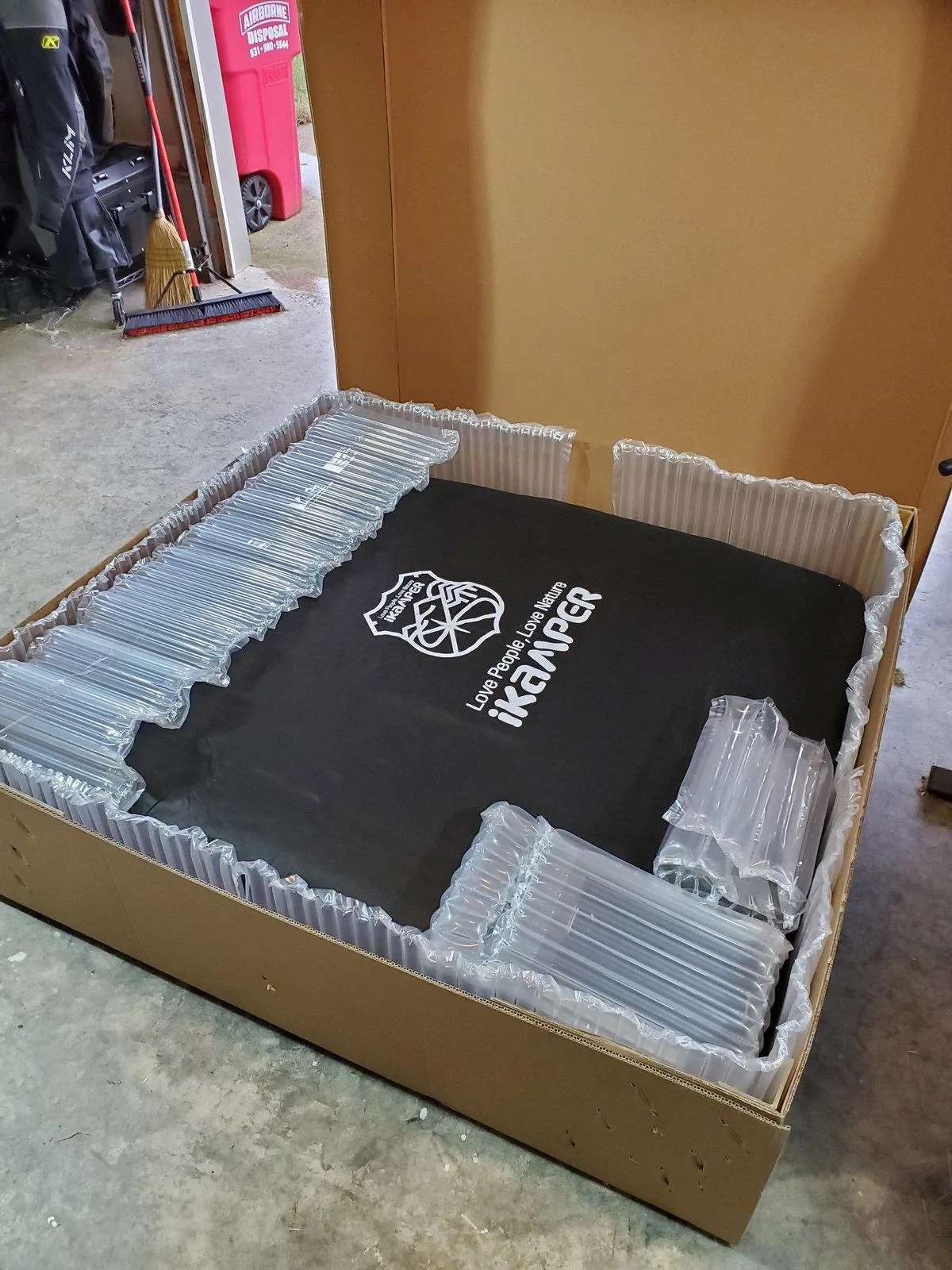

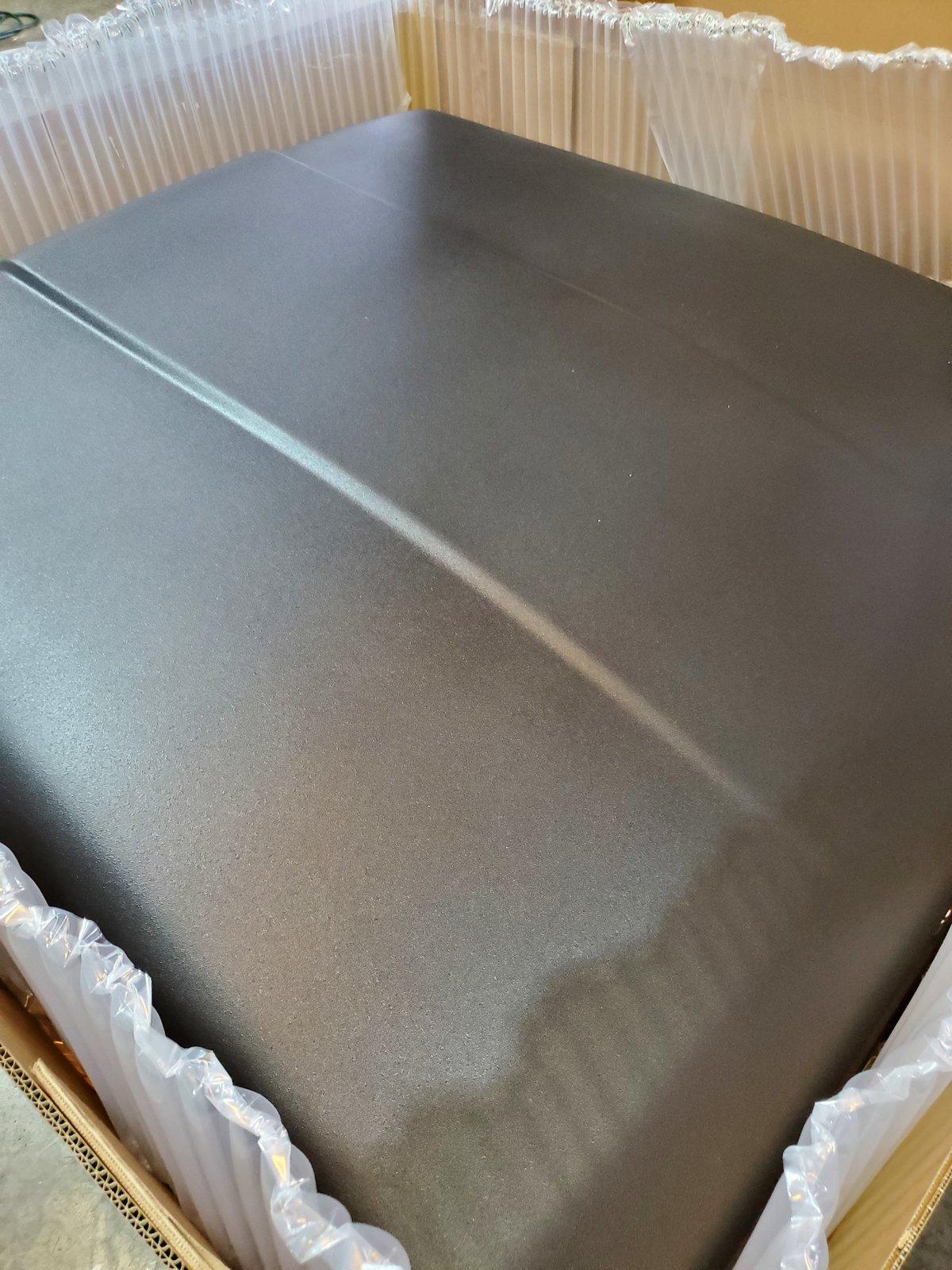

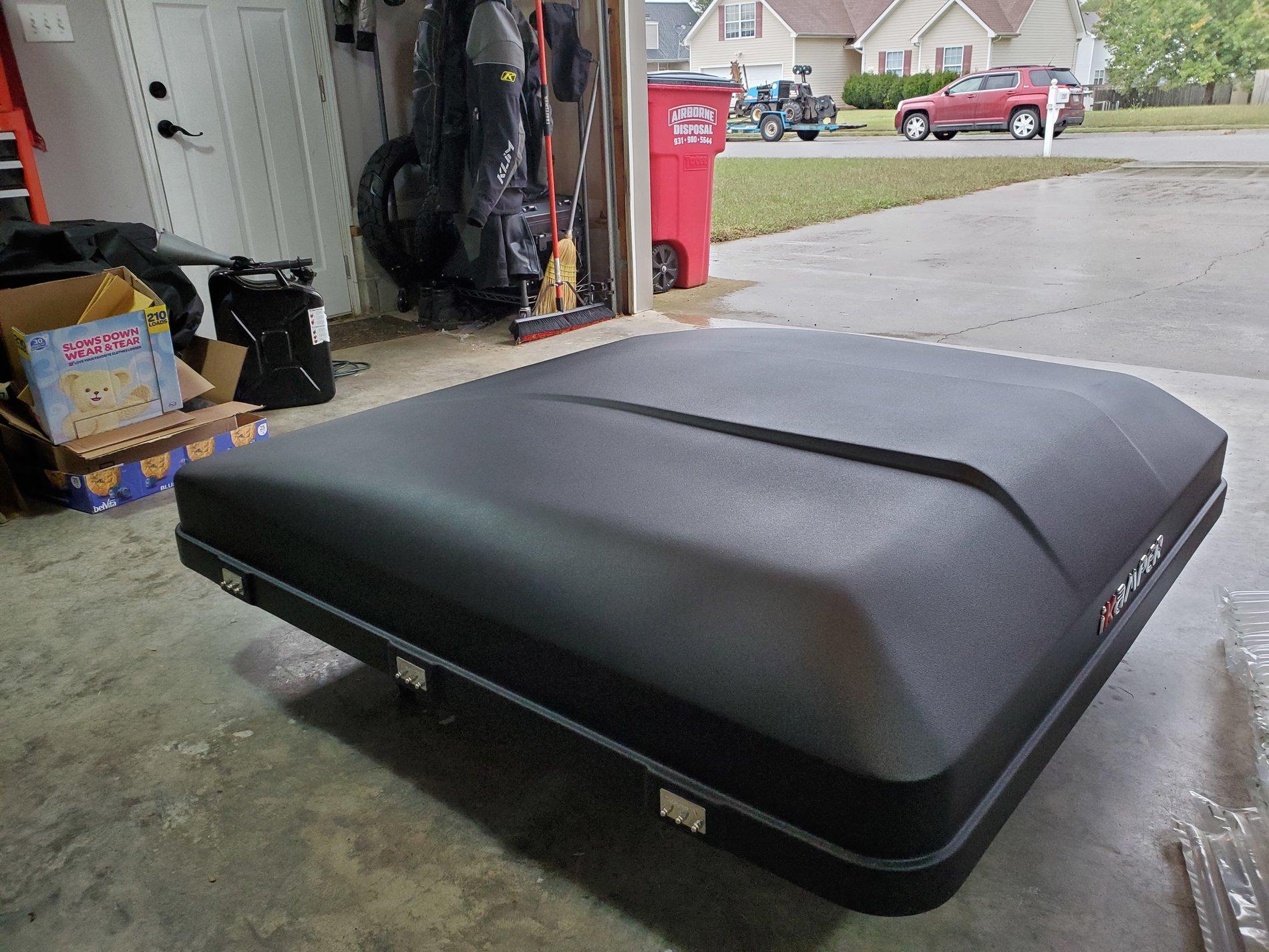

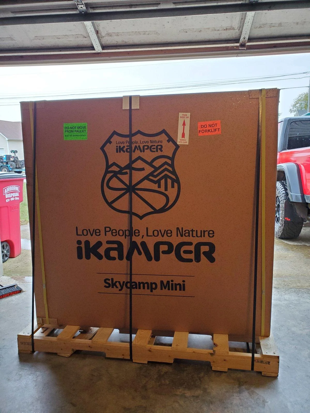

My new RTT finally arrived! Initial impressions are great: Fantastic build quality (feels very solid), great quality on the coating (I went with the "Rocky Black" line-x version), and the packaging was great. I placed my order on August 17th, and it arrived today, October 15th, so they were almost spot on for their estimate of 8 weeks of delay at the time I ordered.
I'll likely be putting up a video walkaround once I actually have a means to mount it. My RSI camper shell is supposed to be in in November, which is what the tent will live on top of, so I'm looking forward to that.

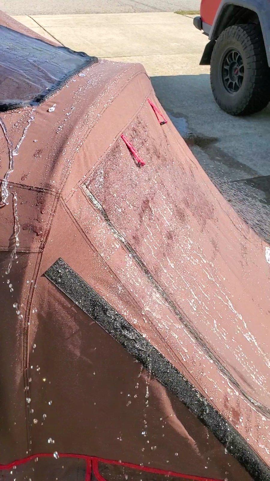

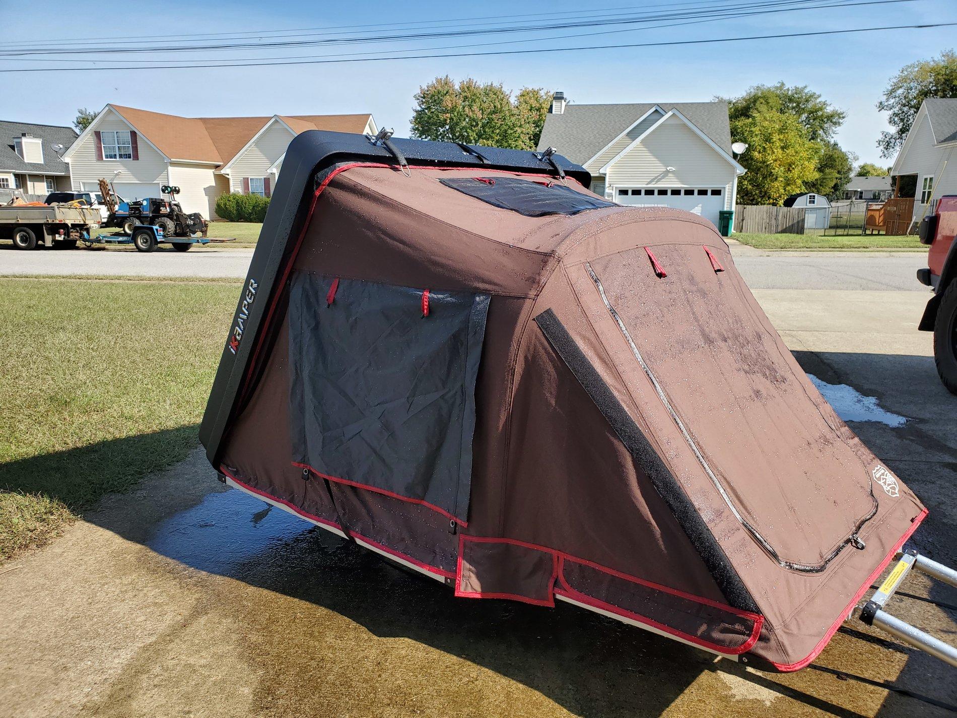

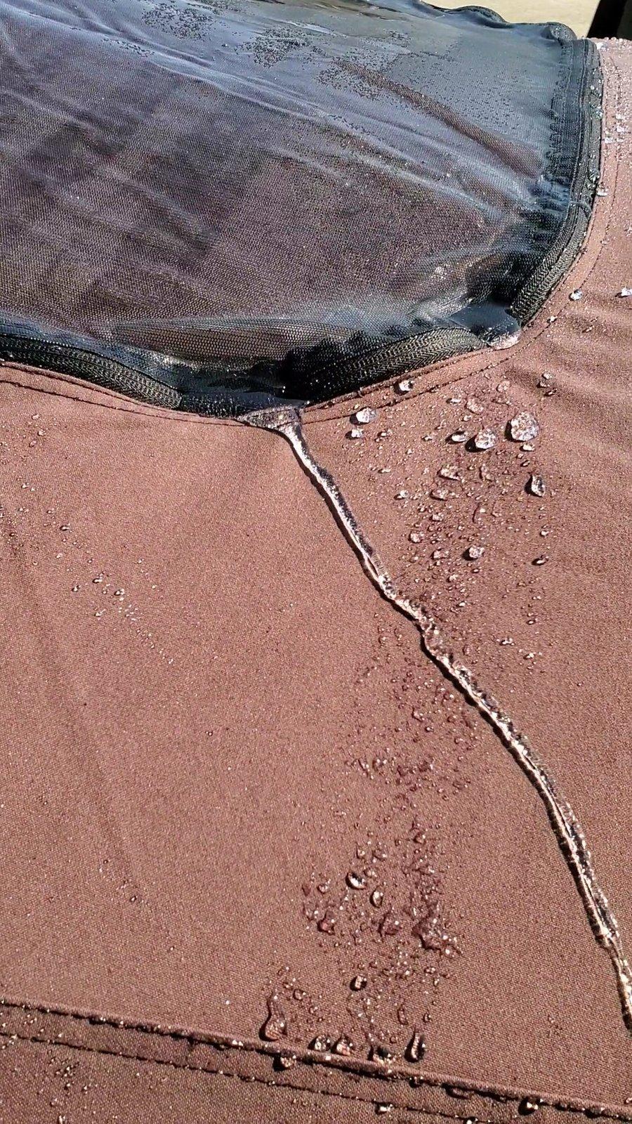

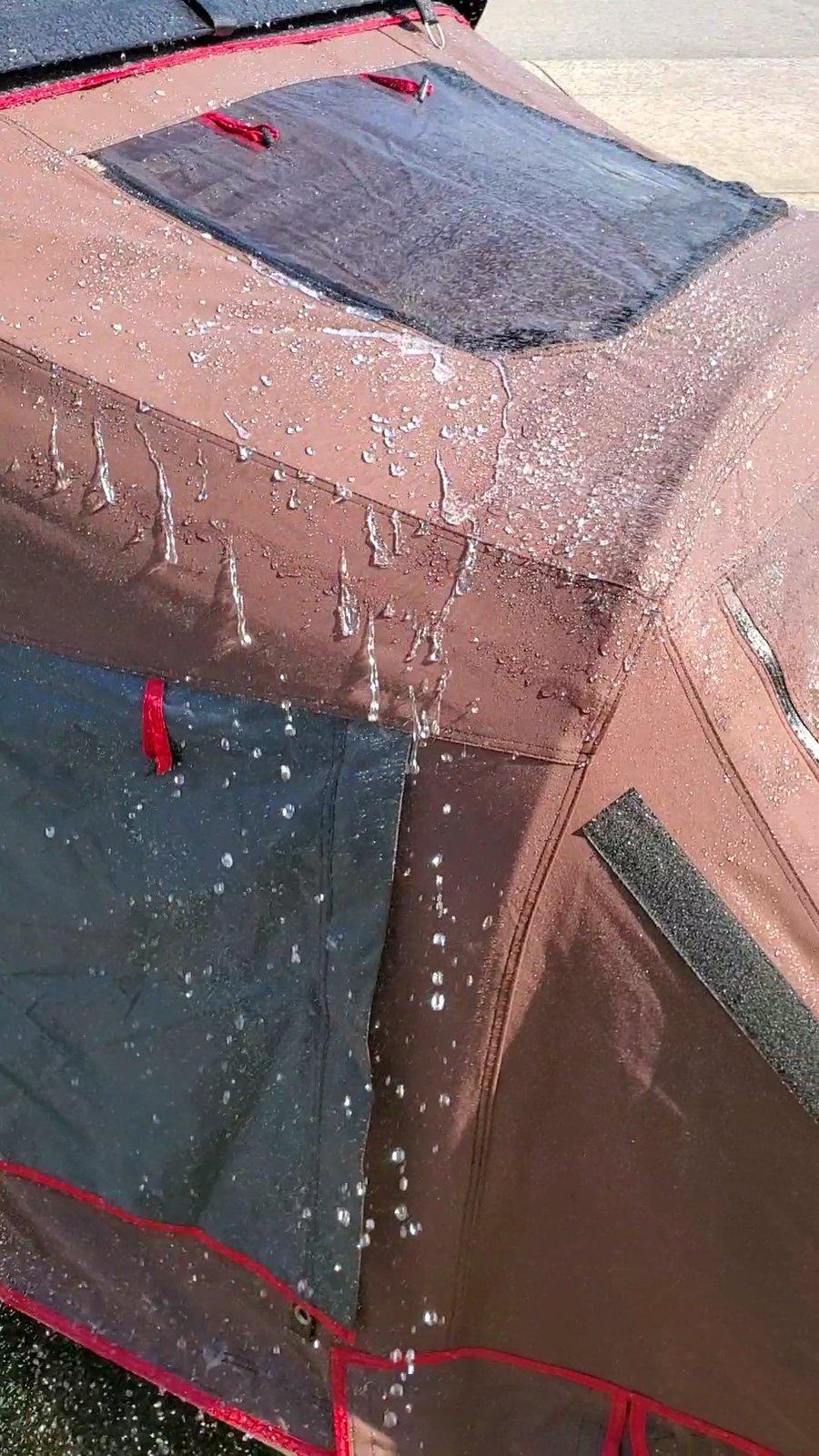

No major updates, but I took the tent out today to weather the fabric. I've had it opened in the garage since receiving it, letting it air out. Today is a nice day, so I'm following iKamper's instructions on initial care.
The fabric is a poly-cotton blend canvas, and supposedly achieves peak waterproofing after being soaked and dried three times. As you can see, the fabric is highly hydrophobic. Leaks inside were minimal, mainly through the zipper up top where water pools a bit on the window. With that being said, this is *without* the rain fly installed, which covers the entire top portion. I had to remove it in order to get the fabric wet, and I anticipate zero issues with it installed, which is the configuration that I will run it in 100% of the time.
I really like the fabric itself. Though it doesn't feel quite as durable as my previous tent (a ruggedized CVT), it seems to be much more breathable. Initial impressions are great, and I can't wait to start spending nights in it. I'll continue to update accordingly.

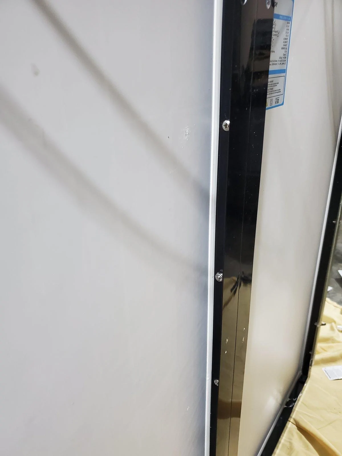

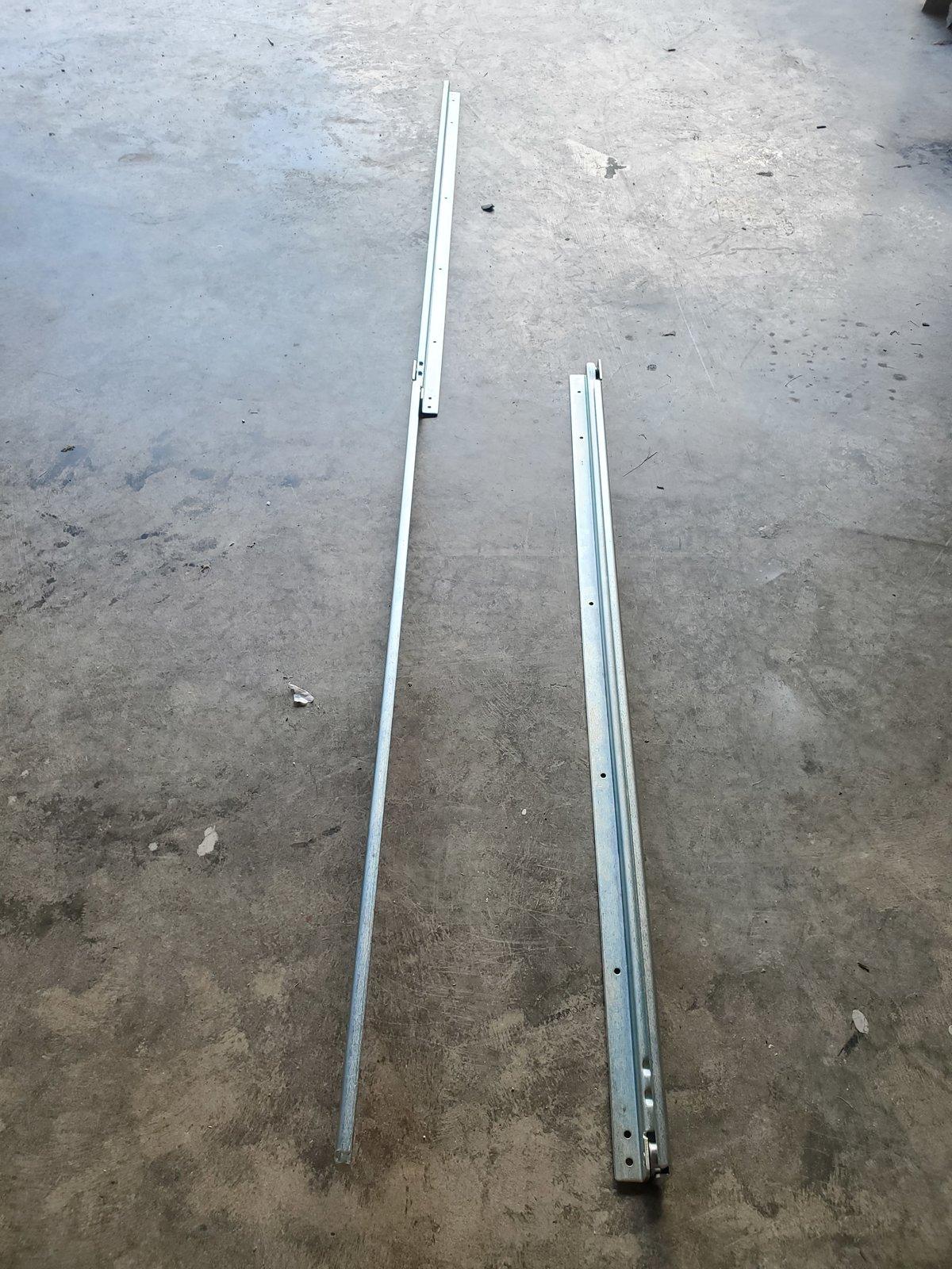

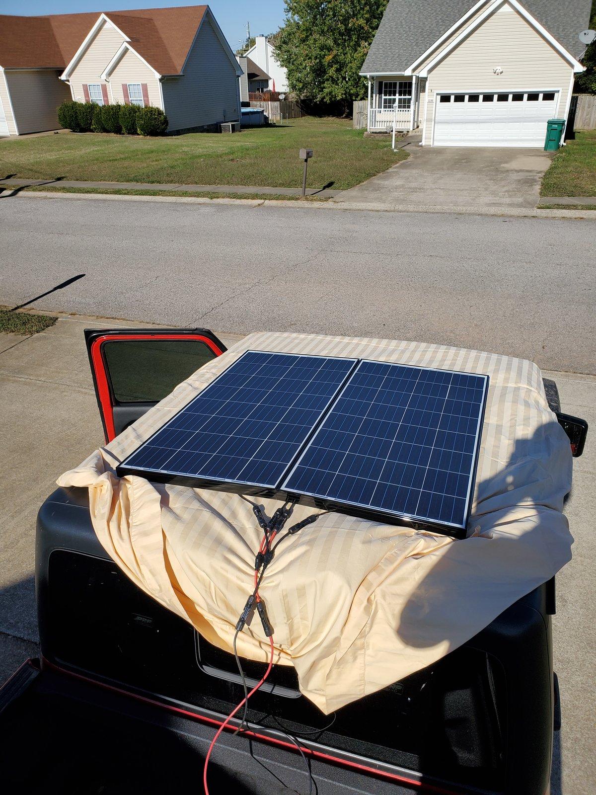

Big update with my big idea. I call it: The Super Secret Solar Setup, henceforth referred to as SSSS. :rock:
The remaining primary parts for building the SSSS came today. After much research, this is what I've pieced together:
Two Renogy 100W panels, with 20ft 10 gauge MC4 extension cables, and two y-connectors in order to run the panels in parallel (pictured while test fitting for width on the roof).
Jeep Gladiator Ares - Build Thread 20201017_151243

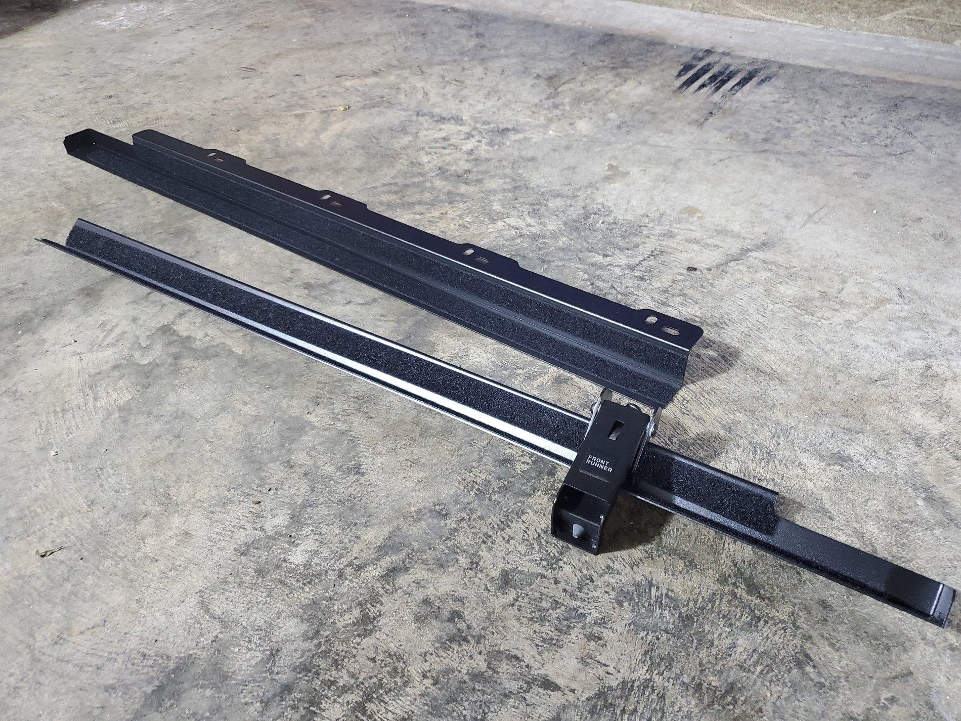

A set of Frontrunner below-rack table slide brackets.
Jeep Gladiator Ares - Build Thread 20201021_181543
Jeep Gladiator Ares - Build Thread 20201021_182749
And a set of slides from a company I found in Australia. Rated for 220 pounds, and designed with fully sealed roller bearings impervious to water, dust and grit.
Jeep Gladiator Ares - Build Thread 20201021_153405
Jeep Gladiator Ares - Build Thread 20201021_154707
Jeep Gladiator Ares - Build Thread 20201021_154831

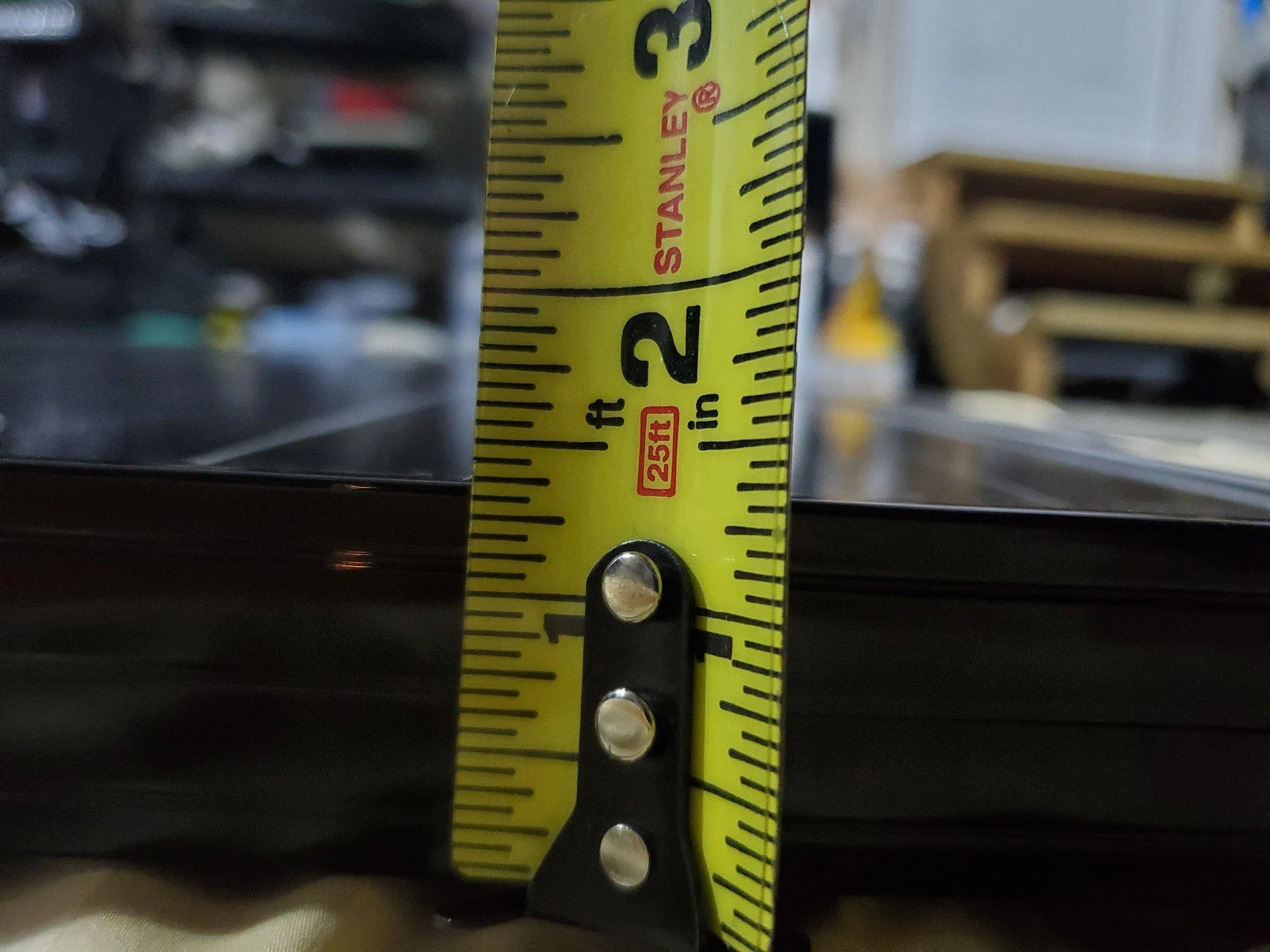

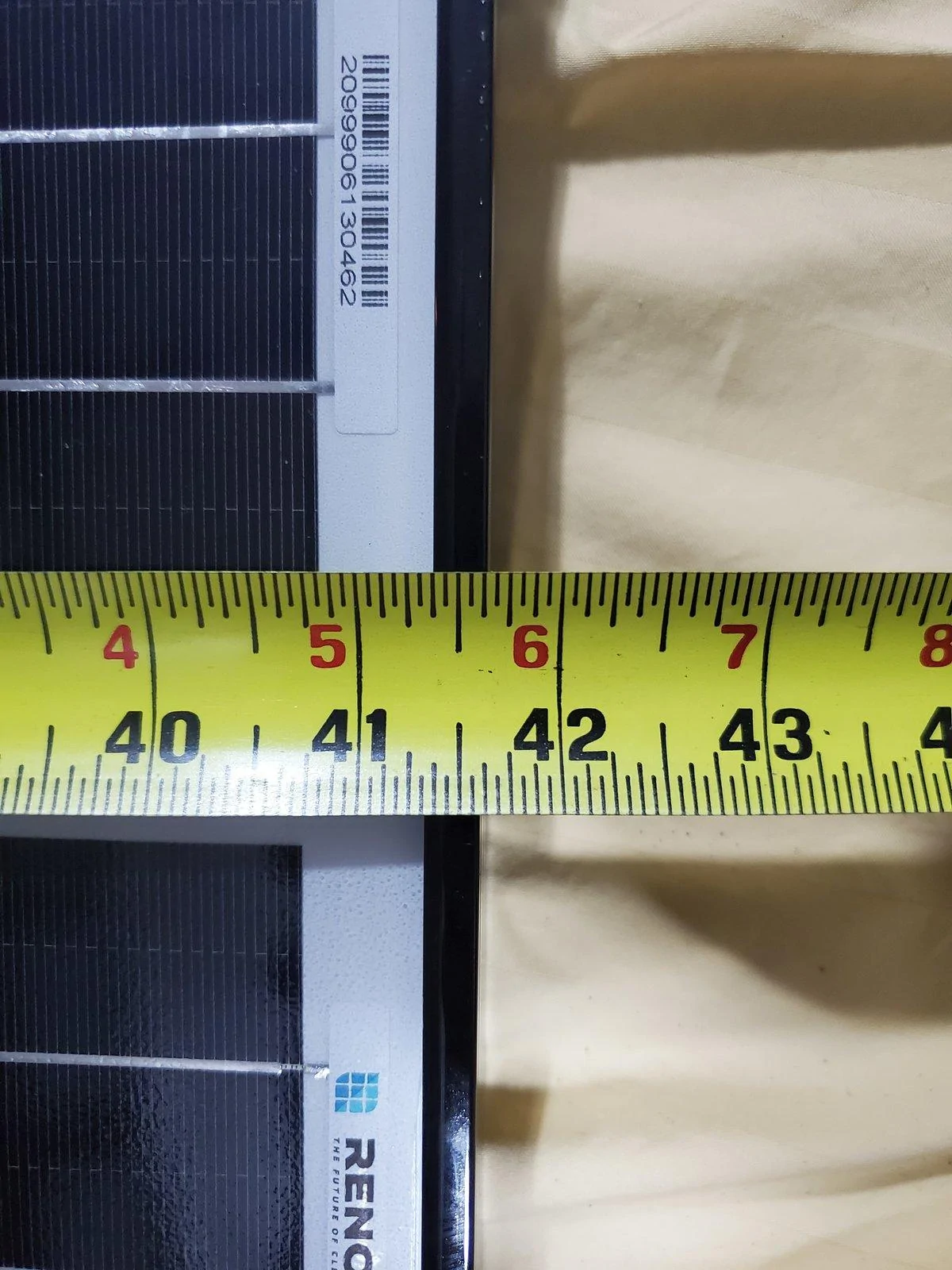

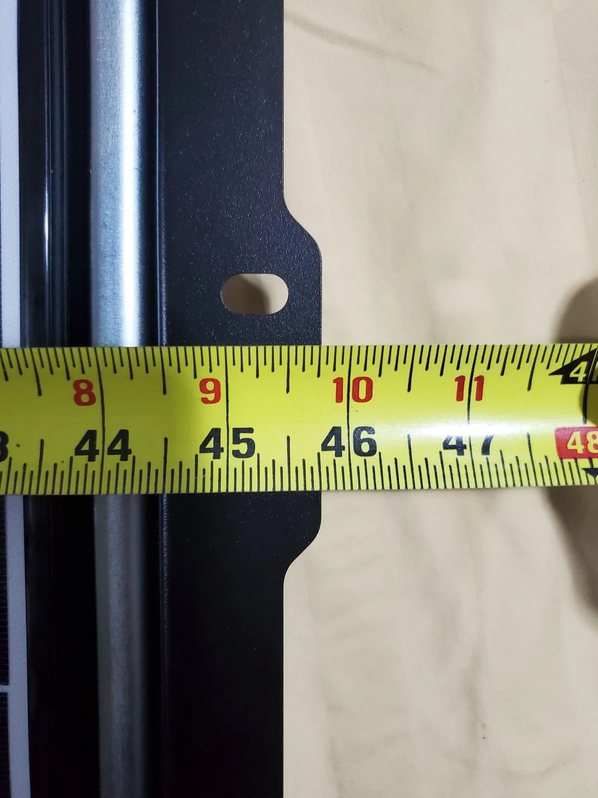

Perhaps from there, you all can deduce where I plan to take this project: The SSSS is a below-rack (the rack over the cab), 200 watt solar panel slide, on a quick-release mechanism. These panels will be bolted together in the middle in order to make them a single rigid panel. Those will then be bolted to the slides on each side, which is then bolted to the Frontrunner table brackets, which will finally bolt beneath my (soon to arrive) Frontrunner roof rack, between the rack and the roof. The panels will be held in place by a Frontrunner locking mechanism that can be padlocked when not in use.
I was able to test fit and measure all of these components today, and with the resulting measurements I'm confident that I can make it work, so here are my findings.
According to Frontrunner, the available space between mounting feet is approximately 46 1/4". At the widest points, my setup is 45 3/4" on the dot. Length isn't much of a factor, as there is plenty of space, but it is approximately 41 1/2" from front to rear. Height comes in at well under 2 inches, so they will slot beneath the rack just fine.
Jeep Gladiator Ares - Build Thread 20201021_182405
Jeep Gladiator Ares - Build Thread 20201021_182449
Jeep Gladiator Ares - Build Thread 20201021_182514
Fitment was my primary concern, and with these measurements well within spec, I don't foresee any issues now. As far as function, I will have them pull out forward, over the windshield/hood in order to maximize distance from the tallest object on the Jeep (the RTT at the rear). They should also throw a bit of shade and help to keep the cab a bit cooler. At 14 pounds a piece, supporting the panels with minimal flex at full extension, on slides rated for over 200 pounds at half extension, should work out just fine. With current measurements, I expect the panels to be within 3" from flush with the front of the roof rack, so at full extension I should get about 93% panel exposure with the sun directly overhead. That is more than enough power to keep my battery topped off running a fridge 24/7, charging gear, and using lighting at camp at night.

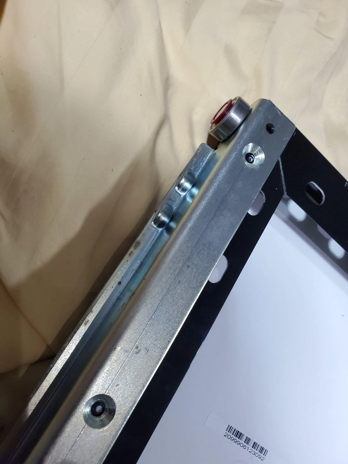

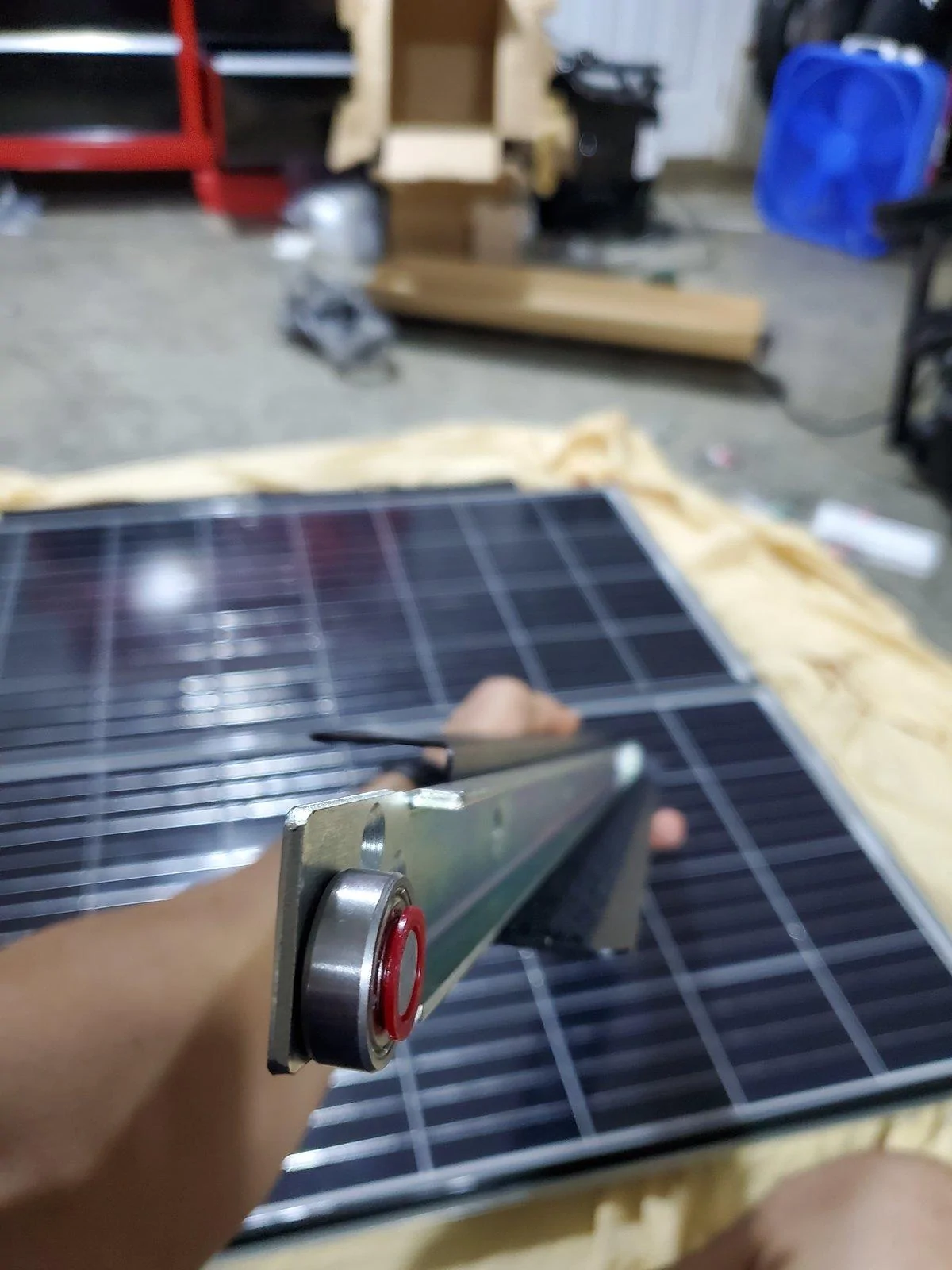

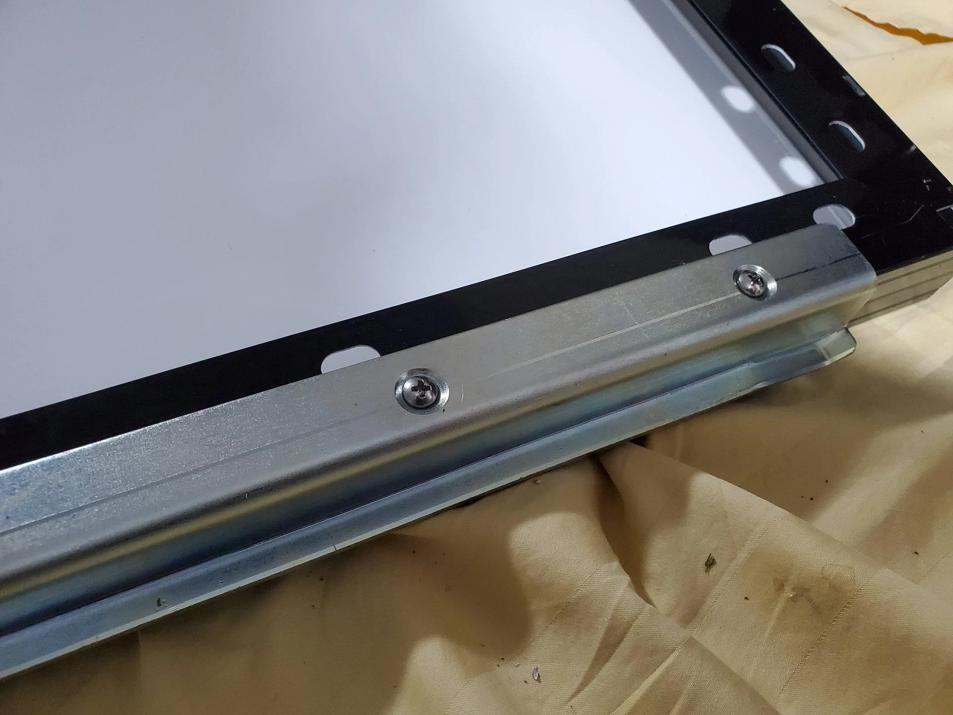

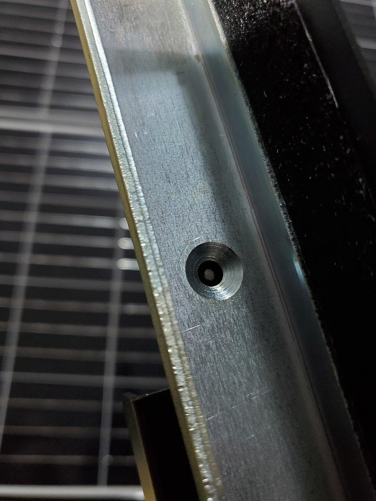

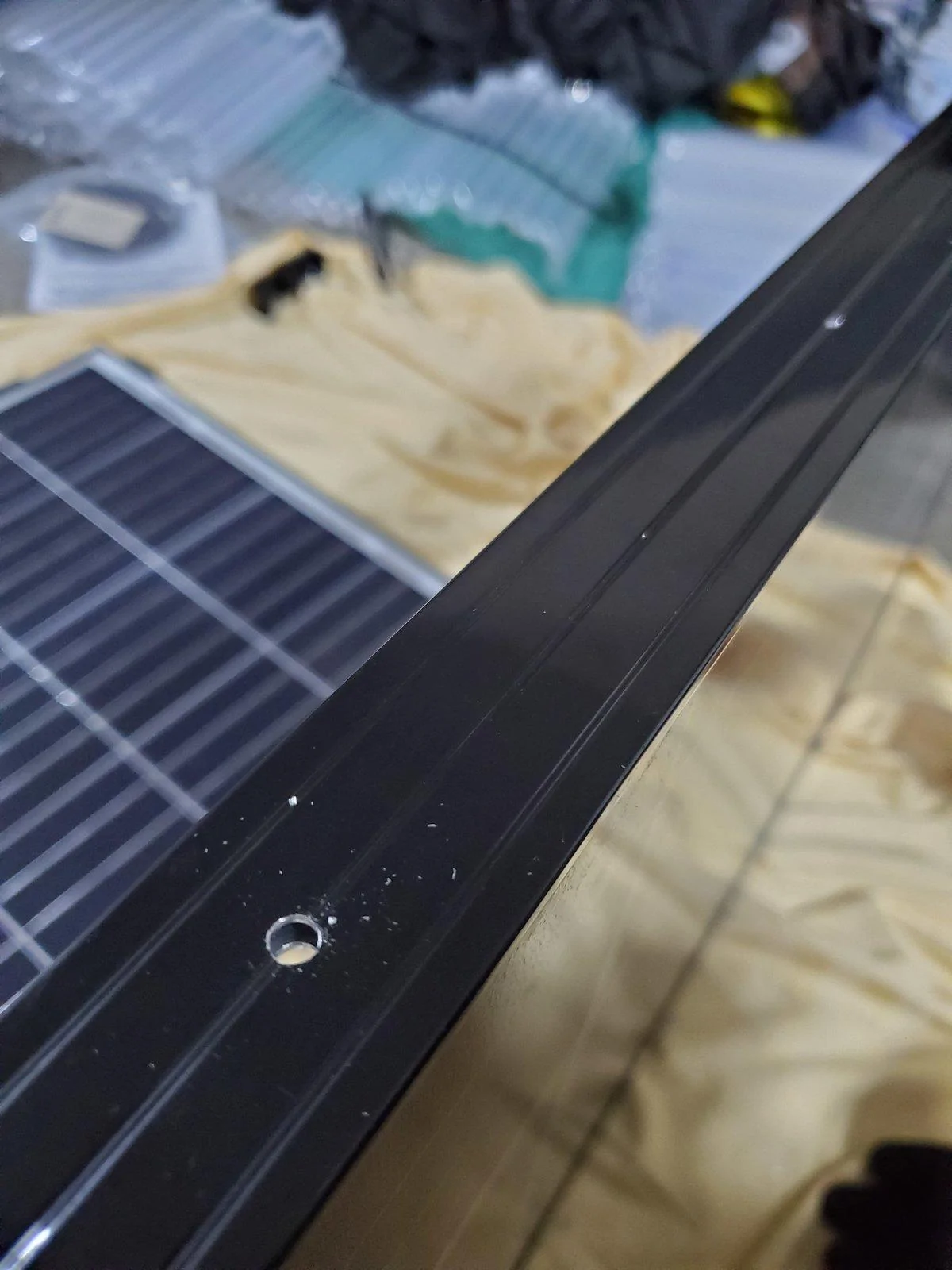

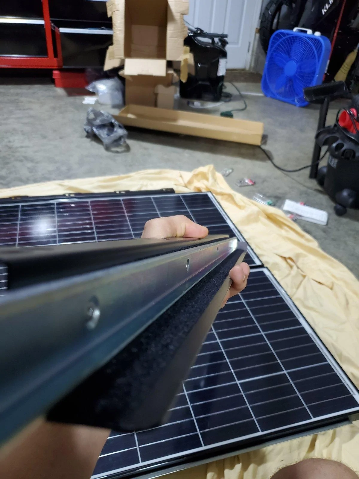

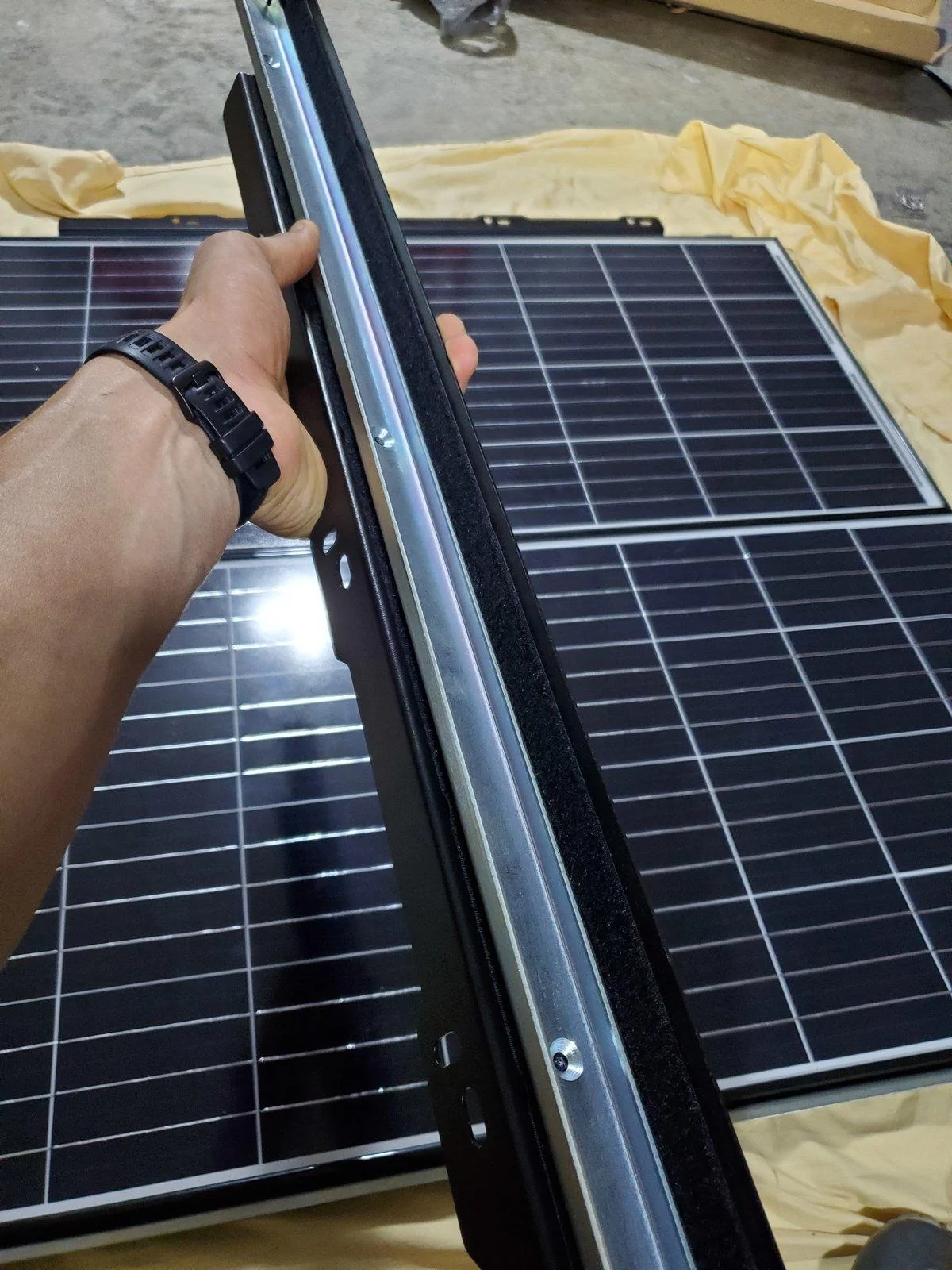

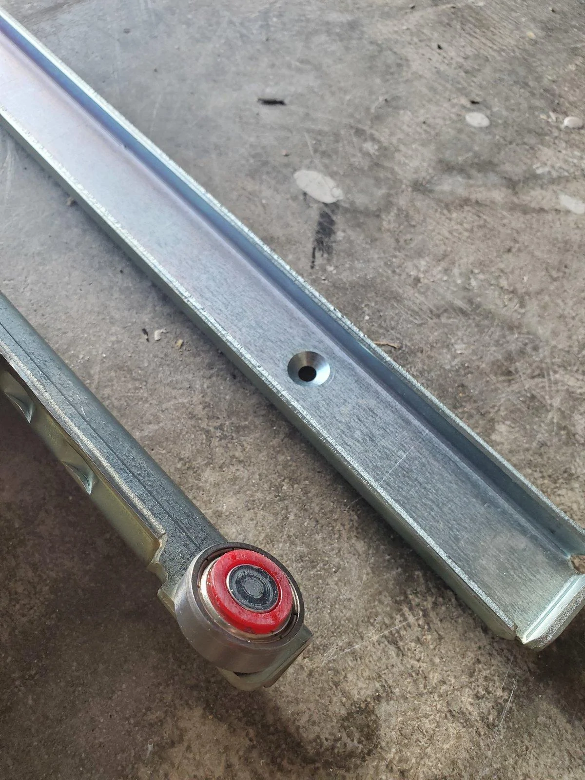

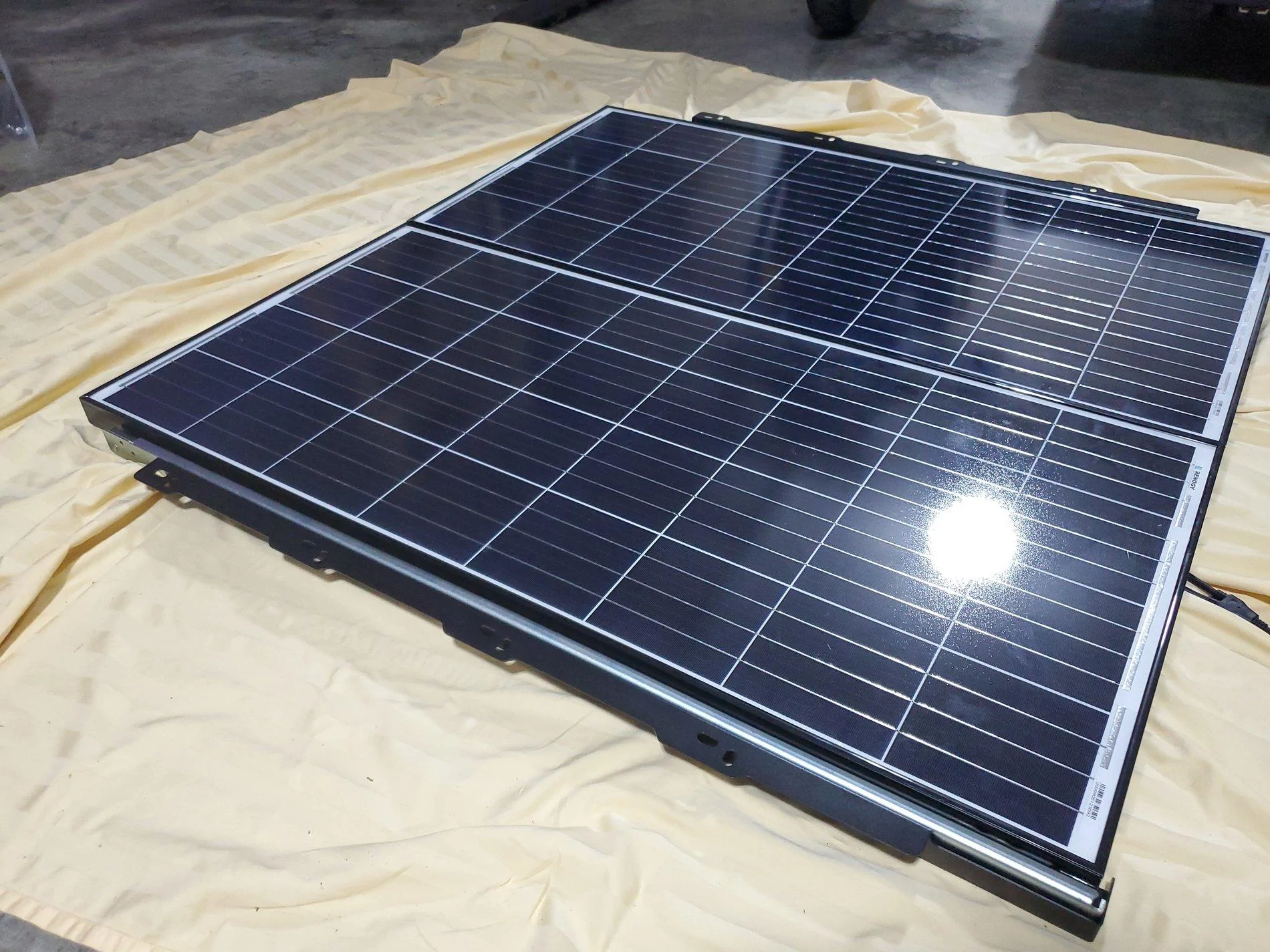

Progress update--I have a working solar slide! Well, sort of. All modifications are complete and it is assembled as intended, but I won't actually be able to truly test it until my roof rack comes in and I am able to mount it, because the whole assembly basically floats in between the outermost rails, so they need to be fixed in place for it to operate. I did a rough test last night by holding the assembly up, maintaining inward pressure (essentially bear hugging the whole thing) and having someone pull the solar panels outwards, and it worked just fine, so there shouldn't be any issues once it is properly mounted.
Nothing crazy needed to be done as far as modifications. The only hiccup was experienced off the bat, where there was insufficient clearance on the back side of the solar panels to line up my nyloc nut. To get around that, I had to drill a larger "access hole" in the side of the panel just beneath each mounting hole. The holes aren't visible anyway with the slide brackets bolted to the panels, so not a huge deal there.
I started off by drilling and attaching the inner portions of the slide assembly to the bottom of the panels. I lined up all of the pieces, and just marked with a paint marker, drilled a small pilot hole, then hit it with a larger bit to accommodate the stainless steel hardware I picked up. The panels are aluminum, so I used stainless hardware everywhere in an effort to limit corrosion.
Jeep Gladiator Ares - Build Thread 20201023_195822
Jeep Gladiator Ares - Build Thread 20201023_215913
Once that was done, I drilled out the Frontrunner table slide to bolt up the outer portion of the slide assembly. This was simple, as the two slotted together nicely. Just like before, a quick hit with the paint marker and I started drilling.
Jeep Gladiator Ares - Build Thread 20201023_224416
Jeep Gladiator Ares - Build Thread 20201023_224423
Jeep Gladiator Ares - Build Thread 20201023_230112
Jeep Gladiator Ares - Build Thread 20201023_230122
The last phase was bolting the panels themselves together in the middle. From the leading edge of the panel, I measured every 6" out to 36", and marked the side of the panels centerline, to accommodate 6 stainless bolts. The panels are, maybe, 2-3 mm from flush, so I'll probably end up pulling the bolts out, and drilling the holes out slightly larger to give it that extra bit of adjustability. It won't limit the function at all, but just knowing it's there will bug me, I know.
Jeep Gladiator Ares - Build Thread 20201023_234612
Jeep Gladiator Ares - Build Thread 20201024_004137
All in all, I'm very pleased with how it turned out. I'll probably end up affixing some small rubber stoppers/isolators either at the rear inside of the tracks, or a single larger one up front, because based on measurements I'm expecting the front of the panels to be about 3 inches away from flush with the front of the rack, and I need it more or less flush so that I can lock/isolate the panels while driving. I will wait until my rack arrives though to make that adjustment. I'm looking forward to getting it mounted up for an actual test run next month when my rack arrives.
