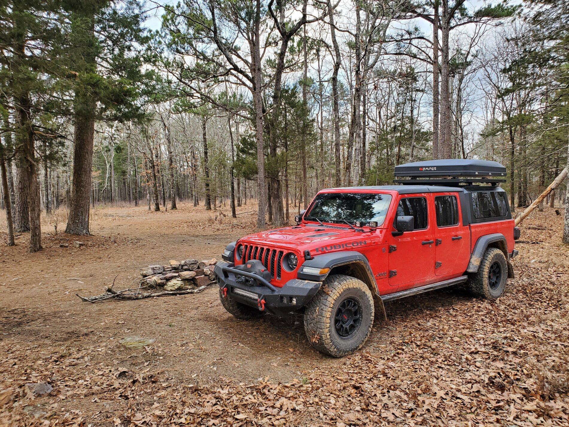

I implemented some improvements to the solar system. Spoiler alert: No more sagging/flex!
I still haven't gotten around to plugging it up and doing testing in the shade of the rack, so that is something that I need to do. It's supposed to be pretty nice tomorrow, so I may grab my cables before heading in to work so that I can do some tests in the parking lot while I'm working. Once I route the MC4 cables from the roof in to the bed and actually have everything hooked up nicely, I'll probably put together a walkaround video of the entire setup, from the panels, to the input, to the charge controller, to the battery. I think it's a pretty unique setup, so maybe someone would appreciate it!

New video up!
I had been considering going the sliding bed route for some time, and after my shakedown trip, having to climb over my fridge in to the very back of the bed to access things numerous times, kind of drove the point home. I came across the Cargo Glide (1000-5842) for a pretty good price and pulled the trigger. It's their base model, with about 70% extension and a 1000 pound capacity. Quite pleased so far. Check out the video if interested!

Side note: My next update will probably be a complete walkaround of the build as it sits right now. I have one more thing to accomplish before I want to do that, which is drilling out the racks, and installing/wiring up all of my marker lights for the roof racks. I've added a LOT since doing my last build walkaround video back in August. Look for that in probably the next 2-3 weeks or so.

New project; new video!
Just a small one. I got around to installing the clearance/running lights on the roof rack. That's the last electrical project that I had in the works for now!
I'll probably get out and do some filming for an all-around build update later this week. Keep an eye out if interested!

New video is up! If you're interested in a pretty in depth walkaround of just about everything that I've done to date, check it out!

I wanted to ask: how much height to measure to the top of your mounted tent (in the stowed position)? I’m wondering if that setup would fit in my garage.
Thanks!
