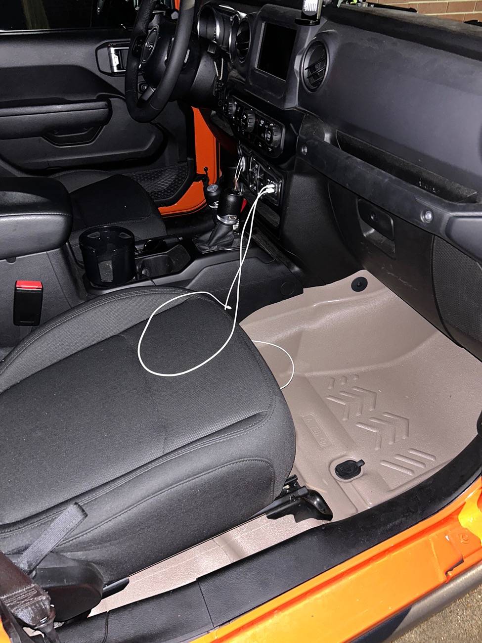

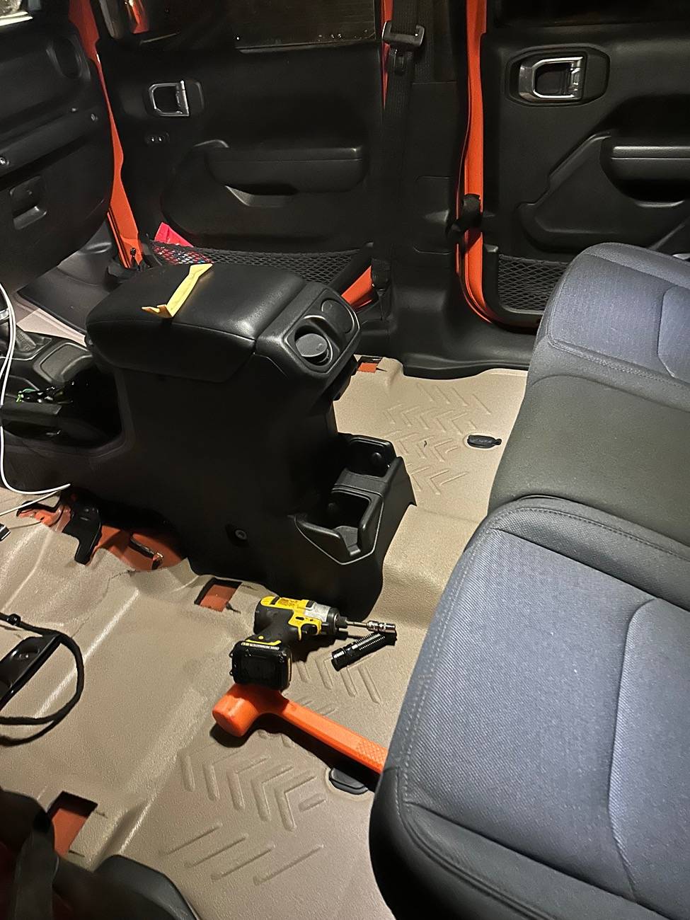

I got my flooring installed. I think the contrast between the black interior and desert khaki ( tan ) looks nice!
