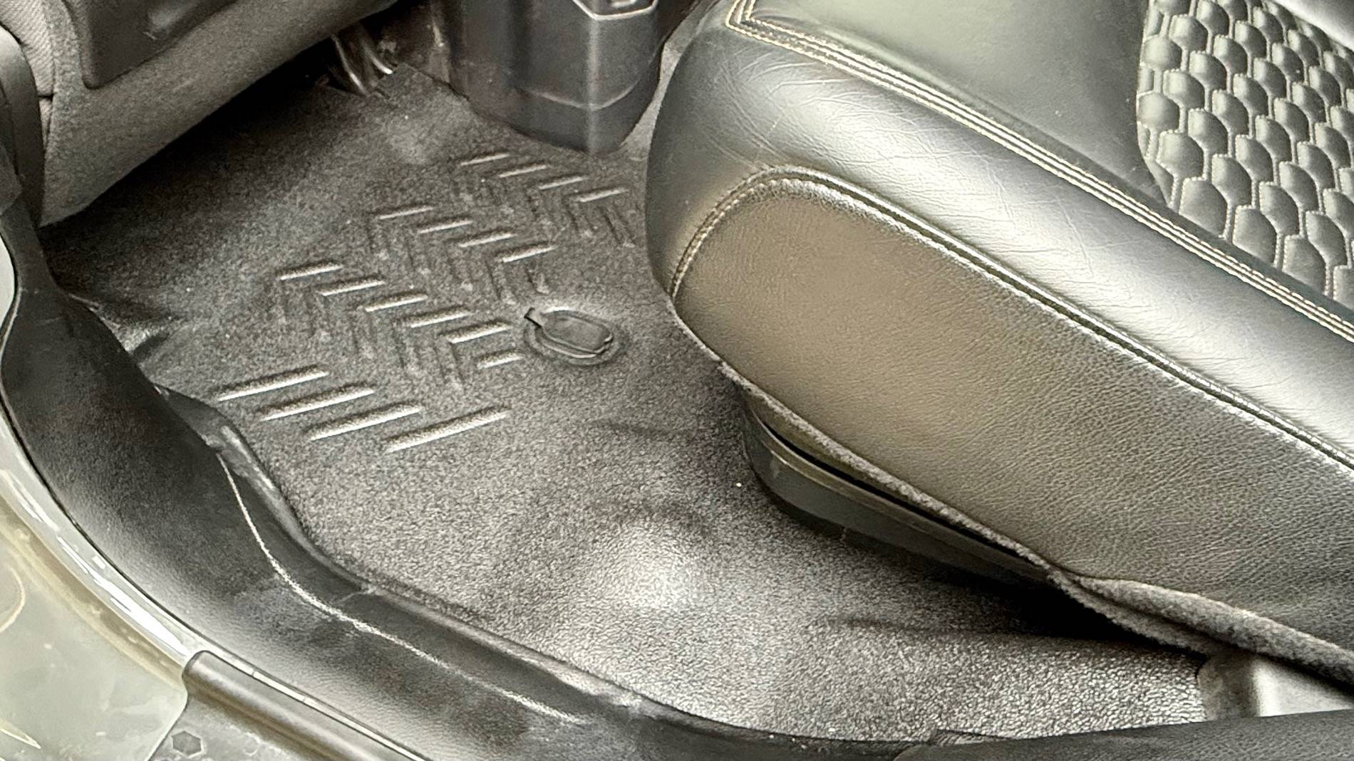

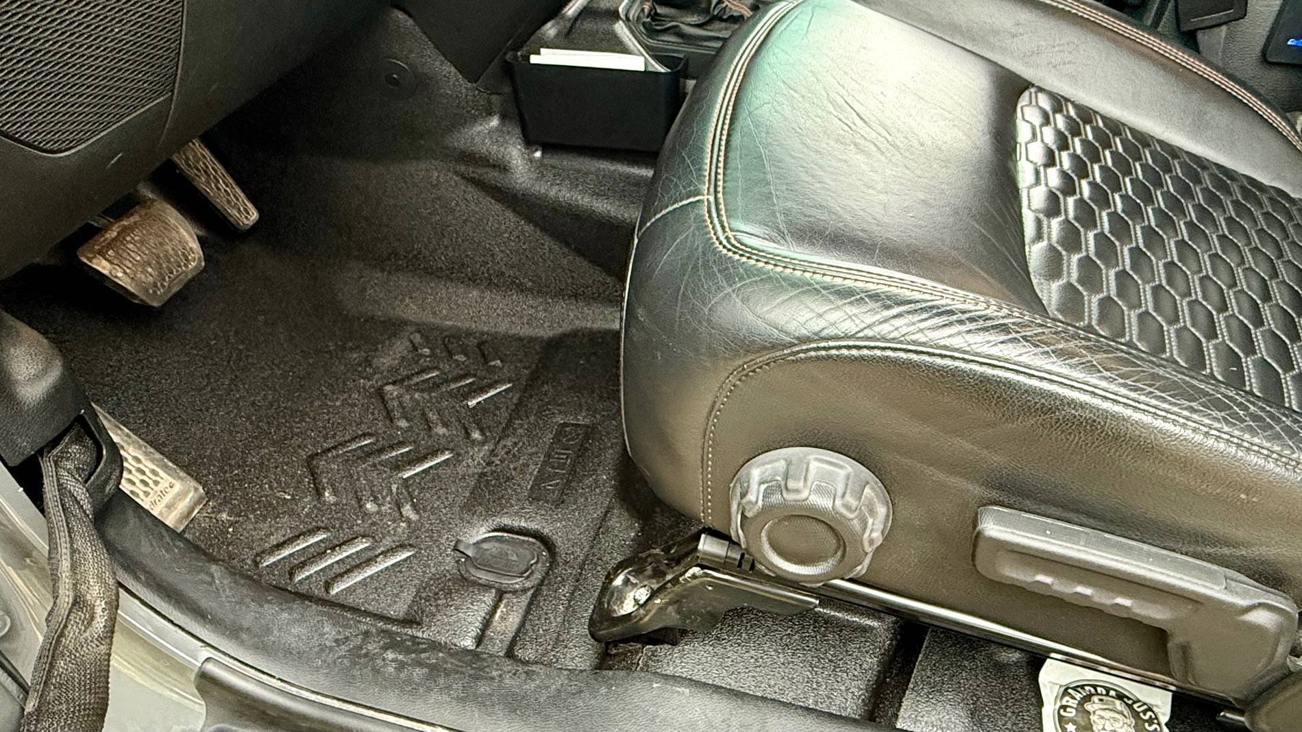

Had mine installed and picked up just last evening. I knew I should have done this long ago. I absolutely despise carpet in my offroad vehicles. I have yet to find even a single complaint and I did read through this entire tread. Maybe in due time, but not likely (hopefully).
Jeep Gladiator Armorlite regrets? IMG_0268
Jeep Gladiator Armorlite regrets? IMG_0269
