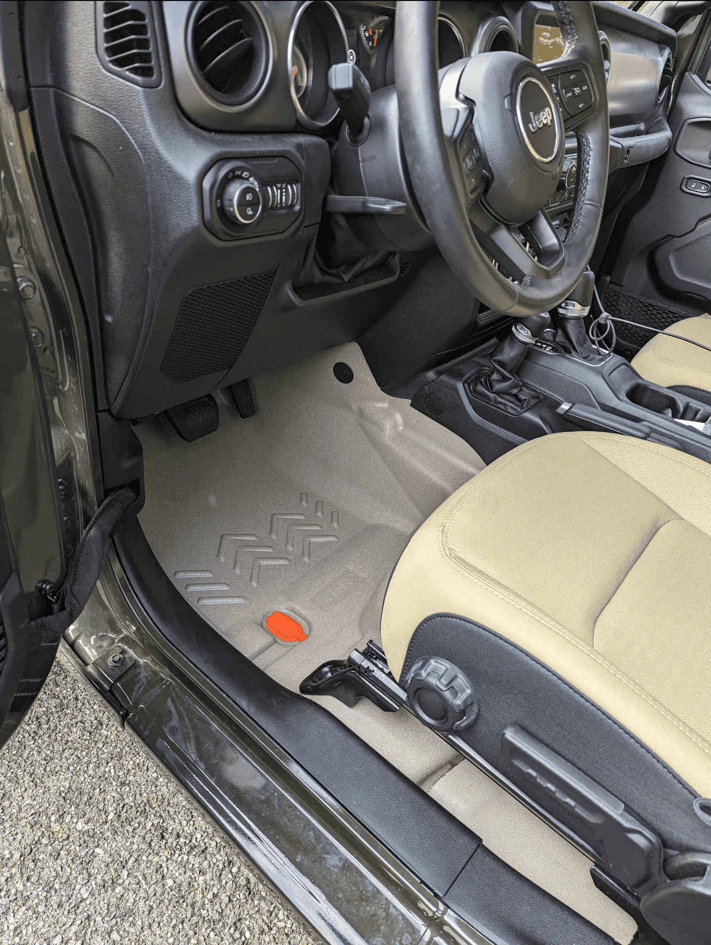

And she's done. Couple hand cuts and new words discovered. Love how it came out

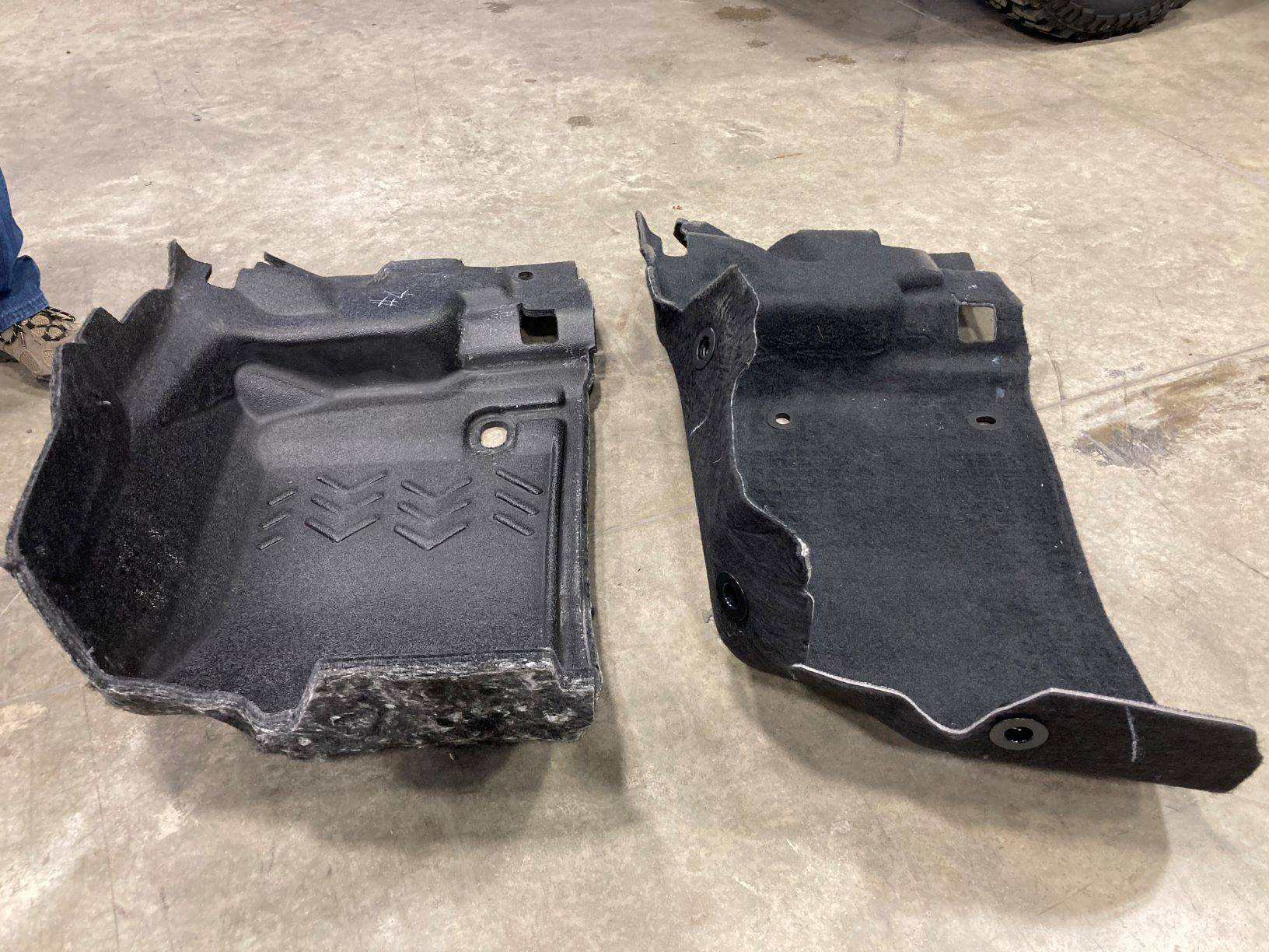

I've got no dogs in this fight but at least at first glance it appears the Armorlite would be significantly better at sound reflection and adsorption compared to stock as well as Bedtred, even with butyl/alumn. sheets.
Without too many words, since there are a lot of caveats even to my POV, a big part of sound deadening is trying to find a proper amount of material to reduce a specific frequencies penetration into our trucks. Lower frequencies need thicker material to reduce, road noise is usually stated be in the 1000hz range. That's fairly low and would require a pretty reasonable material thickness to treat, like >2-3" thick. That doesn't mean that thin butyl/alumn sheets don't help, but most are <1/8" thick.
Anyway, these pictures should give a pretty good idea why the Amorlites would appear to work better than stock and likely Bedtred, which appears to be even thinner than stock, which has foam coupled to the back of the carpet.
Stock vs Amorlite:
Bedtred (taken from the JL site):
Personally I 'd go Armorlite and toss some butyl/alumn sheets in as well. If the goal is simply to have a more durable surface, both Bedtred and Armorlite would likely surpass stock.
If cost is the primary concern, Bedtred does win there, if you throw out spending nothing and keeping stock, lol (no ones going to do that).

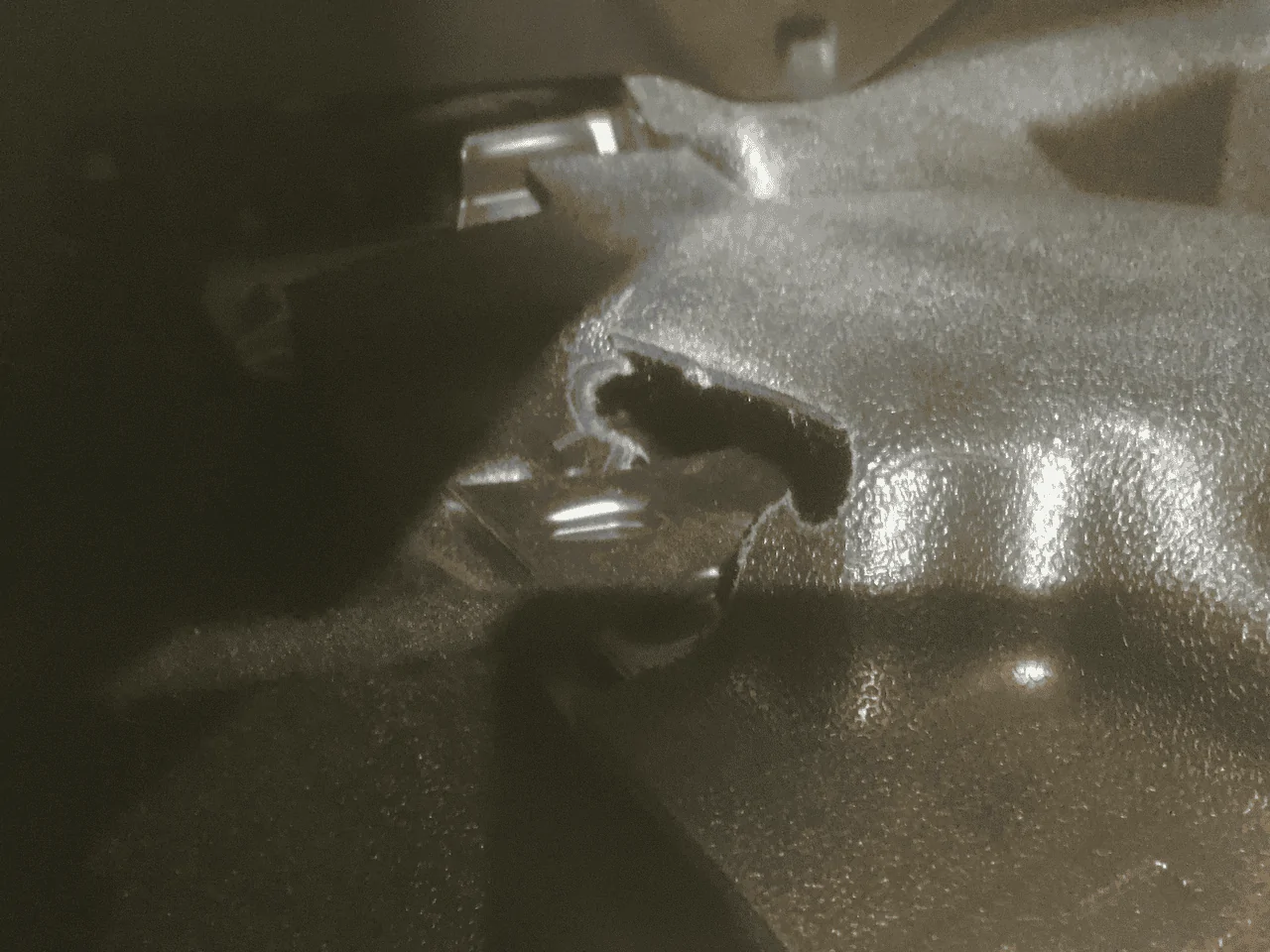

I regret not knowing the following before doing the install last week:
1.) For the under seat ducts in both the factory carpet and the Armorlite flooring there are oval holes with relief cuts at the round ends of the ovals to allow the ducts to pass through. On my front passenger side Armorlite the relief cuts were shifted relative to the oval. So much so that although the cuts on the door side were there, the relief cuts didn't make it all of the way to the oval. I didn't notice this until it was installed, and was wondering "Why are the wires going to the passenger seat getting mashed like that?" It was easy enough to complete the cuts, but would have been easier to do before it was installed. Not the most clear picture, but you can see the center console side cuts and resulting flap, can just barely make out the cuts on the door side. This is before I fixed it:

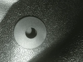

4.) When installing the front pieces, have something small and thin that can fit through the holes for the carpet posts. I used the smallest little ignition wrench I had, or something like a paint can opener might work. Once you have the Armolite under the pieces of trim and onto some of the carpet posts, finding yourself looking at this:
Jeep Gladiator Armorlite regrets? IMG_2055
Lets you stick the tool in the hole, grab the edge of the post enough to lift / shift the Armorlite the rest of the way into place.

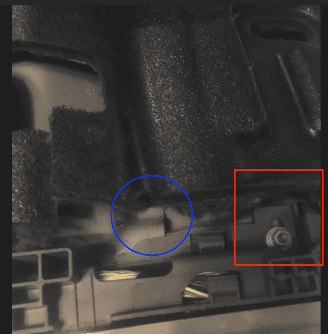

5.) When installing the drain plugs, not only does the drain plug opening in the Armorlite need to be centered on the opening in the metal floor, but the Armorlite also needs to lie flat against the metal floor. This is where I had the most struggle with the passenger side front because as it sat there, the drain plug hole in the Armorlite was raised up above the hole in the floor. Even when I did get the drain plug installed enough to hear the "click" of the drain plug snapping into the metal floor, stopping forcing the Armorlite down allowed it to pop the drain plug back out. The two places where there was interference causing it to not lie flat are highlighted below:
Jeep Gladiator Armorlite regrets? highlighted
(There is a really big socket jammed under the flooring propping it up for this picture.) In the red area there is a bump out in the metal floor for that stud that the wiring chase / trim clips piece attaches to. There is a corresponding bump out in the flooring. Problem was that when the drain hole was centered and pushed down to the floor, the bump out in the flooring was riding way up on the bump out in the metal floor.
In the blue area there is the "cross rail" that runs between the door sill area and the center console area that the front bolts of the seat rails bolt into. The flooring has bends to get up and over the cross rail, but it doesn't have a bump out for that side part of the cross rail in the blue area.
I ended up peeling away most of the underside padding in these two areas. That allowed the flooring to lie closer to the metal floor, and the drain plug to stay in place once installed.
I suspect that there are manufacturing tolerances when the pieces that make up the floor are welded / glued together. I'd guess that the piece with the drain hole in the floor was shifted towards the door, while the cross rail is shifted towards the center console. I didn't have any issues installing the driver's side front flooring, and although I didn't measure it on the driver's side that cross rail section bump highlighted in blue didn't seem as if it protruded as much into where the flooring wanted to sit.
