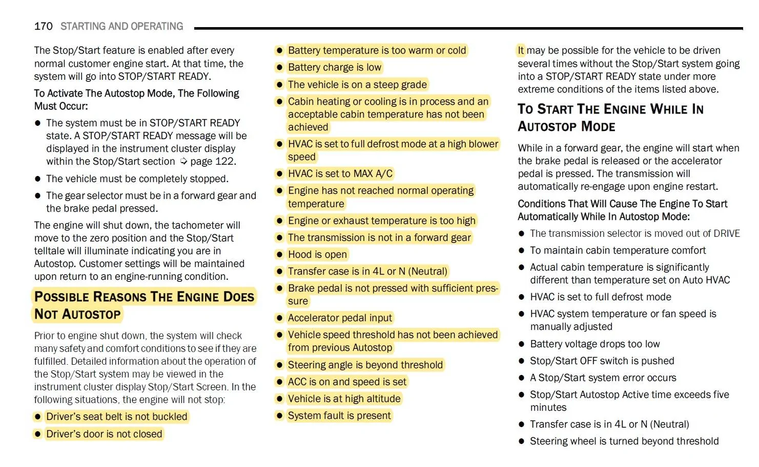

There is a big list in the owners manual of things that can keep the start/stop from engaging.
Next to battery condition, people overlook during the summer months that having their A/C on Max will inhibit the system.

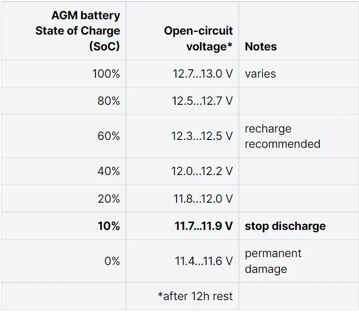

Volt meter (anything that can read down to the tenth of a volt with reasonable accuracy - doesn't need to be a $300 + Fluke)
Test voltage at main battery after the truck has sat for a few hours - not running. Volt meter leads on main battery posts.
Test with engine running - likely will show similar to cluster voltage display but I've found sometimes a bit of difference - not sure where exactly they sense the voltage from.

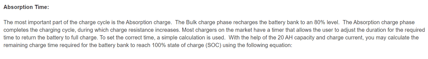

If it's low - say 12.4, I'd charge both batteries with a decent charger of at least 10 amps. Let it go through all 3 charging phases. Yeah, it's not like let's throw a voltage at it and push it full. A good charger will charge an AGM with 3 phases. There will be various times of constant voltage and times of constant amperage, declining voltage and so on. It can take hours so be ready for a time where the truck can sit.
If you can - IF - leave the batteries disconnected after the charge. Check voltage to ensure they made it up to at least 12.7-12.8 volts. Mine make it to about 13.0 then settle to 12.8 after an hour or so.
Let them sit about 6-12 hours if you can and check voltage. If, disconnected, they are no longer reading 12.7, it's not good. Capacity is gone, they are self-discharging too fast.
If you don't have time to let it sit like that, reconnect and check later but know the parasitic load of the truck systems will draw batteries down. But if they have decent capacity, they'll still stay up there 12.6 for quite a while.
Yes, that for sure - max AC - but it will work with normal AC. Just not max. I've got a tech doc showing over 20 factors that will never show up on the screen as a reason as well.
So if you run max AC, ESS won't work as it figures "I can never fulfill that request" and won't shut off.
IF you run in auto mode or just plain AC mode, it will work ONCE cabin temperature is reached. If you set it to 70 degrees you may see stops/start not ready, cabin heating/cooling" or similar, but once it reaches that 70 degrees as far as it is concerned, it will trigger ESS if all of the list of other factors match their true/false criteria.
