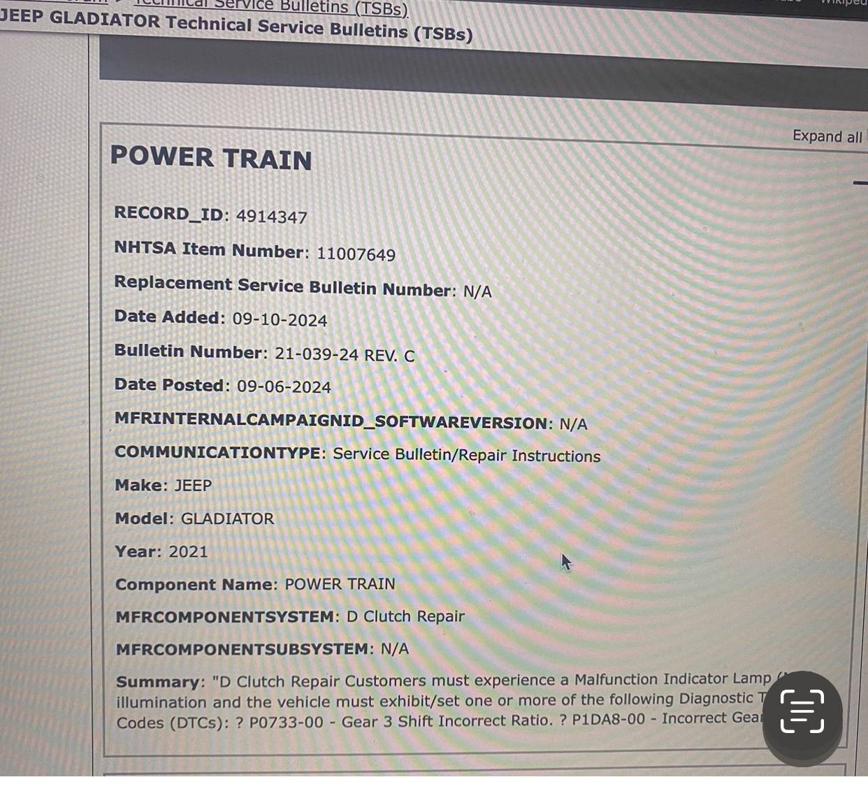

It will continually get worse. Is not normal.
Luckily you have a long time left on your powertrain warranty. As soon as as you get an error code get it to the dealer. D clutch is bad. They are now rebuilding these and not replacing. This is the latest TSB.
Jeep Gladiator Autotrans clunks sometimes. IMG_8218
