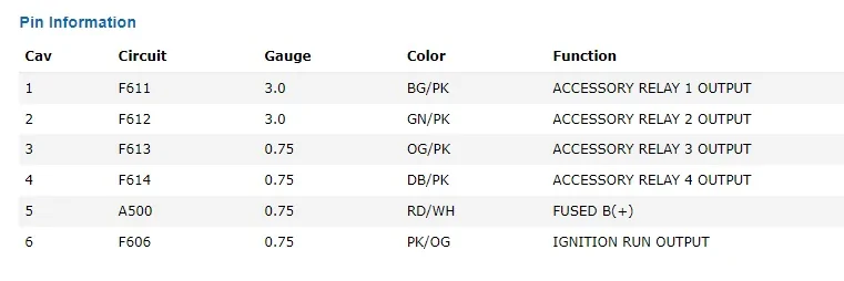

FWIW, they use a metric wire gauge system on our Gladiator.
0.75mm would equal a 19 AWG but 18 AWG size would be more standard.
3.0 mm falls in between 12 AWG and 14 AWG. I would always error on the larger 12 AWG.
Park, turn and DRL on these are .75 which I find ironic as it's a lot heaver than was used for standard lamps in the past. Normally they would be 16 gauge at best. 14 was not common in older lighting.
