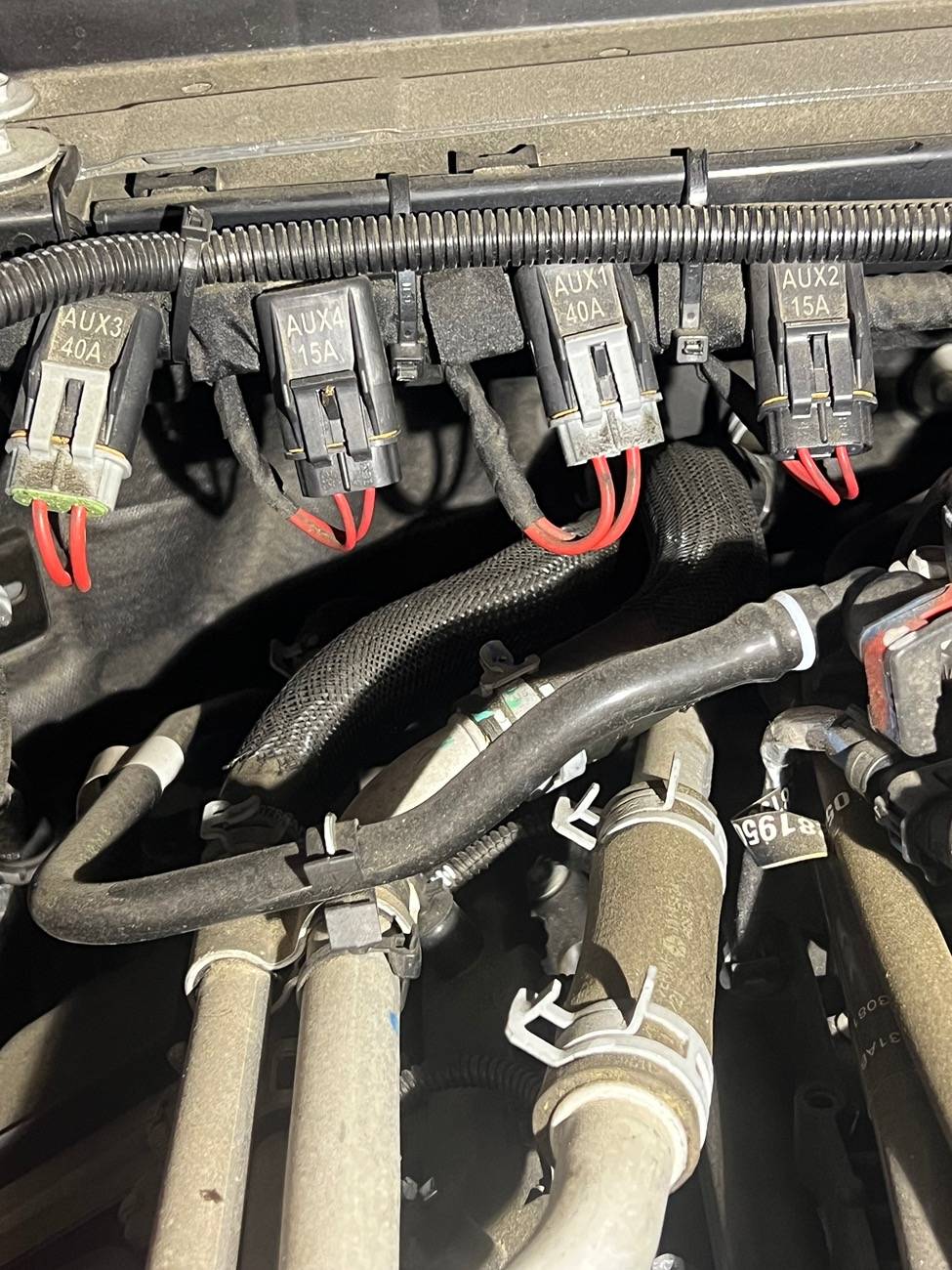

This is from under my Mojave hood.

All 4 aux switches actually control relays, so using an aux switch wire you are running the accessory through a relay in the PDC.
The Black Blue and White wires indicate a lighted toggle switch with the lights he bought.
I'd skip their harness, ground the lights and run power for the lights from aux 1 or 2 (those are 40 amp)
3 and 4 are 15 amp capacity.

Assuming the leads from the lights (5) EACH have a ground and a power wire, you would run the ground from #5 together to one wire, then over to the ground stud next to the battery (on the fender)
Run the two power leads (one from each light (#5) over to the lead that goes to one of the 40 amp capacity aux switches.
So you'd take the location at 5, and turn those into one each of power and ground.
Ground to the fender stud next to the battery
Power to one of the aux switch leads (also next to the battery, taped up between battery and fender)
