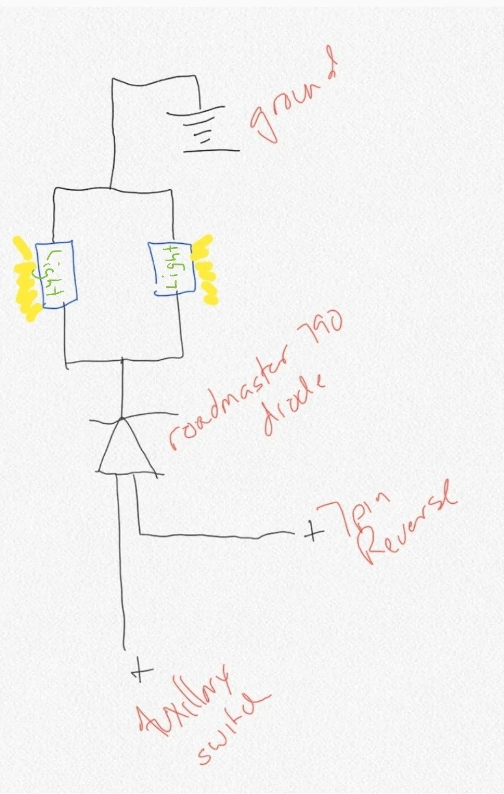

Here is the harness I have and how Rigid said to wire. Does this help?
I know this is wiring for a 3 position switch. 1-On/2-Off/3-On in Reverse.
I'd like the auxiliary switch to be used for #1 and I'd like #3 to happen when I shift into reverse. Position 2 is not really needed.

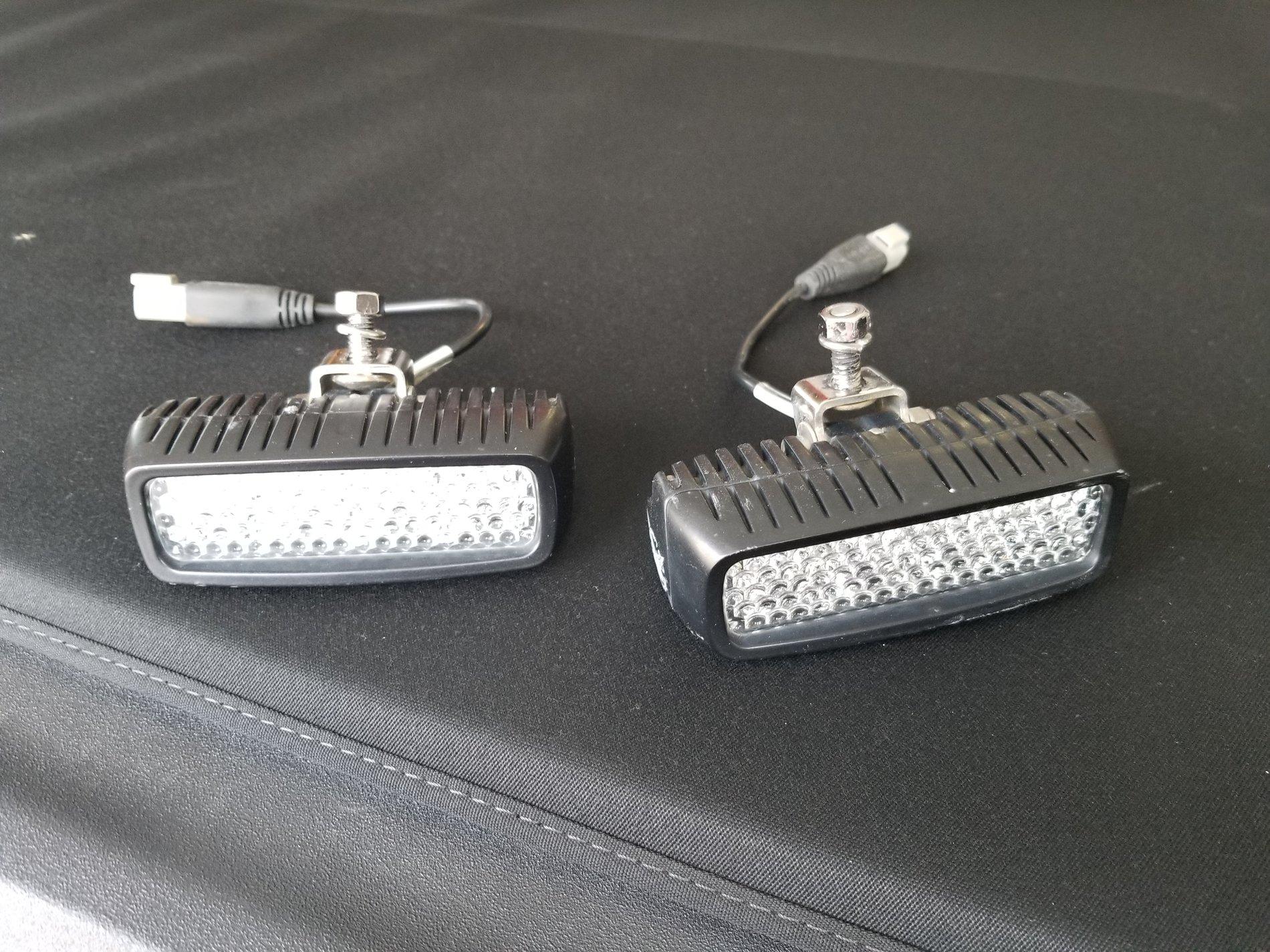

Well, here's my write quick write up. This project was pretty easy overall. Just to recap, I had these Rigid LEDs mounted on my F150 that I removed before trading it in. The kit came with a wiring harness that including a relay and 3 way switch that was not needed for the Jeep.
Here's a link to the lights Ih
https://www.rigidindustries.com/sr-q-series-pro-flood-diffused-backup-kit-surface-mount-980023.html

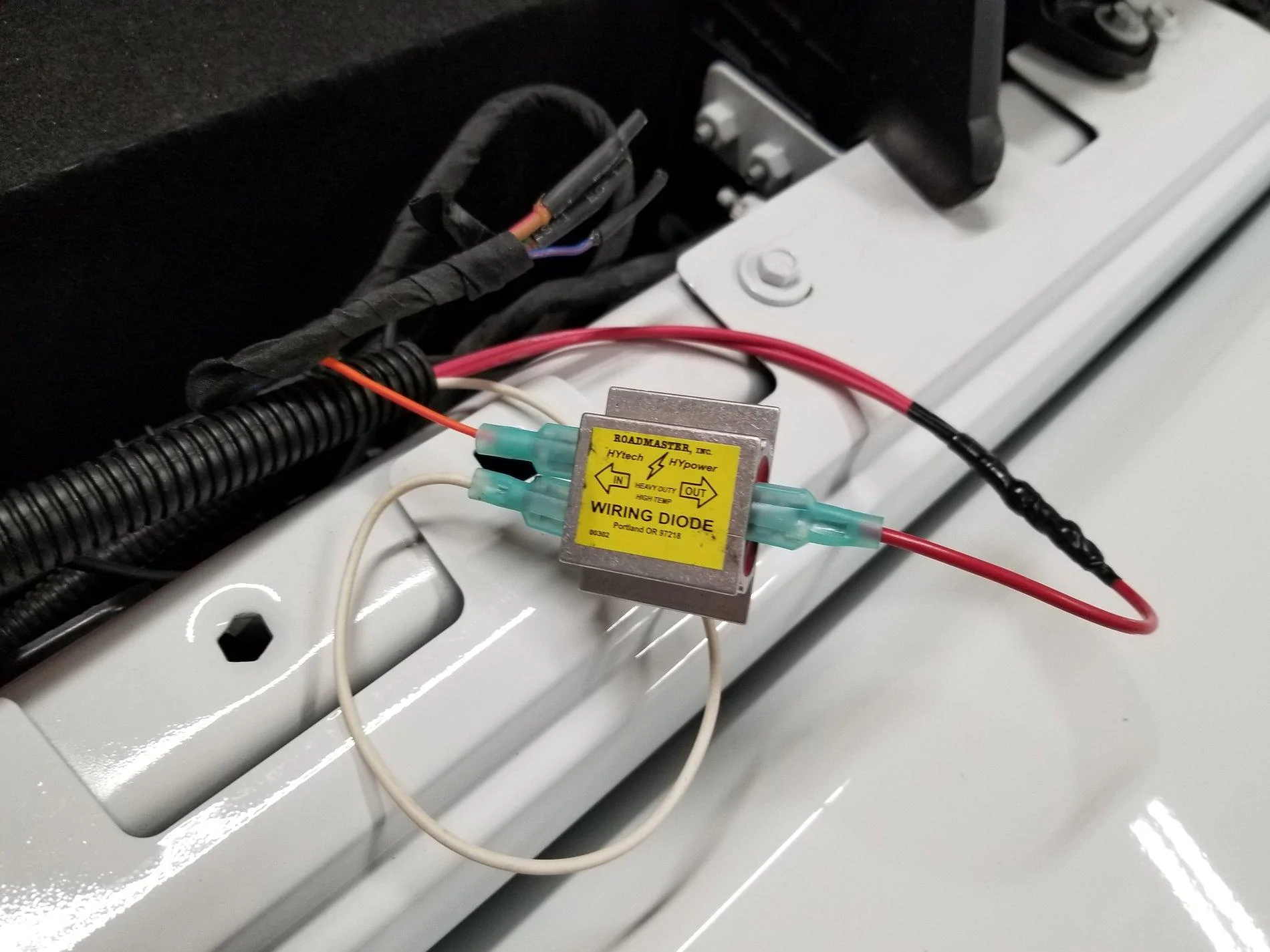

Here's the diode needed to accomplish this project:
https://www.amazon.com/gp/aw/d/B007HRO564?psc=1&ref=ppx_pop_mob_b_asin_title

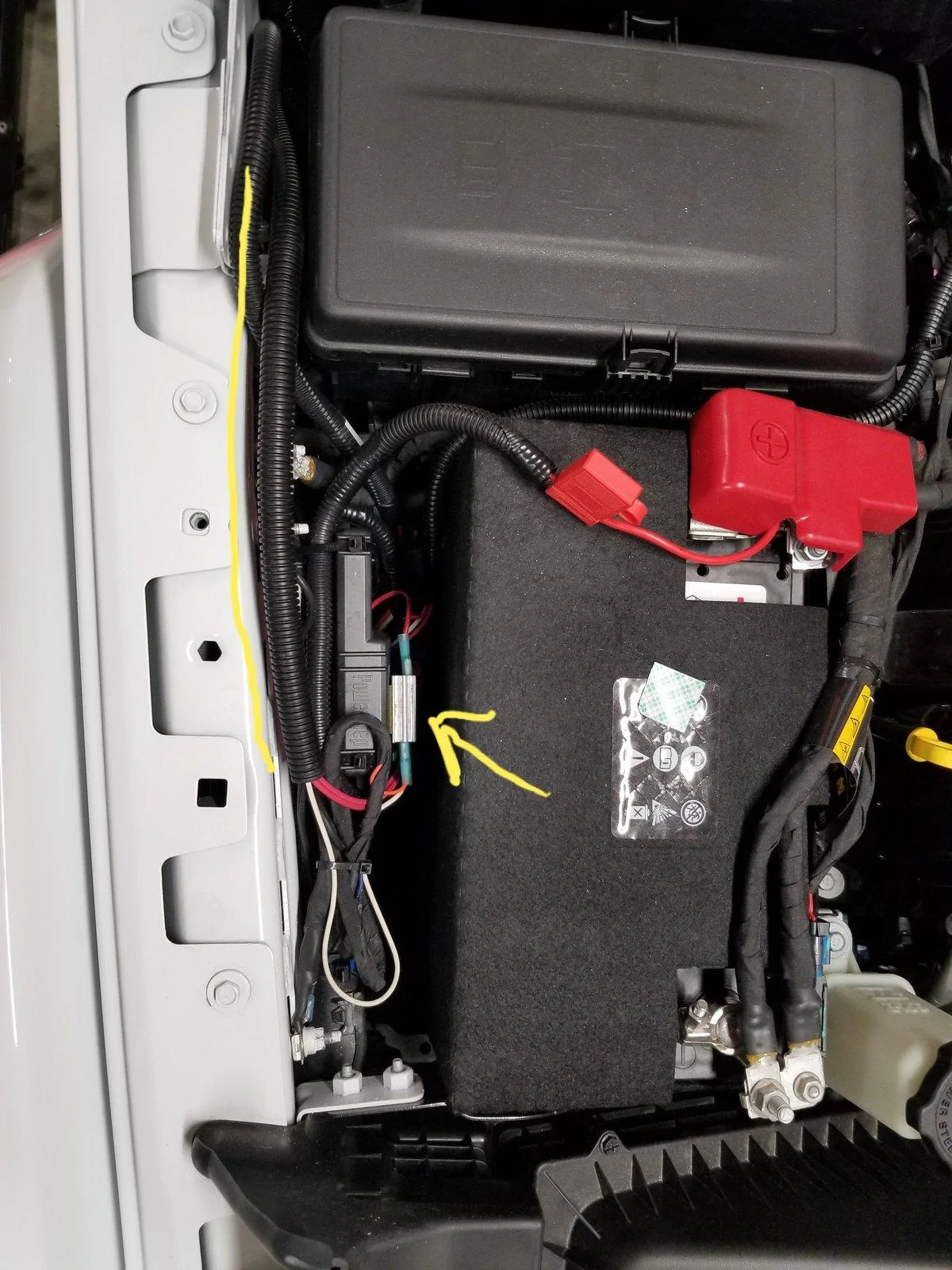

Before I ran all the wires nice and neat, I ran the harness on the floor next to my truck and tested the wiring.

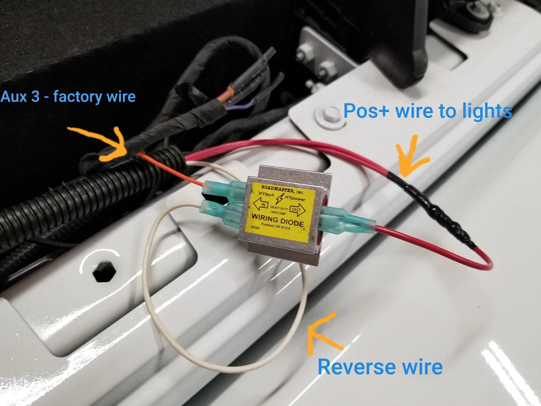

Here's is how I wired up everything under the hood.

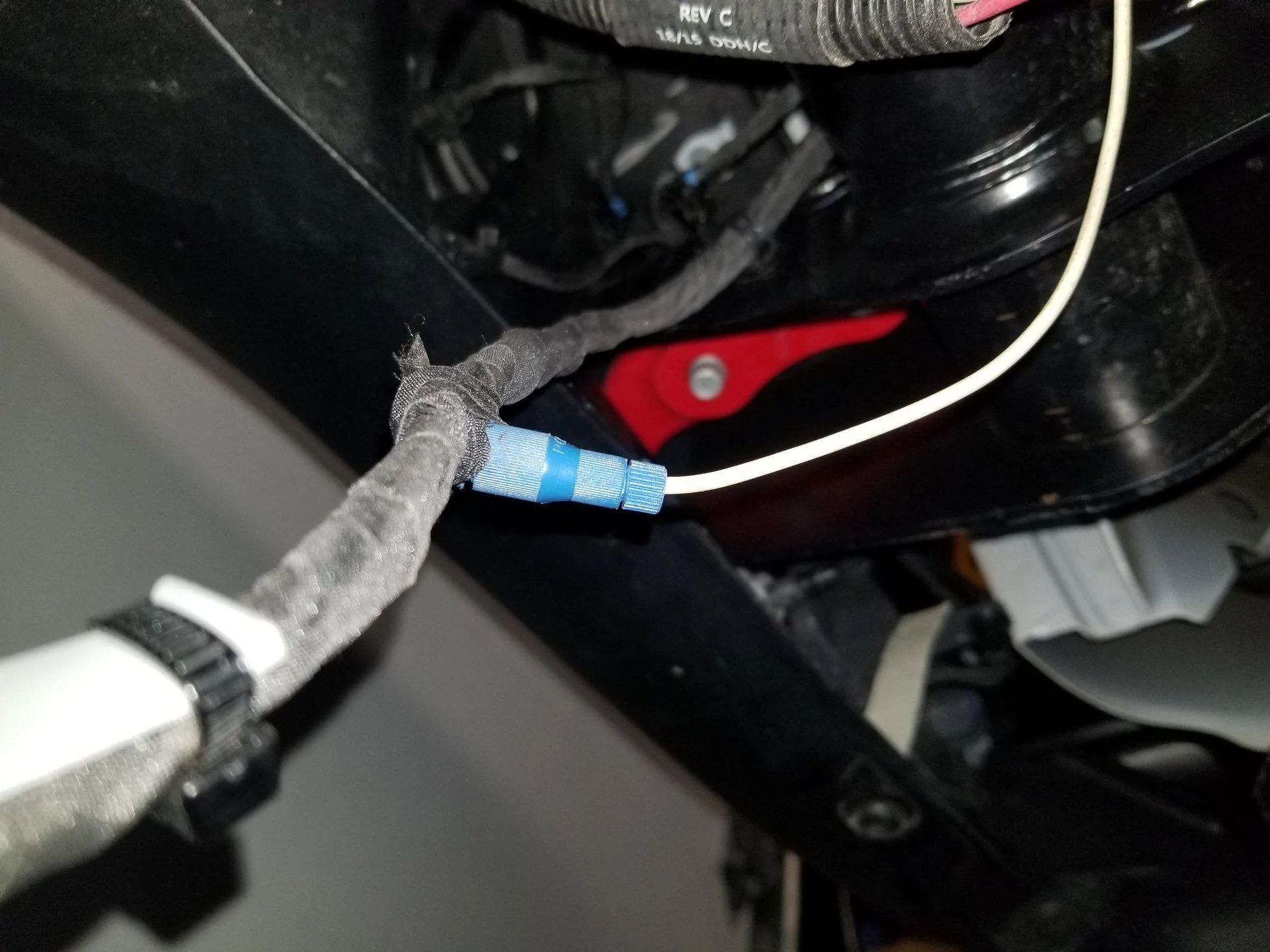

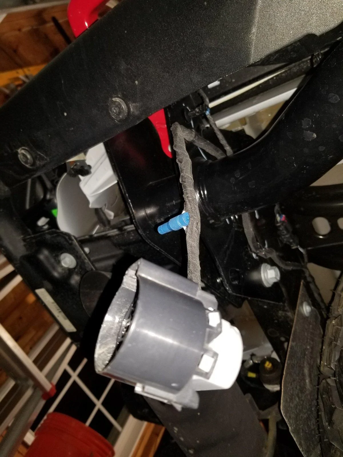

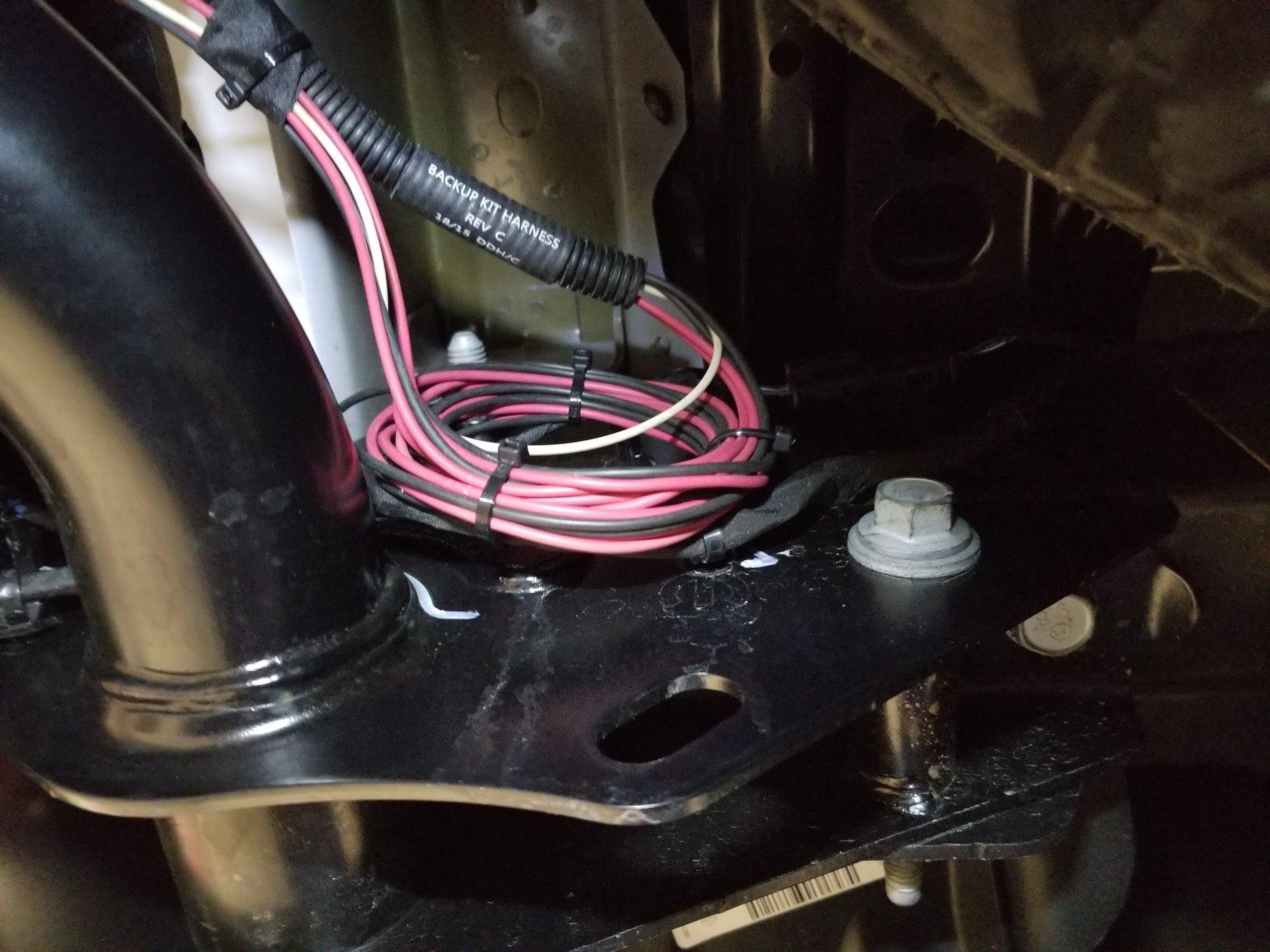

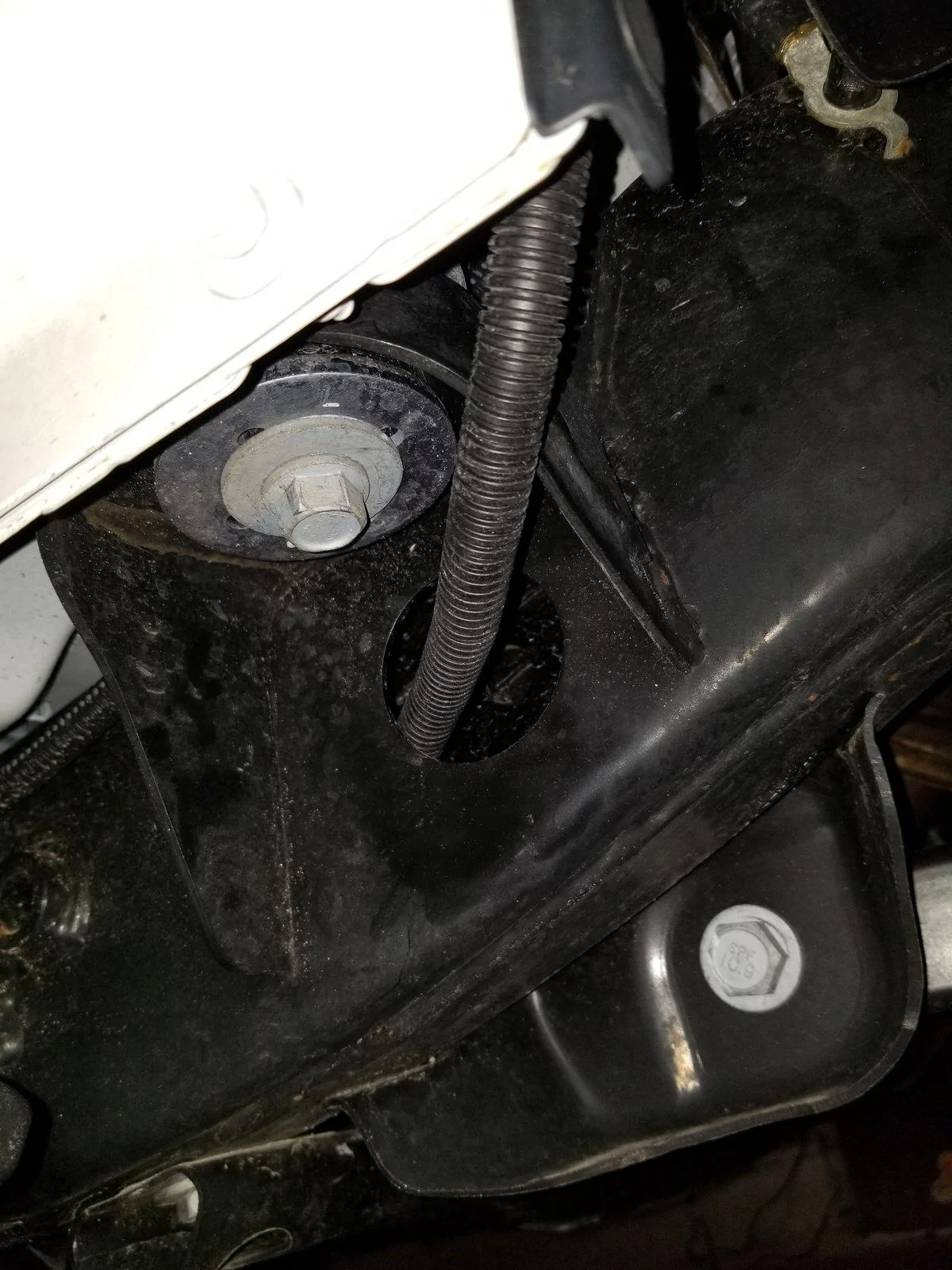

I ran the harness through the frame using a metal fish tape (snake).
I used a posi-tap to grab the signal from the reverse light on the trailer harness behind the bumper. (Orange/white wire)

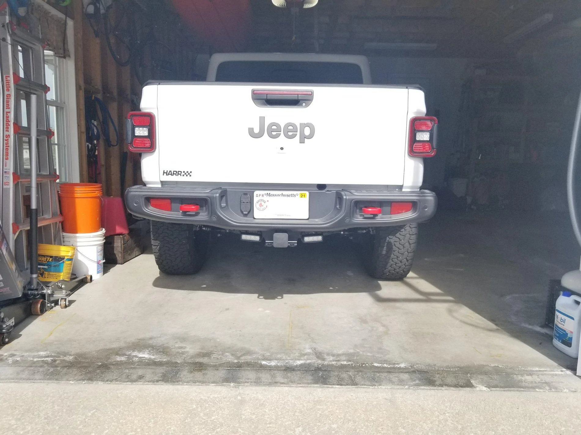

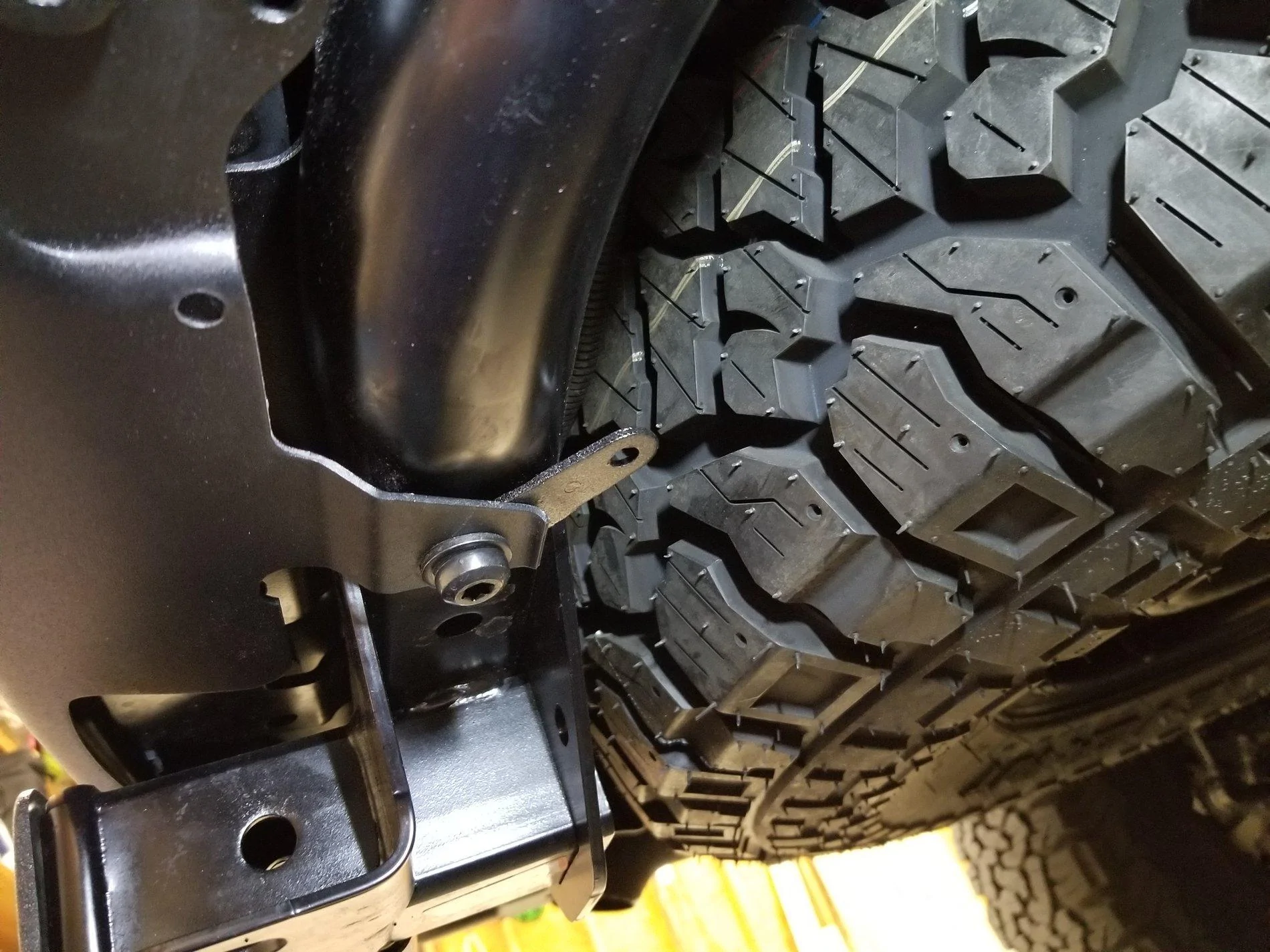

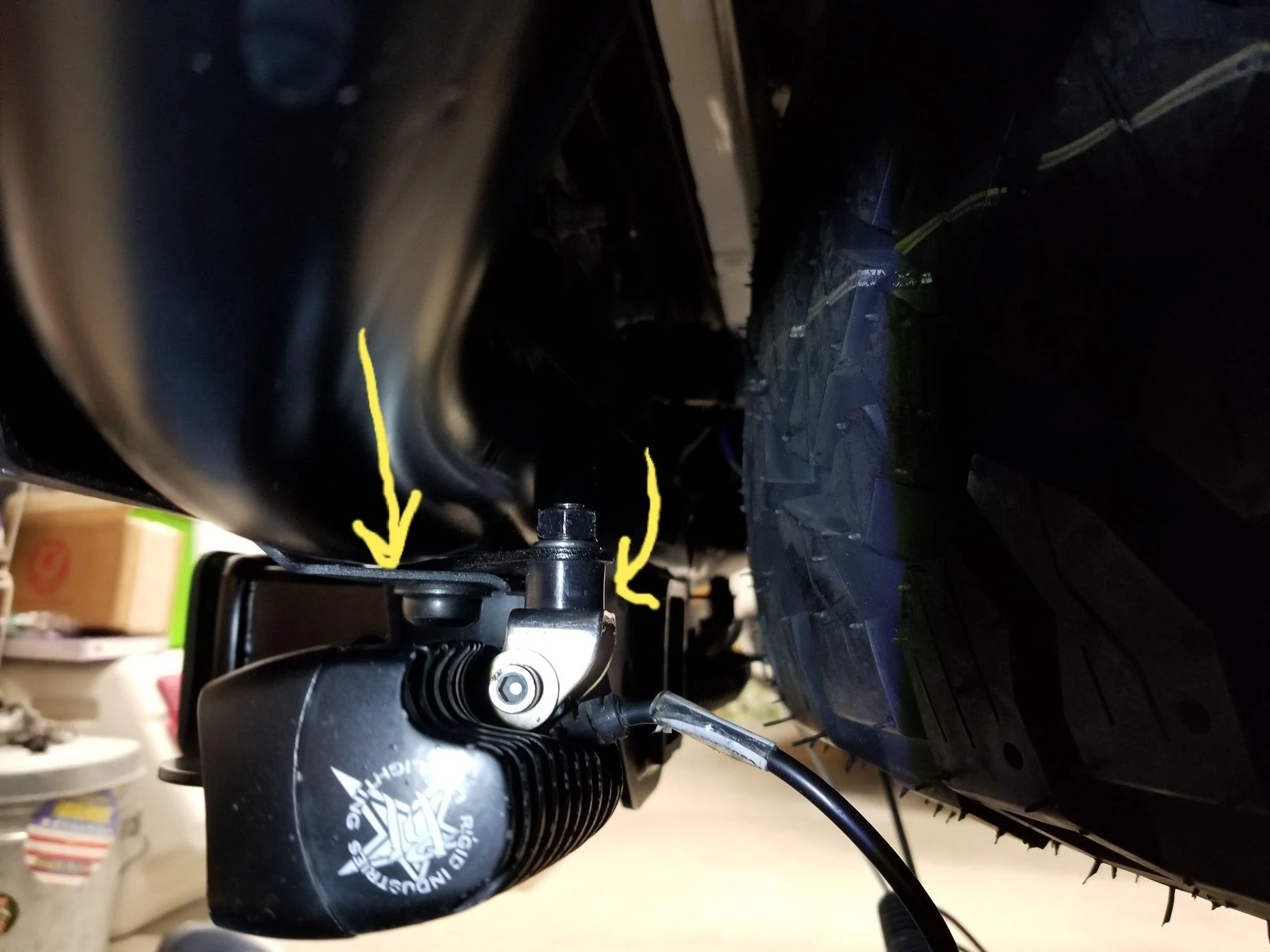

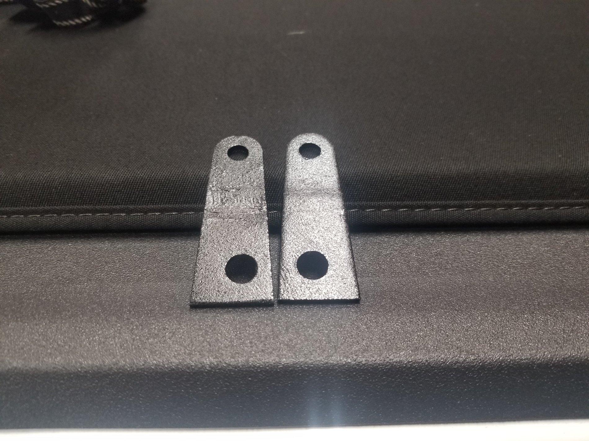

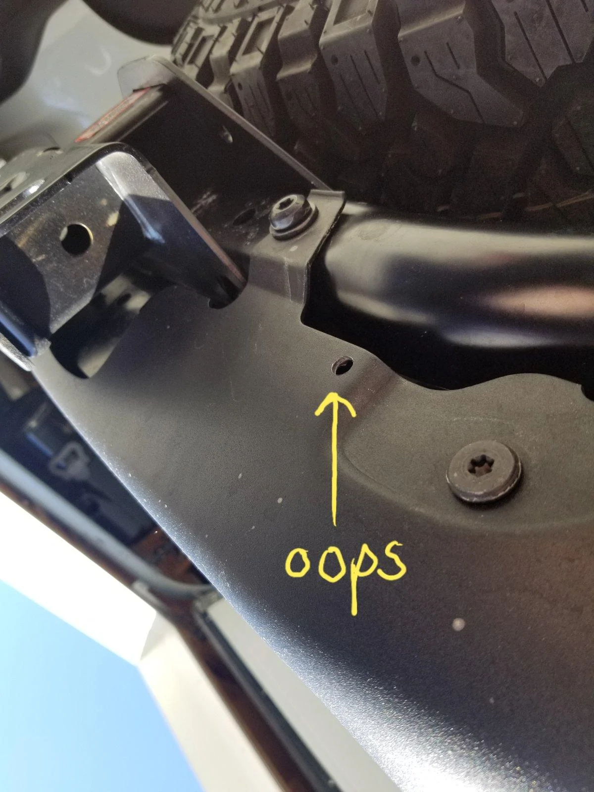

Mounting the lights...
I fabbed up my own brackets and spacers using some left over metal stock and hardware in my workshop. This was after I drilled the bumper in a couple of spots (yes couple) and not liked the what it looked.

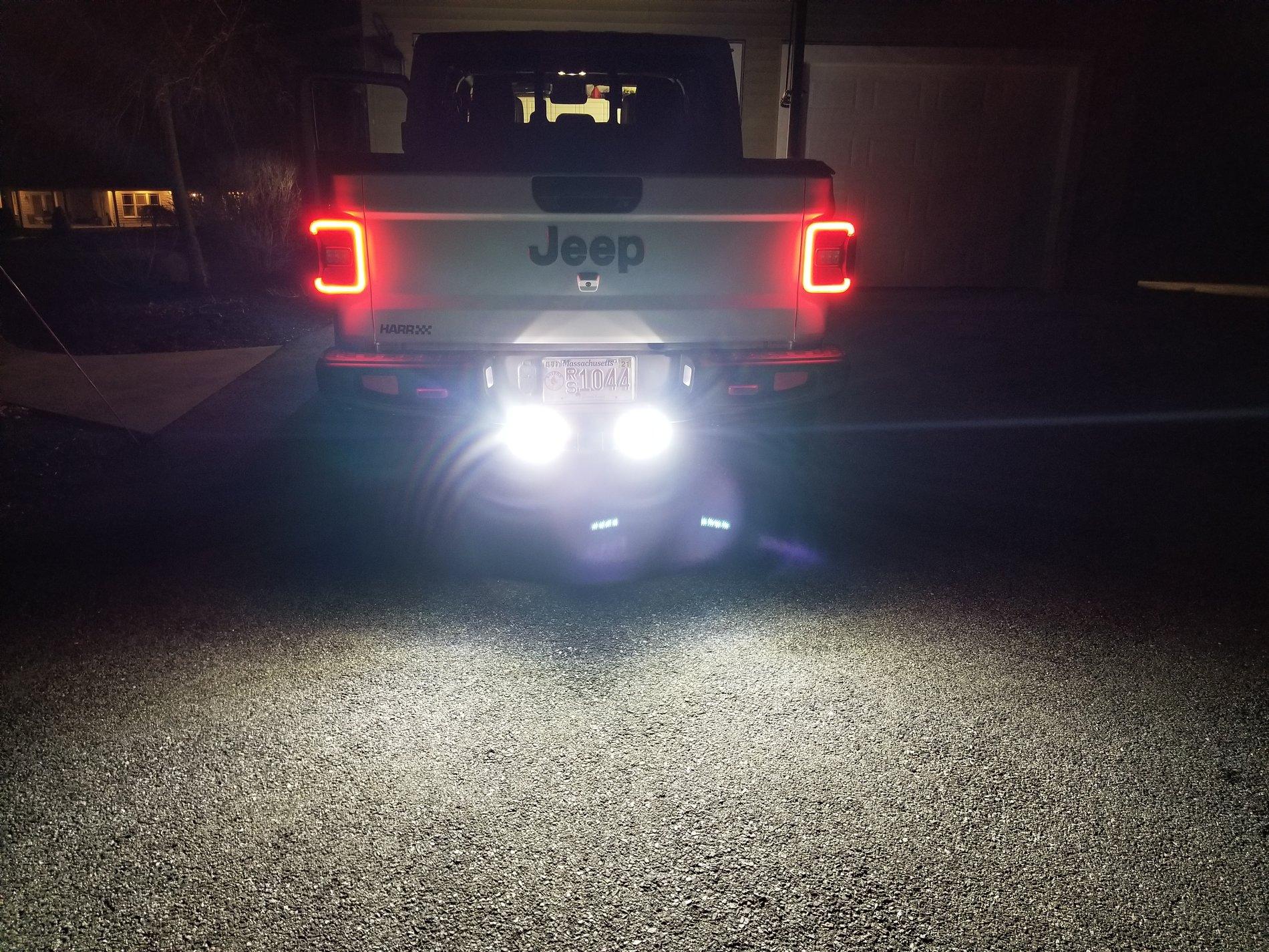

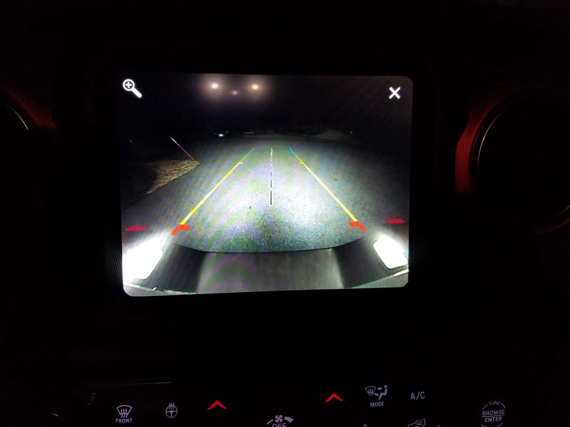

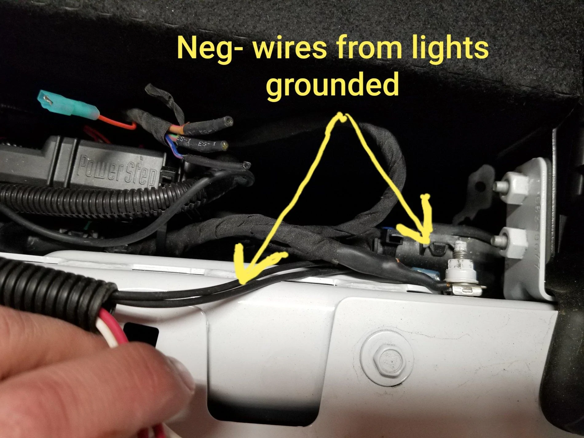

All done. I could have cut the harness down further but I just could the wires and zip tied it up needed to the trailer hight frame behind the rear bumper.

Wait, so the diode accepts 2 potential positive leads and then sends it to the lights when either or both is on without risking power being back fed?
Other than more protection from the elements under the hood, any reason you chose to mount it there and not in the back by the lights? Seems if you did that, you'ld only need to run 1 wire from aux wire to rear of truck since the reverse tap location was in the rear as well. Any issues with power running from front to back reverse wire, then back to front to diode, then all the way back again to the rear lights? Like some kind of voltage drop or heating up the wire from making 3 trips instead of 1?
Does this also solve the "can bus" problem, that I don't understand? IF SO....
This diode just simplified my life and i raise you a beer emoji! :beer::turkey:
i think i can figure out where that front hole in the frame is, near one of the body mount bolts i think, but can you give a better photo of where it comes out in the rear of the truck?
Seriously, i've been putting off and putting off tackling my rear backup light install, but with that diode and easy wire running through frame, this became one of the easiest mods. thanks!

This is my first foray into diodes. I can't take credit for the diode. Someone here posted it in their auxiliary light thread and I ordered it immediately on Amazon for the same reason. It seemed too simple.
To answer your first question, this diode does accept two 2 potential positive leads and then sends it to the lights. But from what I gathered, when the diode open up by pressing the Aux 3 button, it blocks out feedback into the reverse wire lead.
I could have really chopped up the harness provided by Rigid, but it was designed to run the length of the truck with wiring under the hood and ending at the rear bumper. The is a long harness consisting of fiver wires (2 pos, 2 Neg and Revese wire) inside a wireloom. It's about 12 ft long overall. Since the harness was long enough and came nicely wrapped from Rigid, I just ran the whole thing from the back of the frame to the front. I'll get you a picture of where it exits at the back of the frame at lunch today.
As far as delays, I have seen zero delays. Press the Aux 3 button and the lights come on instantly. Shift into reverse and the lights come on instantly and shut off as soon as you shift into drive. I haven't tested having the Aux 3 button on then shifting to reverse. My guess is the lights will just stay on, because the diode will be dedicated to taking power from the Aux 3 back to the lights.
Smart. So did you push the fish tape from the front of the frame to the rear, then pull the wires/loom back to the front?
