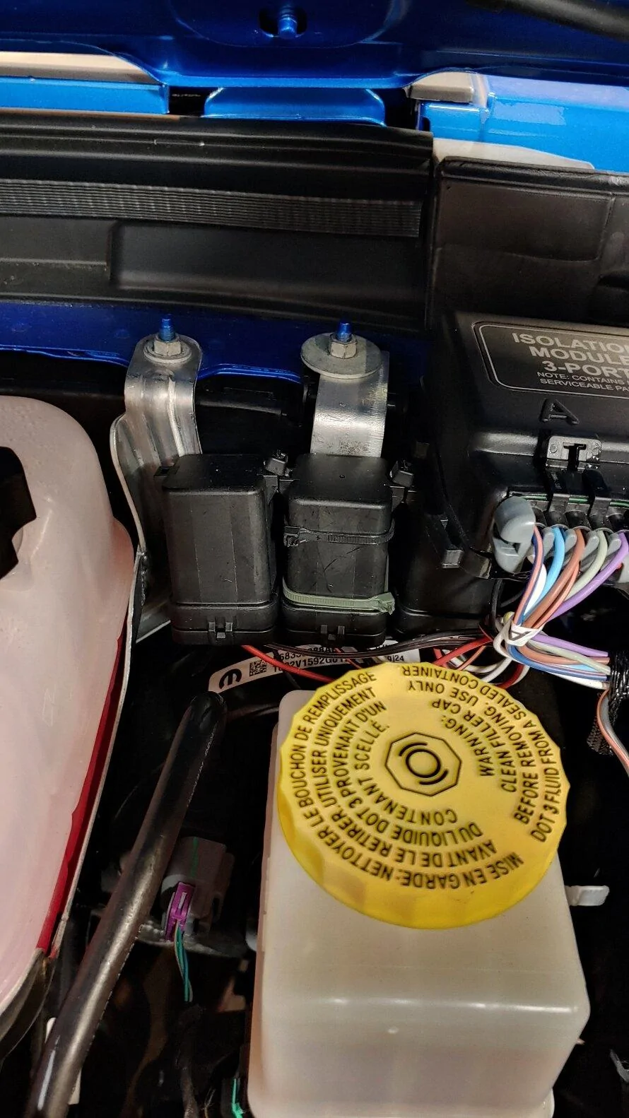

See this bracket I made here? How many relays do you see?
Jeep Gladiator wire harness for Aux switches? 20221024_161454_HDR
But wait, there's more!
Here are three more relays........

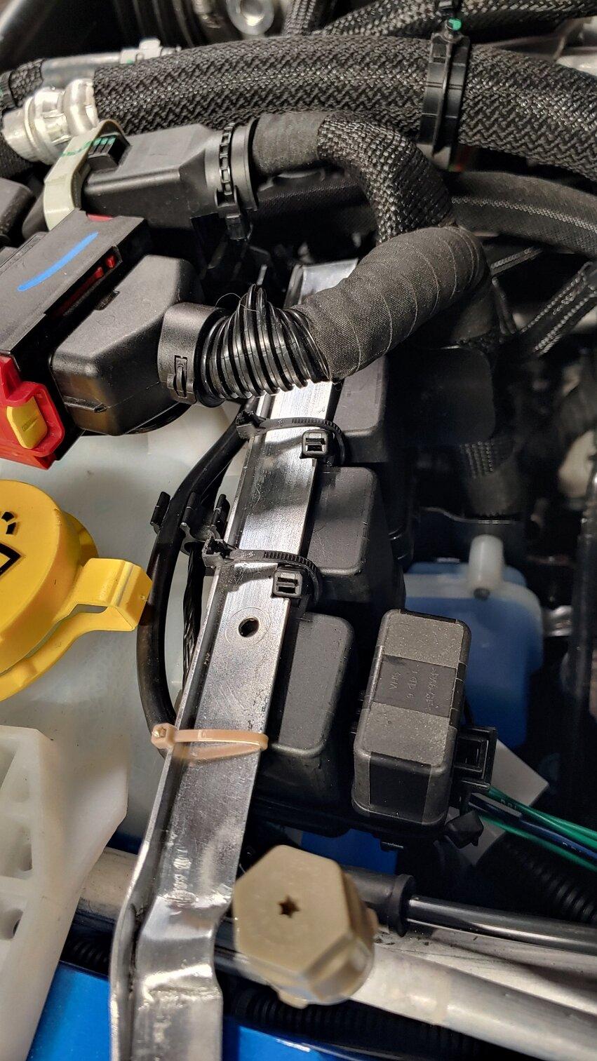

Jeep Gladiator wire harness for Aux switches? 20221023_130655_HDR

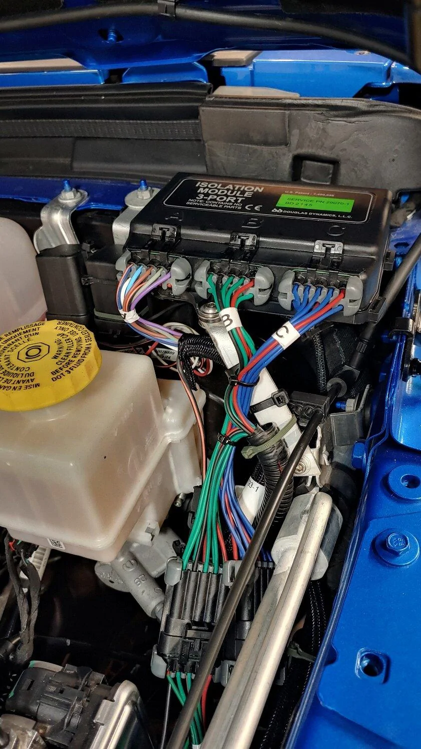

And then there's this - with........... drumroll please............ relays, transistors and switches.
Jeep Gladiator wire harness for Aux switches? 20221023_130650_HDR
The above all control the snow plow lighting, turn signals, park lights and DRLs.
There's a reason for everything here. I scoured the tech docs and schematics as it looked like some engineer was on crack or listening to Helter Skelter on constant replay.
Treat the Jeep's aux switches as if you are going through a simple switch and that there are no relays. It's the easiest way to think about it.
The aux switches are electronic devices, not what you think of as a switch.
