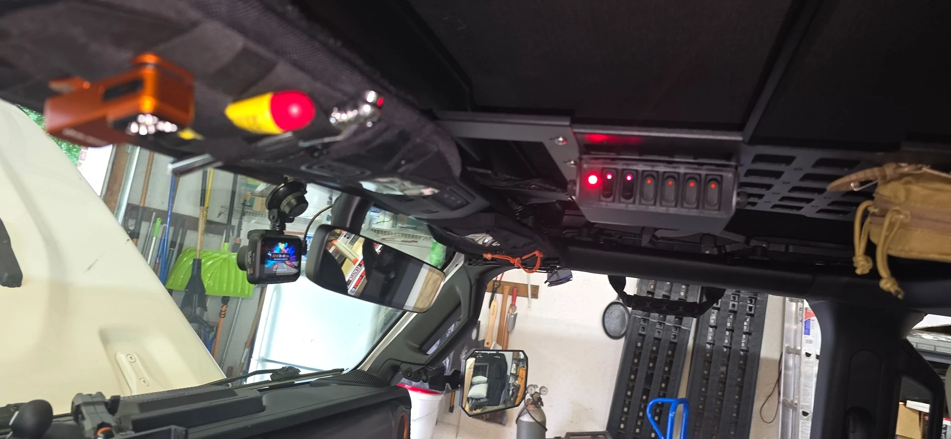

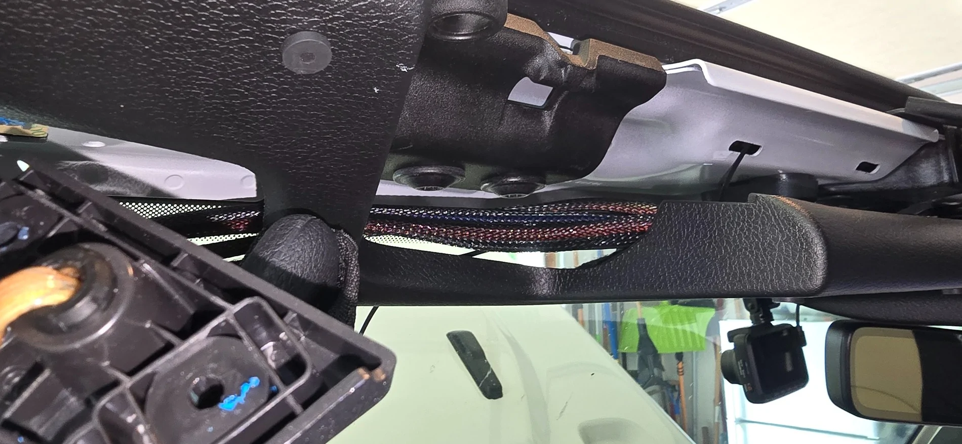

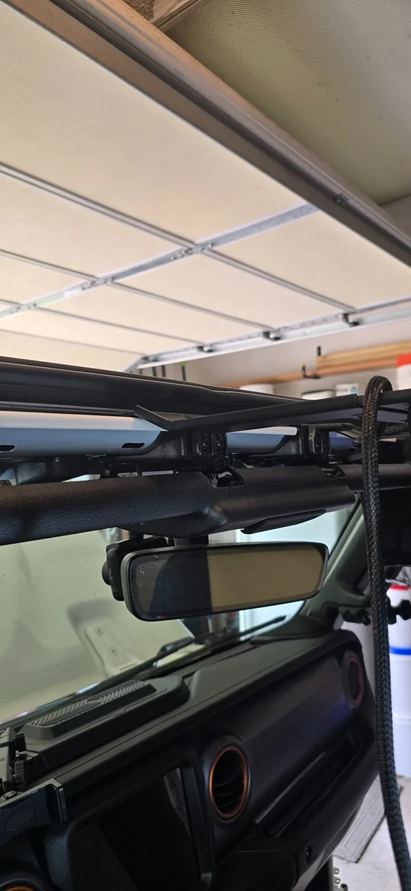

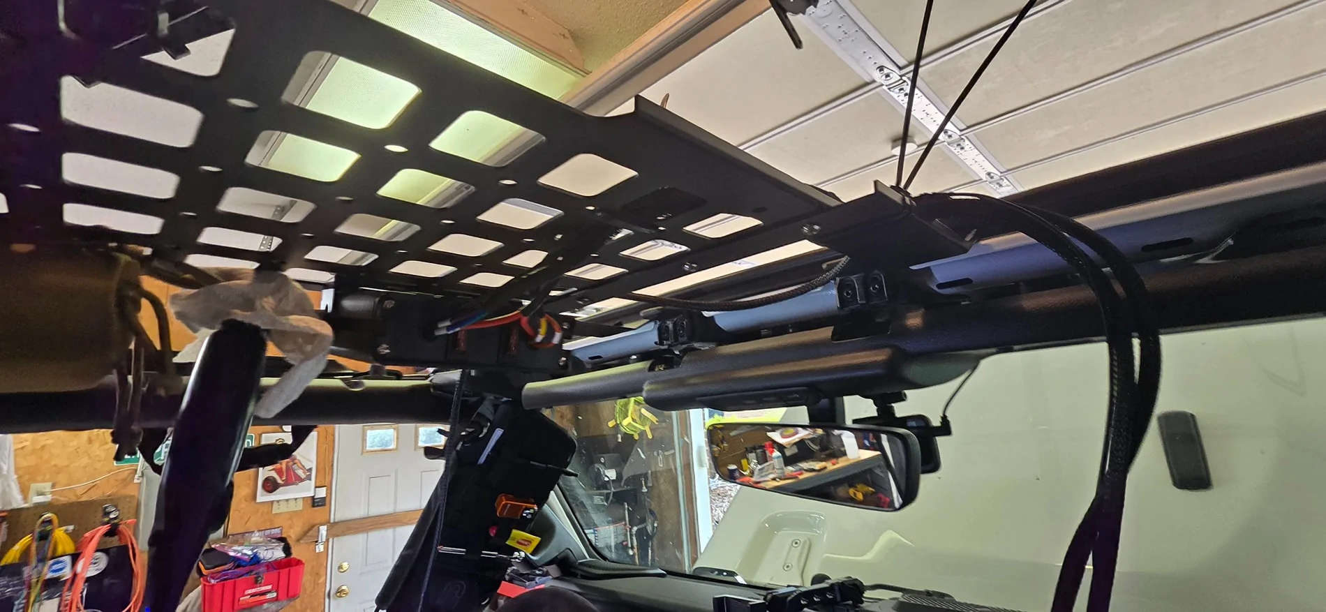

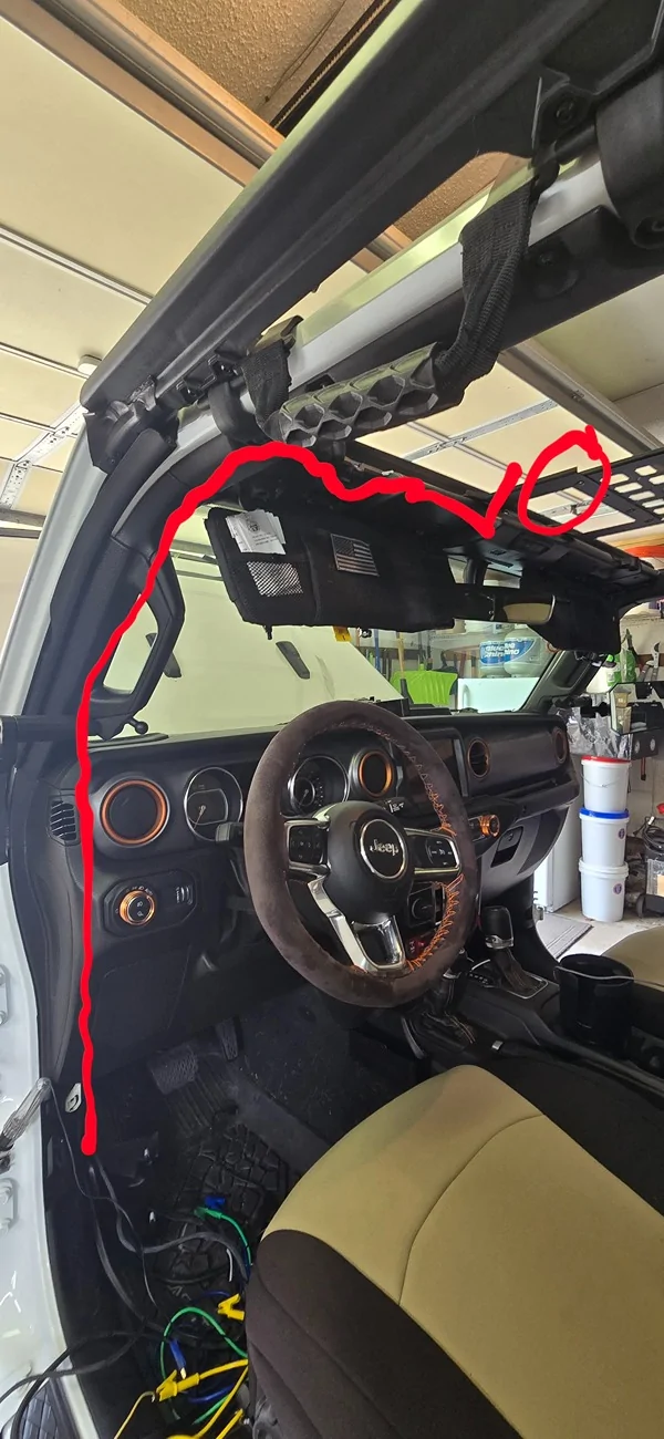

Wiring a rocker box to my overhead hard MOLLE panel. See pics and path in RED. Is it possible to route two small wire harnesses through this path? Didn't see much about it on here.
Like to get opinions before I start taking plastic off.
TIA

Should be fine running that much wire through there. Do them 1 at a time. Anchor the first then anchor the second to the first. Makes it way easier than trying to run 2 at the same time. Just takes a bit longer. Not sure what year yours is but may have to deal with airbags there but unsure. Mine is ā€˜21 so I don’t have all those fancy bits.

Thanks. It's a 2023. I don't think I have side curtains. Did you see I have 2 sets of three in looms? Think it will fit 3 at a time?

Ok, that's not exactly what I'm doing but it shows there is room. Thanks!

Yep. Plenty of room just try to keep it as clean as possible and if you can shorten wire to avoid a huge bundle at the end, do so. You’ll probably find more stuff to wire in so keeping some room open is smart.

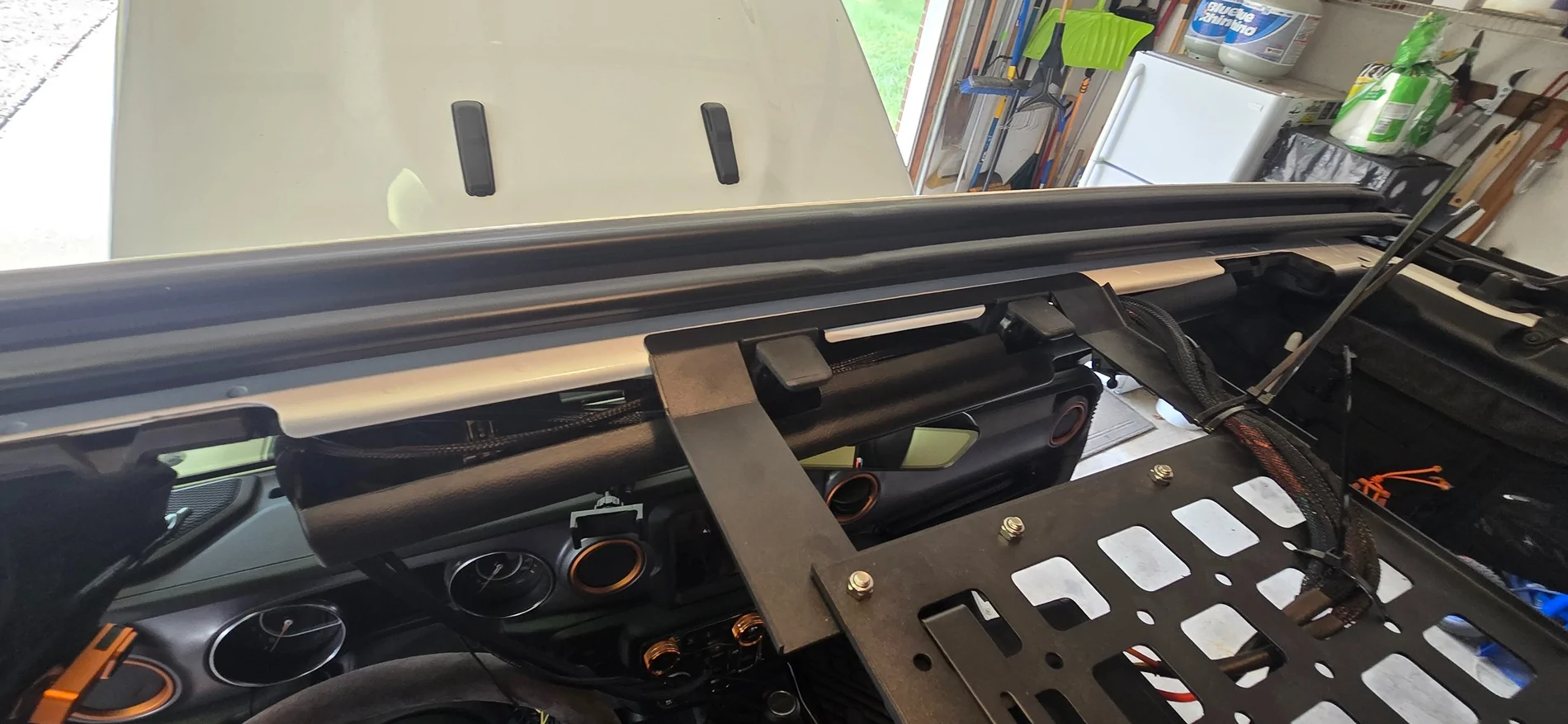

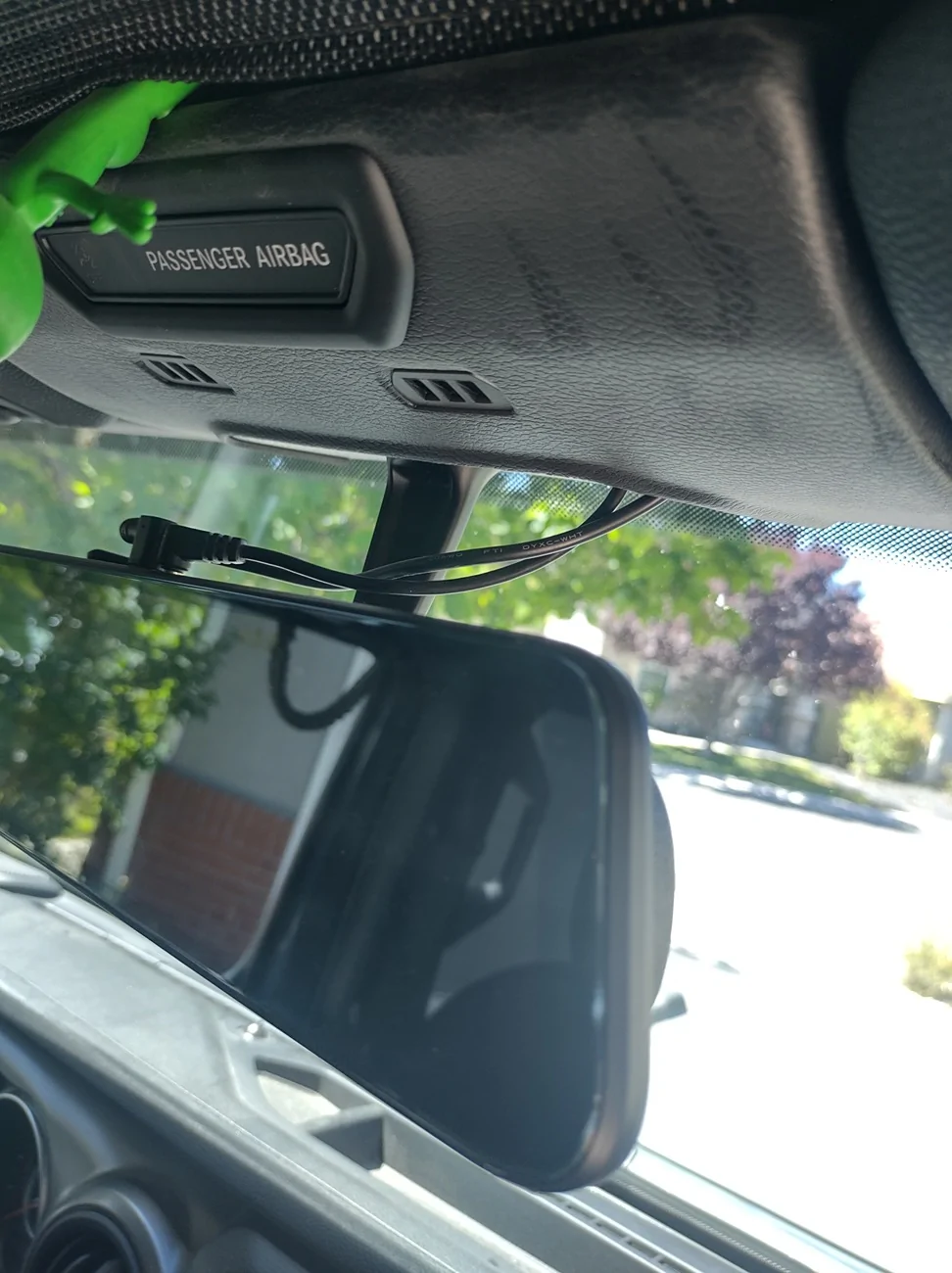

I did this with my rearview camera from my camper up passenger side up the pillar and out. Drop the windshield makes it so easy.

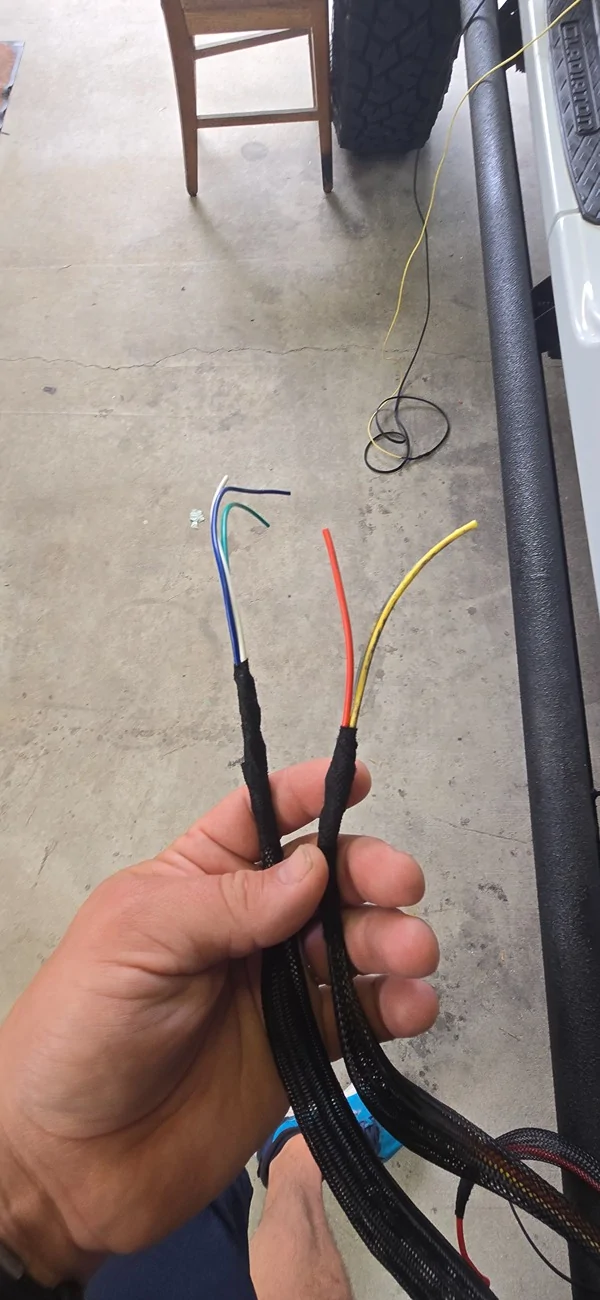

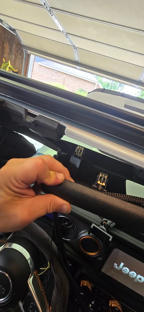

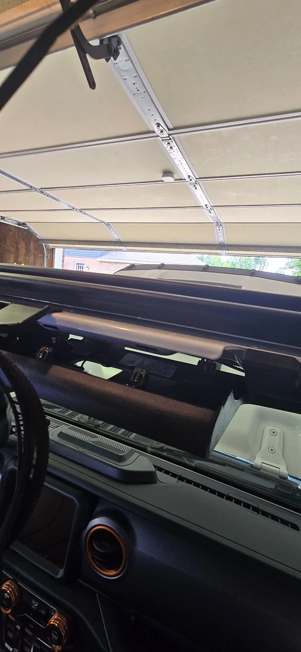

Thanks all. I went drivers side. There is a good ground point down by the kick panel too. I'm about to see if all the plastic clips back in fingers šŸ¤ž

I ran the power and antenna for my GMRS radio which is mounted on an overhead molle panel down the passenger side B pillar and out through a hole in the floor. On the driver's side, my ARB Fridge power cable, which is fairly thick runs from the battery through the hole for the clutch pedal, along the door sill, under the plastic to the back seat.
