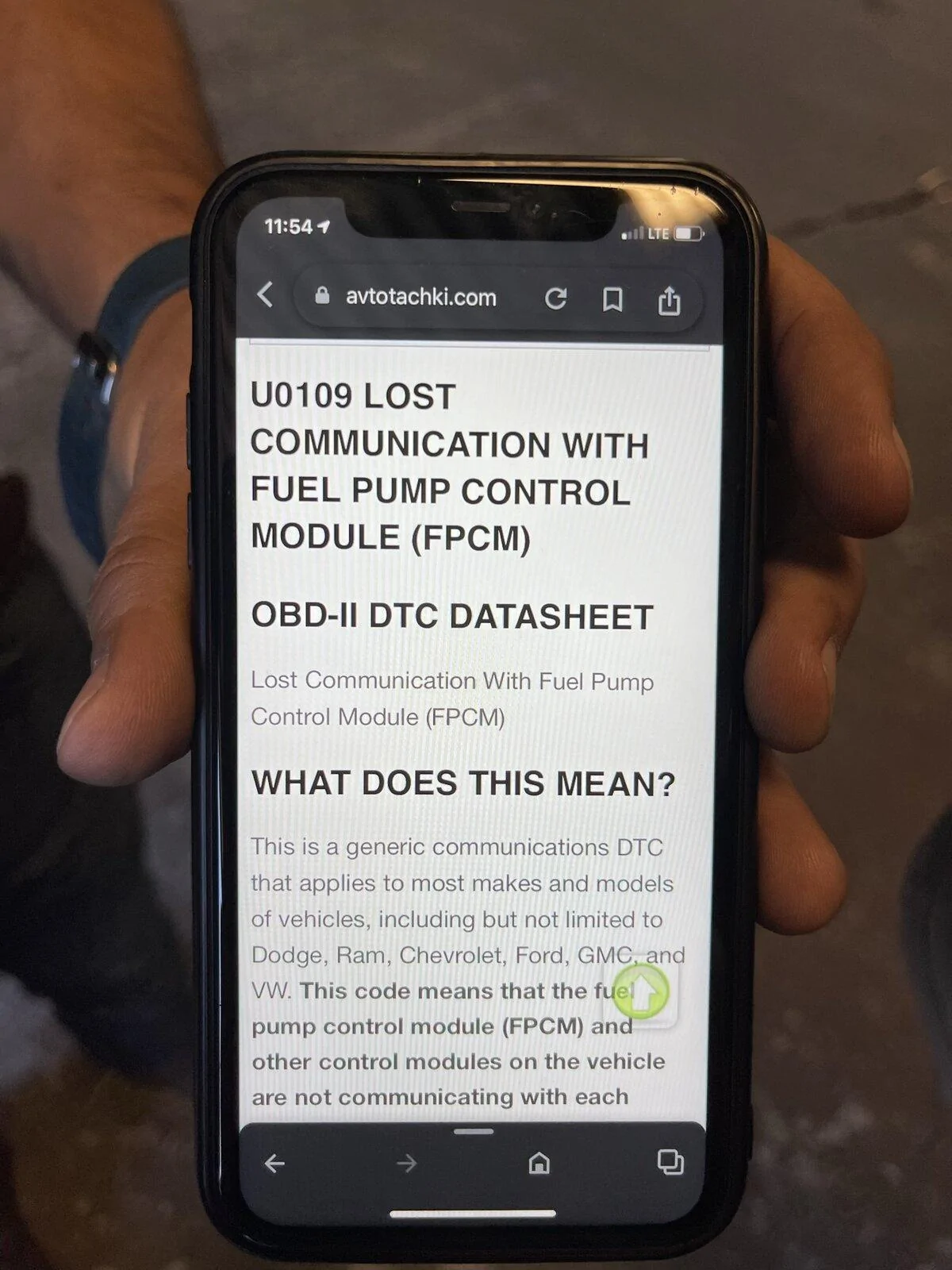

I bought a couple pod lights recently from a popular local 4x4 shop. I told them my truck was pre wired with the auxiliary switch group and they told me they were familiar with it and it would make it easy.
When I went to pick up the truck though they showed me how they had wired it to the battery with a fuse and also to auxiliary switch 3 as I had requested.
However that seems wrong to me. I was under the impression all they had to do was wire directly to the corresponding number 3 wire in the auxiliary harness as everything is already rigged for power, fuses, etc? I pointed that out and they told me that no. It still needed the fuse and power, etc.
As soon as I left the shop I noticed something weird. I had a check engine light on. Which I’ve never had before. I brought it back and when they checked it it showed this code:
Jeep Gladiator Auxiliary Switch pod light wiring question… 5E7E08BA-BDD7-4533-95E7-F3045DE35D2F
They cleared it, and it hasn’t come back. Basically they chalked It up electrical system sensitivity. Lights are working fine and the warning light hasn’t come back. Any thoughts?

ive wired lights, grms radios, and arb air pumps to those aux switches. you can do both (connect to battery, and also connect straight to switch). The aux switches are powered directly and that power is contained through the supplied fuse for the aux relay, so you really only have to then ground, which if the device is outside the vehicle you can run both power and ground next to the battery box, or if inside you can run the power down the passenger foot well and there is the same relays on the inside and spot for ground already set up. What they did was run additional fuses from the batter box to the aux lead in the engine bay. Its not wrong, and is extra safety in case the device blows, your aux does not (either way its a fuse that will blow first), ive done this with the arb air compressors. As for the communication error, probably caused if they disconnected your battery.

Thanks, I feel better about it now. I knew it was all prewired and didn’t need all that extra junk. I told them as much but they did what they did. Maybe to justify charging me for more time. Whatever. Just wanted to make sure it wouldn’t cause a conflict in the electrical system.
