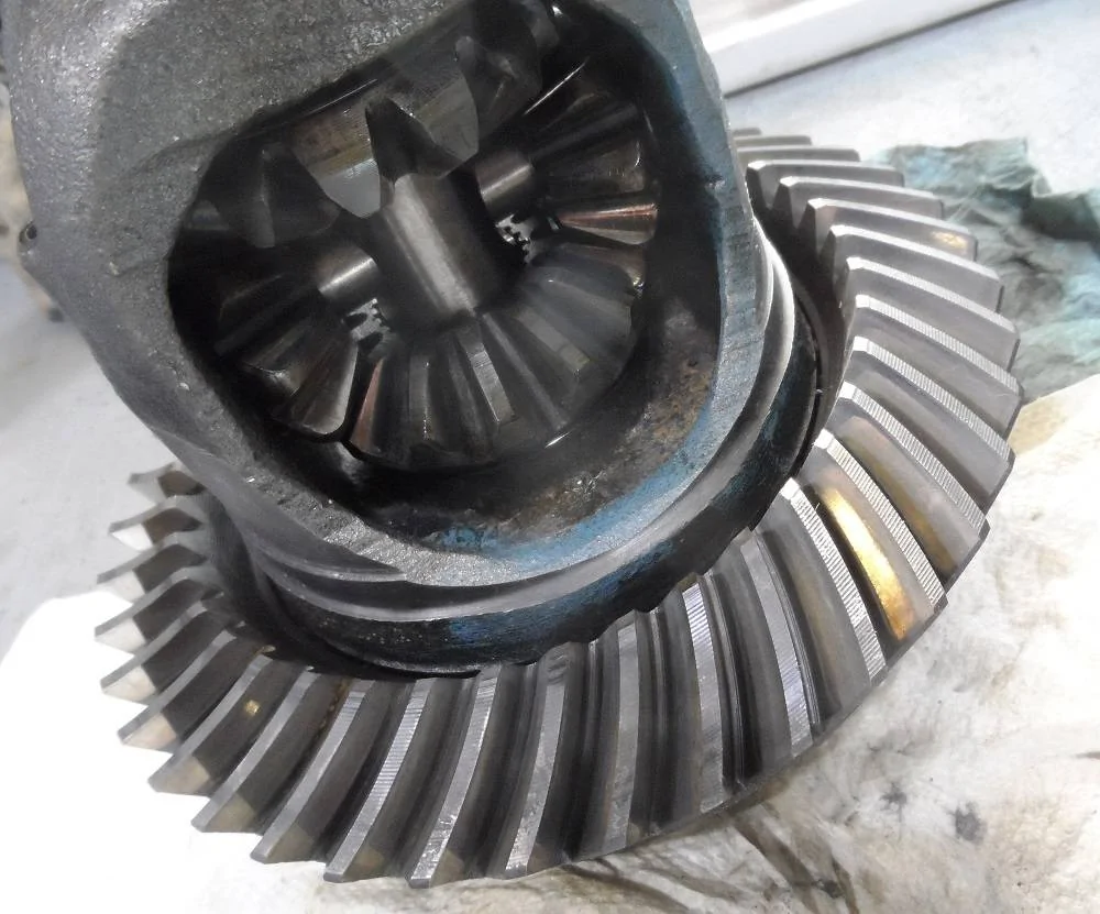

There's not only ring and pinion backlash, but there's carrier to side gear backlash in there. So once the play is out of the ring/pinion pair, there's play to remove from the carrier gears inside the carrier.
The carrier rotates the carrier gears against the axle/side gears. There's a bit of play or lash on each pair. If the lube is hot it's going to be a bit worse.
Depending on the design of an LSD, there can be more play as clutch packs wear.
