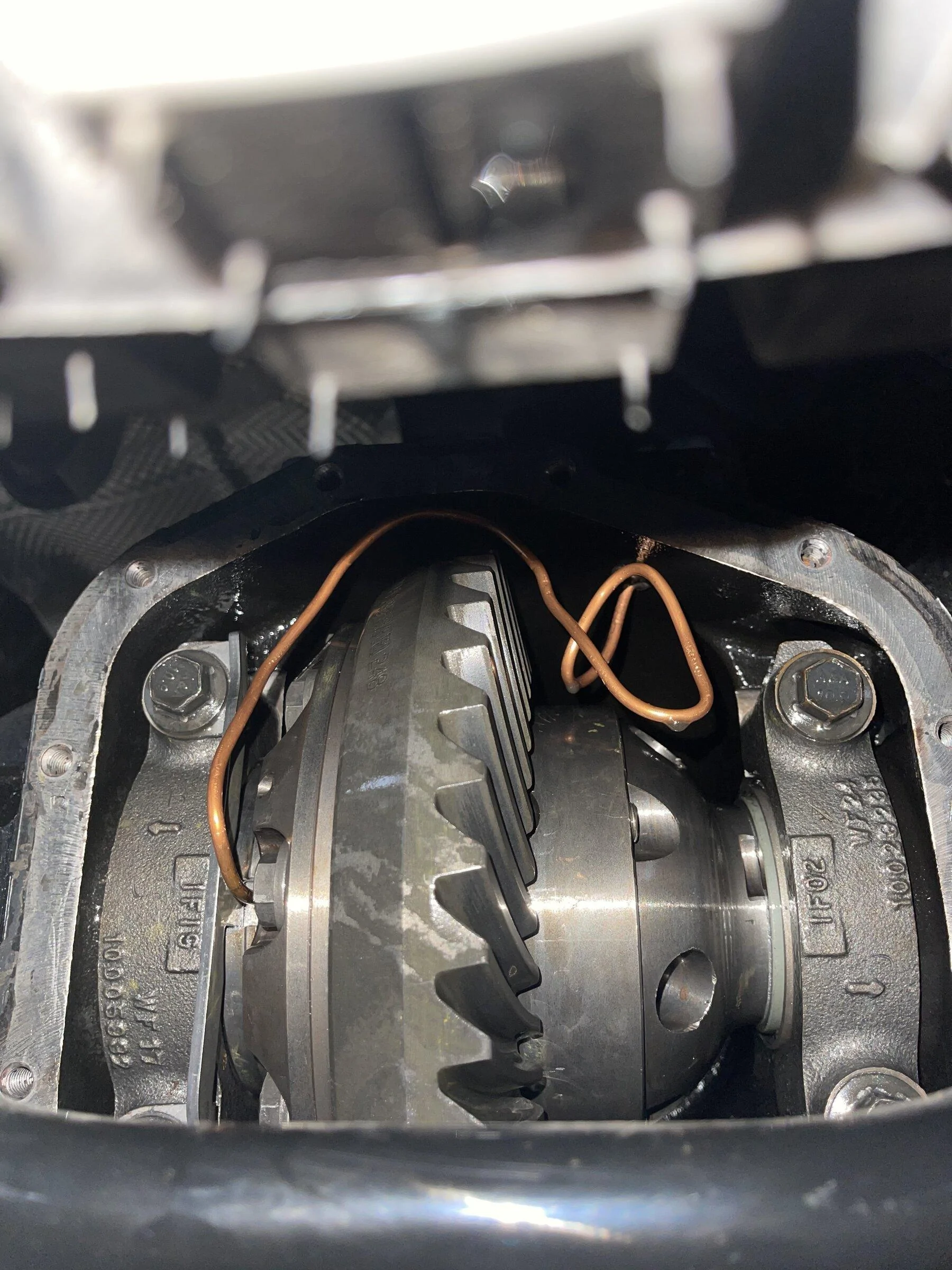

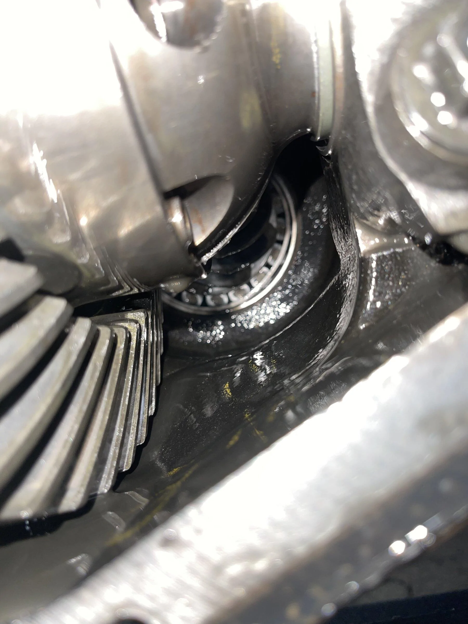

Back story:
I paid a shop to install my ARBs and gears recently. 300 miles since the install, I’ve been following the break in suggestions. The day I picked it up I noticed a slight howl between 40-50, assumed it was the gears setting in.
Today:
In preparation for a long road trip I wanted to change the fluids and install my new ARB covers. Upon removing the cover I find my airline looking like a 3rd grader installed it, look a little deeper I see the pinion bearing cage is bent.
Lesson learned:
Do it yourself or don’t cheap out on the shop you choose.

I don't see the harm in the copper air line, it's not touching anything is all that matters. The howling and the bent bearing cage is no good though.
