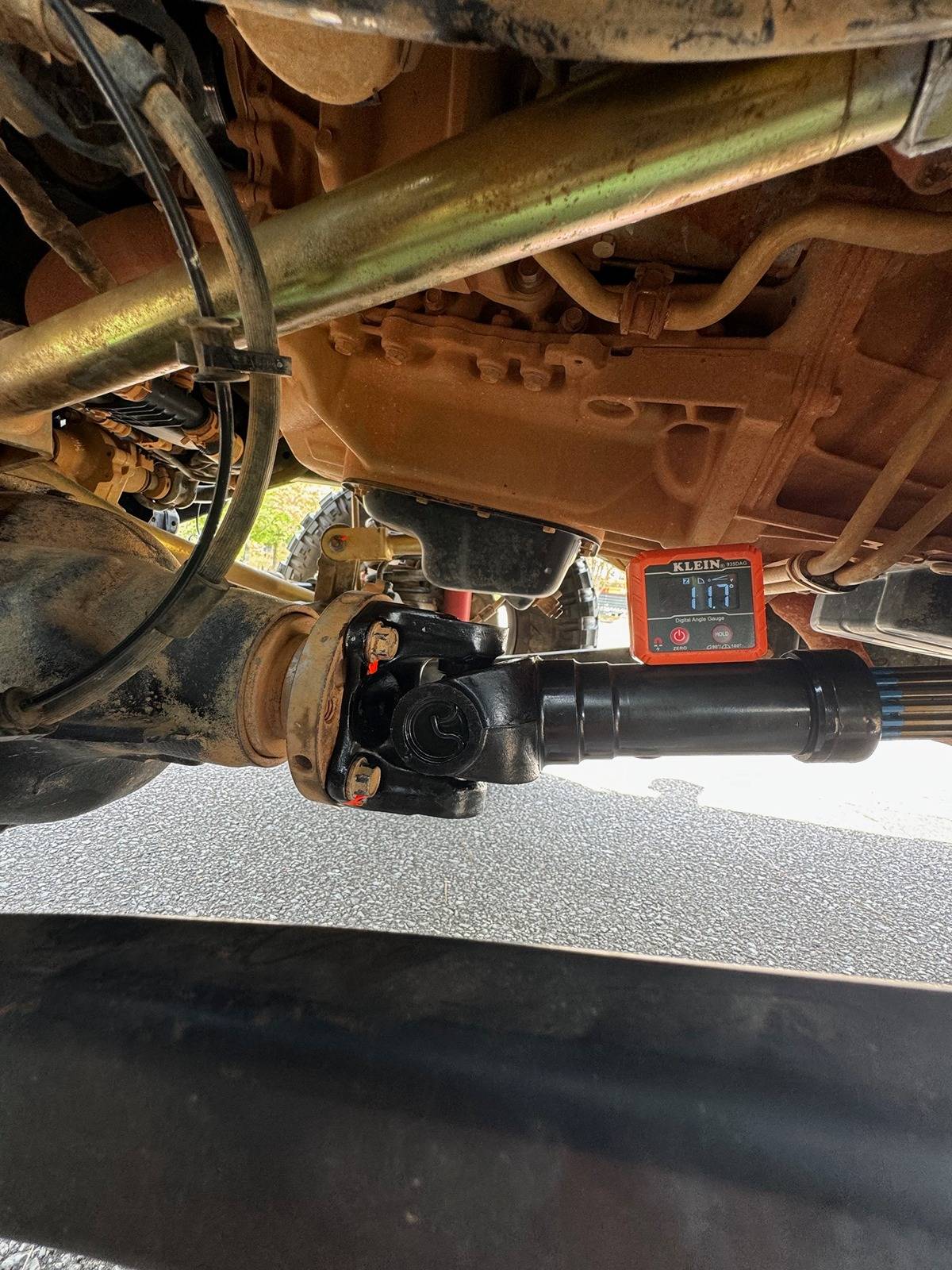

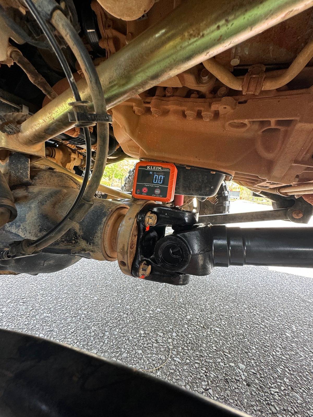

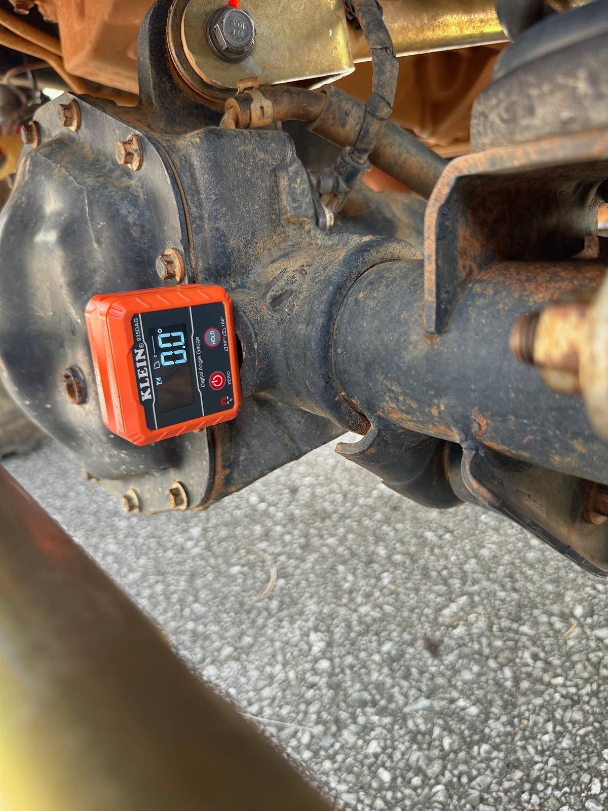

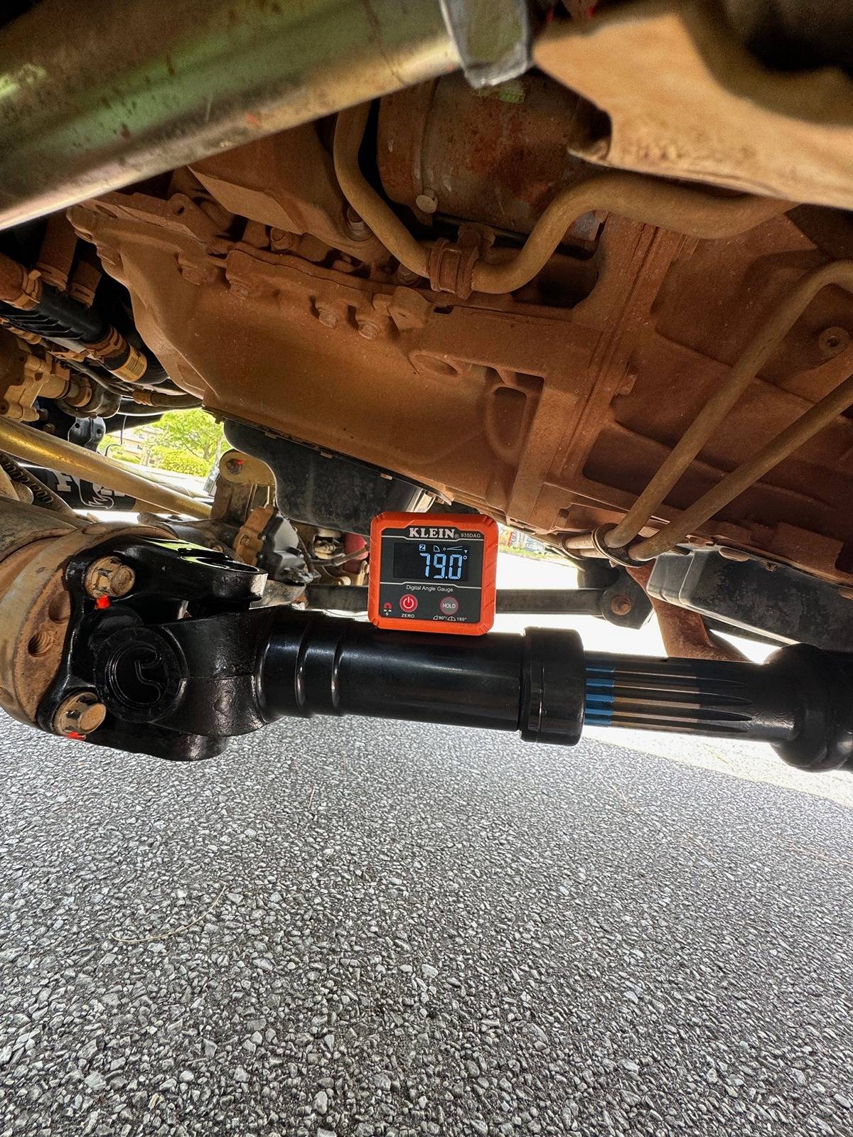

24 Rubicon
Your vibration is most likely related to the amount of caster that you've got dialed in. Anything over about 4.5-5 degrees and you'll get a vibration from the front just because of the angles. Running a non-rzeppa at that angle will be even worse so you may just want to replace the rzeppa and dial back the caster a bit.
28.4 should also be fine with the rzeppa again assuming a caster of about 5-5.5 degrees. I am at 28.45 and 3 wheeled it quite a bit on all kinds of crazy shit and still on the stock shaft at 65k miles.
The wife also has a 4xe and we have to run around 5 to keep it from humming. Also the same 28.45 length front shocks and plenty of 3 wheeling and still on stock front as well at 50k
Do you have a FAD installed on you JT? It sounds like your setup is similar enough to mine and you are not seeing the rzeppa failure. Maybe I had a bad joint to begin with or the constant spinning has lead to premature failure. Either way I could replace the rzeppa and install the a FAD and just forego the driveshaft swap. Any thoughts om that?
I do have a FAD as I'm a 2021. You wouldn't be the first one to install a FAD and just replace the rzeppa with the terra flex replacement joint. I actually sent a guy an extra fad actuator I had from an axle replacement.
I personally wanted to avoid aftermarket non-cv drive shaft and built with that in mind as I wanted to minimize vibrations and wear and tear, especially on the 4xe which only unlocks full performance in 4h auto (and a spinning drive shaft)
