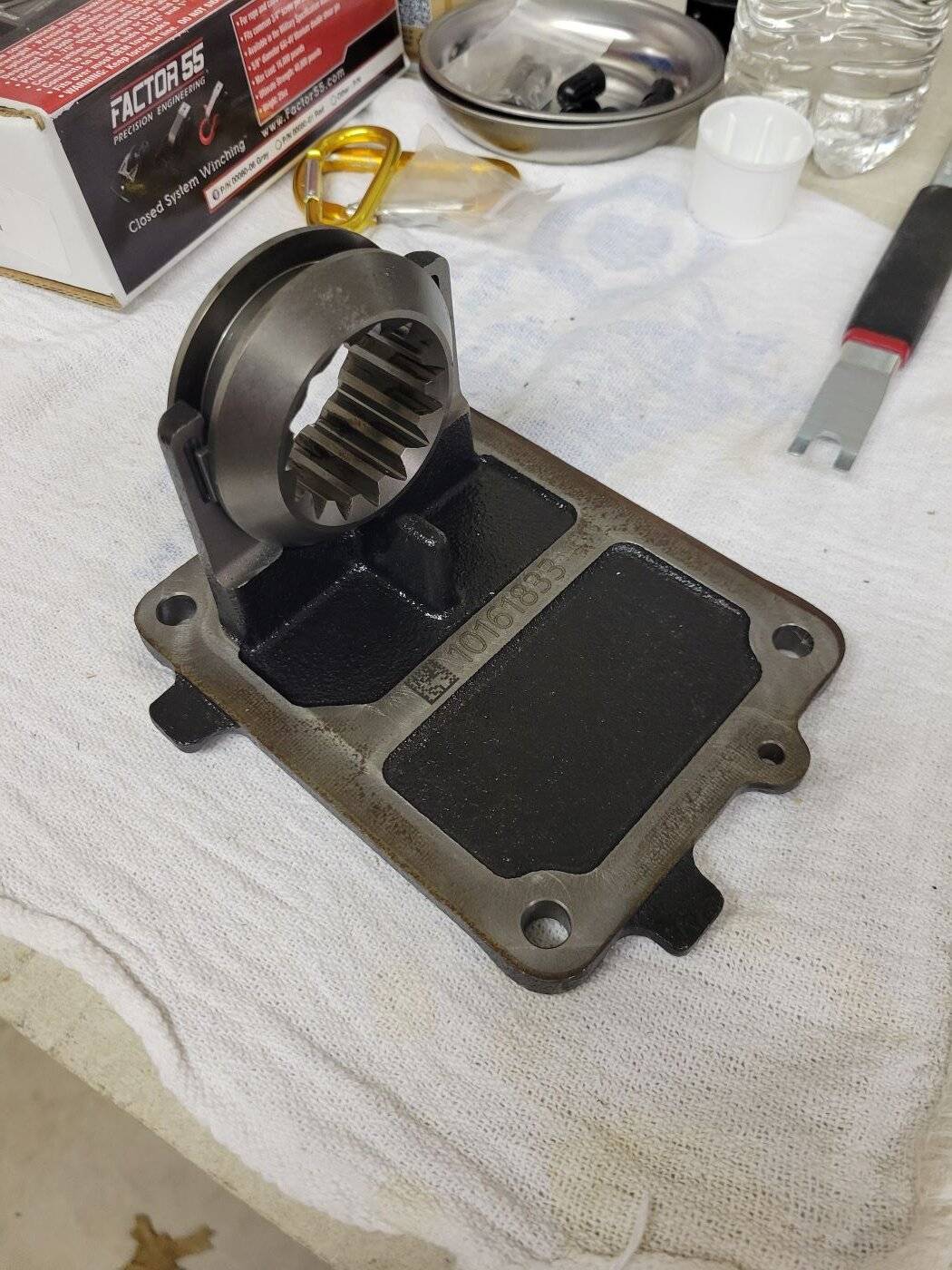

TIL this plate exists. Interestingly, Dana's block off kit includes a larger coupler that basically doesn't slide left or right, and just uses a flat cover.
As an aside, an update for folks:
Not sure if it was related, but I ended up trashing my rear diff pinion/carrier bearings. After the shop fixed this and slightly corrected my pinion angle (I was running it mostly straight at this point, they dropped it a degree), it was still vibrating. They sent the Adam's driveshaft to a local driveline shop who said it was completely out of whack: they described it as being "bent" and "not balanced".
After they did what they could with it, the vibration has basically stopped until about 78-80mph.
While I'm happy to have a smooth ride at 65-75, it's still very disappointing that for this price...not only was it junk to start with, it couldn't even be fixed entirely.
It's unfortunate because the build quality itself seems fine, and they were quick to assemble (maybe not a good thing after all), but the end product doesn't meet expectations.
