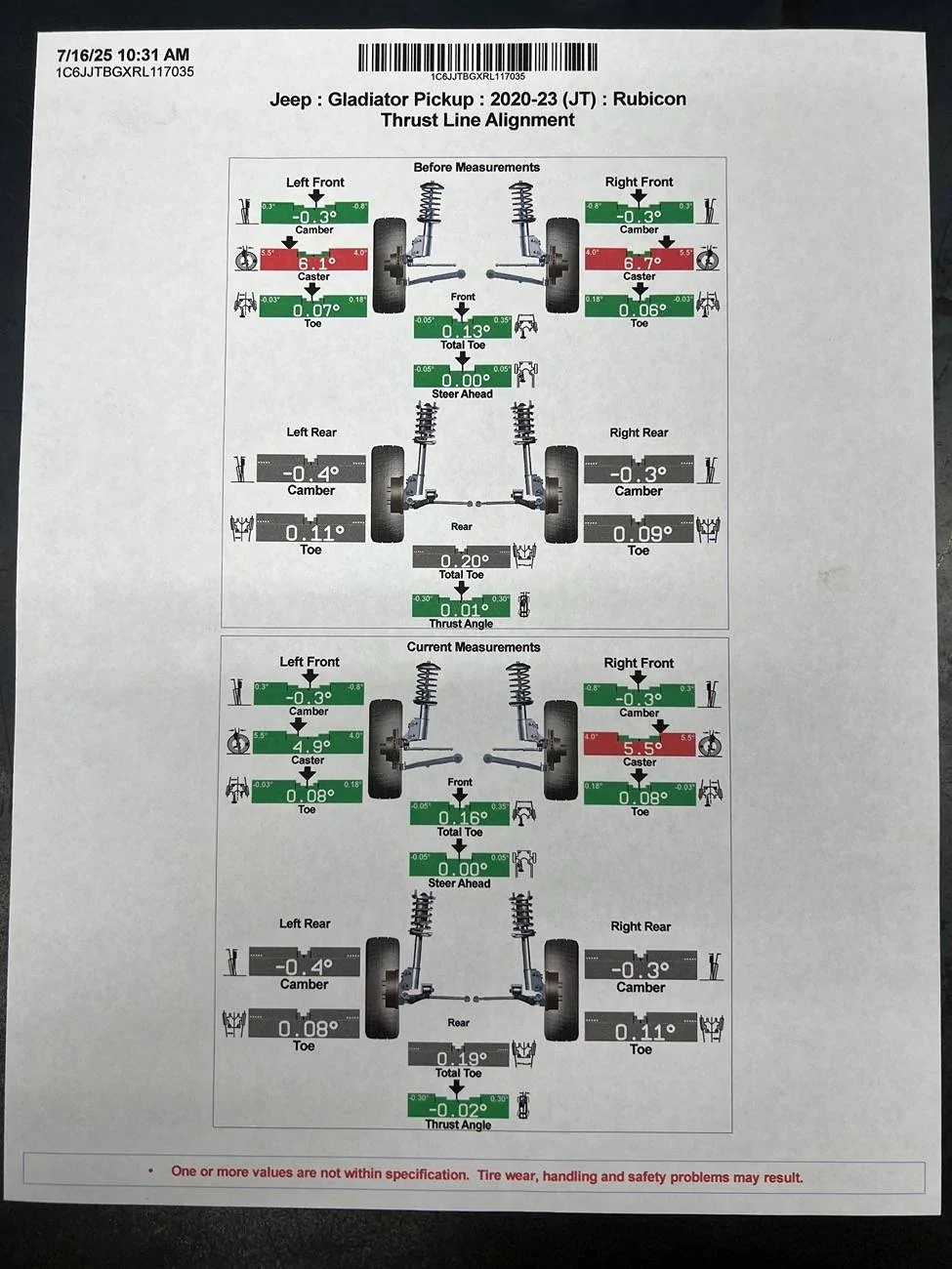

The fix is in!!! Guys at CPW (central parts warehouse) in IL. We’re on the same page with setting the caster at 5. After all set and done the pinion angle went from 11.6 degrees (caster of 6.6) to 9 degrees with a caster of 5. Did a full alignment and had me take it out on the highway. The vibration is gone! He said if It comes back we can always take it down to 4. I feel that won’t be necessary. Also the steering feels great. I can not feel a difference. So hopefully this helps for anyone running a similar setup!
But....but....but.....you cant run caster low (in spec)......you will die in a violent fiery crash if you don't have at least 6°!!!!??? ;)
All your driveline angle numbers are just confusing......What you are looking for is a 0° operating angle (or as close as possible) on that front joint. Also keep in mind that the vibration may come and go with loads changing or as the springs settle in.
Congrats on that victory!

If your Caster is only 4.5 its probably too low . 5.5-6.0 is where most end up.
Do you have adjustable lower control arms ?
That doesn't cause vibration - tire balance or driveshaft - with that many changes, the lift, the driveshaft swap. How many have we seen here with vibrations after a driveshaft swap?

What you are looking for it a 0° operating angle (or as close as possible) on that front joint.
I didn't see what shaft he has, which joints it has where, but............Don't run a single cardan joint at 0. they don't live long there. You can easily go up to 3 or 3.5, but 0 will shorten the lift as the needle bearings won't move. They'll get pounded in place.
A true CV won't or shouldn't matter.
Same thing for a 3 joint double cardan shaft.....a 0° constant operating angle isn't good, but the pinion angle and position is changing constantly with load/height so it's getting lube. 3° is a lot and will create a horrible vibration especially with the larger joints and heavier shafts. In this case the OP only made a 1.2° change and the vib is gone? Imagine what 3° would feel like??!!
I'm sure you understand that the two joints in the cardan cancel each other out, but that lone joint at the slip end will cause a vibration when it's off either way of 0° and that what this post is about.
A single joint can go up to about 3, depending on RPM.
(Wood's told Dan that a while back)
We always started out with some angle because under load the pinion wants to climb the ring gear, changing the pinion angle.
