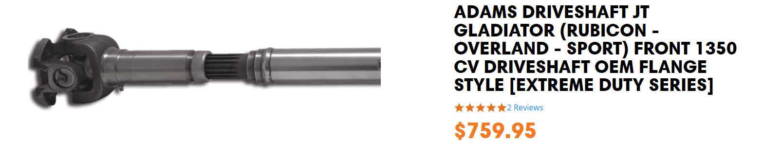

is it this shaft? If so -
This end - must be run straight, little to no angle. That's a single cross or single cardan u-joint and those can't be run with any appreciable angle.
I can't believe driveshaft makers put a single joint at the differential end of the shaft. It just boggles the mind. That end should have a CV joint since yo have to run the shaft uphill to the transfer case, and those with lifts often run heavy caster, meaning the pinion is tipped down, while the transfer case is lifted up farther from the pinion of the front axle.
What the heck is up with that?
A properly designed front shaft should have a double joint, or a CV, at the pinion end to take care of the extra caster, or downward tilt of the pinion, and the increased angle to the transfer case due to lifts.
IMO, it's a pissy design.
I've written about this before, even included youtube videos of shafts running at the angles some Jeep people need to run - with a single joint. It shows exactly why it's a crap design and why they vibrate or jerk when turning at angles above about 2 or 3 degrees. 1 degree is best, above that and you start phasing in RPM changes that cause vibrations.
I've never seen a driveshaft with the CV/double cardan at the axle end either factory or aftermarket. The pinion should be pointed directly at the output flange on the transfer case so the CV at that end deals with the angle and the axle end u-joint is square and happy. Before OEMs started using the rzeppa joints that's how all the front driveshafts were built and setup from the factory. The rzeppa at each end allows the driveshaft to handle wonky/mismatched angles at each end which is why they all run them now. The problem being they aren't capable of enough travel for long travel suspension setups. The issue in the JL/JT is the separation angle between the inner Cs and the pinion. You have to compromise caster in order to get a good pinion angle with a ujoint/cv driveshaft especially when running 3"+ of lift. The 2024 and up models with no FAD run into this issue even worse because they will vibrate in 2wd.
