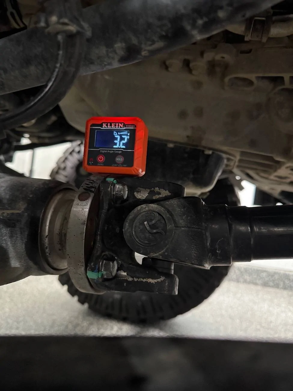

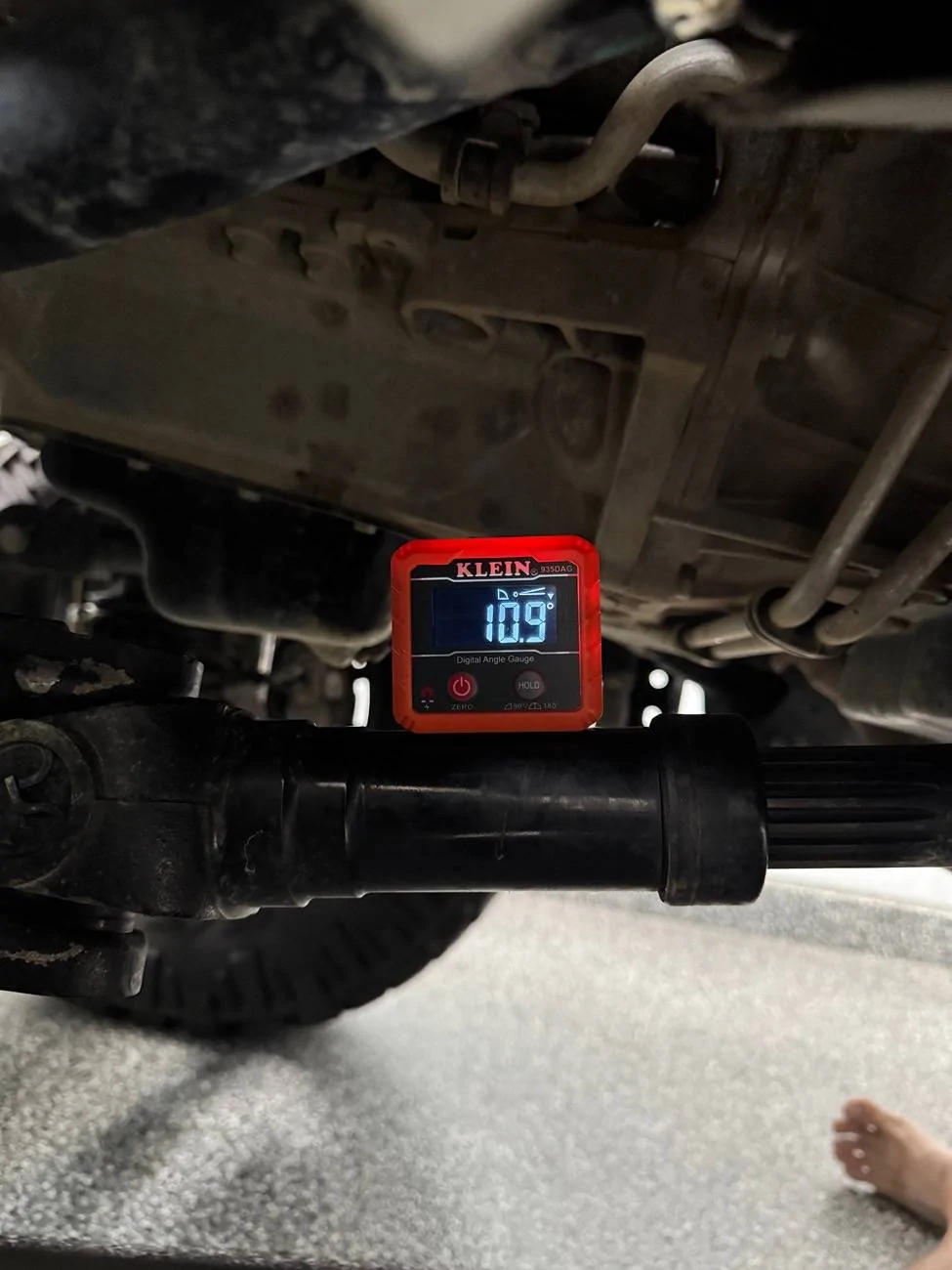

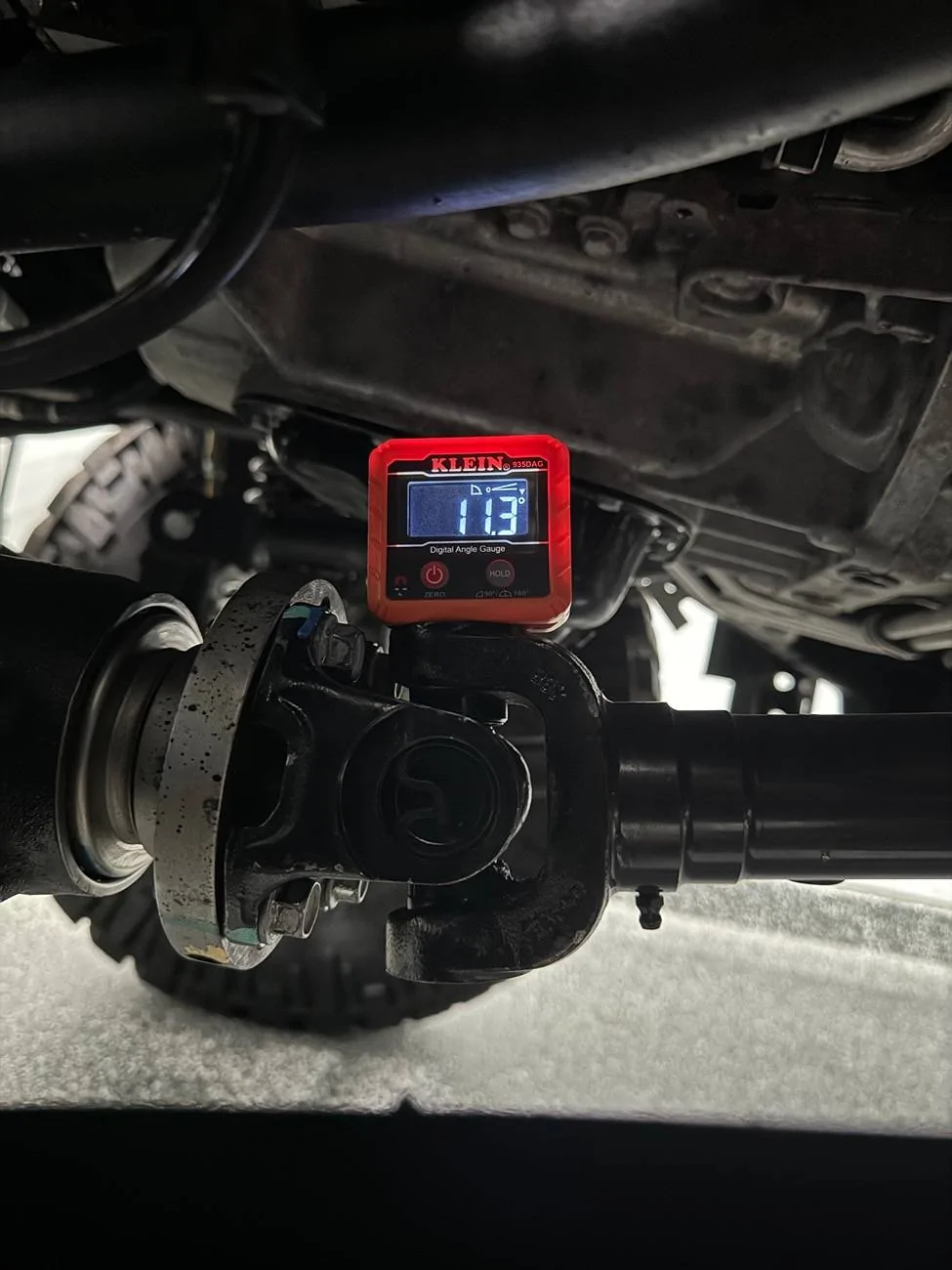

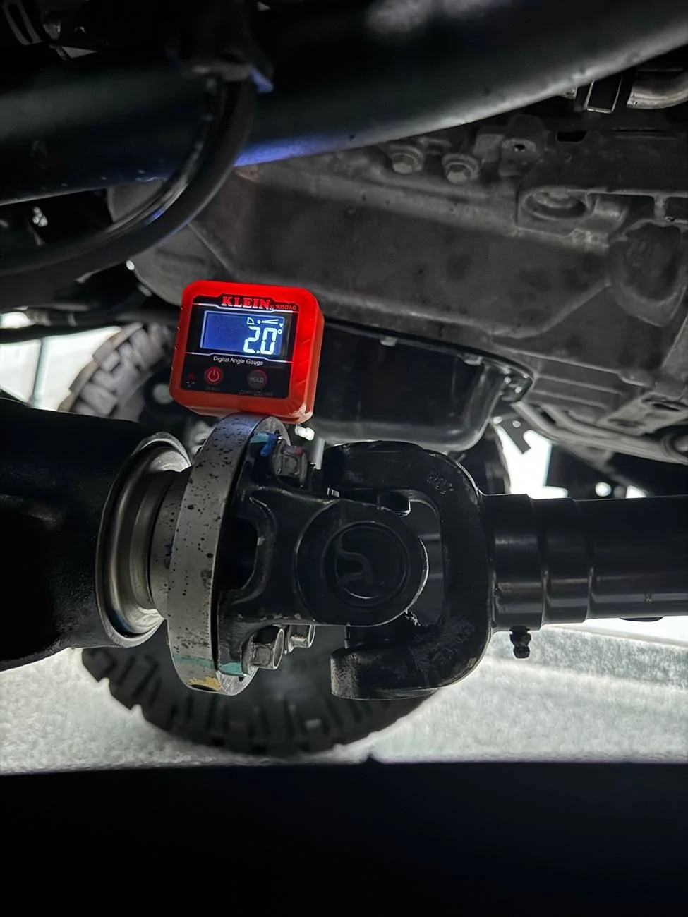

You’re absolutely right my bad. I fixed it. I have a pinion angle of 2 degrees and operating angle of 9.3 degrees. Earlier my pinion angle was .2 degrees and operating angle was 10.5. Sorry if I was using wrong terminology earlier. All new to this. My bad. But she is happy here. I’ll be testing everything this weekend on the trails! Thanks for all the help. And yeah my favorite comment was “doesn’t sound right” about a caster lower than 6 haha

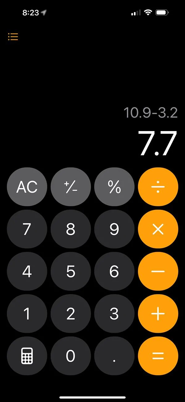

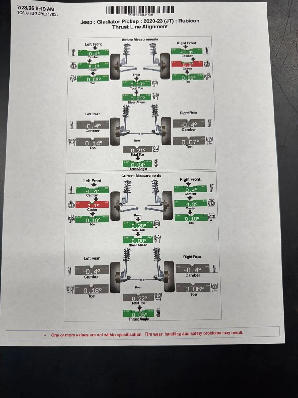

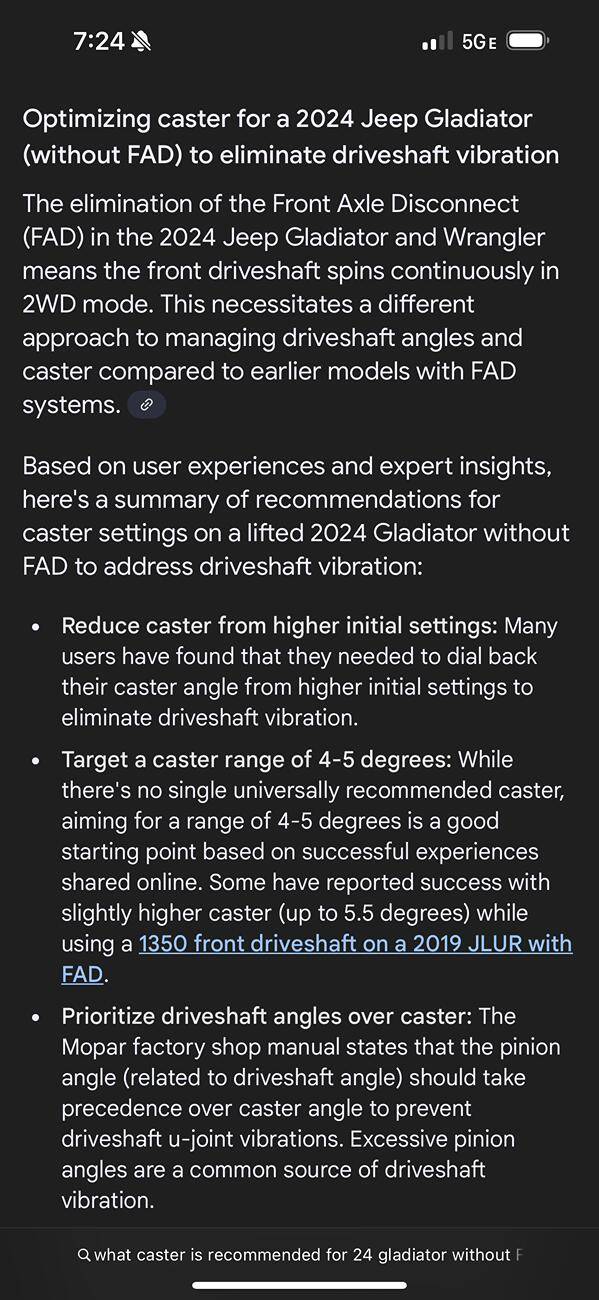

So a little update and the true fix/ caster angle needed to run a 3.5” lift (with 1350 CV driveshaft) on 24 and up gladiators without driveline vibrations. Still was having slight vibrations once everything settled with an operating angle of 9.3° and caster of 5°. So went back to the alignment shop and had them move the caster to 4° which is the lowest I’ll go. Left me with an operating angle of 7.7°…Finally!!!!! No more driveline vibrations at 60mph. No more driveline vibrations once so ever at any speed. The steering still feels great. Maybe the return to zero isn’t as good but I stopped noticing after the first drive. Tracks straight and does not wonder. Hopefully this helps the people with 24 and up who were lost like me. I truly believe this is the best caster for 3.5” lift on 24 and up gladiators without a FAD.

Happy to hear your solution, I’m going to try 4.5 degrees of caster and reinstall the Metal Cloak driveshaft, then I can remove my limit strap and use all the down travel my long shocks allow. Thanks

Like last time… vibration came back. It’s definitely less. It’s still worth the sacrifices to steering running the lower caster for a better operating angle. I started digging into the 392 wrangler forums since they have been dealing with this issue longer. The true fix is getting a high pinion axle housing or a new high pinion Dana 44/ Dana 60 complete assembly. Also modifying the existing housing. All super expensive. It boggles my mind that some major company hasn’t came up with a sub 1k solution for this issue. Teraflex makes a high angle Rzeppa front driveshaft for JK’s that would solve all the problems. It would be awesome if they would make it for JT’s and JL’s. Or if someone would make a FAD completion kit. But I bought this Adam’s driveshaft without knowing it would cause other problems. All the lift companies should be pushing for a solution.
