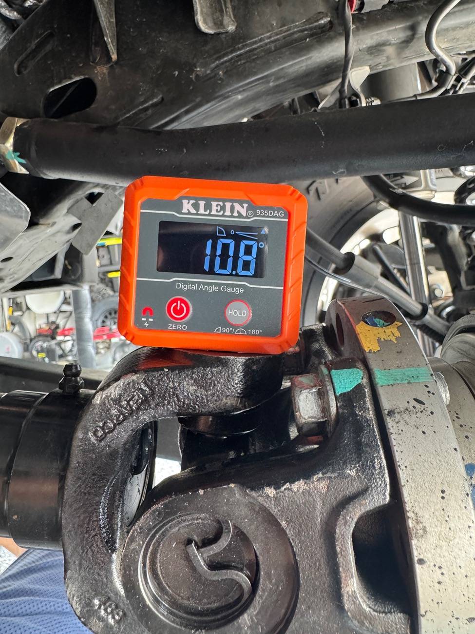

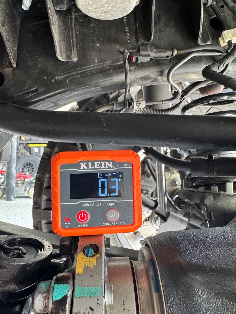

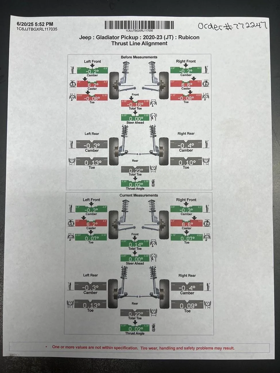

So I got ahold of my alignment print out and found I was at 6.6 caster. Putting me at a 10.5 pinion angle. Talked to the guys at Adam’s driveshaft and they agree that angle is to steep. They said I should shoot in the 4’s for caster but might be able to get away with a caster of 5. So my steering shouldn’t be to bad. Should have everything done by Wednesday. I’ll update then! Hopefully I’m dialed in just in time for it’s first time out at badlands, IN
Offense but I dont think I would use the uneven surface of the yoke as a measuring point. JMHO
I’ve kinda had it with ya lol. I’ve kept my peace but you have had something negative and conflicting to say with every comment. That’s where I was told to measure. I moved it around multiple spots and they all read the same. You were completely wrong with your advice on caster angle. Only negative comments and zero help so offense taken

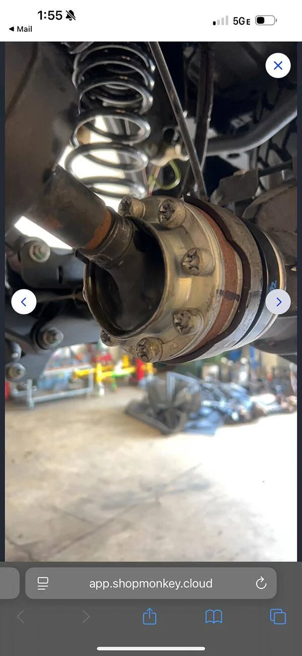

They are gonna do an alignment and it’s covered. So why not right? Also the shops right off the highway so I’ll know right away. Also they need to adjust the rear as well cause at full extension the rear driveshaft hits the collar so I’ll have them adjust that too.
