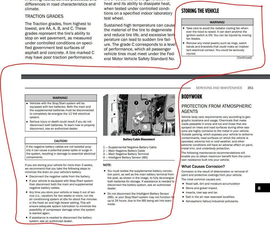

IMO, starting & running the engine without driving the vehicle and getting it up to full operating temperature is not good for the vehicle. You are better off just letting it sit.
Pages 350 & 351 of your Owner's Manual covers Jeep's official recommendations for storage:
Note that they are having you disconnect the batteries instead of using a battery tender/minder/maintainer.

Damn! I have looked and looked for this very page. I gotta quit drinking. I must have past this multiple times
