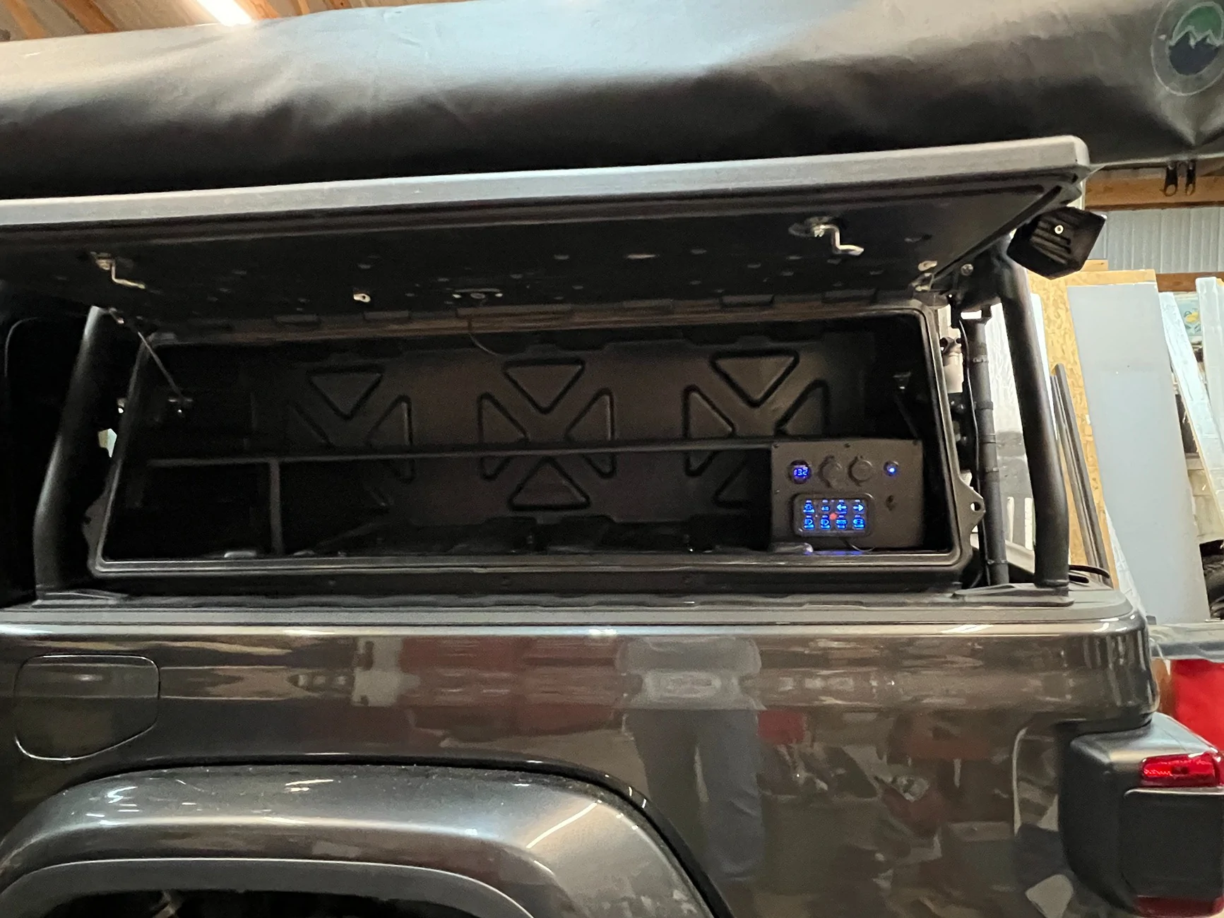

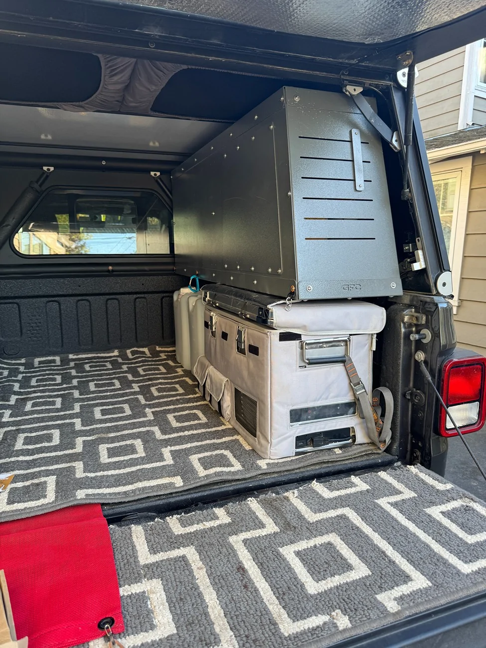

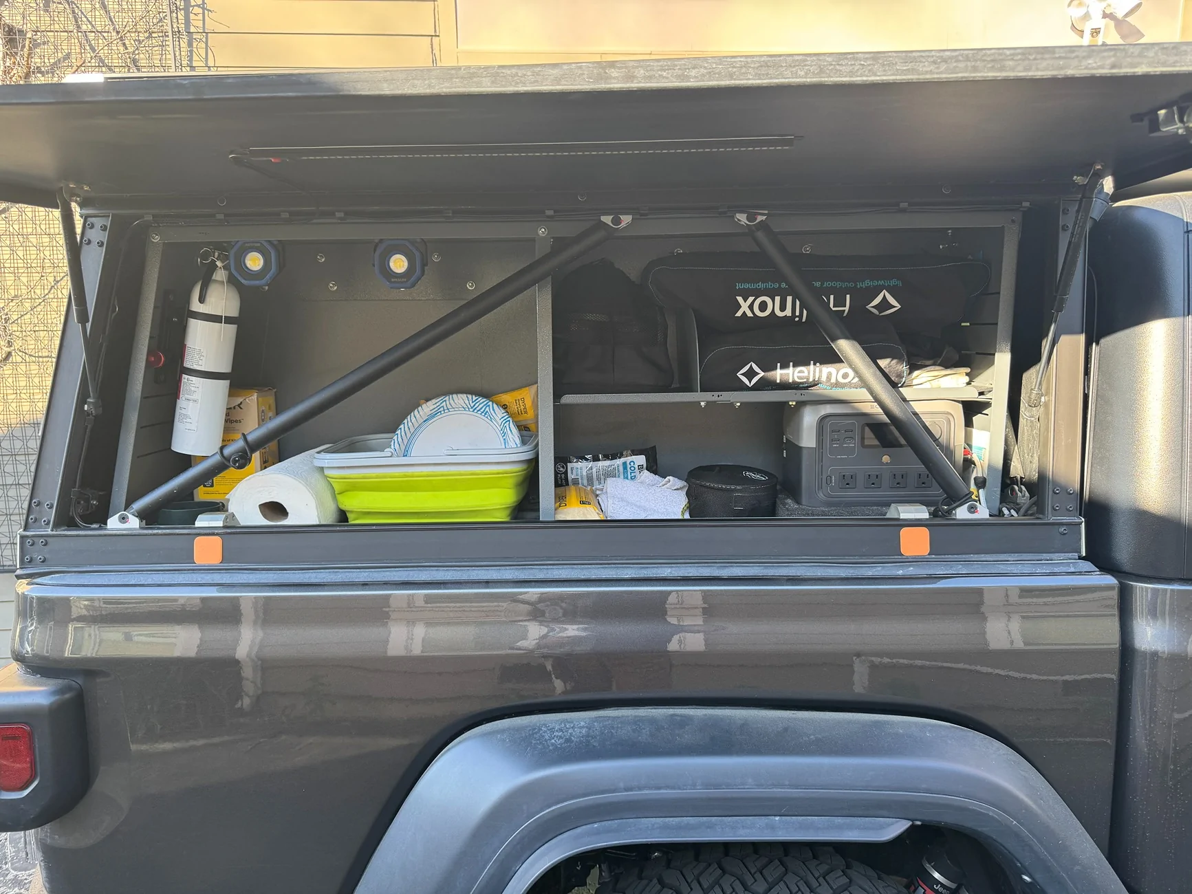

My JT is a dedicated overlanding rig; I have an portable power stattion (Ecoflow River 2 Pro) which is mounted in the storage cabinet in of my GFC (basically in the bed). It charges from the alternator when I'm driving and from a solar panel on the tent roof when I'm parked. All of my stuff (fridge, Starlink, phone chargers, etc) runs directly off of the power station...so there's no switching of anything when setting up camp.

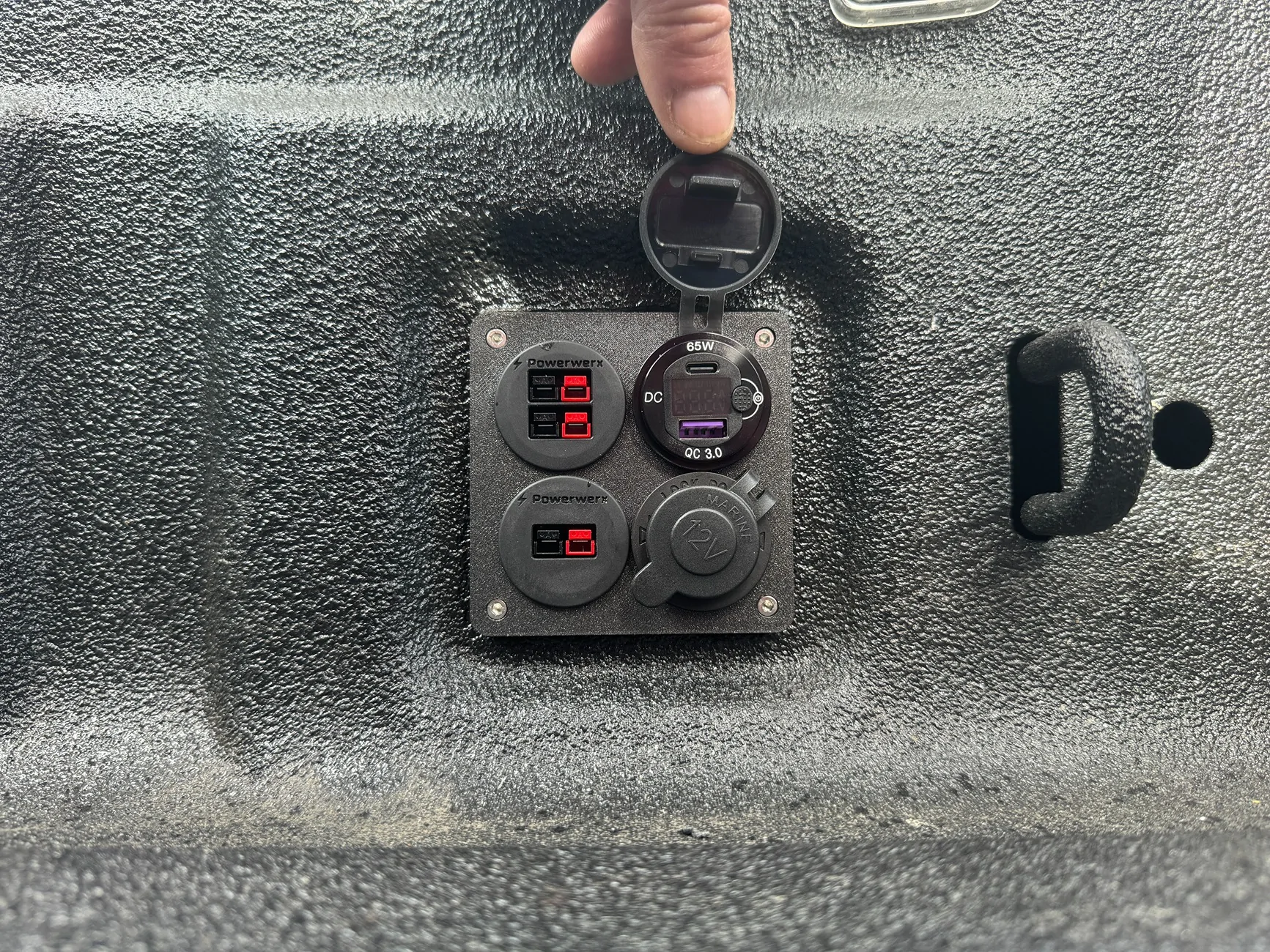

I installed a panel like the one you described in the factory 115V outlet location. It comes in very handy and it is switched on/off (via a relay) by one of the JT's Aux switches .
The Ecoflow River 2 is rated at 768Wh (comparable to a ~60Ah 12V deep cycle batt) which is more than enough to keep everything running overnight. I'm sure Jackery and other mfr's offers similarly sized ones.
Yes, your winch/compressor/lights will need to be connected to the main battery.

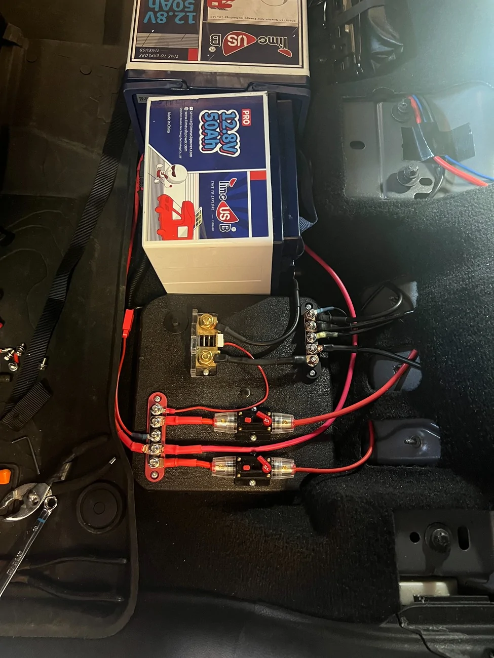

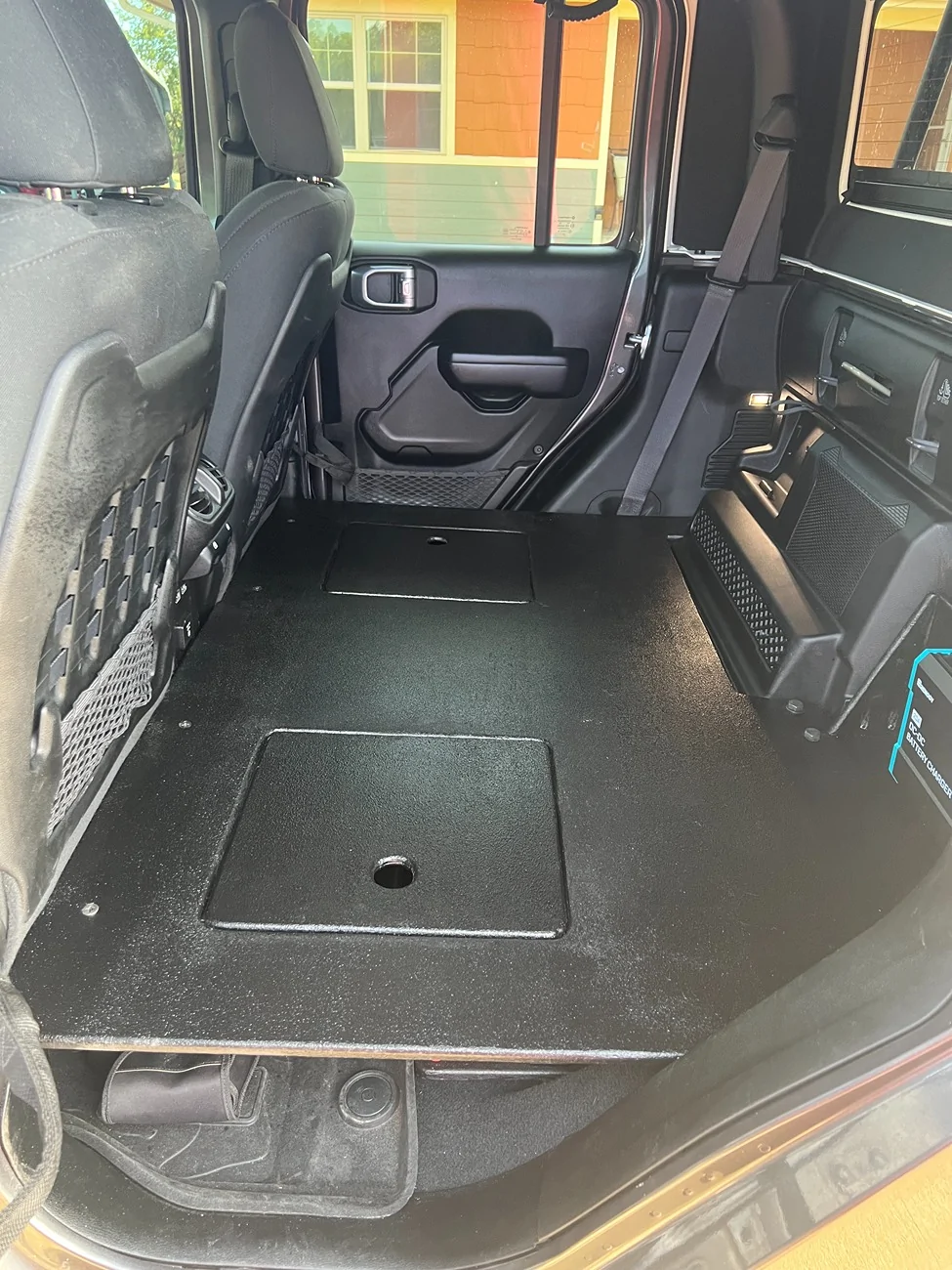

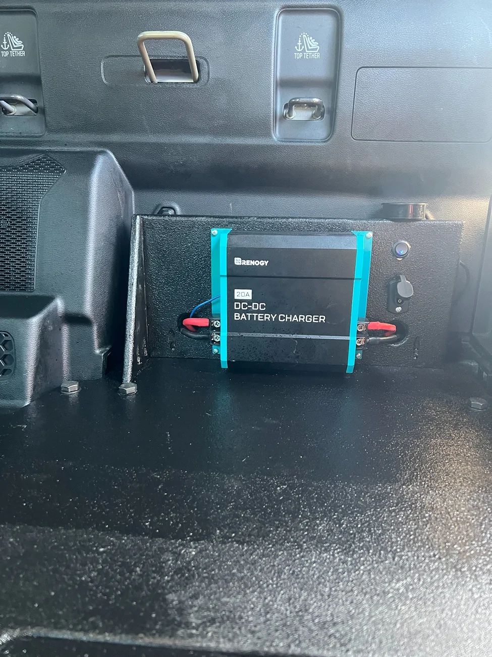

I run a traditional dual battery system. I do not have any need for 115V so I have no need for a power station. I use a Renogy 40amp DCtoDC (recently upgraded from the 20amp), 100Ah LifePo4 battery(2-50's under seat delete), shunt for monitoring and a AuxBeam switch panel on my bed rack. I have multiple lights, power to the tent, power for diesel heater, power for water pump. I use the 30amp SAE connector for my fridge and diesel heater. I do not like using the cigarette style plugs.

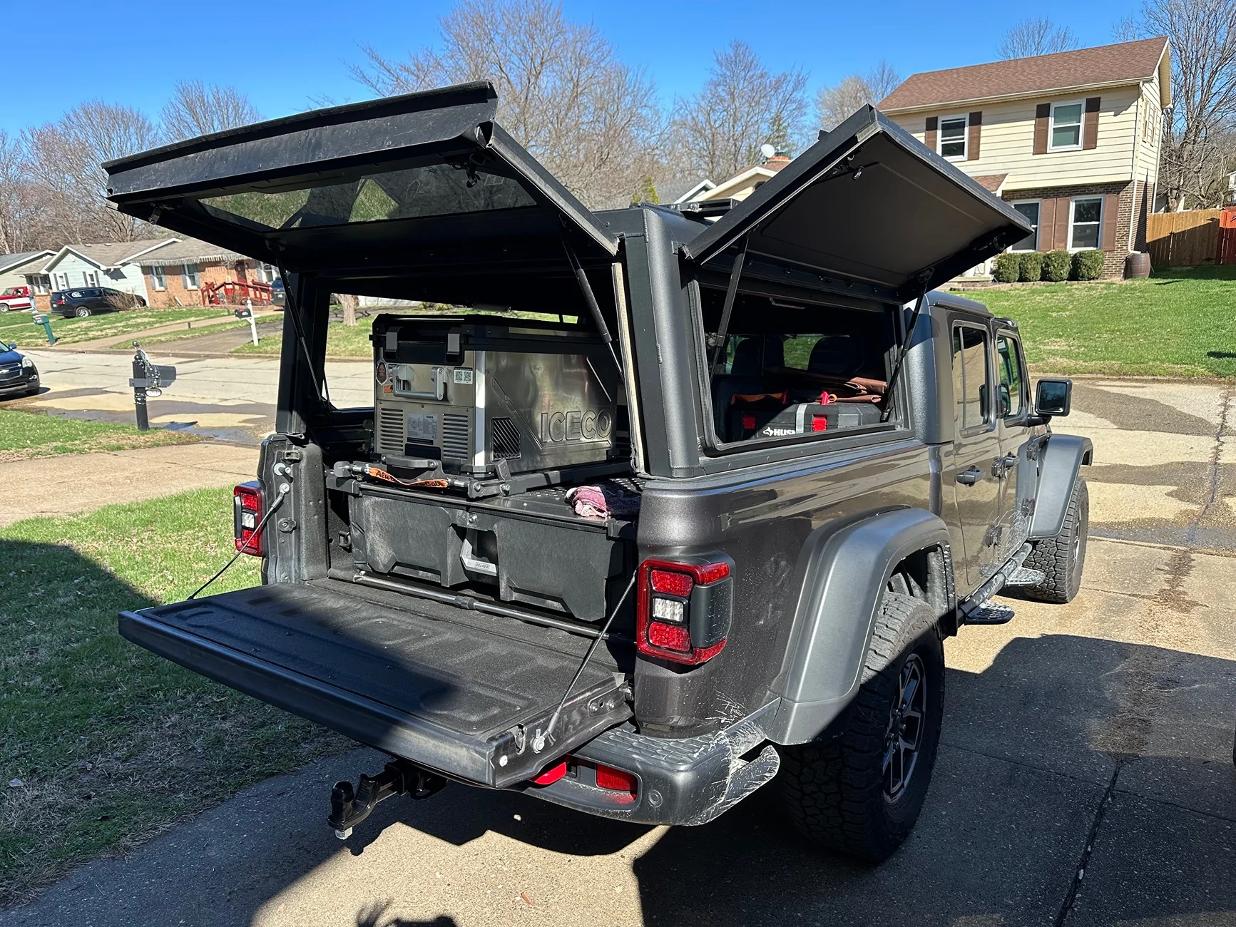

I havent swapped the system over to the Gladiator yet, but in my Silverado, I ran a APL55 fridge and Starlink on a Bluetti AC200L power station that was mounted in the bed. I did have 12V power routed to the bed, but the power station charged almost exclusively from a 200W solar panel on the cap. If it was cloudy for several days or if I was driving for hours at night, I would charge the power station from the vehicle 12V. I had just purchased a Bluetti Charger 2 that will handle the tasks automatically (switching between solar and alternator) but I had not installed it before I wrecked my truck. Hopefully I will have it all in the Gladiator in the next month.
The AC200L gives me a pretty large AC inverter, so I can run almost anything you would run at home. I also have a 30A outlet on it that I will often plug my travel trailer into when I want to use the microwave (almost everything else in that runs on 12V off-grid).
If you don’t want to hard-mount panels, you can also use the Charger 2 and deploy foldable panels when camped.

My cabinet is a Turbo Cubby from GFC.
I picked up my River 2 at Costco... but right now it's on sale directly from EcoFlow for only $379.
