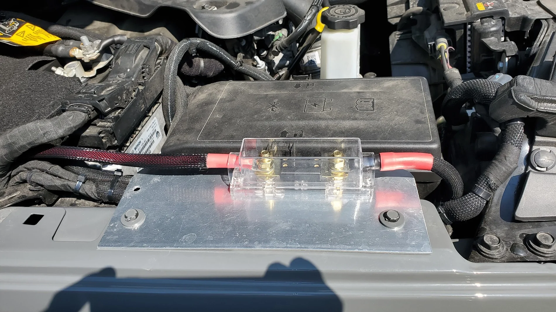

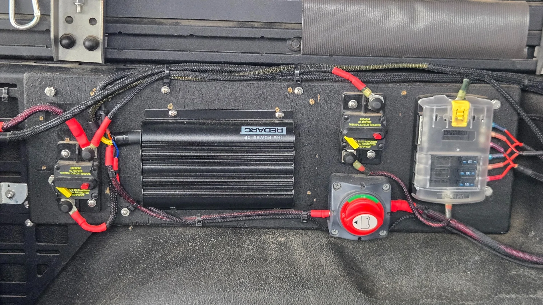

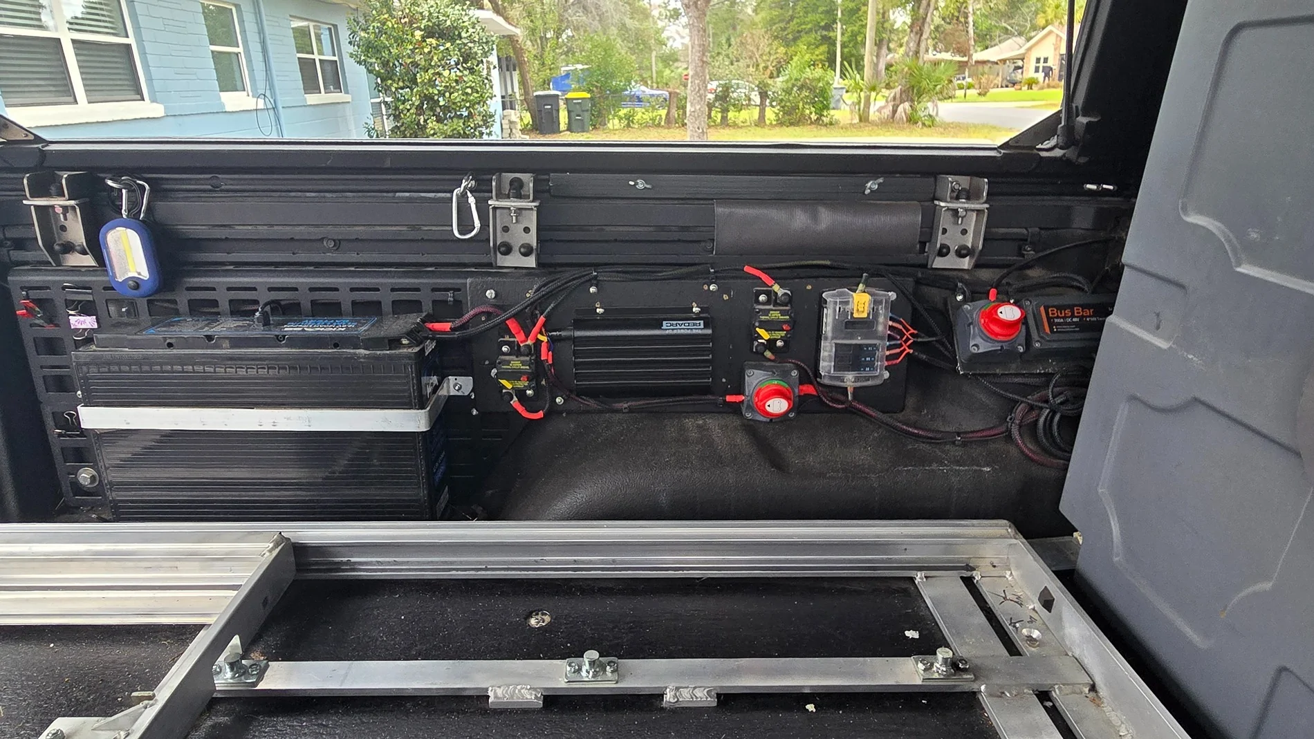

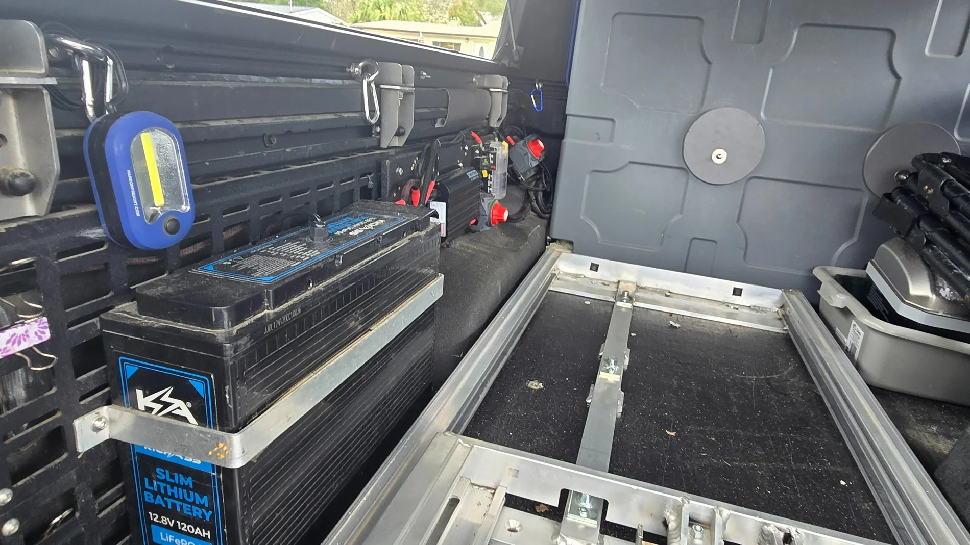

Here are pix of my battery setup. I bolted plywood to the molle panel to have something to attach the switches, breakers, and controller. The KickAss Slim 120 battery tucks in behind the wheel well so you don't lose any bed space. I started with a Renogy unit and after two of them failed and HORRIBLE customer support from Renogy, I switched to Redarc BCDC 1225. Very glad I did. The KickAss battery has bluetooth that connects to their app to monitor charging. There are isolation switches for the solar panel and the main battery connection. The bus bar next to the water tank is grounded to the frame underneath, above the spare tire. All of the wiring that goes outside the bed can be routed through holes that are already there and make sure you add rubber grommets to protect the wires. If you use marine breakers like these, get Blue Sea. There are cheaper knockoffs, but I did not want to depend on cheap stuff.
