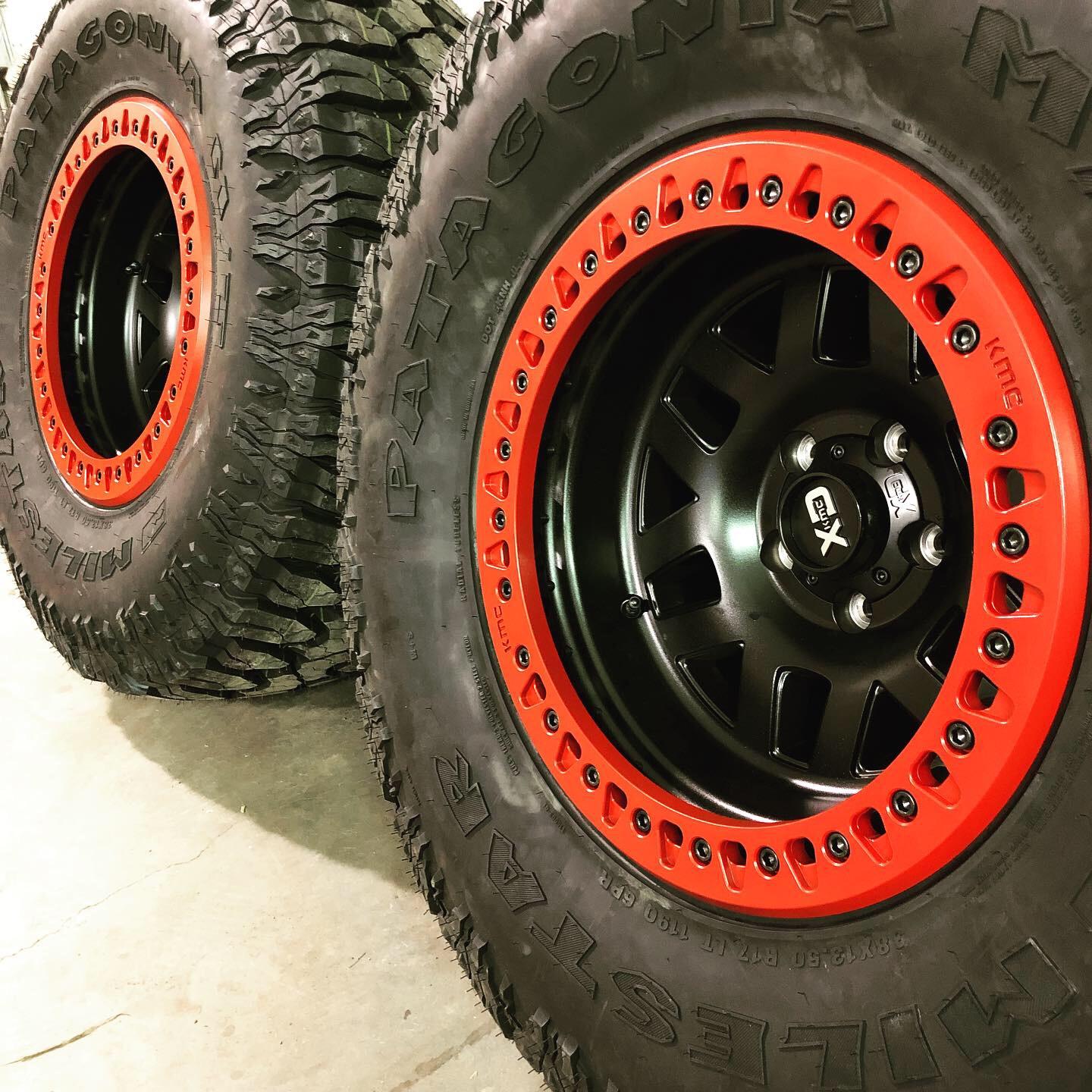

Okay thanks! Thatreally doesn’t seem like a PIA.. I’ve been doing a little work and the only drawbacks I’ve seen is cost. Found a DV8 wheel on Quadratech going for $300 as the most reasonable so far.
https://www.quadratec.com/p/dv8-offroad/882-series-wheel
I like your setup. What wheel/tire combo are you working with??
Frostbite
Aug 19, 2019
Washington
It really isn't a ton of extra work. If you wheel a lot its worth it.
I'm running this setup..
KMC XD229 Machete w/ 3.5" backspacing
38x13.50 17 Milestar Patagonia MT
I painted the ring to match the red on the tow hooks and other things. They get scratched up in the rocks but they look nice when fresh.
