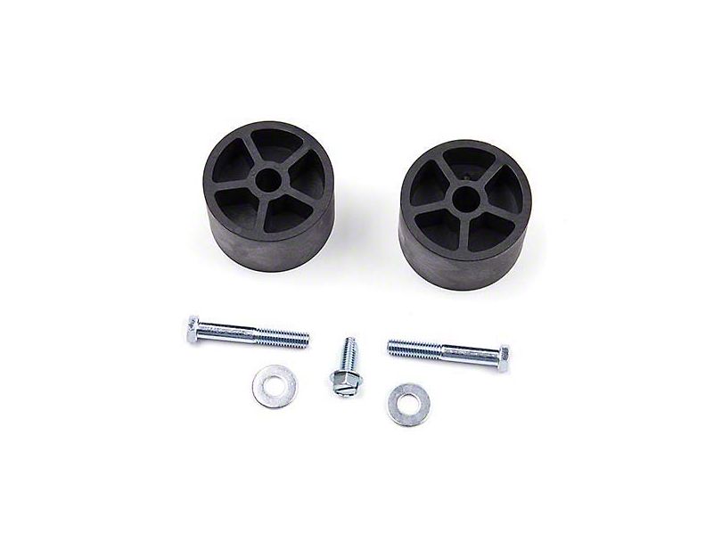

Thanks, I have the AluCab
Our full height is about 2" lower than the top of the roof. So if your AluCab base needs more clearance than that it would be pretty easy to mount it to some 2" spacers. The plastic spacers they use for bump stop extensions work great for such things.
