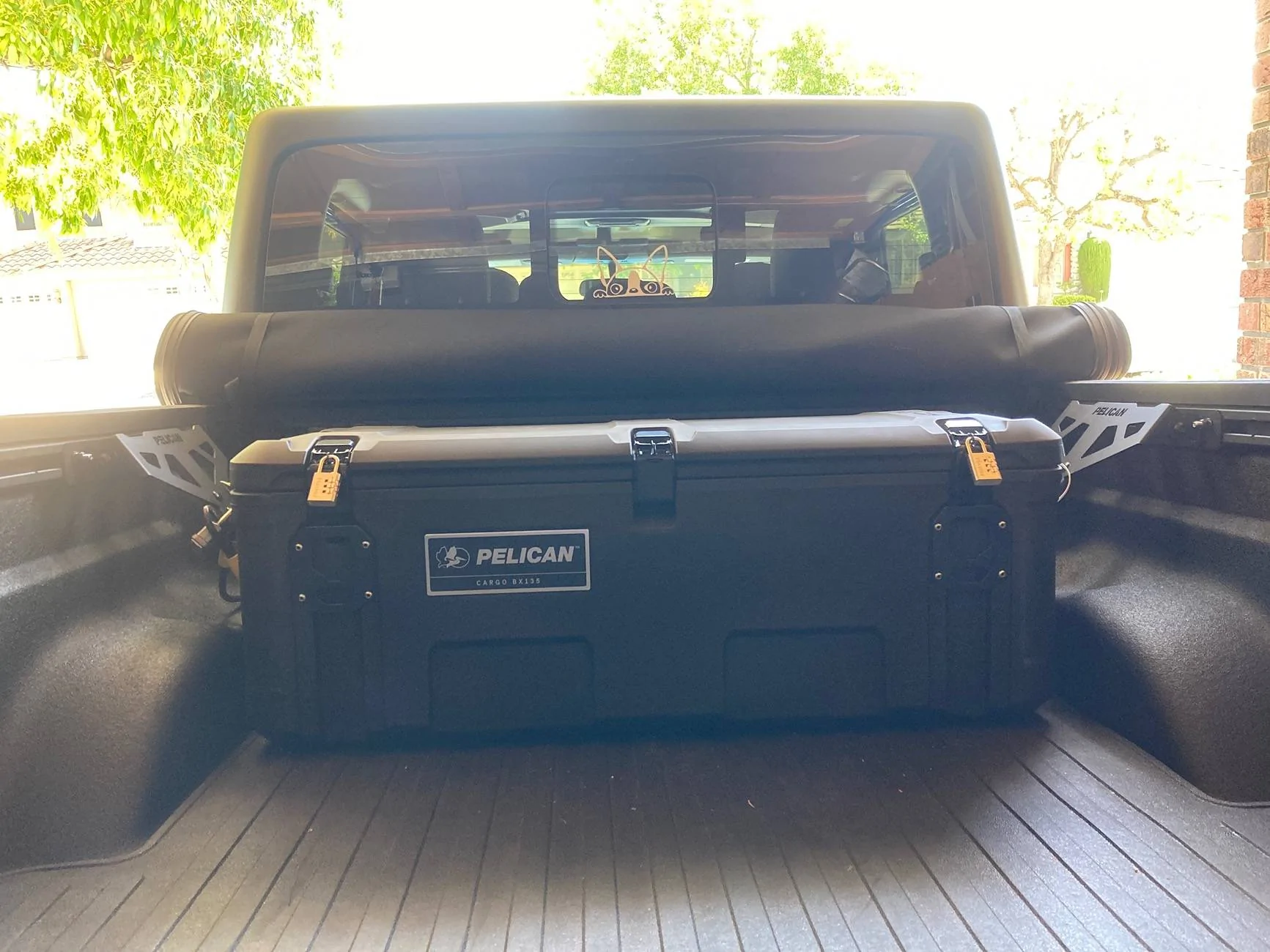

I’ve heard of this being done but wanted to get feedback on the idea of building 8020 storage, similar to GooseGear, that instead of mounting to a bed bolted base plate, all of the containers are mounted to either the bed rail system or AluCab channel that runs the exterior.
I have this Pelican setup for over a year and has worked great attached to the rail system

Canopy is putting pressure on the bedside where it sits fully seated above it. All of its weight moves inline with the bed. The problem with rail attachments is when you have a load that isn't anchored or weighed down to the bed, then the weight of that will move separately from the rails. If it's fully seated on the bed with some good weight, it wouldn't matter as the bed rail attachment is really just to stabilize or anchor it in place. Something like @Commodus is fine, the full weight is on the bed. Those bed rail attachments for stuff like packouts or tanks that don't seat on the bed, however, can be problematic.
If you have a cap, I suggest using a flat plate attachment with t slot for extruded aluminum rails you put in between the mounts for the cap.
