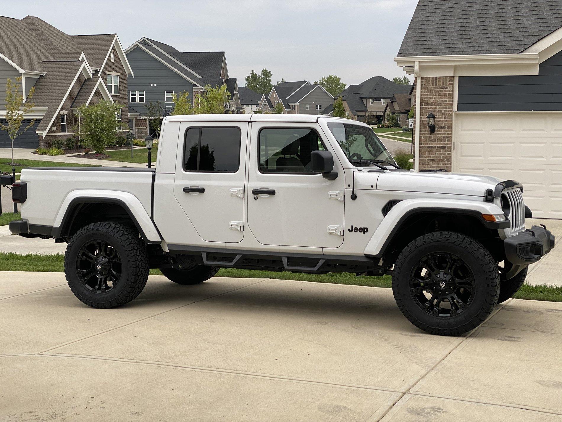

Overland w/ MOPAR 2” Lift, 20” wheels, 35” tires
Jeep Gladiator Best lift for Overland with 35's or 37's 24C50781-3EC4-4380-9BEE-09961A98402D

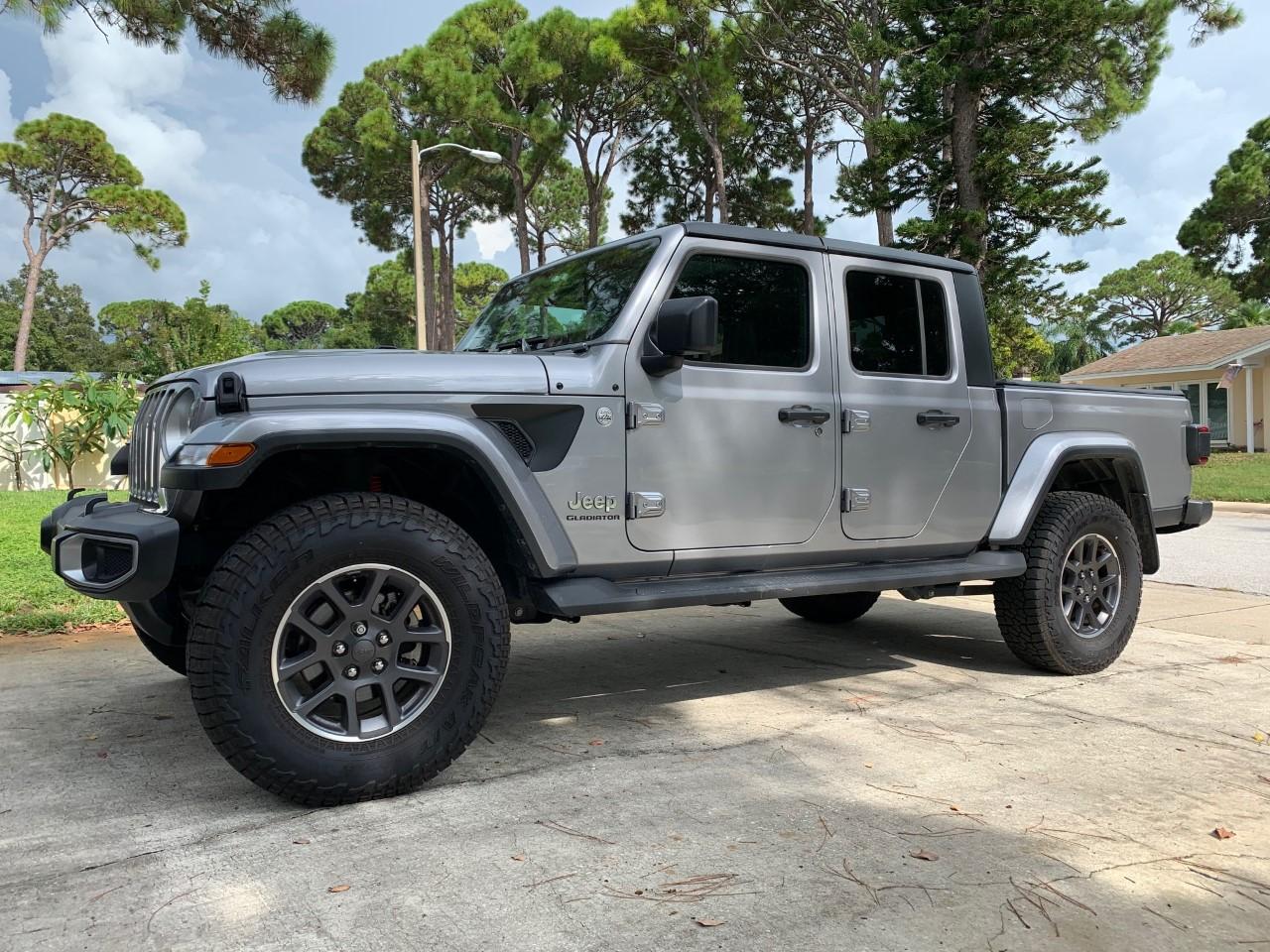

Overland with Iron Rock 2 inch lift, DT8000 prerunner shocks, on stock wheels with Falken 285/75/R18 tires (35s). Tazer used to reprogram TPMS and tire size.
