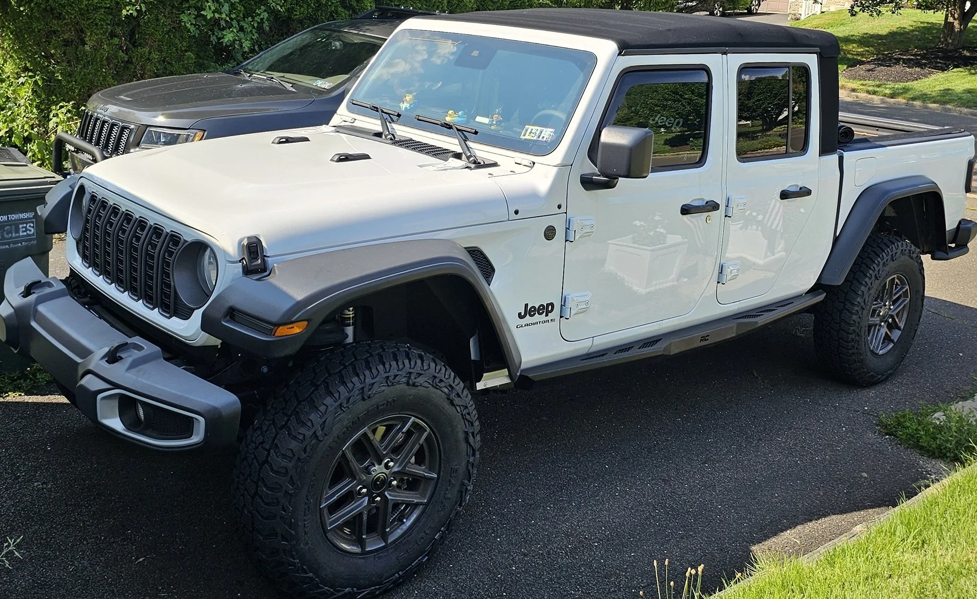

I'm building my gladiator to do similar things. I went with the mopar 2 inch lift and 35 inch tires. It probably gave me close to 3 inches of lift total. For tires I went with the Mickey thompson baja boss a/t's in 255/85r17 size. I think its the perfect combination to do what I want to do.
