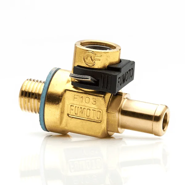

The only down side to the Fumoto is how far it sticks out on a Jeep.
I've used Fumoto Valves for decades. This is the first vehicle I haven't put it on because it's vulnerable off road.
Femco has a decades long rep similar to Fumoto and this new brand referenced above looks good.
I'm estimating how far each stick out from the face of the bung on the oil pan. It's not exact, but pretty close.
oil bolt - 1/4 inch
Femco low profile - 3/8 inch
Fumoto - 2 1/2 inches.

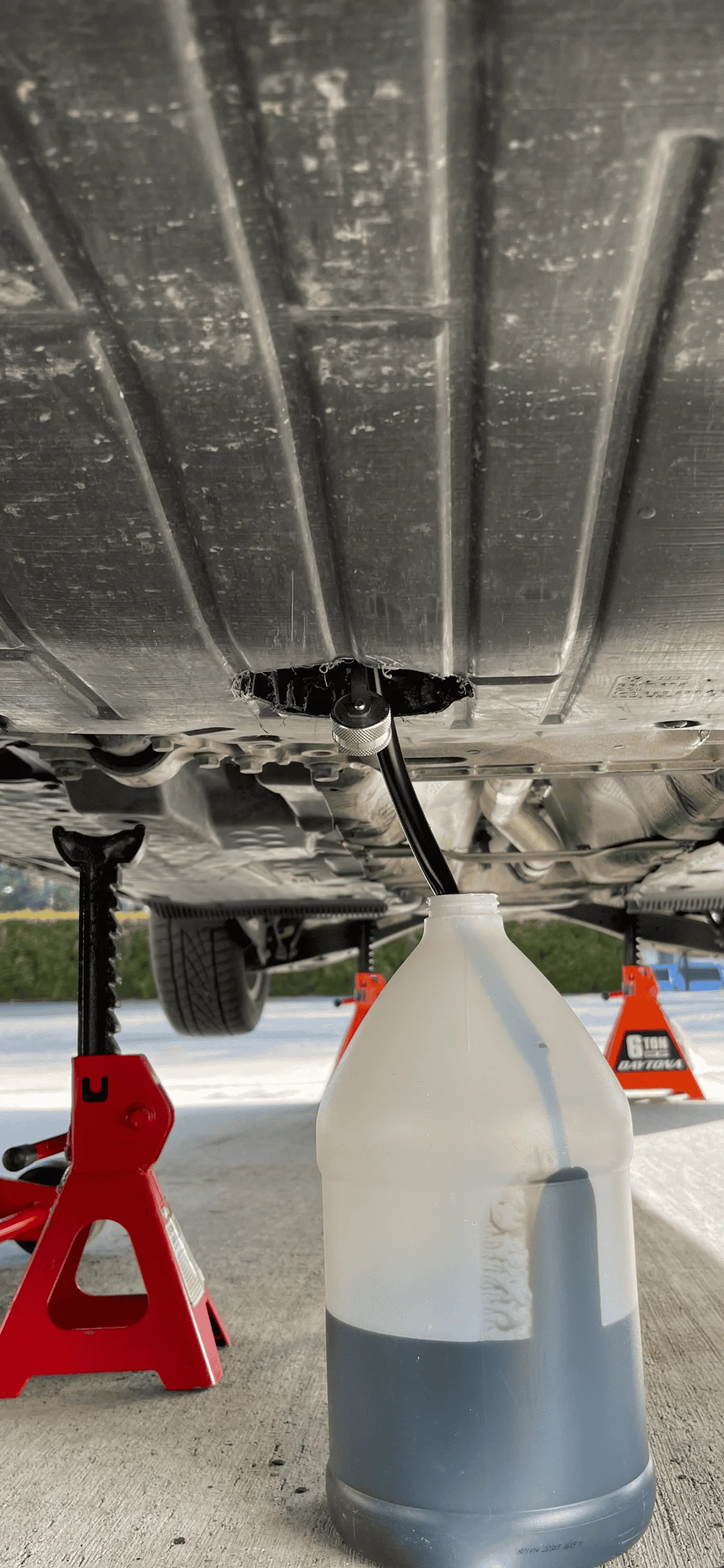

I converted to the valvomax…. It’s literally on every vehicle now. I love the twist on- rout the hose through a small hole in the skid plates, straight into a jug- the secondary leak protection…. ??‍♂ in my opinion it’s all that and a bag of chips more than the other valves.
Photo of the VW…. Seriously disliked removing 20 screws to dump the plastic air diffuser in order to drain the oil….. future skid on the Jeep will be nice too….. no more slight breeze blowing oil onto the skid and running all over.

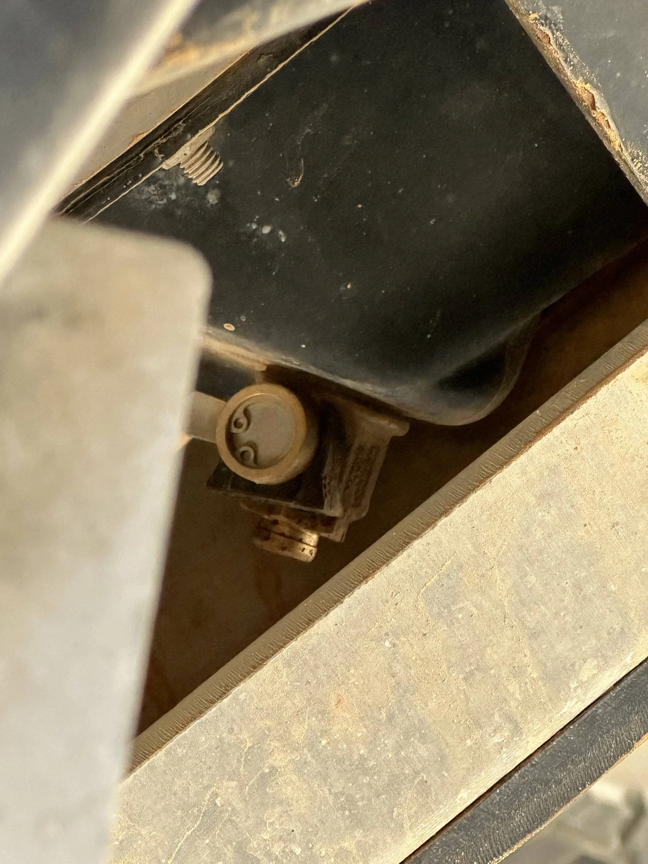

I should have clarified. I've always used the one with the hose nipple and want to continue to drain that way. I like draining into a bottle.
The Fumoto with the nipple is LOOONNG,.
Jeep Gladiator Best oil drain pan for me??  Best filter?? 1698088674061

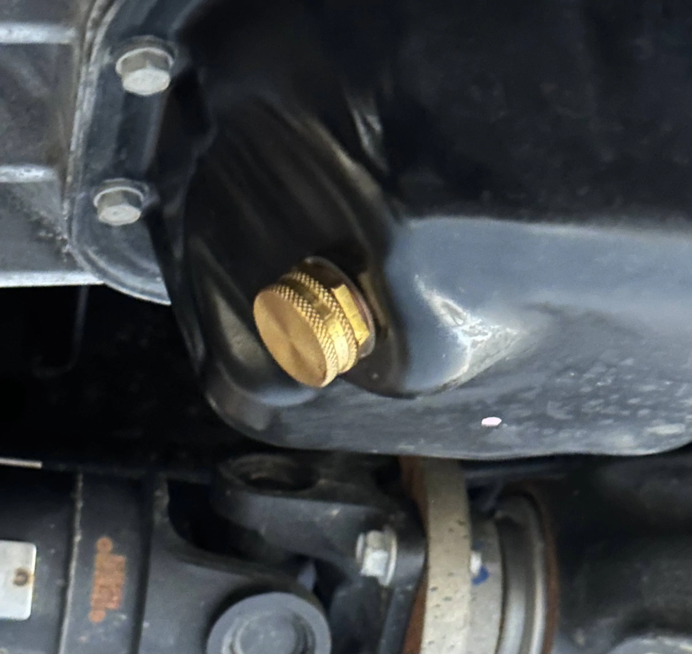

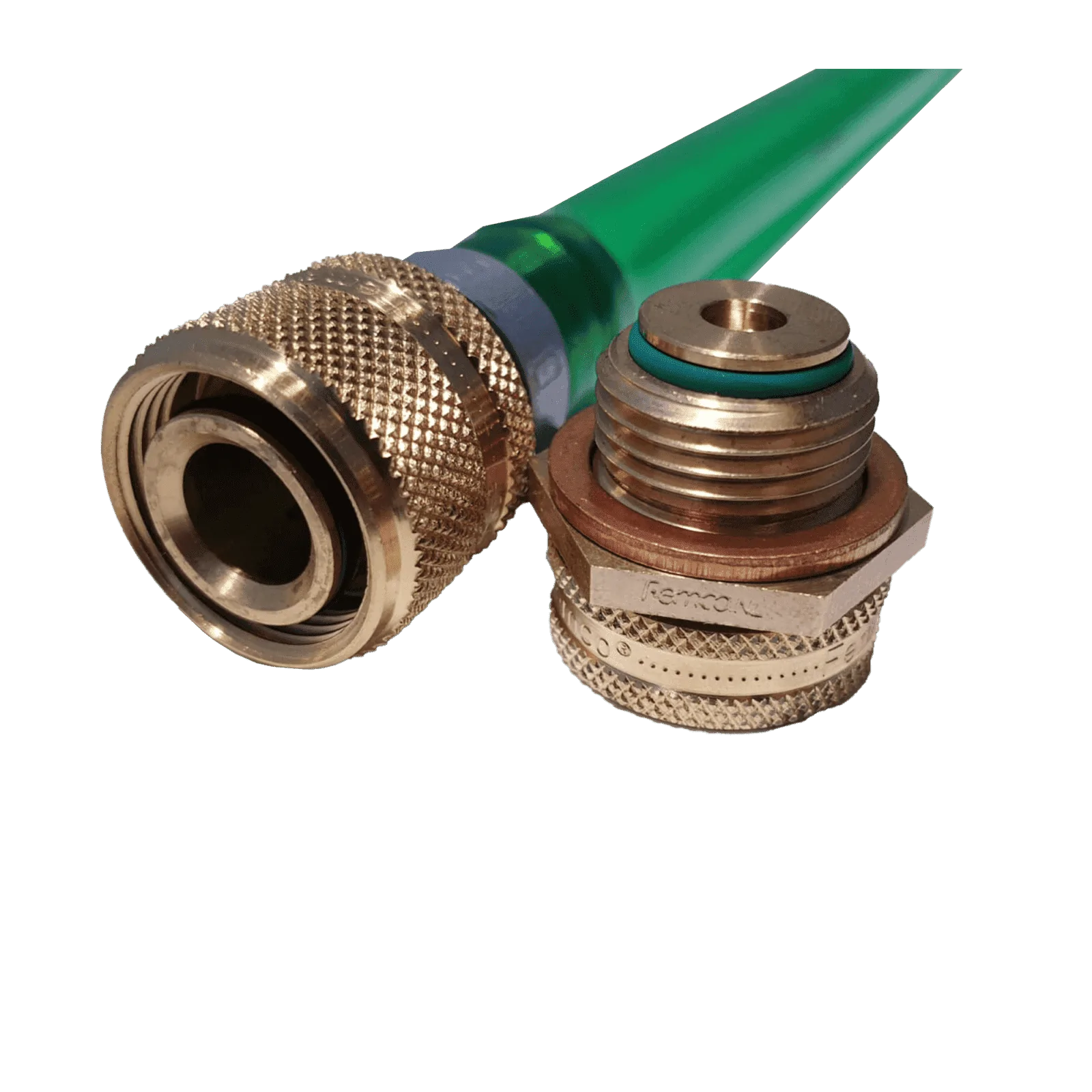

This is the Femco on my Jeep. To start the flow you attach a fitting with a hose on it.
Jeep Gladiator Best oil drain pan for me??  Best filter?? 1698088804171
My fumoto is much smaller. Only drops a hair below the pan. But mine is protected by a skid.
Jeep Gladiator Best oil drain pan for me??  Best filter?? IMG_7866

Interesting. It even looks like it has a short nipple on it for a hose. If I had a skid plate, that would be perfect.
It does. I use Fumoto’s 3/8” hose with the white plastic end that snaps over the nipple. Works great.
