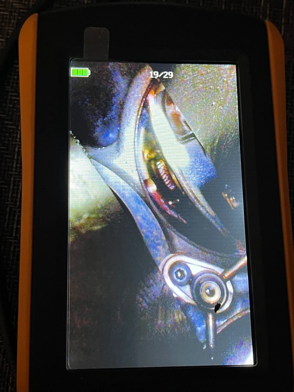

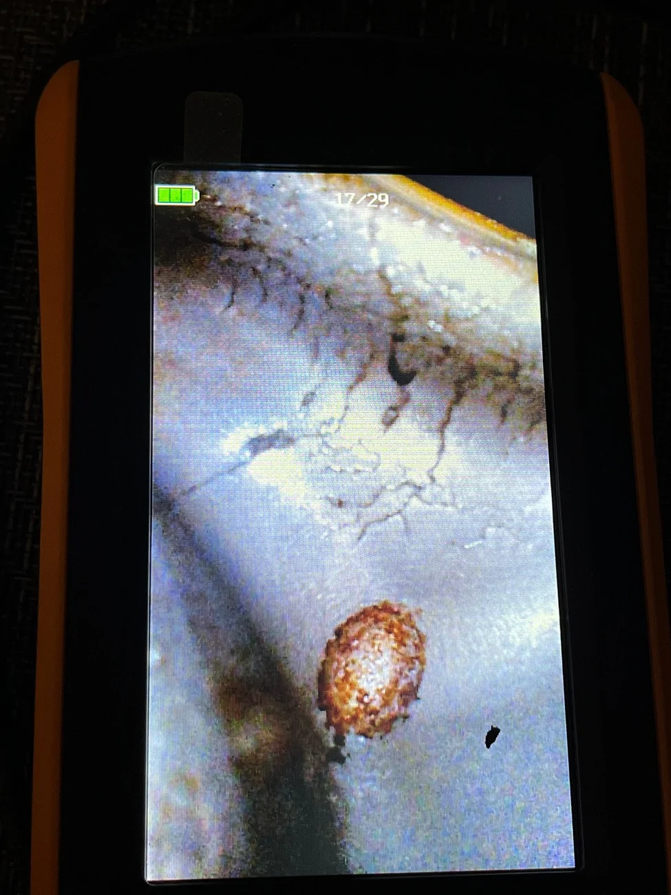

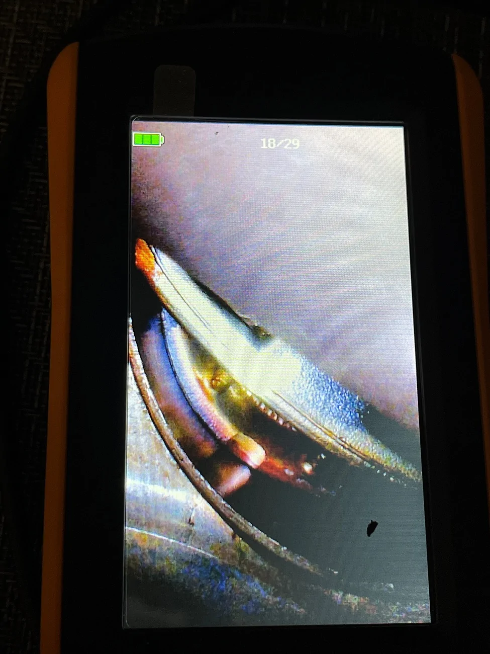

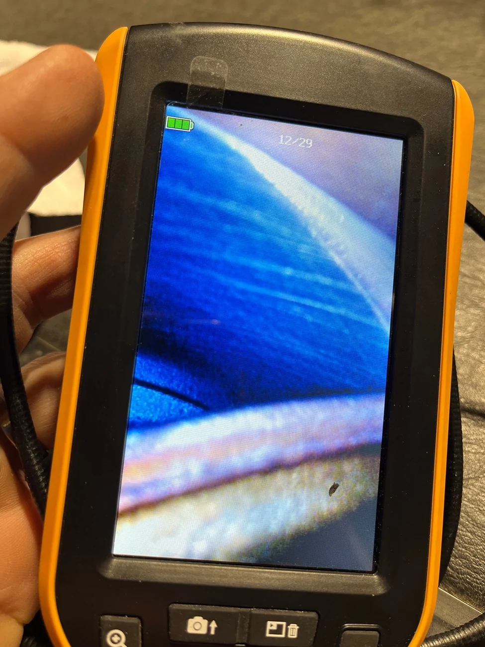

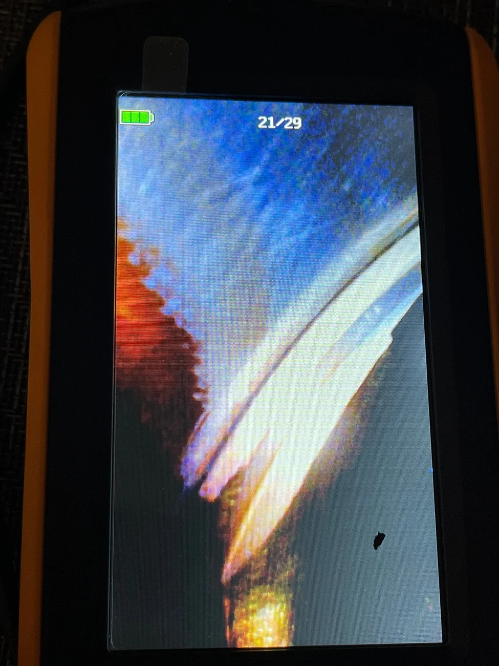

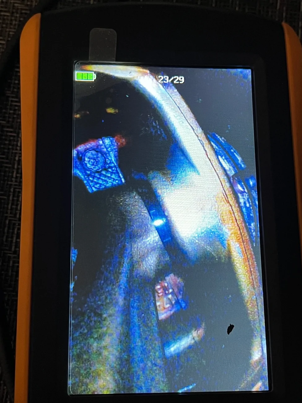

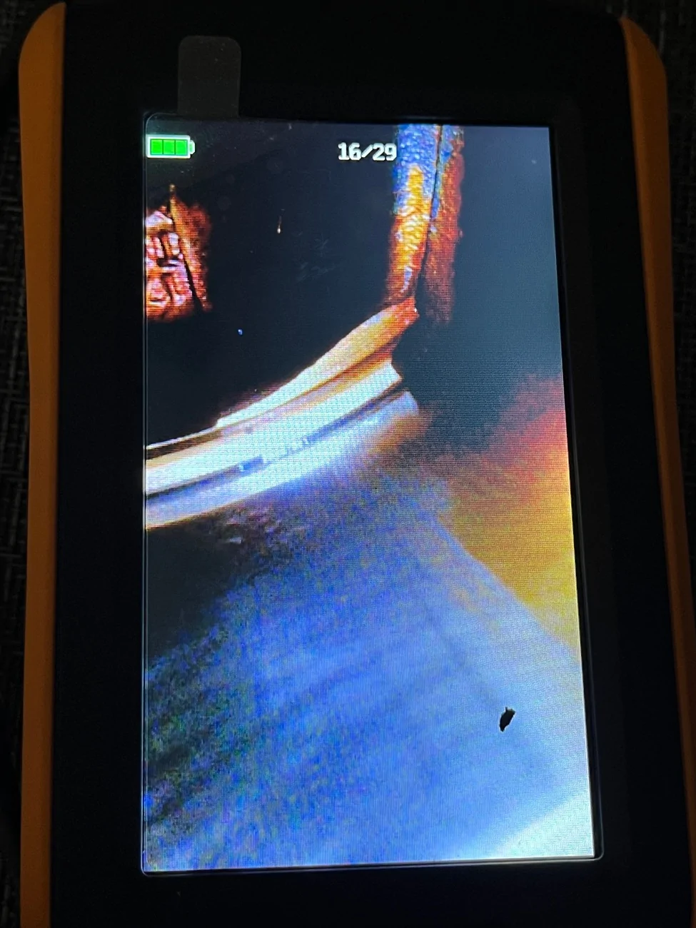

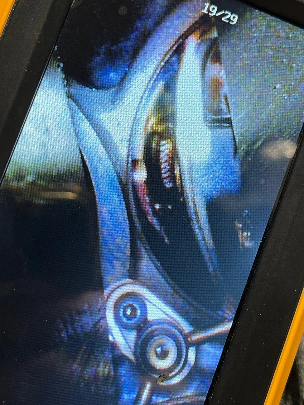

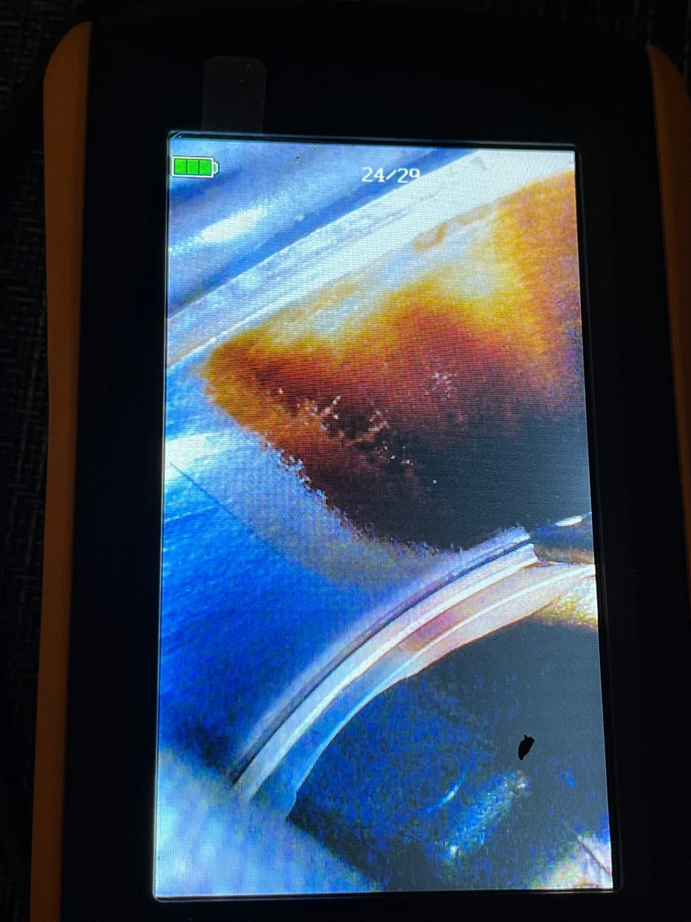

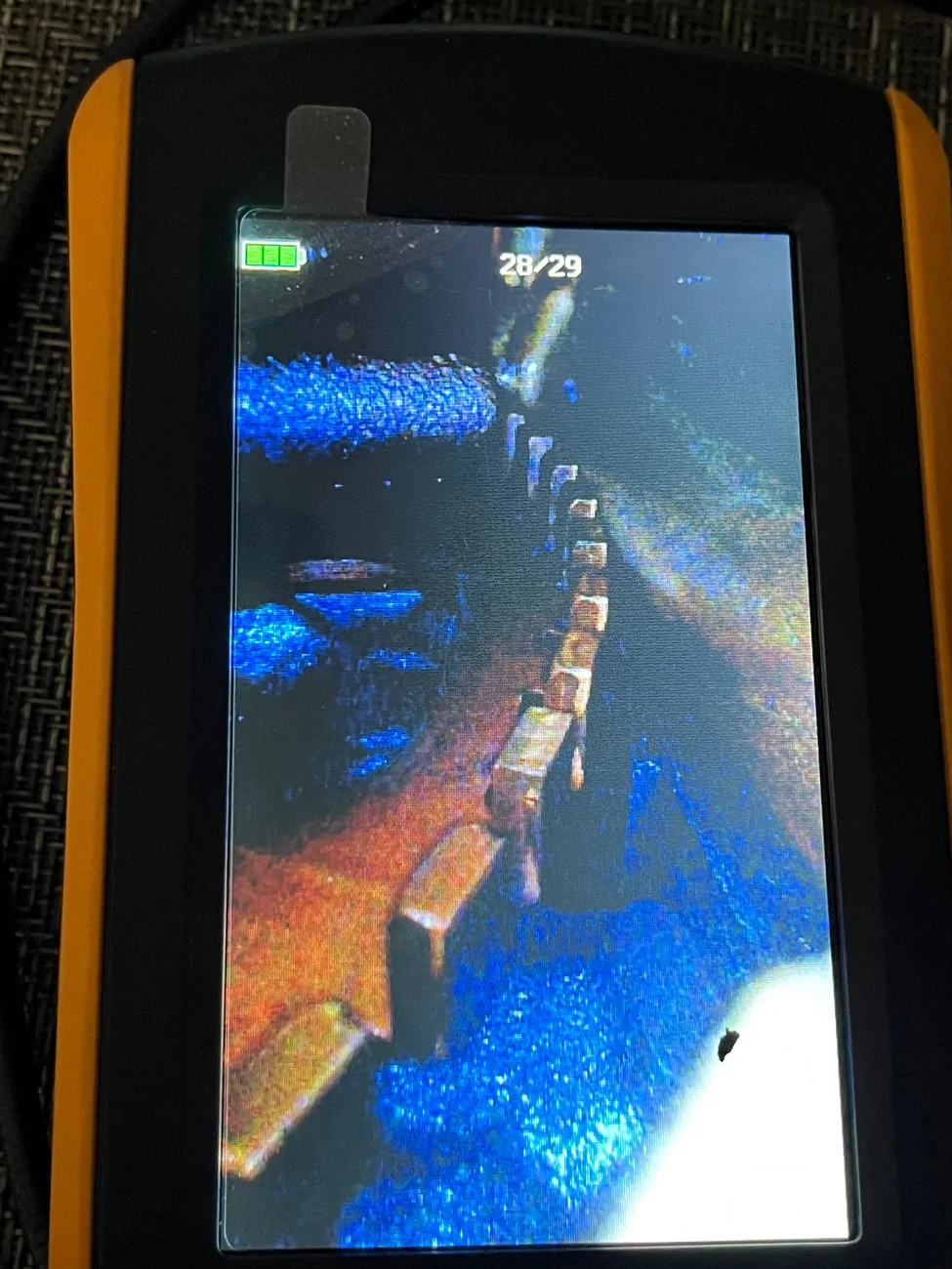

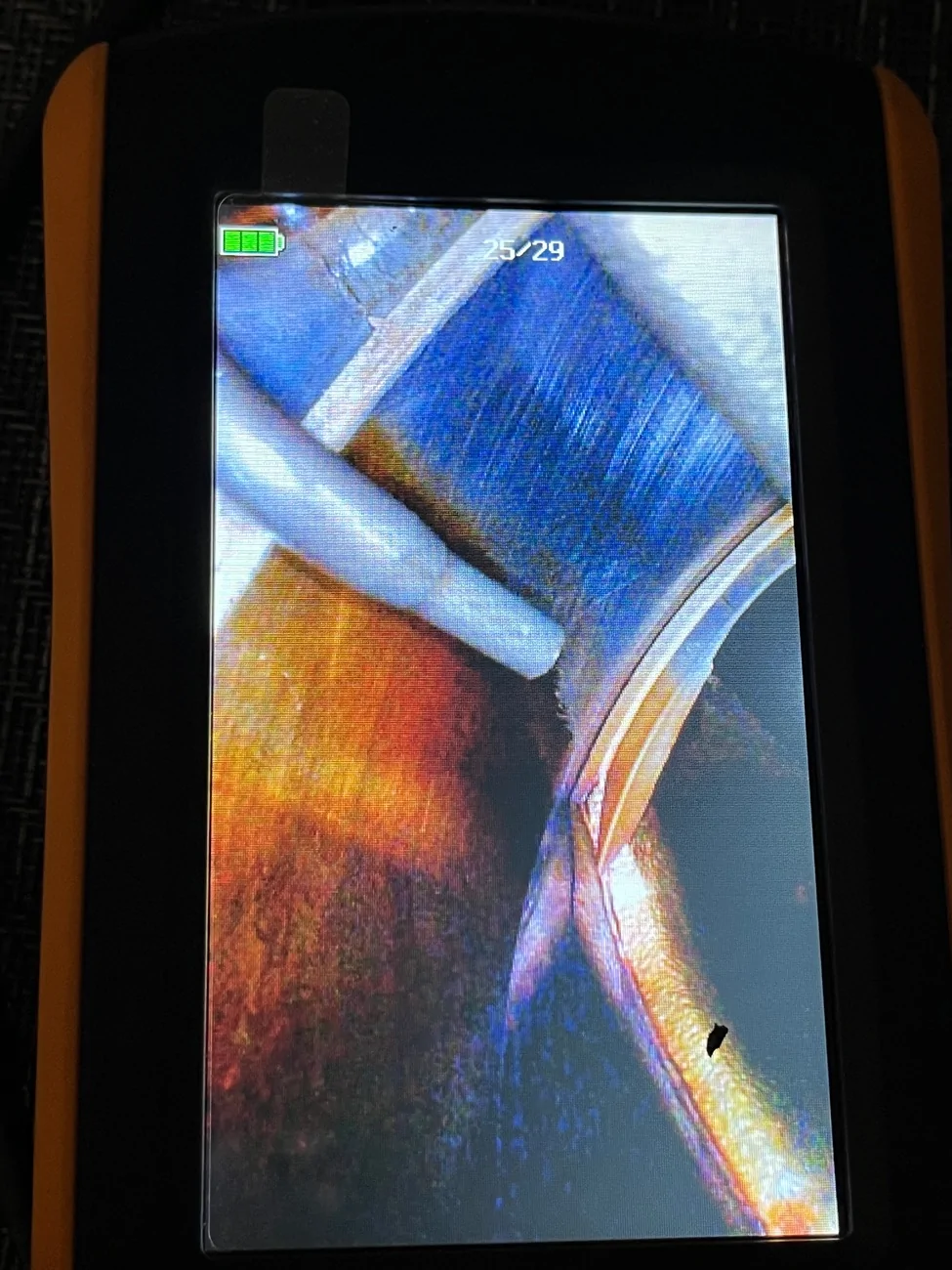

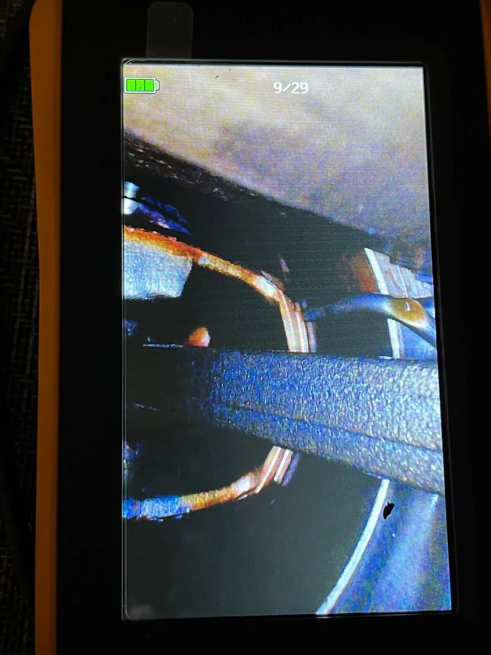

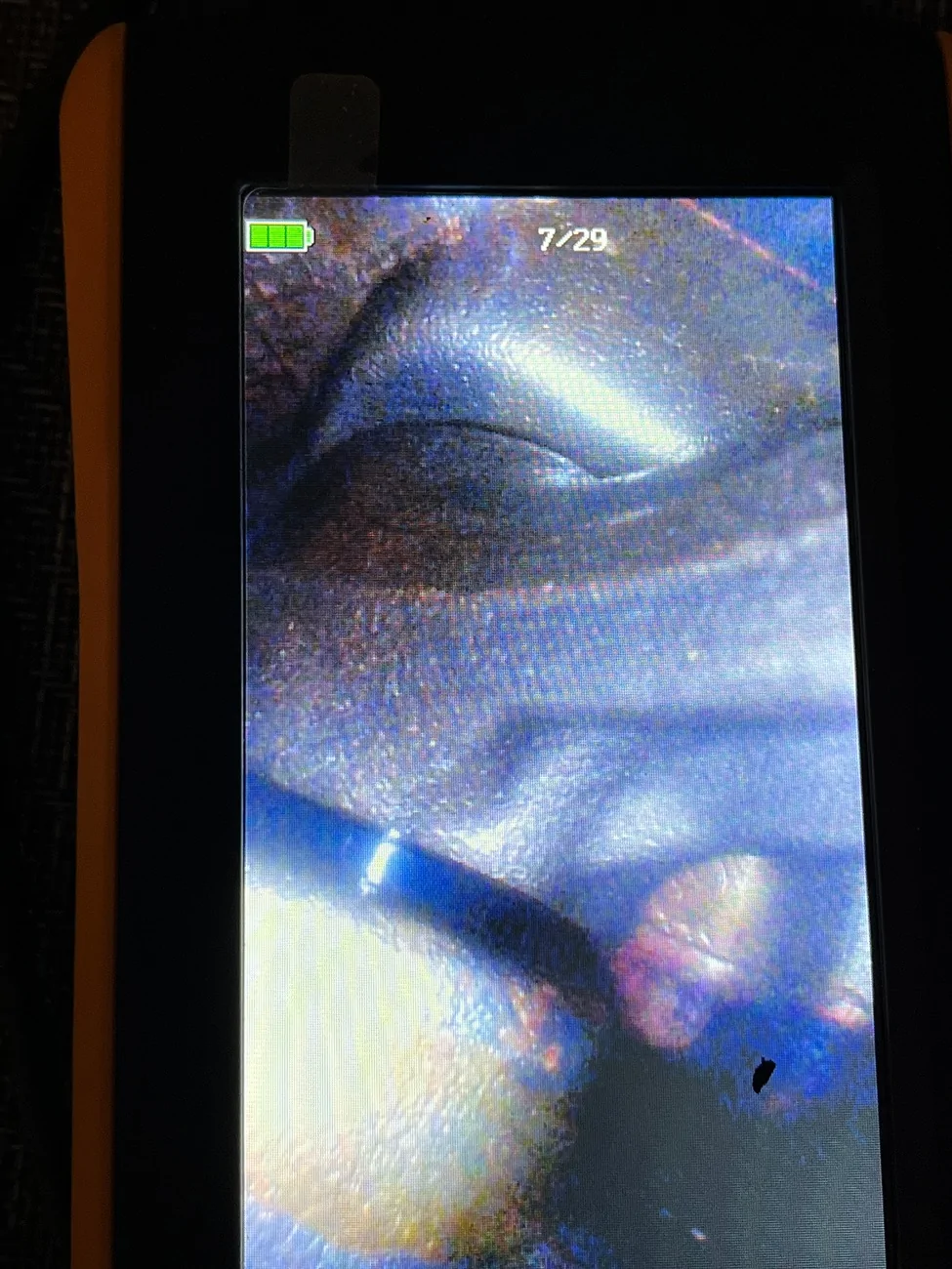

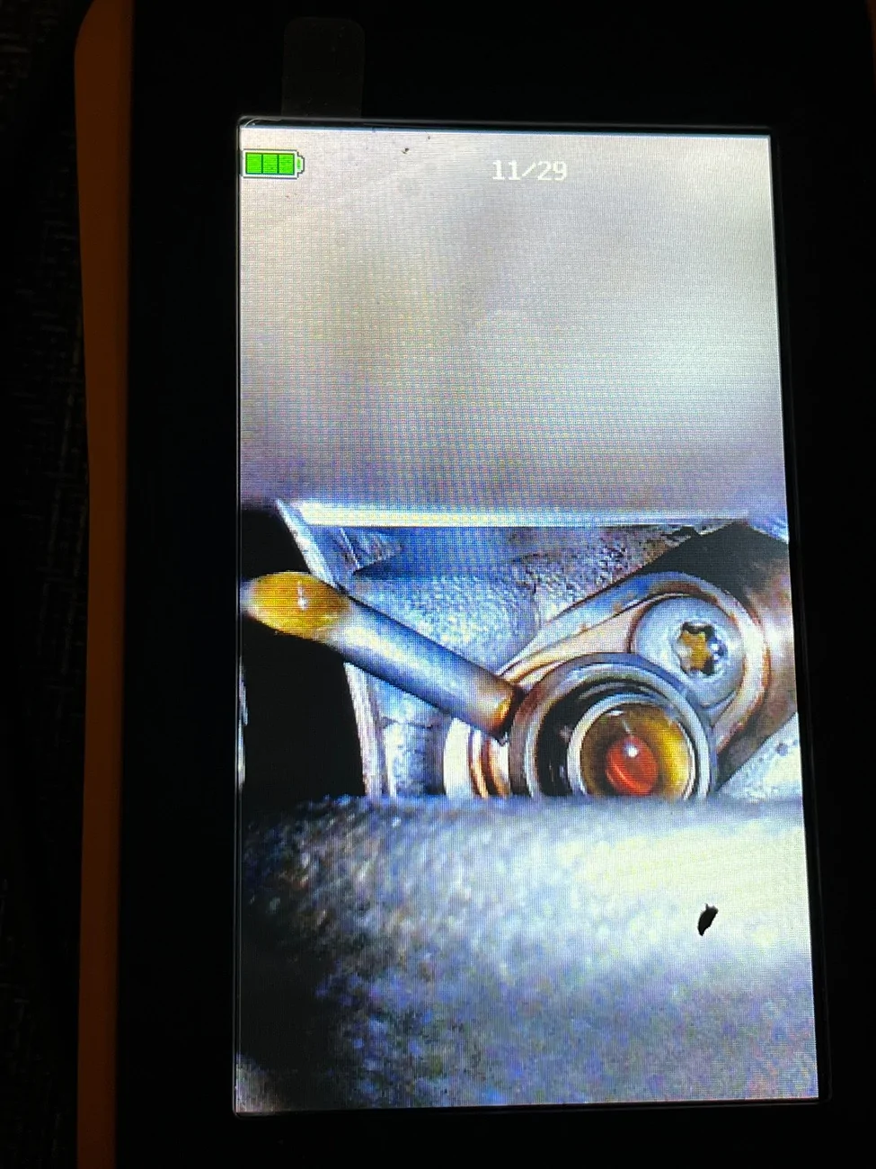

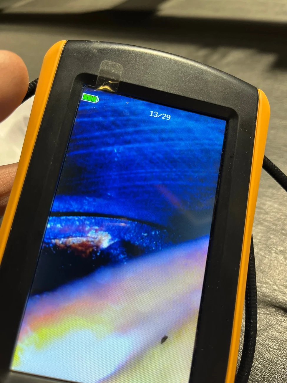

Took some photos with the bore scope guys! I’ve got the pan on, hand tight, waiting up 45 min to torque so here’s some photos for your advice/comments
Jeep Gladiator Oil Pan Gasket? IMG_5170
Jeep Gladiator Oil Pan Gasket? IMG_5171
Jeep Gladiator Oil Pan Gasket? IMG_5172
40,465
53,924

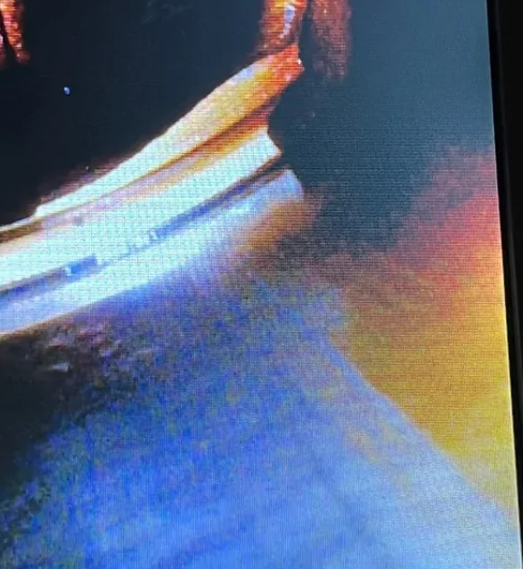

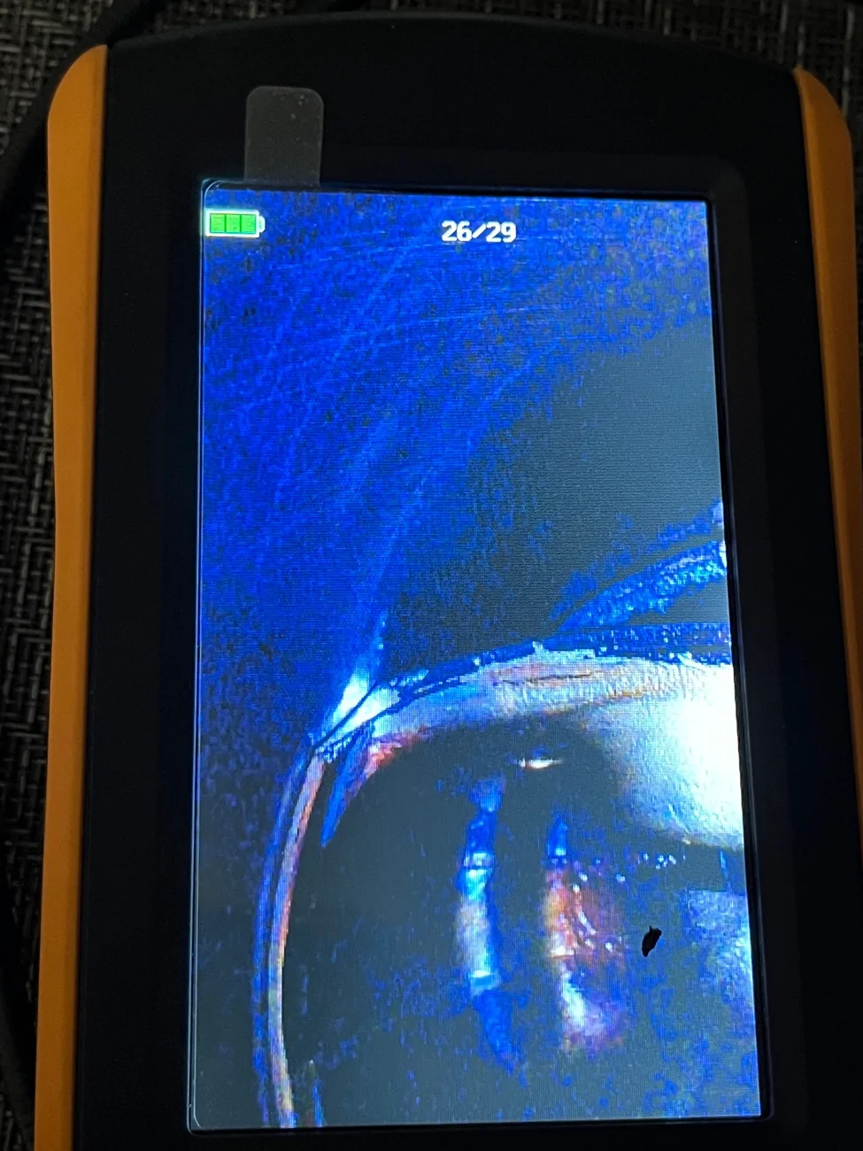

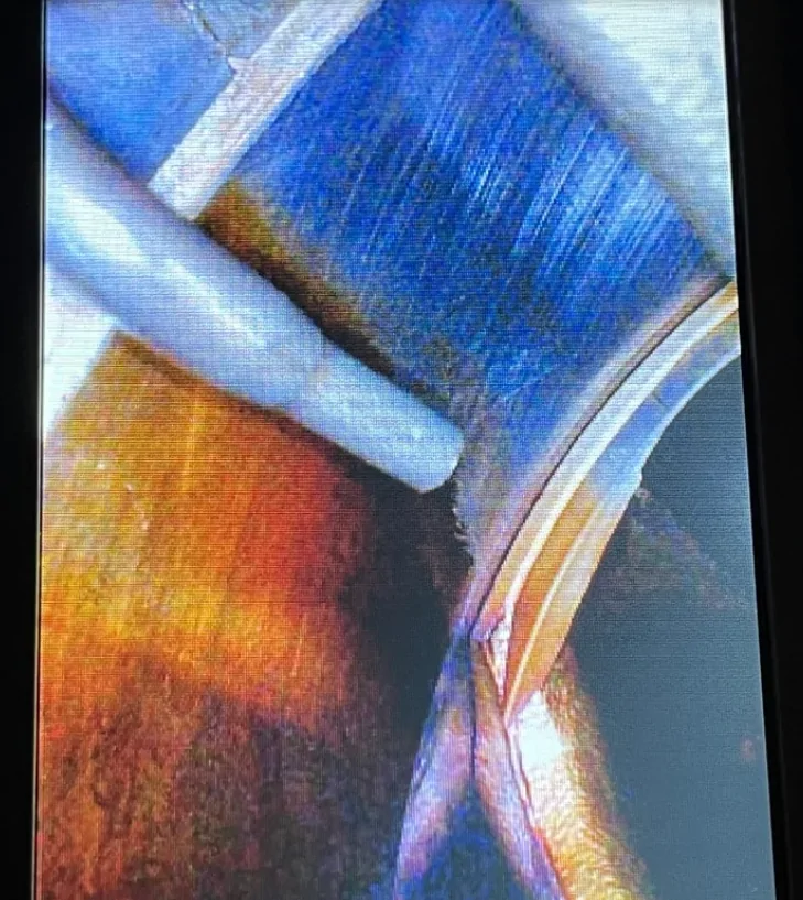

This (pic below) bugs me. I know that the spray will cause differences in appearance because of the fact, gee, it's being sprayed with oil, but that sort of varnish on the cylinder wall?
I'd love to see what the top side of a cylinder looks like, piston mostly down stroke.
Perhaps I'm seeing the normal piston skirt tilt against the cylinder wall wiping the varnish off and keeping that area cleaner, but in any case, that's a whole lot of varnish for modern oils and modern fuels in newer engine designs.
Jeep Gladiator Oil Pan Gasket? 1759588298527-z0
Jeep Gladiator Oil Pan Gasket? 1759588448039-od
40,465
53,924
Is this evidence of blow by?
Makes me wonder if there's something going on, getting past rings and causing that coking of the oil (carbon deposits) and the varnish in a pattern like that. It's a bad look for a modern engine with those miles/kilos.
It reminds me of a 100,000 miles 4.0 where the oil ran out black and thick like it had never been changed.

Once you sealed up the pan, I recommend performs a compression test cold and again warm. Do another hot oil change after a couple hundred miles. Ensure not to overfill. Check PCV valve as well.
40,465
53,924
Yes - sounds like good advice.
I'd wonder - which cylinders were we looking at, or was it a random assortment left and right bank?
The warm compression check may be tough since it takes a bit to get to the left bank of plugs to remove them - it would be cooled down a bit by then.
Other side, more easily done.
I'm concerned about that engine, especially the coking of the oil/carbon bits, and the amount and patterns of the varnish.
