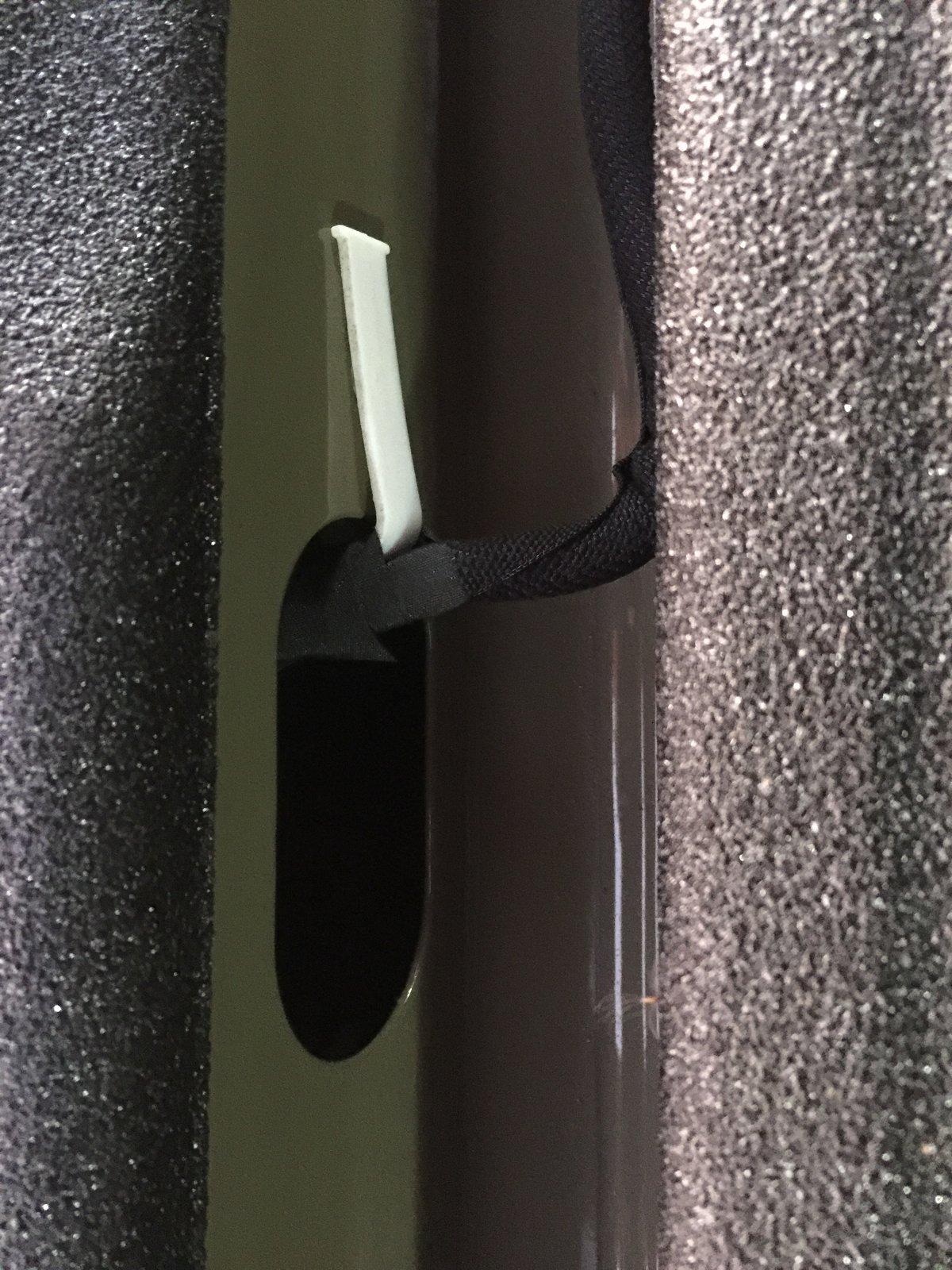

I don’t know what made me think of it this morning, but for some reason I did. I had been meaning to look at that harness and so I did! I took a pic for y’all. Mine has a piece of what appears to be plastic, attached to the harness where it goes through the tailgate, holding it away from the cutout. I didn’t put it there so had to be factory.
How long it will last, certainly I can’t say. But it does keep the harness away from the cutout.
Jeep Gladiator Grommet/Gasket for tailgate center hole EE0B61EA-1158-4DD8-830B-E510BB1B41F3

My Gladiator has that same clip, but that wasn't my worry - my worry was sweeping debris out of my bed and accidentally getting crap inside the tailgate. That's why I bought a grommet to plug it up.

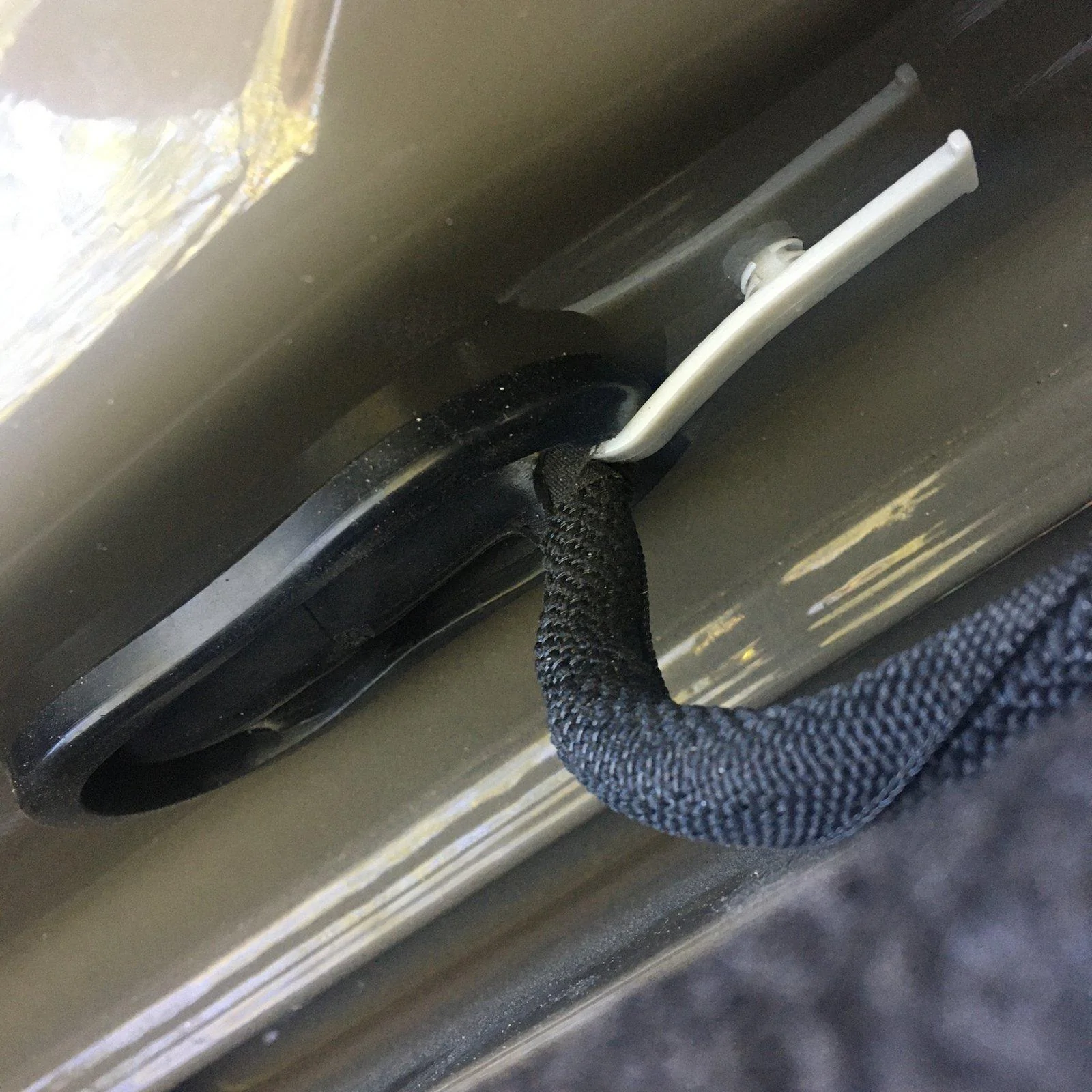

, I decided to simply split one open with a razor blade and core out a section just slightly smaller than the wire and clip that are going into that hole. As you can see from the pics, it slots in there nicely - it should do the job of stopping crap from entering my tailgate, and that's all that matters. :)
! Here is the URL to the actual grommets I ordered, in case anyone needs the info in the future:
Flyshop 1-3/4" x 2-3/4" ID 2" x 3" Drill Hole Grommets Synthetic Rubber Grommets Wire Protection,Oval, 4-Pack
https://www.amazon.com/gp/product/B07841Y9QM/ref=ppx_yo_dt_b_search_asin_title?ie=UTF8&psc=1

The plastic clip keeps the harness from chaffing.

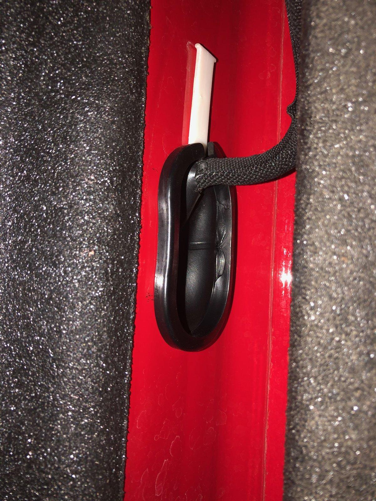

I installed mine (thanks again to @mortuar) with just a slice at the wire location and an ‘X’ cut for the wire to pass thru. The clip did not seat flush before the grommet but a trim of the grommet would fix that if desired.
Jeep Gladiator Grommet/Gasket for tailgate center hole 72DF07AC-963F-4DE1-A463-9257F84E140D

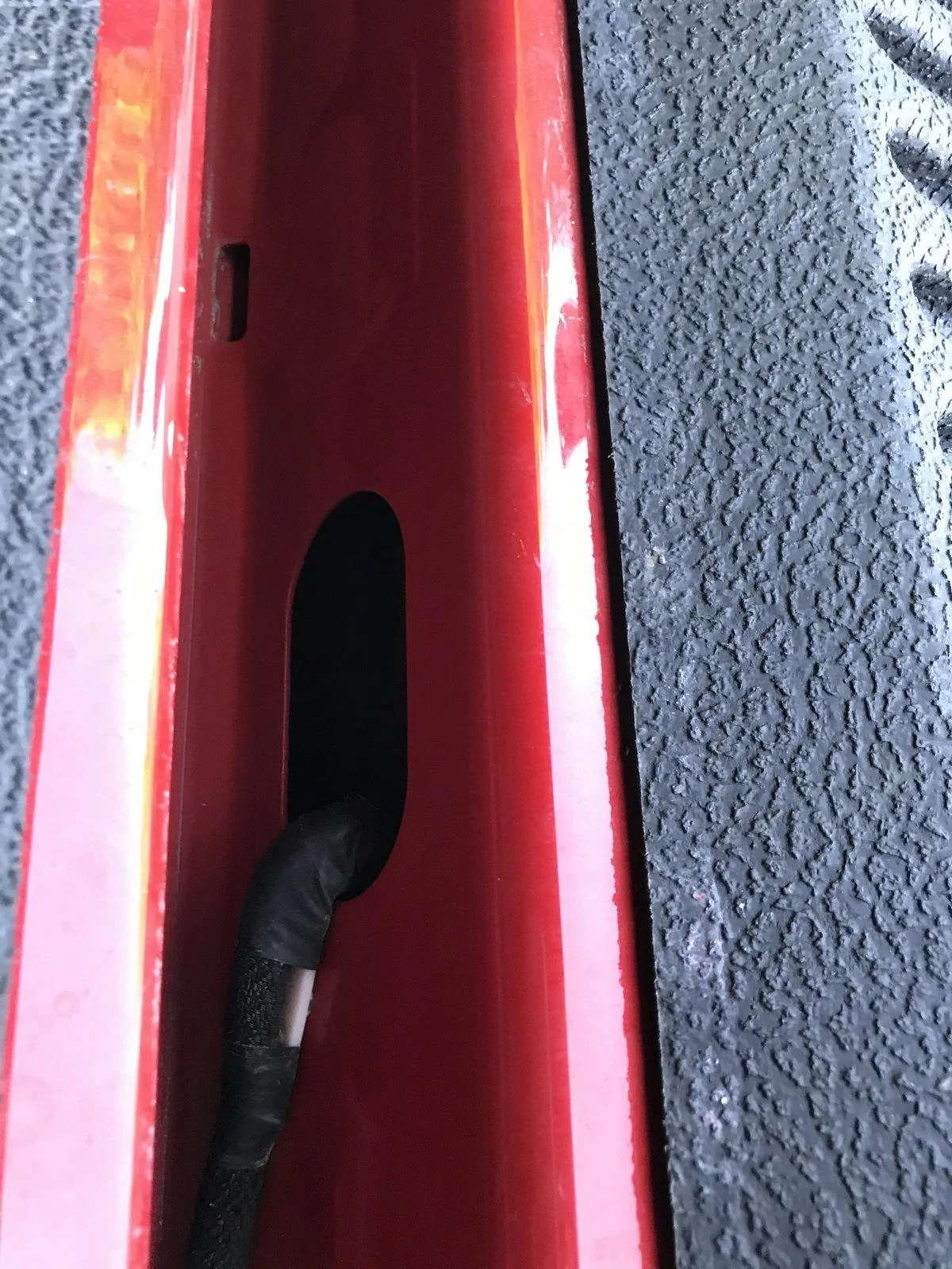

For what it's worth, RAM's are setup this same way. My buddy came over in his 2019 RAM 1500 and it has the same hole. It looked to be about the same size as the one on the Gladiator. I didn't see anyone talking about it over on 5th gen ram forums though. There's a lot more RAMs out there then gladiators so there must not really be a market for it since I couldn't find anything specifically designed for people that want to plug it.
This is from his truck's tailgate:
Jeep Gladiator Grommet/Gasket for tailgate center hole IMG_5059
