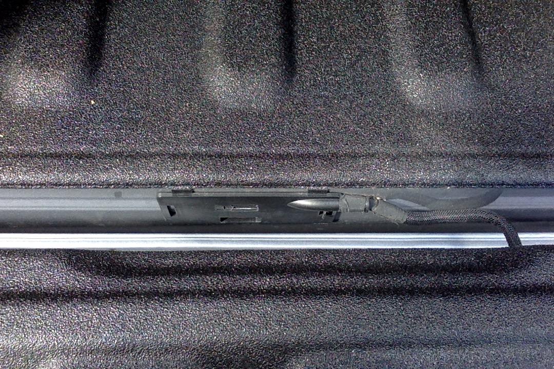

I envision a lot of salt spray collecting in that hole and rotting the tailgate.

Hey Alex @JeepCares I find it hard to image that a Jeep engineer could not put a wire plug connector into the wire right at this hole and then have just the wire going into the grommet. This should have been a very simple fix, basics of wire connections.
Hi Everyone,
I did hear back. No piece is missing. The opening size is required to fit wiring connectors into the tailgate during manufacturing. When the tailgate latch is closed, this hole faces straight down and engineering testing confirmed that any accumulated debris will fall out onto the ground, eliminating the need for a grommet in this location. I hope this provides some clarification.

Hi Everyone,
Alex
Jeep Cares
Forum needs a laughing reaction icon. Seriously? Just mail us all the grommet, it's not that hard to install. Sheez. "Engineering"... hehe.

It seems strange to me that they would put a plug in the bed but not in the tailgate. I would be interested to hear "Engineering's" explaination as to why the bed needs a plug but the tailgate does not. I foresee a lot of Gladiators on used car lots in the future with a bubbling rust line on the bottom.

@JeepCares The engineers contention that debris will fall out is valid for debris that might blow into the opening . But mice and chipmunks will find the tailgate a very nice home. They will pack a corner of the tailgate with nesting material which will rot the tailgate from the inside. The same thing has happened to other cars I have. My WRX hood rattles each time I open it, my Scrambler frame had nests in each frame rail, and my tractor air box needed to be cleaned out until I started using an electric rodent deterrent.
We as owners should just be proactive and cover the hole, or get one of those electric rodent deterrents. My 2020 Jeep Scrambler (F' it, I am calling it a Scrambler) will be a weekend toy or used sporadically so I need to keep the critters out.
I work in manufacturing and realize that "just adding a 10 cent grommet" is BS. By the time the entire the engineering-procurement-manufacturing process is complete, those grommets are 10's of thousands of dollars of inventory. I would be surprised if Jeep stepped up and provided us all with a grommet or made a TSB to have the dealers do it.

Hi - thx for checking. I understand why it is needed, but I think once debris finds its way in there, it is going to distribute, and the odds that it finds it way out is a bit limited. Back to the Grommet search!
