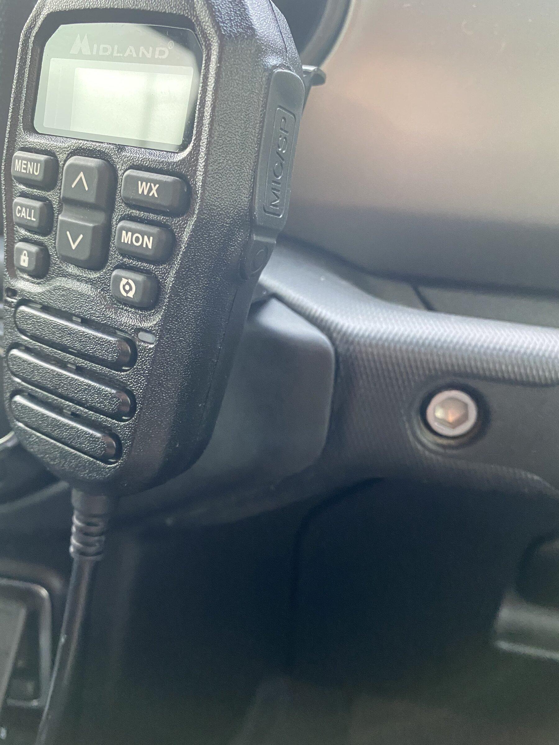

I have a Midland MXT275. Its broad range is surpassed only by its dependability under various circumstances. Additionally, it contains 142 privacy codes that may be used to silence conversations and ensure that nobody else is listening. Additionally, it successfully blocks busy channels.
I'm still researching and somebody correct me if I'm wrong. I think the privacy codes only block out other people's transmissions. Other people can still hear you unless they are using a different privacy code. The name "privacy code" is kind of misleading. Also, I have heard that different manufacturers of radios have different privacy codes and may or may not be compatible with other manufacturers.
I'm looking at Midland for simplicity and on microphone controls. An extension cable could put your GMRS use in your tent. The mic is on a cat 6 cable and long extensions are cheap. The midlands have speakers on the mic and on the base unit. You can enable or disable either or even plug in an external speaker. I'm comparing GMRS handhelds to FRS handhelds also. I'd like radios that are USB rechargeable so I can charge them on the road.
I think the handheld GMRS do not require a license because they are limited to 2W transmission, but they work great with vehicle mounted GMRS and you can get 4-5 miles range in most terrain.
Correct me if I'm wrong, anybody. My skin is thick and I want the truth.

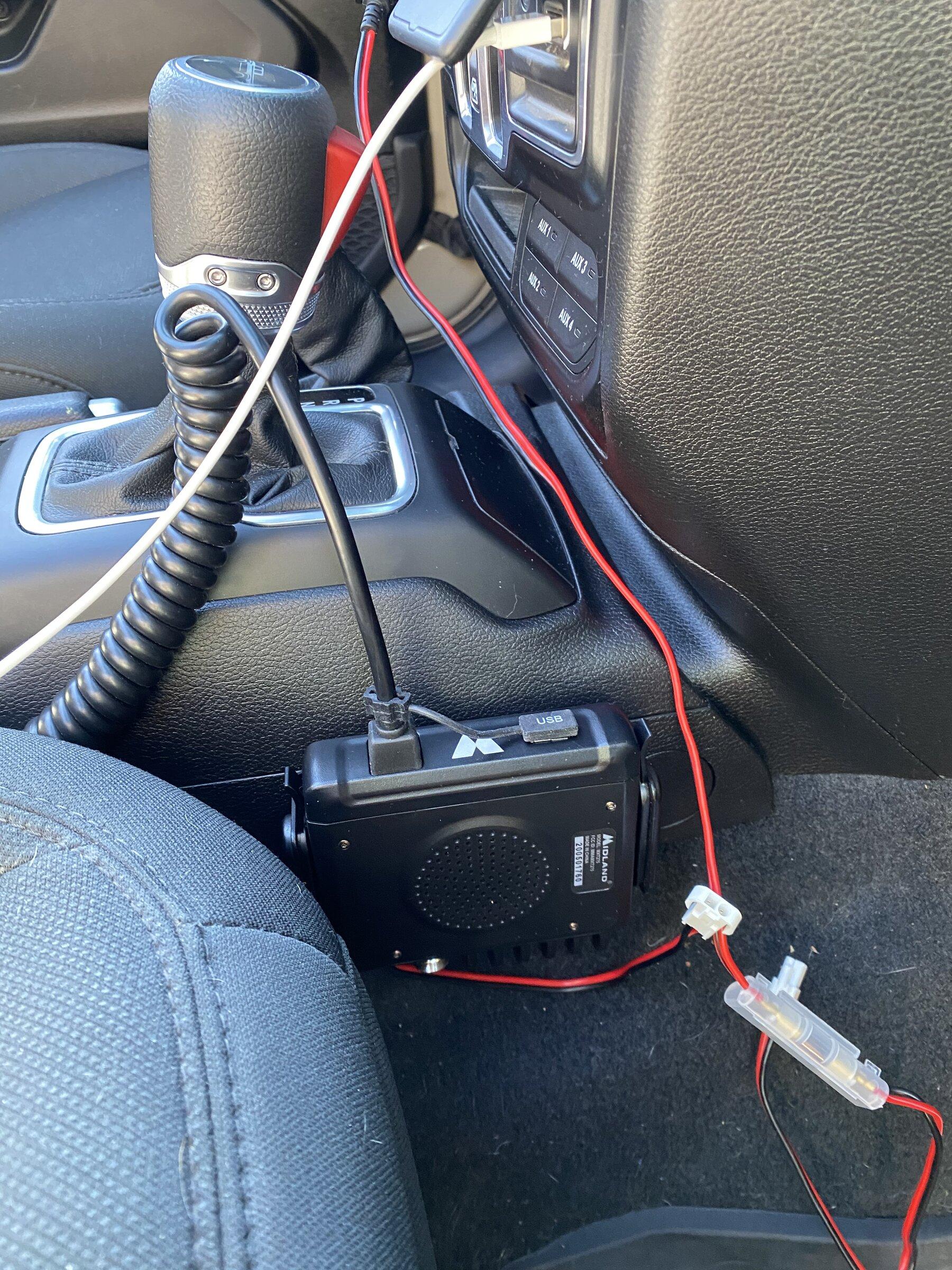

I'm considering mounting the base unit behind the passenger back seat on the wall and wire in an outlet for charging handheld radios. It's lockable and makes it easier to not roll up the antenna cable.
How long of a CAT6 extension cable can I use with the mic? Use extension in tent?

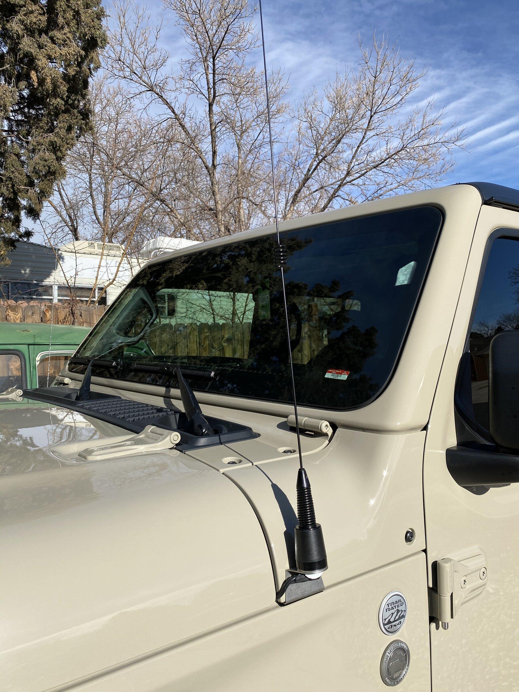

15W plus a good antenna is better than 50W with a bad or poorly placed antenna. And the 15W unit is smaller and easier to tuck away in the dash. Many groups do fine with handhelds with 2W and small fixed antennas. You'll be fine with 15W and a 6" antenna with some ground plane.

Where are the aux switch connections under the hood for the diesels?
The wires are between the battery and fender. They are taped up. Use a flash light. You should be able to see them.
