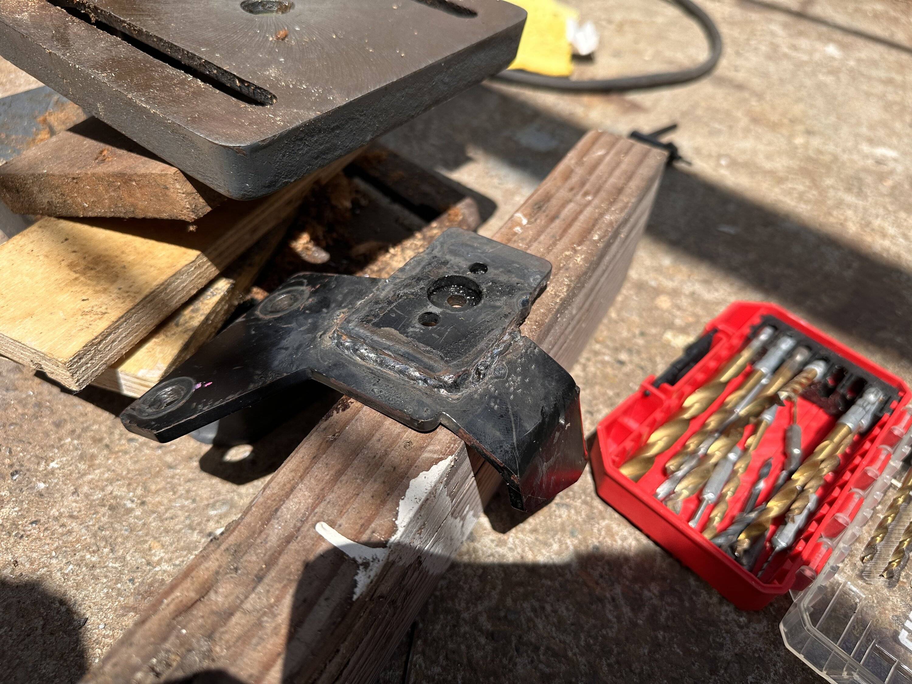

I have the Teraflex geo brackets for the front control arms. Core front track bar and front lower control arms. More Core pieces hopefully soon. The Core front lower control arms adjusted short as possible is about a 1/4" or so longer than the oem control arms. Was wondering if you noticed the length difference between the Core and oem control arms. With the geo brackets and the core arms. It seems to push the front axle too far forward. The coil spring on the driver's is hitting the Steer Smart track bar brace.

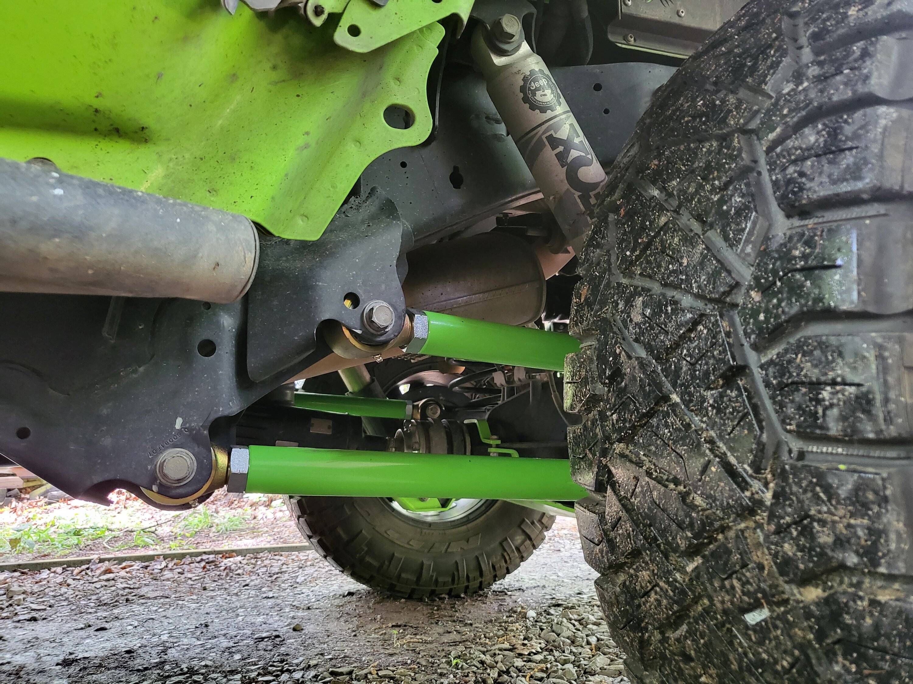

I started out with the Teraflex leveling kit which I set at the max 1-1/2" then added the Mopar lift and Core trackbars a little later. I drove like this for a few months with 0 issues. I wanted to contiue to strengthen things up so I bought the Core CA's. Since everything felt right I just replicated the hole centers from the Mopar control arms over to the Core pieces and haven't had the first issue. Keep in mind the Mopar front LCA'S are about 3/8" longer than stock. I haven't and don't intend on installing geo brackets for the ca's. I don't have a need to for my particular build. I know the more horizontal the ca's the better but I'm just not having issues that need to be corrected.
So in the mix of all this I swapped in Rubicon axles so I could have lockers. Before I began the swap I documented all my current measurements so I could setup the new axles the same as what I was removing. The castor with the Mopar LCA'S was 5.5 degrees so by setting the new LCA the same, it stayed at 5.5 degrees. My CA's are not fully compressed but are only out maybe a couple turns the best I can remember.
Is there a particular reason you feel the axle is too far forward? Visually or some other issue? Sorry for the long post.

If you're still running stock upper ca's the axle should still be in its original location. I'm not sure if you're lifted or not but if not, the longer lower ca's HAS rotated the bottom of axle forward slightly. If you are lifted more than a couple inches, the stock length UCA's are pulling the top of the axle back some. This could also affect the spring perch causing the springs to have a weird bow in them.
