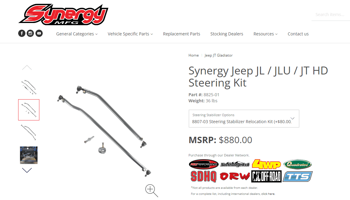

It's been excellent so far, definitely made my steering feel firmer after adding the setup. I ran it since install until recently on almost 35s (315/70/17) and just this week swapped to 37s. So far it's performing great with both setups, although I haven't gotten to play with it out on a trail with the 37s.
As of right now, I absolutely love the purchase, would buy it again.
Sweet...thanks for the quick response!
I had the Synergy set up on my JKU and was shocked how much of a difference it made. The Rock Jock is slightly better for my budget too...

Had aluminum and went to Synergy. It's .25 thick wall hardened chrome steel. The Aluminum is just the bar so now you have steel and aluminum. The aluminum will flex but the steel doesn't and the TRE will eventually give. Ask Lite Brite. I like the bling of the aluminum and for most there will never be a problem.
