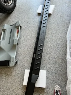

I ordered a pair on Black Friday and they were shipped quickly, arriving at my door in about a week. The packaging was superb and no damage was found to when I opened the boxes.

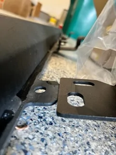

Bestop’s instructions for the install are pretty straight forward and easy to follow; they recommend an hours time, but it took me a couple of hours as I was installing by myself. The first issue I encountered was that the brackets that mount to the rails have slots that allow for the rails to be adjusted to the front or back of the Jeep (photo below demonstrates the slot).
There isn’t a reference point to use as a guide so it’s up to you to find the best position; and there isn’t a way to adjust the rail to bracket mounts once the rail is attached to the truck. These brackets are then mounted to the frame using existing holes and the middle body mount:

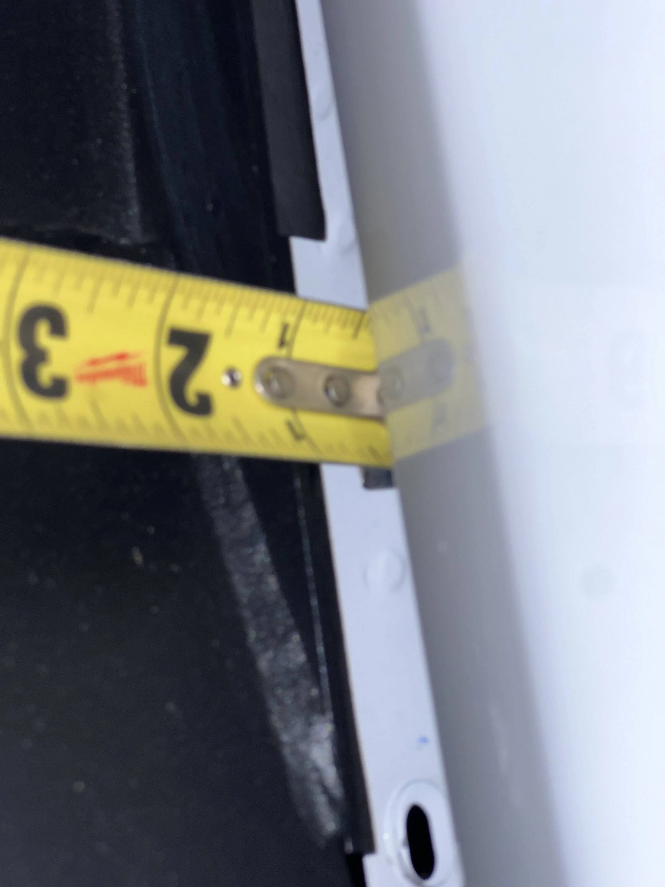

Bestop supplies various mounting plates and a custom u-bolt that provides a way for the brackets to be securely attached. They also included an handful of metal shim plates for the brackets to be pushed away from the pinch seam. The middle mount is designed to allow for bracket to moved to/from the frame for minor adjustments. Unfortunately this is where I ran into issues. The driver’s side rear mount was flush against the frame without using any shim plates and I had ~1” gap between the pinch seam and the rail:

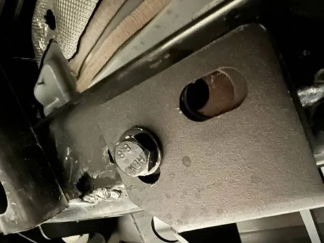

The passenger frame has a bracket that prevents the front frame mount from being fully secured (this wasn’t mentioned in Bestop’s installation instructions); I suppose I could have cut the bracket off - but I chalk this up to poor design:

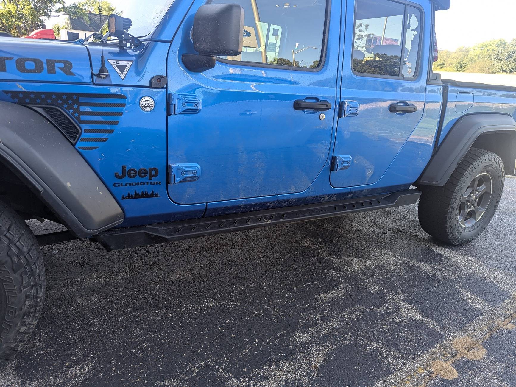

Here are pictures after the initial install:
