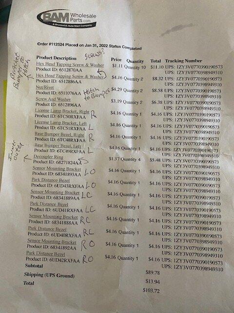

Attached is the list of parts you will need if you are replacing your stock Mojave plastic rear bumper with a Rubi metal bumper and bedside sliders. Hope this helps someone. Cheers, Joel
Jeep Gladiator Thoughts on Rubicon vs Bestop bed sliders / rear rock rails? IMG_3996
