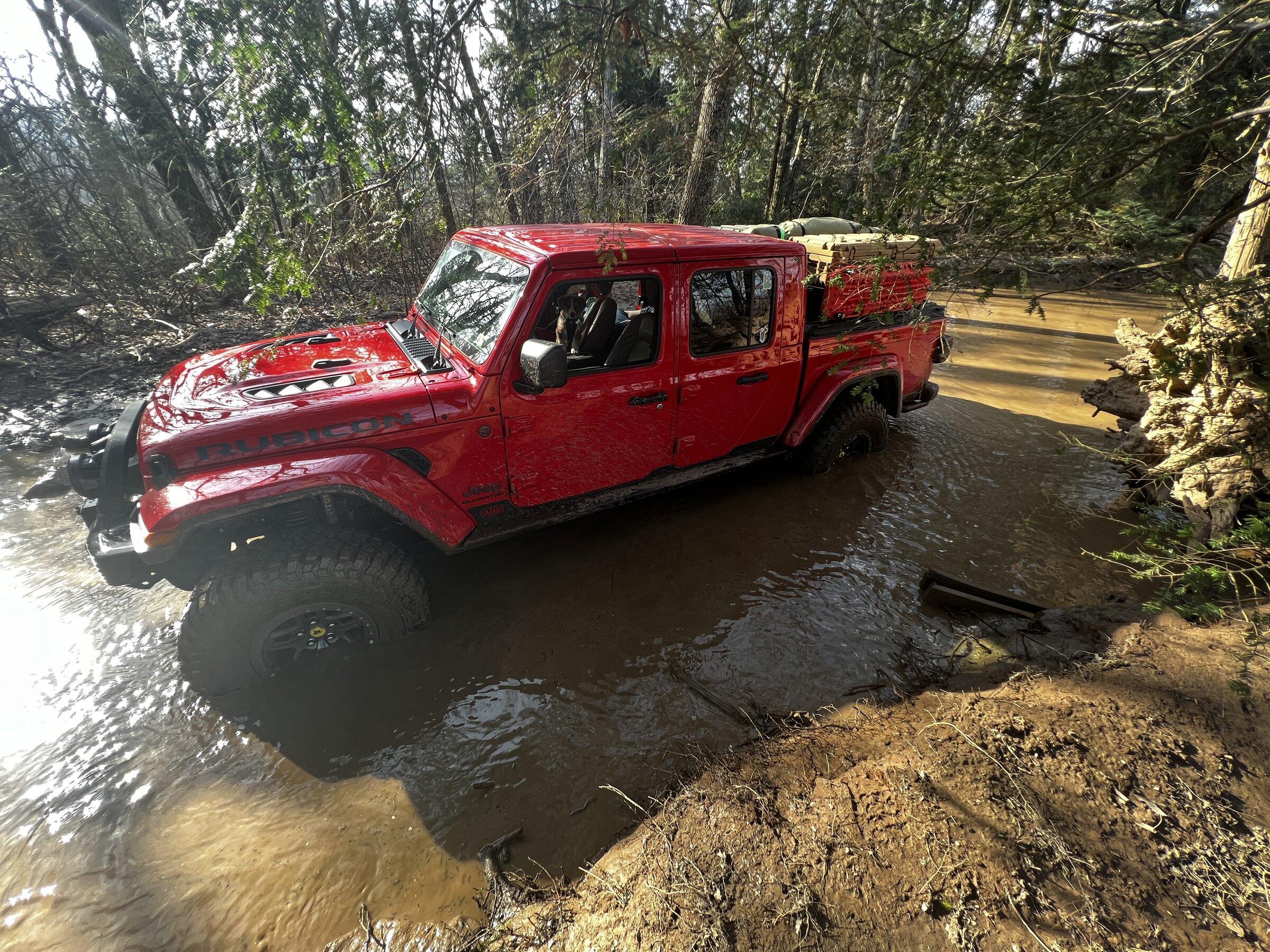

I went with these. I did a quick write up on the install a few weeks back (https://www.jeepgladiatorforum.com/...gy-trail-rig-and-overlander.48591/post-908496). So far, I’m loving them. Great look and fit, and very solid over the few logs and rocks I’ve found so far. No heavy duty rock crawling yet, but I’m a lot more confident on tight trails already.
Here’s how they look right now, just out of a local state forest.

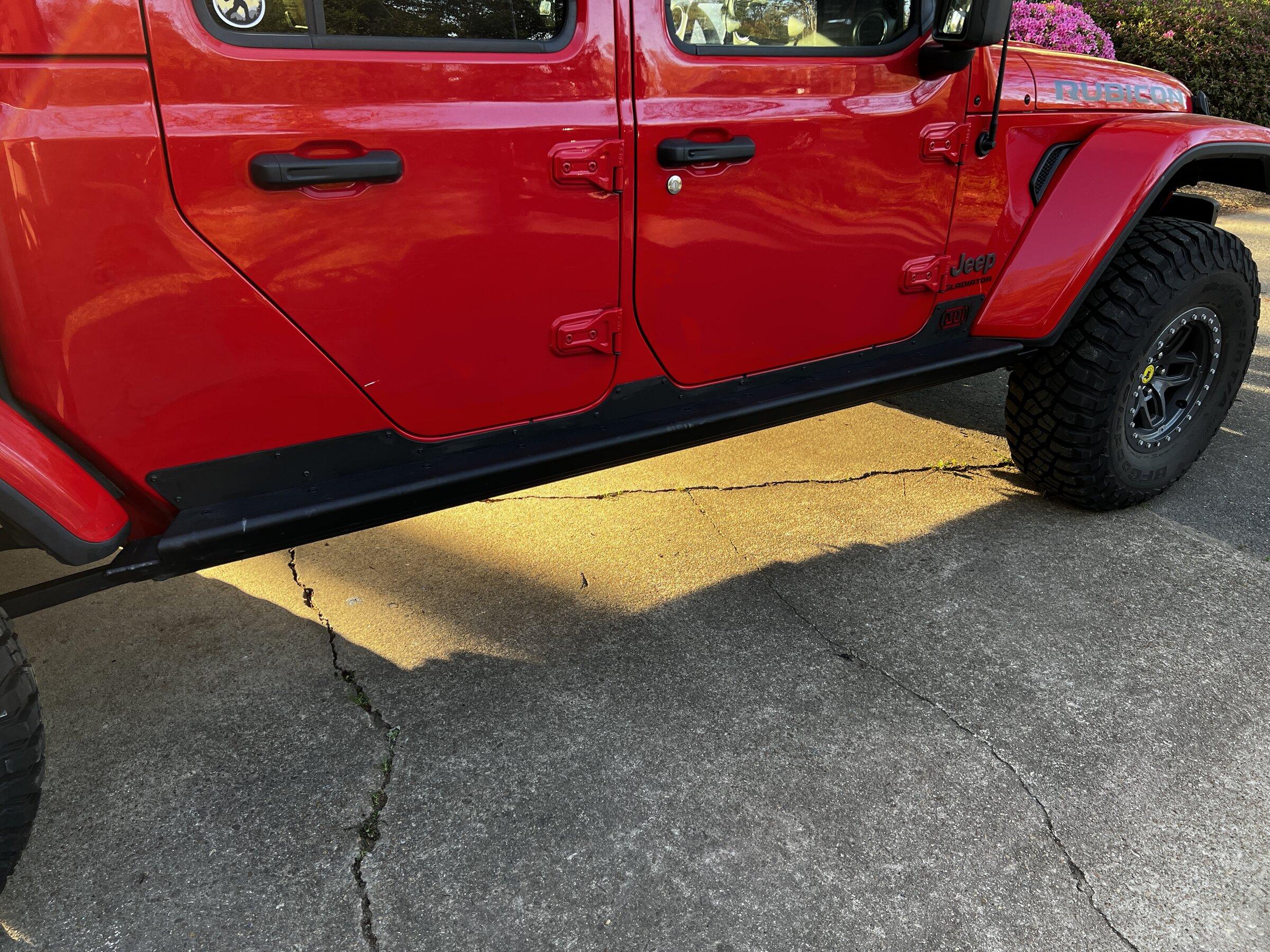

Pops nicely on that red. I'm definitely loving the 3-4 inches of extension past the side of the body. With a rig this long, I know i'll end up rubbing a few trees on the trail.
Yeah, I like the contrast too, and I still hit stuff underneath. I’m waiting to break off some $1000 EPA diesel trinket under the thing. I think the next purchase might be a Next Venture belly skid and axle sliders. The gladiator is like a dog dragging it’s a$$ across the lawn off road. That’s part of its charm.

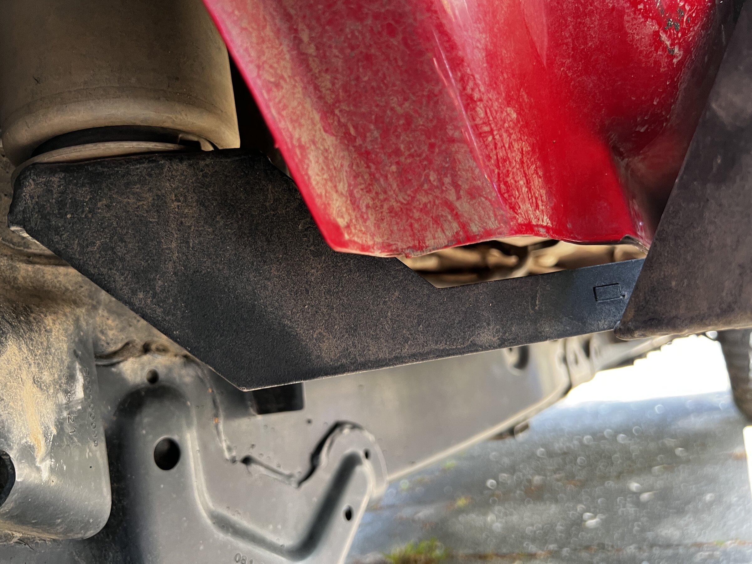

They’re not actually frame mounted. They’re mounted to the bottom of the body mounts. So the body is on top of the frame and the sliders are underneath. Both are therefore isolated from the frame itself. I prefer this to frame rail mounting.
As for not tying into the rocker panel, I’m not sure why your wouldn’t want to do that. The mounts underneath that attach to the body mounts are stout, but attaching it to the rocker panel significantly increases the rigidity. The only reason not to tie into the rocker panel is to avoid drilling the holes. Honestly that was the easiest part. The body bolts were much more of a concern for me given all the problems people have with them. Installed, these don’t feel like they’re bolted on. They feel like they’re part of the truck.
If you’re dead set against it I would recommend some other type of slider.
A legit reason not to install these is the tools you need. I wouldn’t want to do it without my inductive heater
Solary H7E Magnetic Induction Heater Kit 1000W 110V For Automotive Flameless Induction Heat 1KW Hand Power Tool (Black with 3 Coils) https://www.amazon.com/dp/B086BQJD85/ref=cm_sw_r_cp_api_i_V7G2SWGBP0RM0K6YCA2Y?_encoding=UTF8&psc=1
or a wheeled motorcycle jack. You also need a decent rivnut tool and quality HSS drill bits (I used metric one with tapered ends. I also used the caulking gun size Rtv they sell at Advanced Auto. All that crap adds up. If you have any issues with rivnuts or bolts you ought to have a metric tap and die set too. I had to clean the threads on one of the rivnuts after it was installed. You’ll need a breaker bar to take off the body bolts even with heat and a good 1/2 or 3/4 torque wrench.

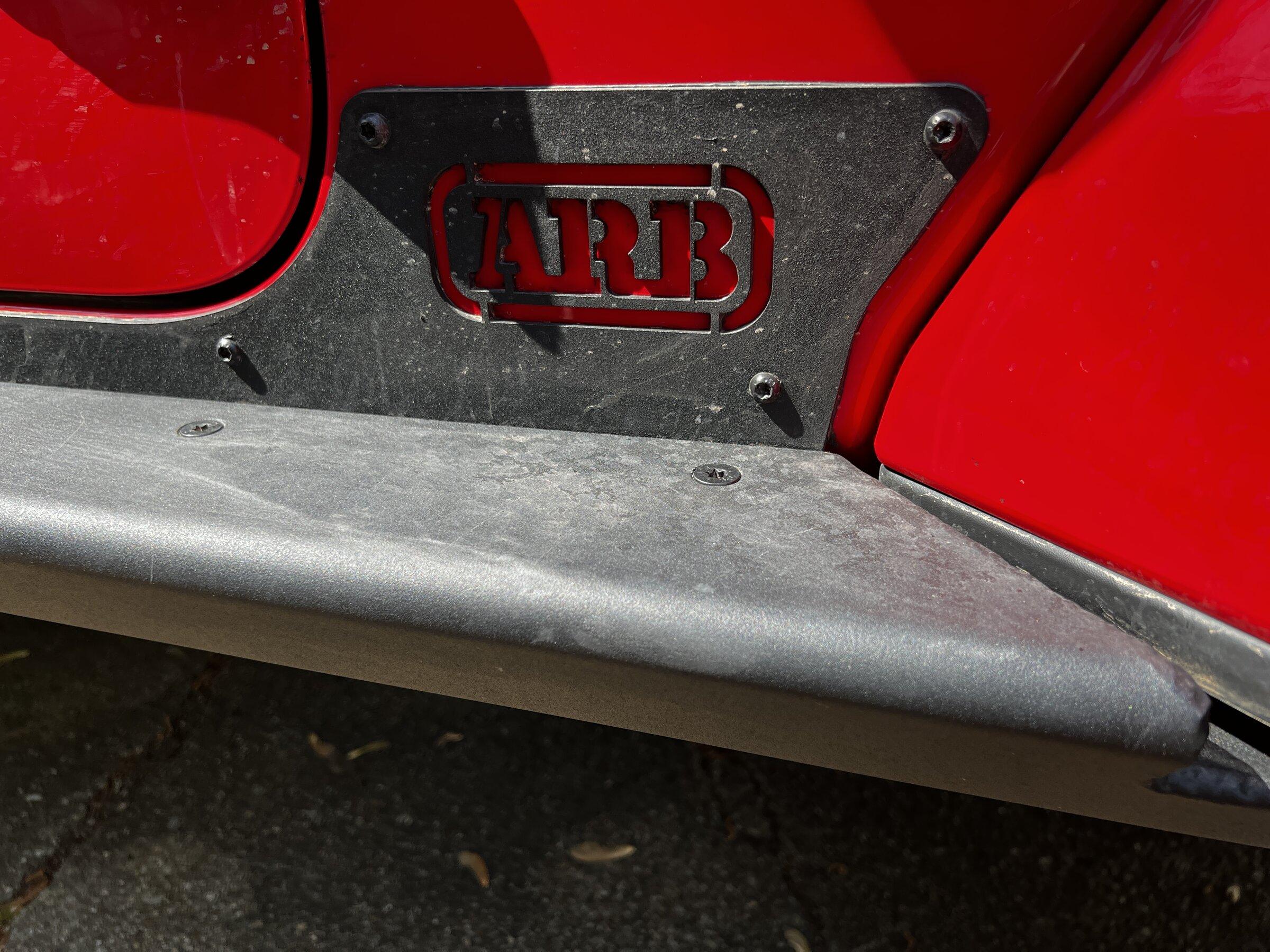

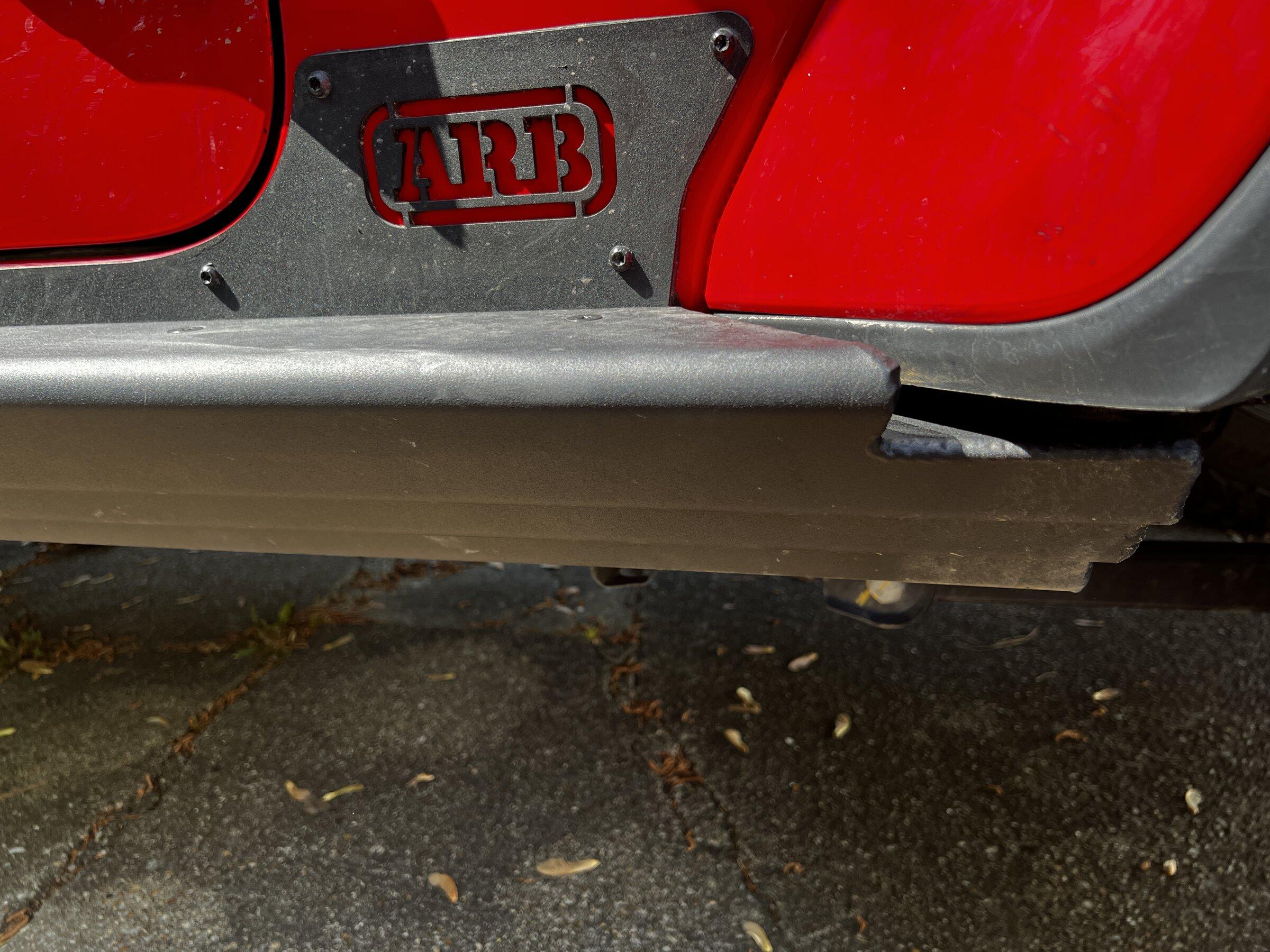

A couple of other things. If you actually install the rocker panels but don’t bolt them in then you actually create the corrosion potential people are trying to avoid by not drilling holes. The panels would sit right off the body and move back and forth. Grit and water would get trapped and the side of the truck would be ruined.
If you leave them off and just install the lower portion you’ll have weird holes in the slider portion and probably an ugly gap between the body and the slider. The ARB sliders are designed to be installed with both pieces. It would also probably void the warranty to deviate from the instructions like this. I would contact them with that question.
I do believe that the EVO sliders allow you to use the rocker guards or leave them off. But honestly I don’t think installing them is a big deal. I personally like these ARBs better than Motobilt or EVO ones. The Motobilts are really good looking but I don’t like that they and the EVOs have big holes in the sliders. I could see those getting hung up on rocks. The ARBs are smooth. You also have to get the Motobilts and EVOs painted. I’ve never had paint issues with ARB stuff.

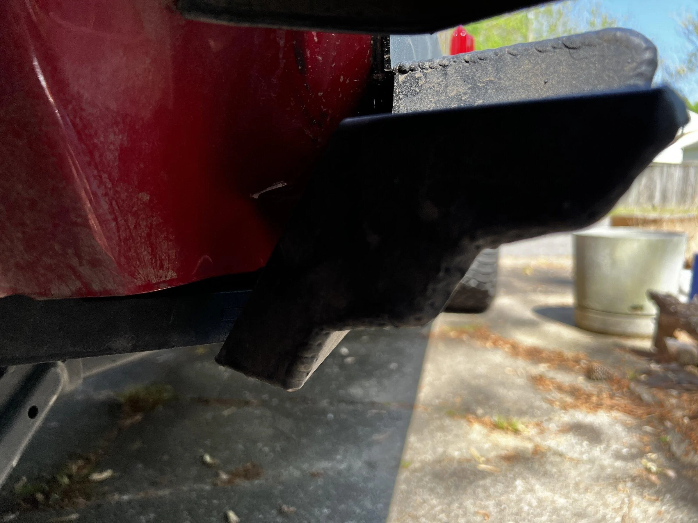

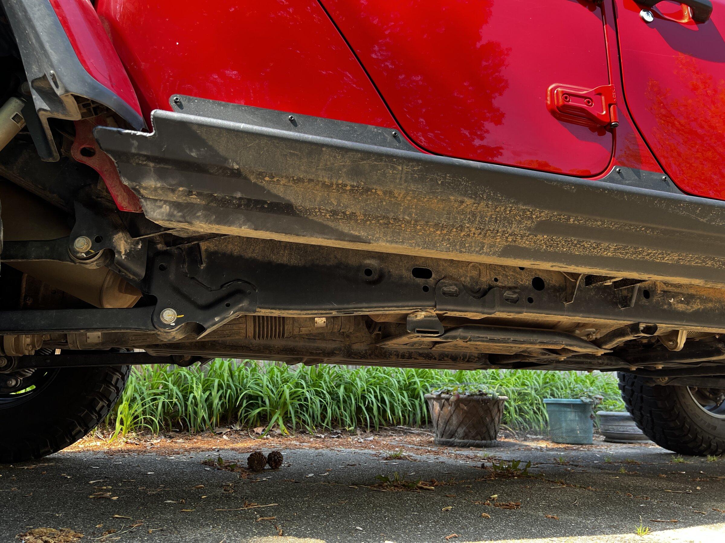

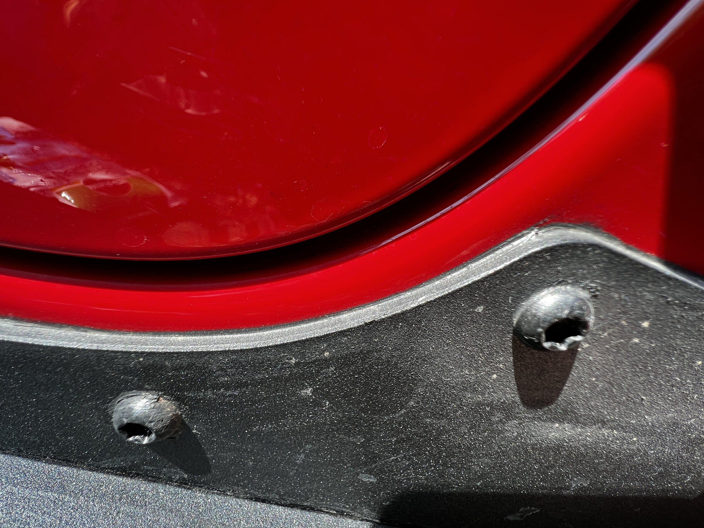

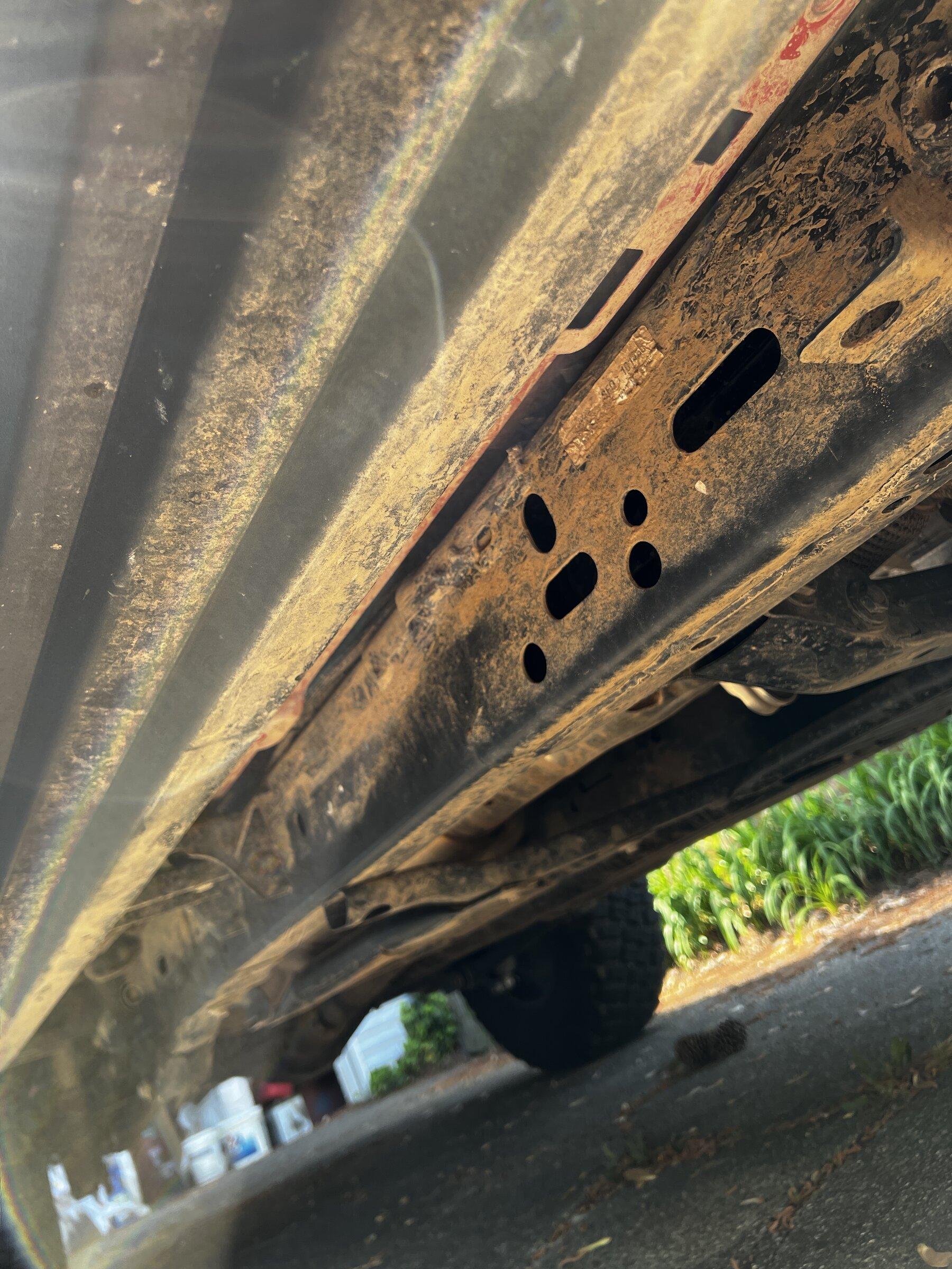

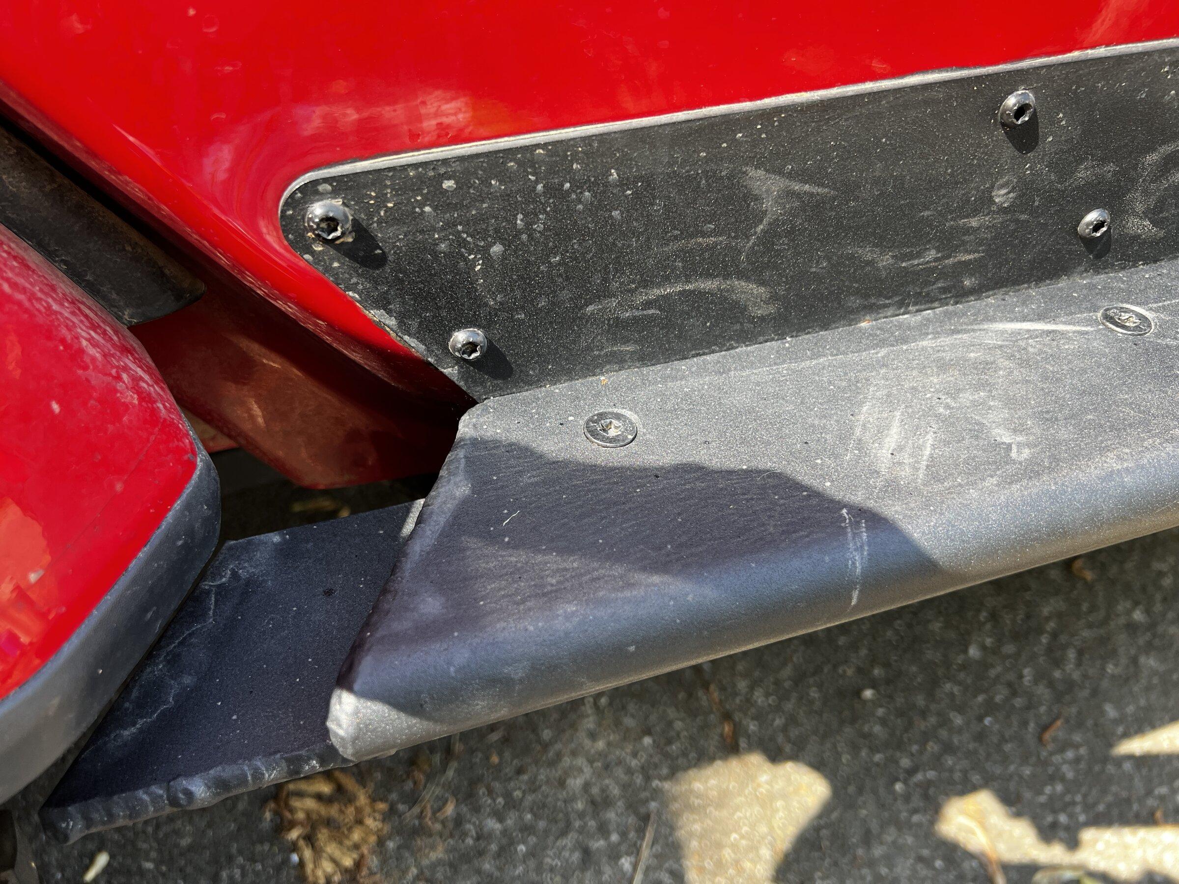

I’m including some more detailed pictures. These provide really good coverage underneath and you see how they are corrugated for strength The last one shows my caulk line. Nothings getting in there. I even sealed the ARB logo. Everything is still dirty from my last trip.
