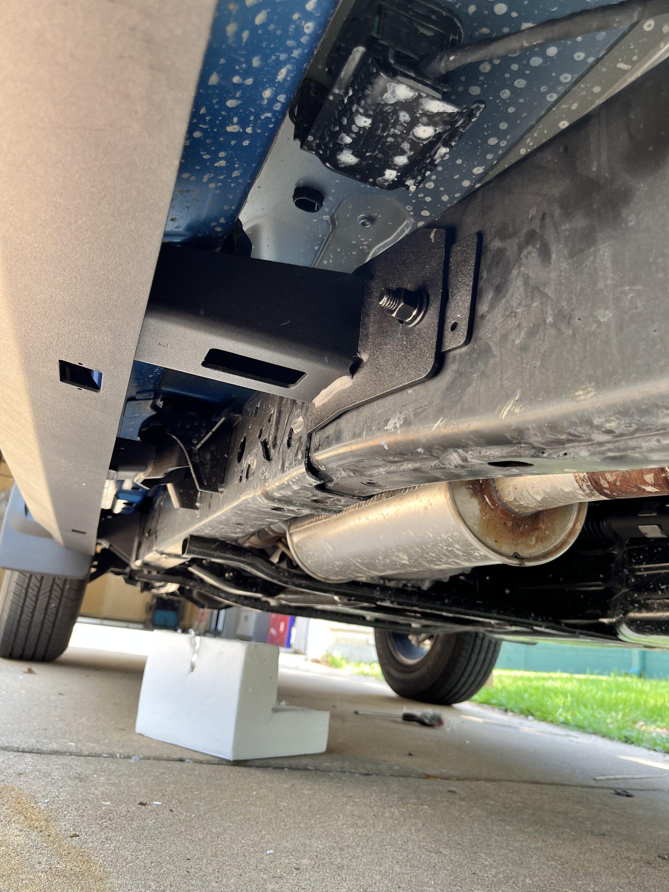

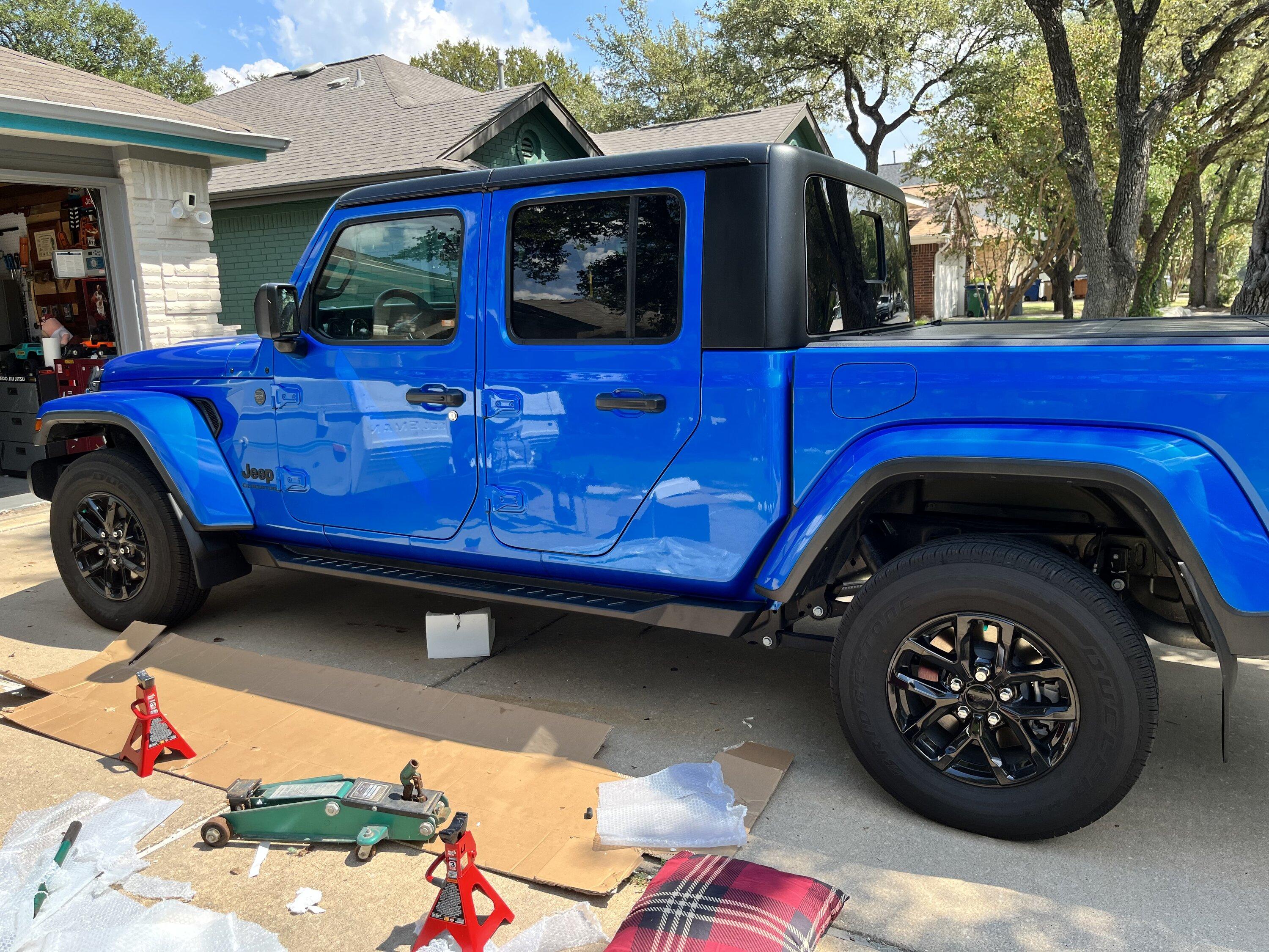

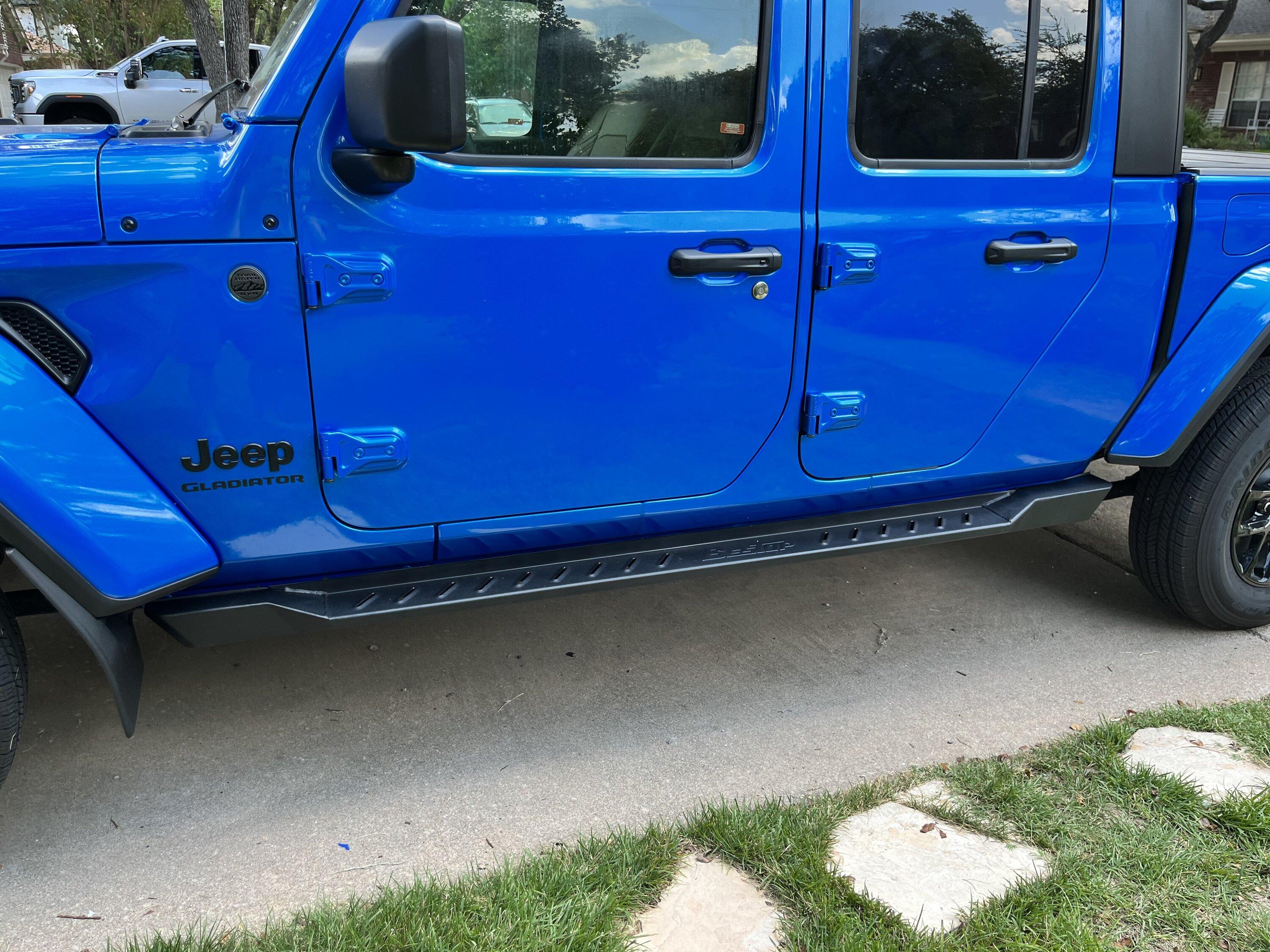

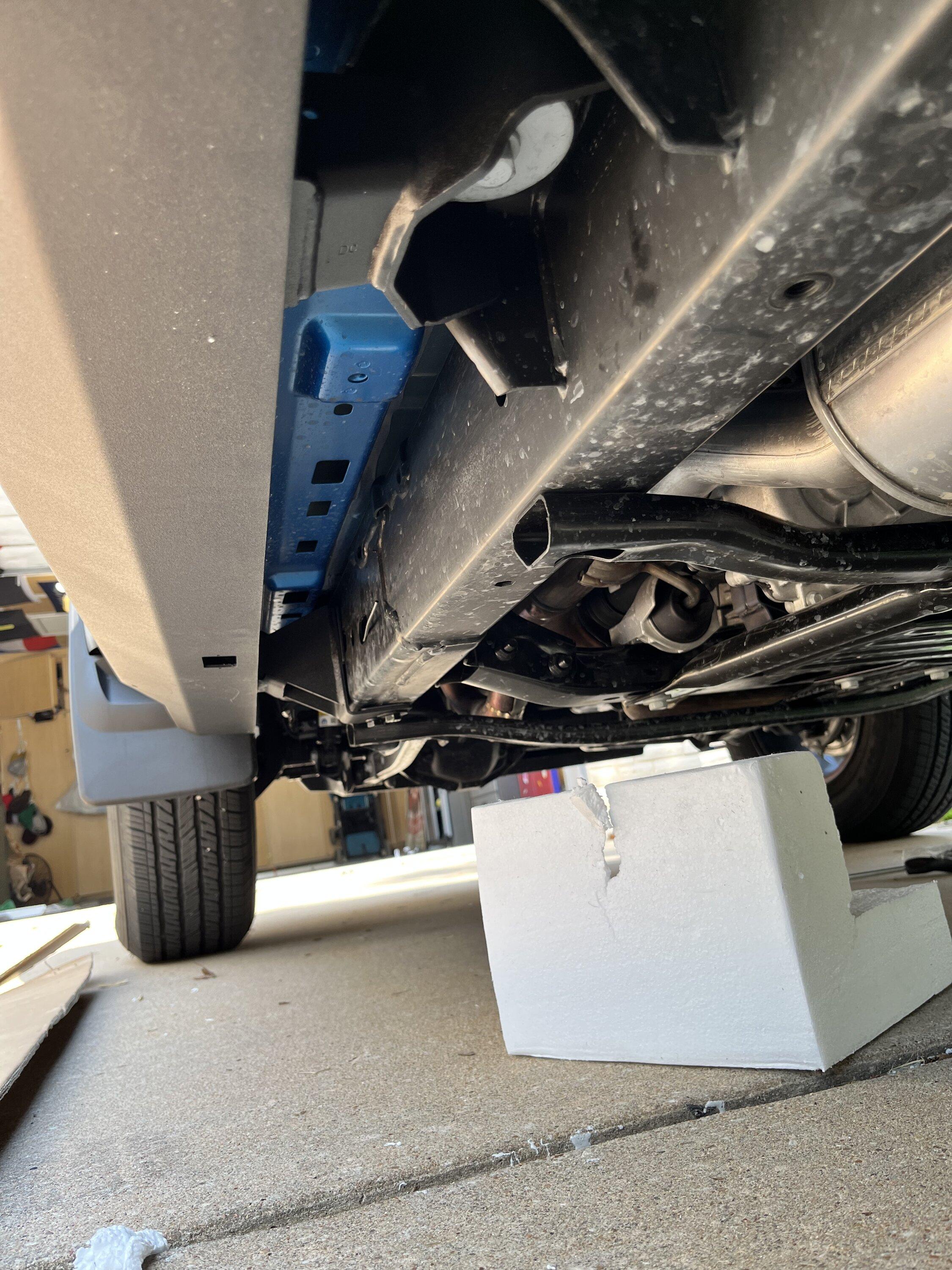

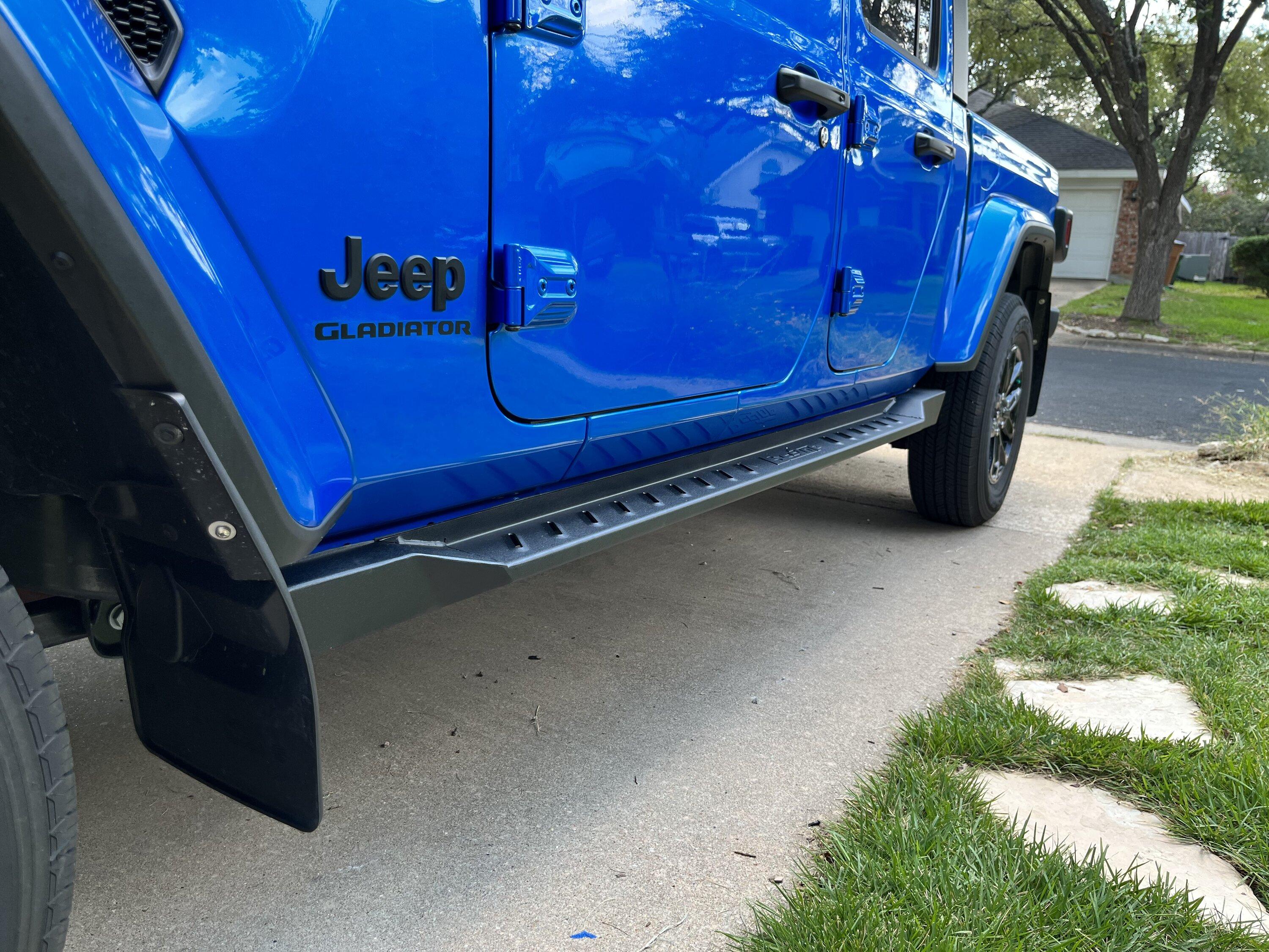

So I just picked up the Jeep a couple months ago and will slowly be building it up.I was looking for rocksliders with a step that were frame mounted. I could not find anything I really liked that wasn’t crazy expensive and or ugly. I saw bestop but never really saw anyone that had it but decicded to try it when they went on sale for just over 500. I didn’t want to have to drill any holes or anything crazy and these fit the bill. Anyways here are pics. Don’t know how strong they are most likely won’t see many rocks. Going to mainly used for camping, big bend, beach and hidden falls eventually.
Install was pretty easy except I was by self with a tweaked back so took about double the time it would normally take. The hardest part was fishing the 2 inside frame bolt brackets (1 on each side)

Don't lean on them too hard. They're not even 1/8" thick steel.
Most of the good ones are 3/16"-1/4" thick steel.

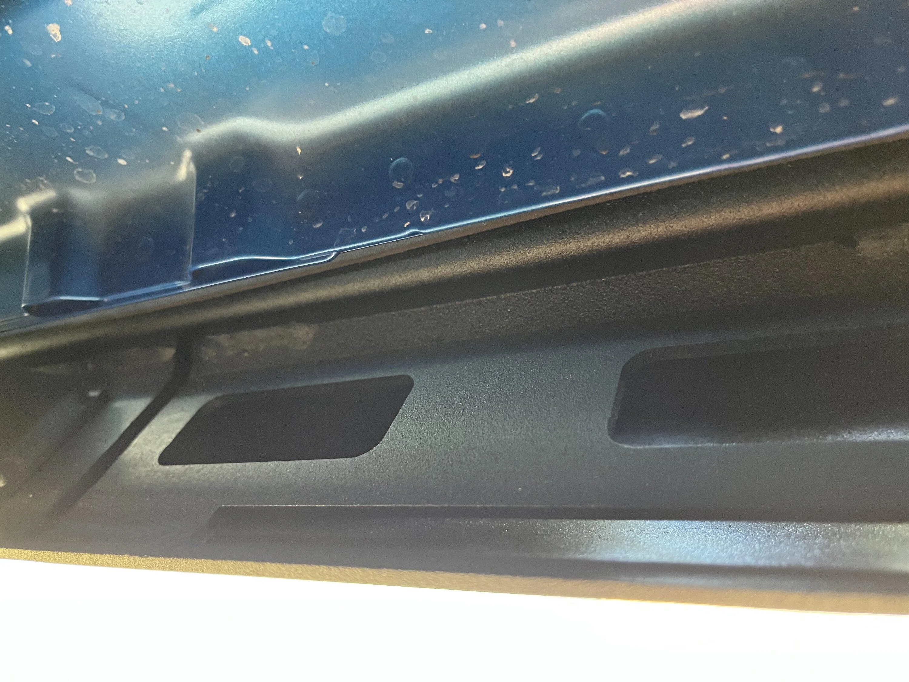

Curious are you assuming or do you have personal experience with them? If so I’m curious to what part messed up the mount or the slider. They are boxed inside so I would be surprised if they folded to easily.

Hey how have you liked these so far? I'm worried about them coming up into the pinch weld or body on impact. Do you see that happening?

The info is right on their web page. They are less than .125 inches thick. Most of the heavy duty ones are .185 - .250 inches thick.

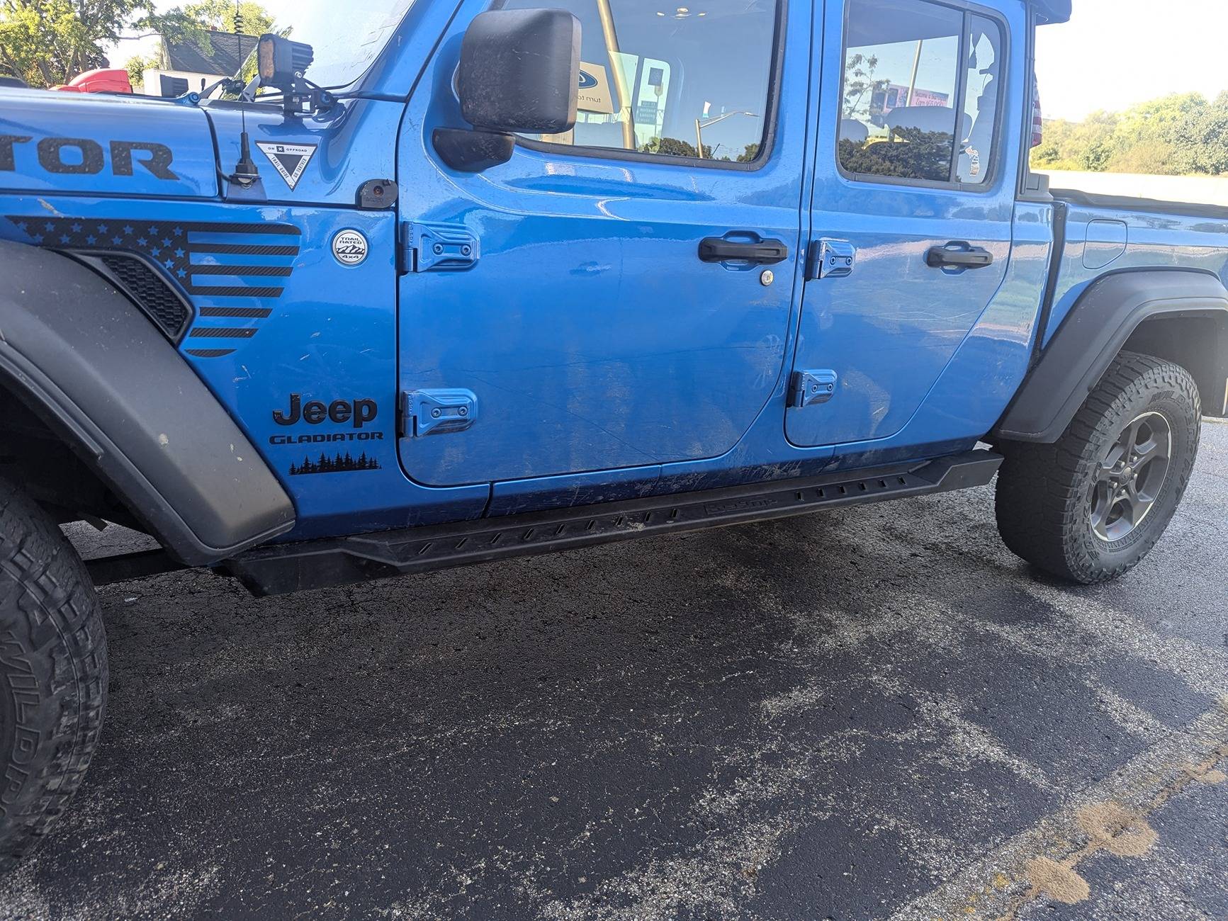

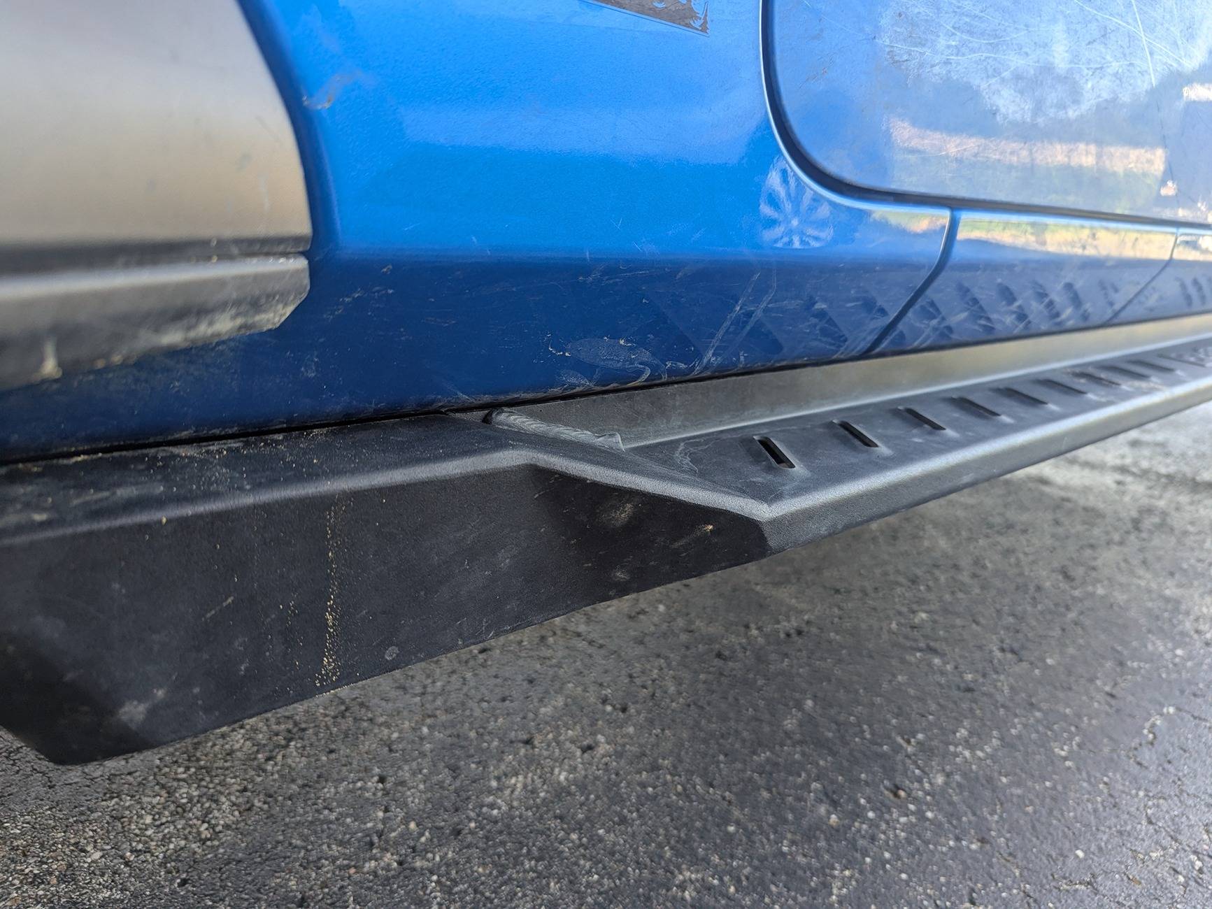

After contacting something firm yesterday, the slider moved.
