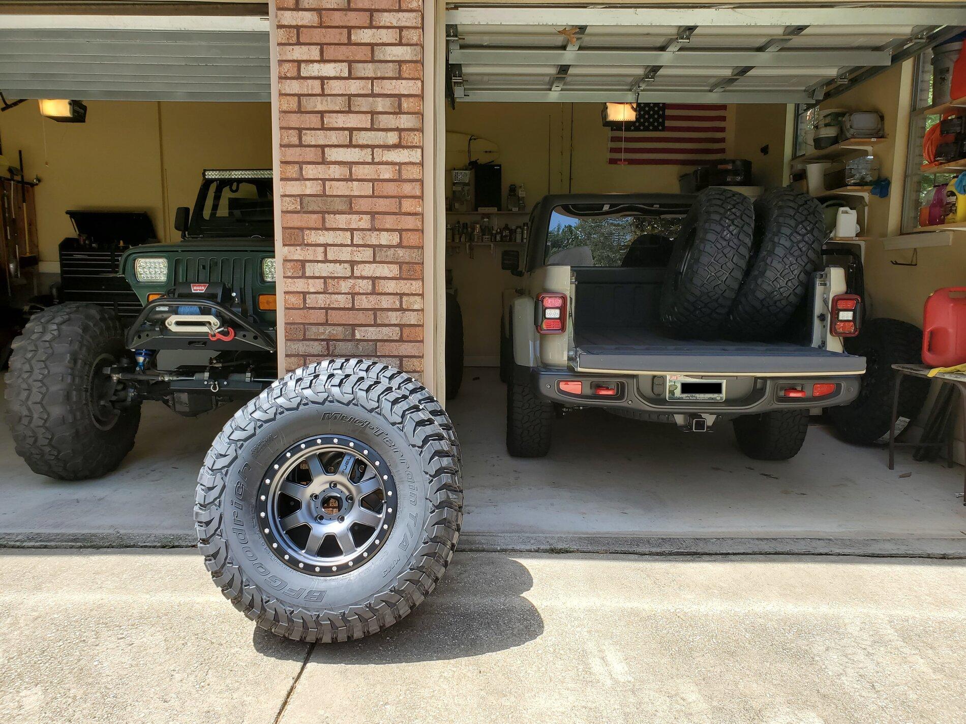

I have 37in KM3 that we originally balanced by 4WP with balance beads and they vibrated more than I cared for at highway speeds. I had them dismounted and rebalanced by a local tire shop with stick-ons and it has been butter smooth since. The installer has a lot to do with it. BTW I should have went with 39bfg.
