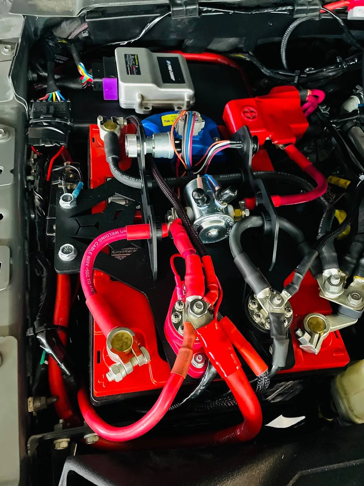

like @ttn333 mentioned.. Genesis Offroad makes a dual setup.. I had their kit installed back in August of 2021 on Camo JT.. wasn't having any issues. more of a preventative measure as I run a lot of accessories and a complex indoor/outdoor audio setup. haven't had any issues with it nor have I ever needed the boost button but when you're in the Pisgah Forest miles from civilization the peace of mind is settling.
Nice setup! I run a national luna dual battery kit in my 4runner. That was before Lifepo4 and the dual agms was to power a fridge. Deep cycle agms don't last very long without charging. It did save my butt a handful of times though. With the Gladiator, I run a house lifepo4 in the back and carry and one of those jumper pack. The only concern i have about the genesis dual battery kit is the limited size of the battery. I prefer running the biggest battery I can fit in the stock location and just delete the aux. battery.

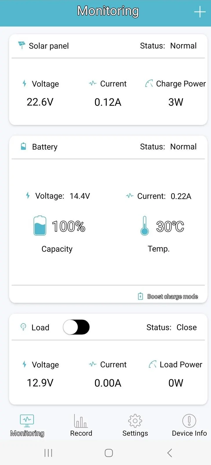

By chance if you need to ask or clarify something I post do me a favor please don't highlight in red. Being color blind of shadings the red/ green/ brown spectrum, I was just about unable to disconcern the red in the posts. :like:
I'm not a expert on this just a little knowledge about it. There is a few on here who are.
A low buck or simple system can be built fairly easily.
This is a screen shot of status of mine a moment ago.
Jeep Gladiator Big aux battery for overlanding? Screenshot_20240516_154911_Renogy BT
The bottom voltage is the vehicle batteries, with a door open, not an accurate indicator though IMHO. I should change the line feeding power to and from the vehicle batteries to charge controller. 🤔

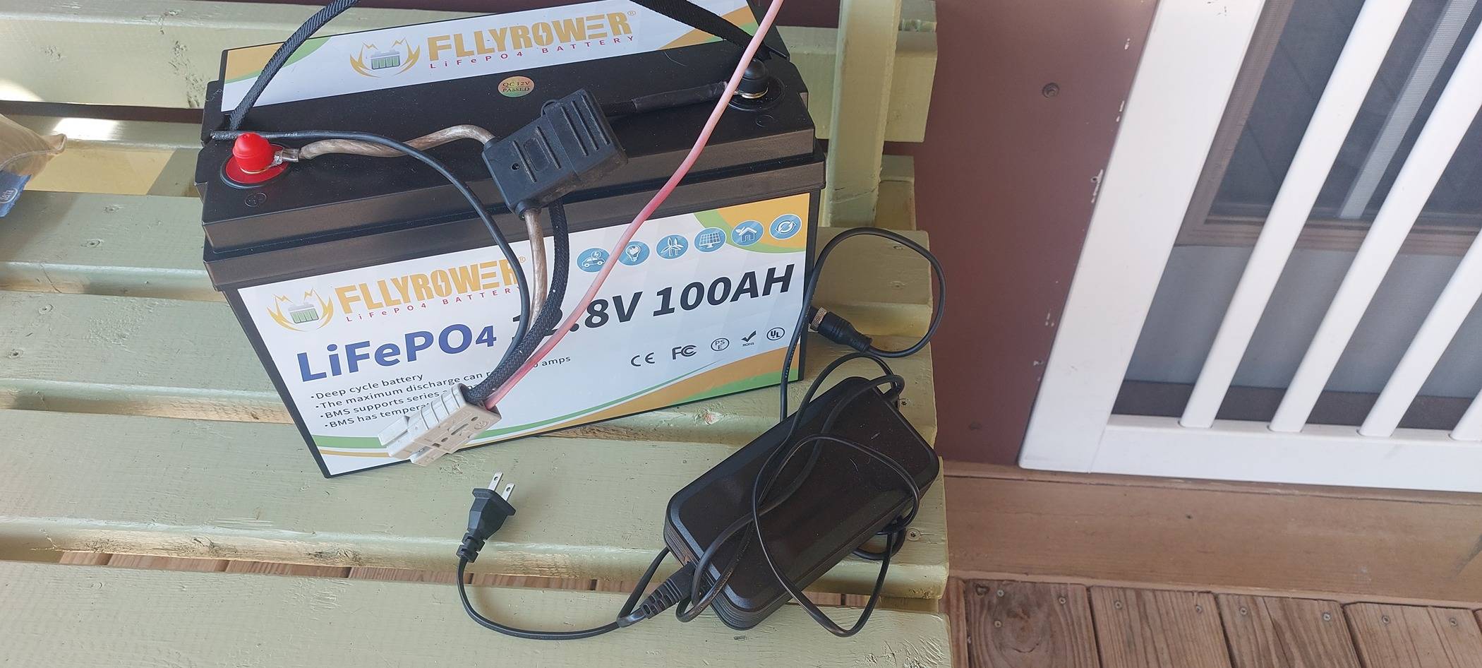

A (2nd) small simple setup I have started on with be battery, solar panel(100w),
Jeep Gladiator Big aux battery for overlanding? 17158934300448782388106705423498
charge controller and some power ports, the battery is another 100 amp. Short term use is trolling motor on small boat, then hopefully to step up to power my cabin and "cut the cord" on power company.
