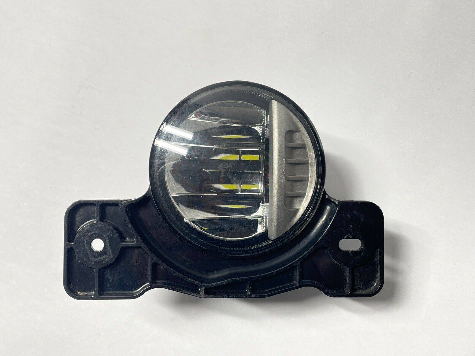

SideNote: My 2020 JTR Factory LED looked similar, but all 1 piece reflector set on the interior. (On a plastic bumper) IE: Like the pic w/the mount showing.
So, I'm also a bit confused to what an OEM light looks like on a steel bumper.

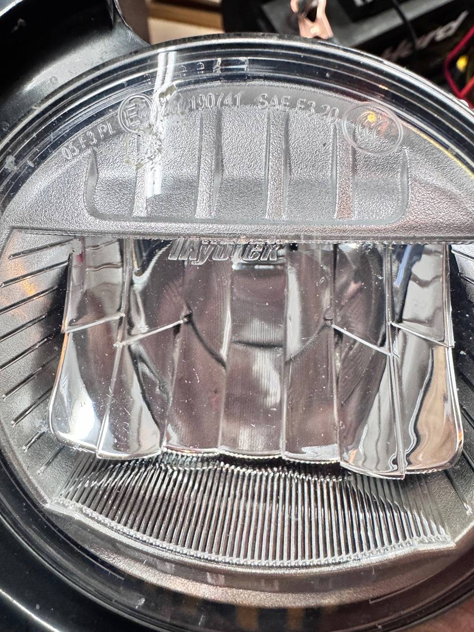

This is a photo of my current light, it looks kinda factory, but also looks cheap maybe a knockoff.
Searching eBay and I'm seeing this light listed as both OEM and OEM replacement.
Jeep Gladiator BLOWN OEM LED's Possible? IMG_6339
Jeep Gladiator BLOWN OEM LED's Possible? s-l1600

Is that MYUTEK? Certainly is a strange manufacturer’s name for an OEM part. I’ve seen the temperature specs for LED lights but I thought it just prevented them from working (cold temperatures).
Indeed, it's hard to make out, but it's Myotek. They've apparently been around and making OEM lighting since 1997 and have FCA as a listed OEM part.
