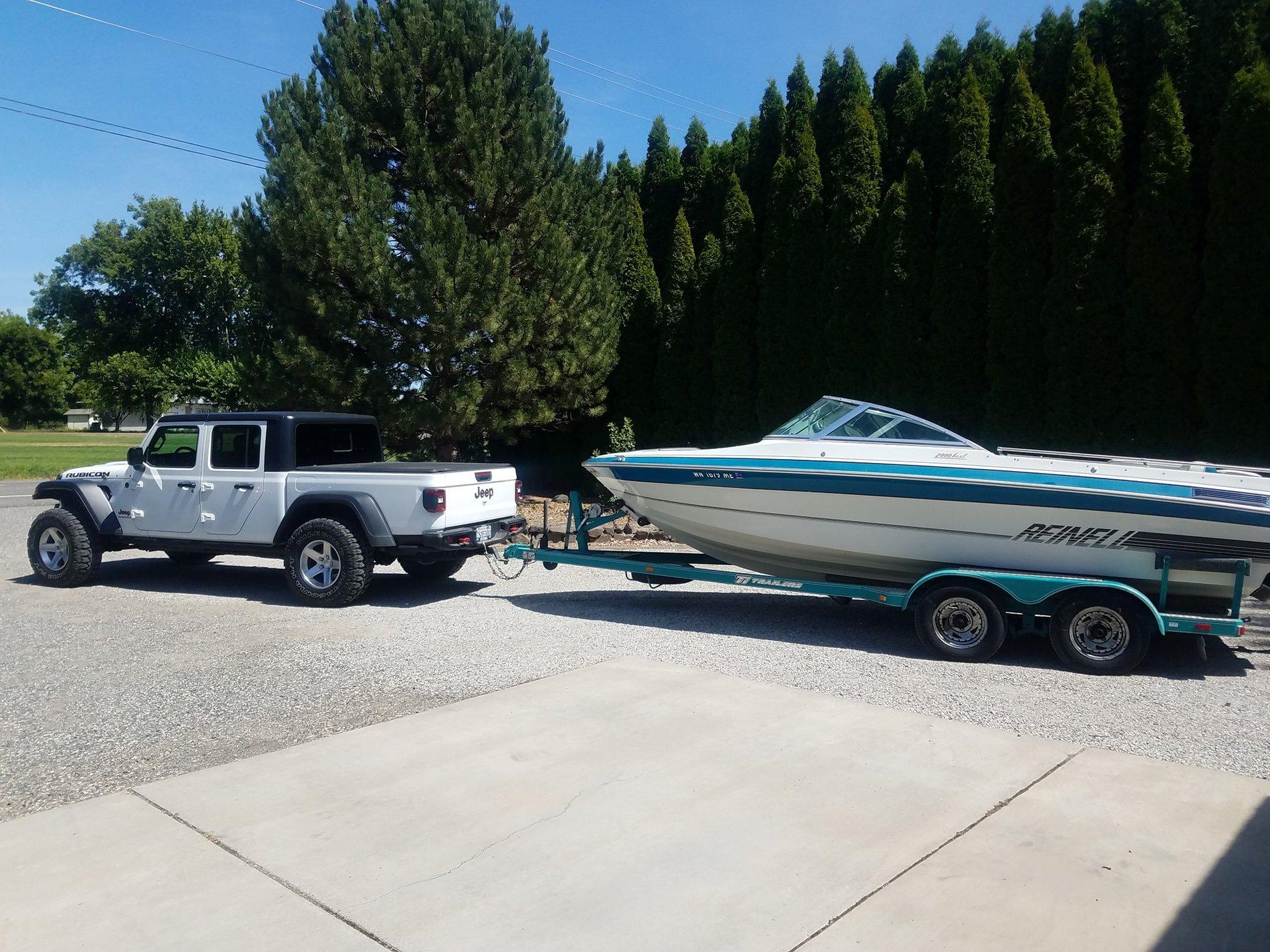

I tow our old 20' open bow with a V8 engine. I do not know exactly what it weighs, but she is heavy. Usually only a couple blocks to our local launch, but a few times last summer I had it on the hiway to launch at different locations. The Gladiator did fine. I could definitely tell it was back there.
That being said, I would not want to tow anything heavier on the hi way for long distances.
