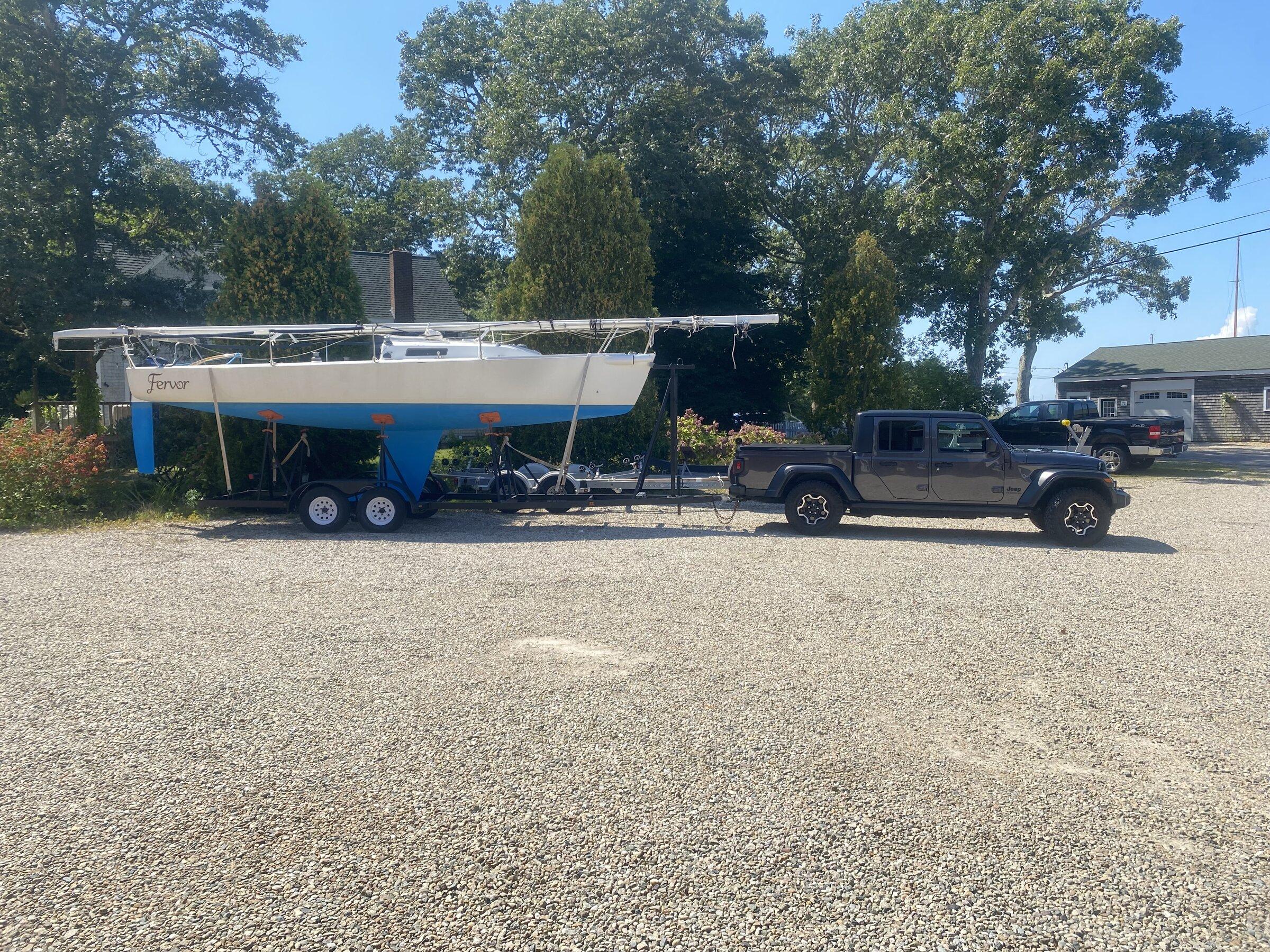

I tow a boat that weighs about 3k on a trailer that weights 1.5k-2k. I recommend working trailer brakes (I did electric as my trailer never gets dunked.) I felt the boat pushed the truck around pretty good stopping otherwise. But I have some hills and bridges that can be steep.
I haven’t felt the load was off and needed a weight distributing hitch although my trailer is well balanced with most of the weight directly above both axles.
Power is totally lacking (Could be the MT.) Although i get a lot of windage from the trailer so I don’t go over 50mph with the gladiator. If I have to go more than 25 miles I borrow a full sized from one of the guys that races on my boat.
Jeep Gladiator towing boat 9FCBDC13-9DB3-4387-AAA2-D73443407EBC

I’ve never seen the JT look so small in a picture lol. Nice freakin boat by the way.

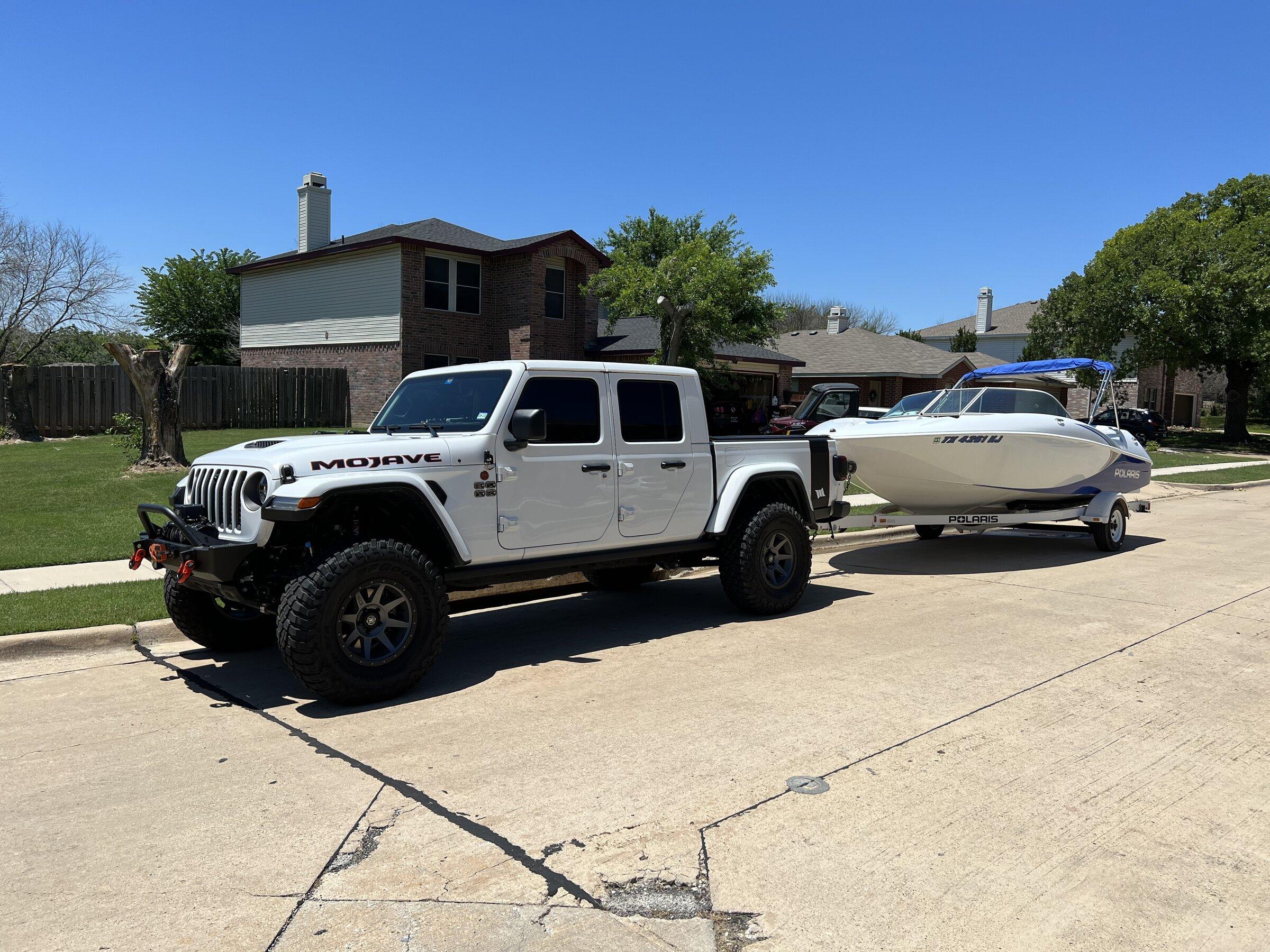

No sag with Clayton 2.5 lift. Granted the boat isn’t that heavy
Jeep Gladiator towing boat FBE2B793-75D1-4ACE-9F0C-18E0F51CA17E
